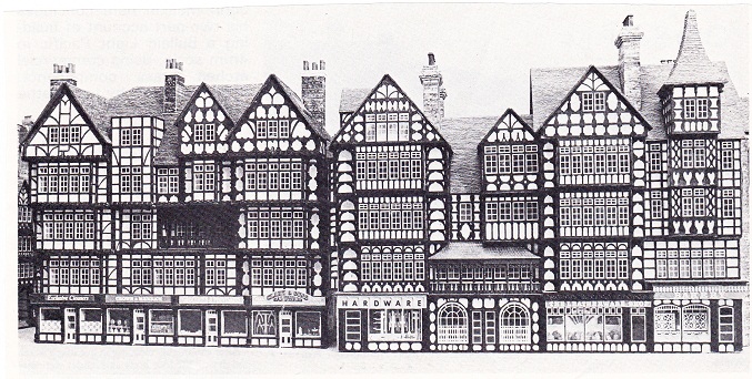

More "How did you do it?" questions:-
1. How did you do the black "timber" patterns on the white panels?
2. Is the diamond leaded glass a commercial item ?

Hi Ray, first the black timber/pattern work.
The whole building is marked out onto a large sheet of post card quality card in pencil - everything.
This is then all cut out as as a 'one piece fret' - a doily if you like - then sprayed matt black.
This is then glued across a 2mil thich sheet of white/cream backing card that will represent the panel infill between the timbers and the bay windoes made up as seperate units.
The diamond leading is brass etched and available from SCALELINK in various sizes and in either square or diamond pattern.This is sprayed in darkish grey and cut to window size with scissors when and as needed. The sheets are about six"x four"
If you require Protype practice regarding half timbered buildings, then please let me know and I'll run through it - with a picture or two to back it up.
One further point (sorry !) In your first photo here there is a little tower on the right hand end of the half-timbered building with a complex curved roof. Was this achieved through trial and error or was there a mathematical technique used?

I don't think I'd know what a 'mathemarical technique' was if it hit me in the face!
Geometry wasn't one of my stronger points ( got six once at boarding school for when we had to write an essay on the Leaning Tower of Piza where I just wrote "What can you say, bloody Wop builders!") but it gave me good "marks" - six out of ten to be exact !
No, I'm just a cut 'n' hope merchant I'm affraid Ray - if it don't fit, make one that does!

This is the part I don't get..
Sorry, but how the heck do you cut that out !! ????????????????????????????????????????????????????
(refering to the picture in post #2)
And that cream coloured filigree on the balcony ? seriously ? HOW ?

Allan says….. "This is then all cut out as as a 'one piece fret' "

"Sorry, but how the heck do you cut that out !!" - very carefully!!!
I just use an ordinary Stanley knife - good grip, no wrist ache, cuts just as fine as any scapel - As a test, draw out an intricate pattern onto a postcard say, then have a go at cutting it out - just take your time.
I shall have to go back and have a look at the 'cream coloured filigree on the balcony' and get back to you on this.
However, below a couple of shots of very early tudor using the same method - 'timber fret' cut out as one piece gled over panel sheet.
Allan.
Ah, yes.
Well that is chemicaly etched bordering from SCALELINK - you will find this bodering most of their brass etched frets and in particular, their wrought iron balcony frets.
Anything else, just feel free to ask.
Allan.
