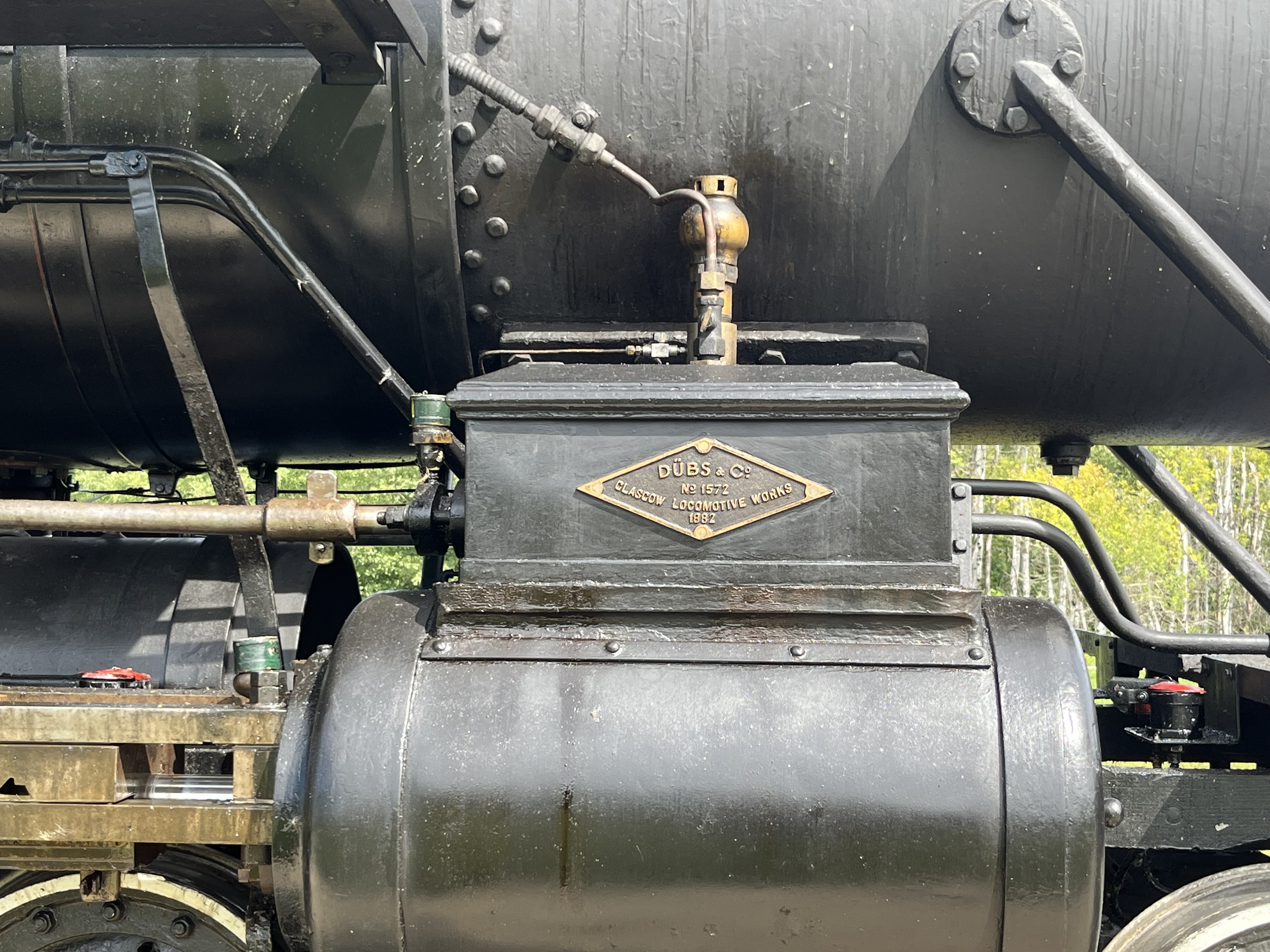

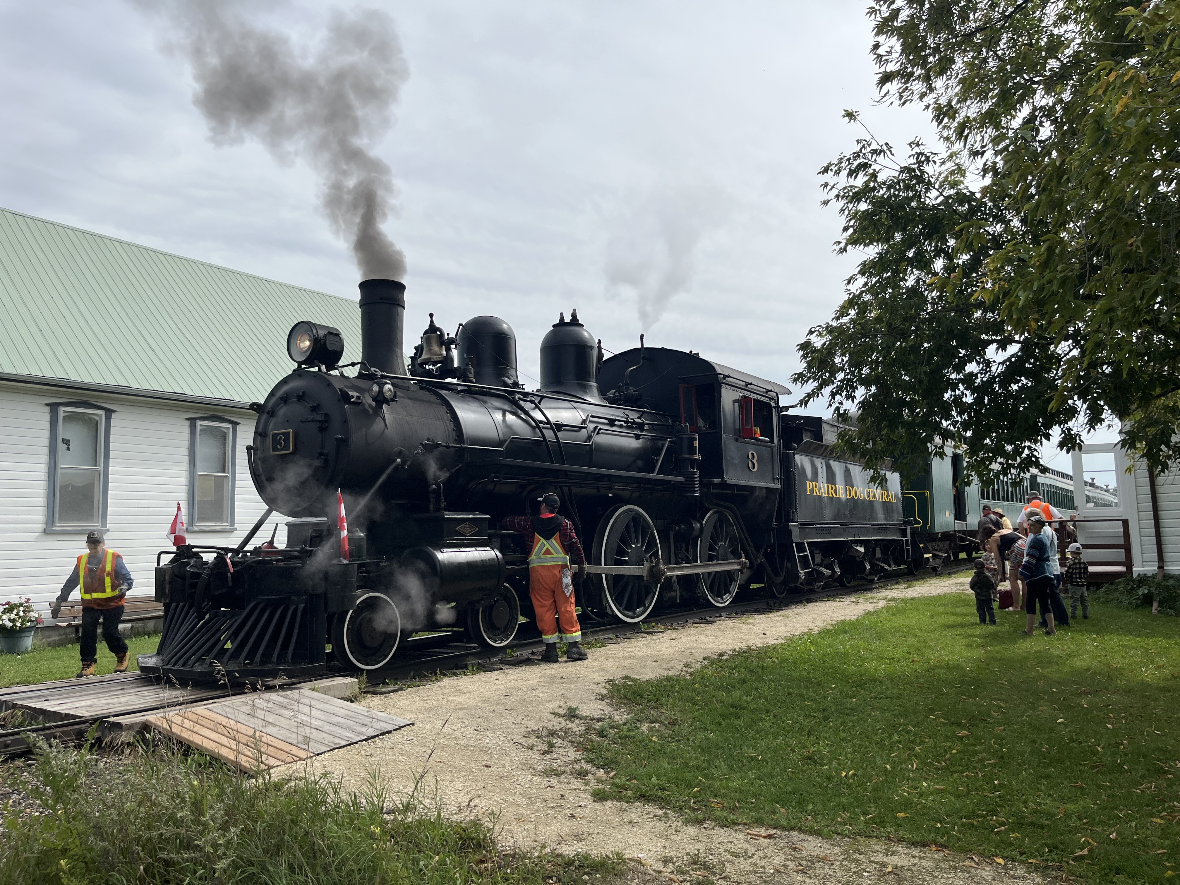

#293668
  Said steam engine. Praire dog central number 3. Canada’s oldest working steam locomotive, 145 years old. She was built by Dübs in Glasgow, which suprised me.
It was quite an awesome experience, we rode out for about an hour to a small community with a heritage village and then came back to just outside Winnipeg.
I realize this concept is maybe pretty normal in the UK but there isn’t much for heritage railways here. The only others I  have been on in Canada are just a simple loop of purpose built track.
I was also quite thrilled to walk along the track and collect bits of coal. My wife was not as thrilled, and wouldn’t let me keep the fist sized piece.

#293669
It looks like two photos of the nameplate were uploaded instead of one of the locomotive.. so let me know if you see this phot
