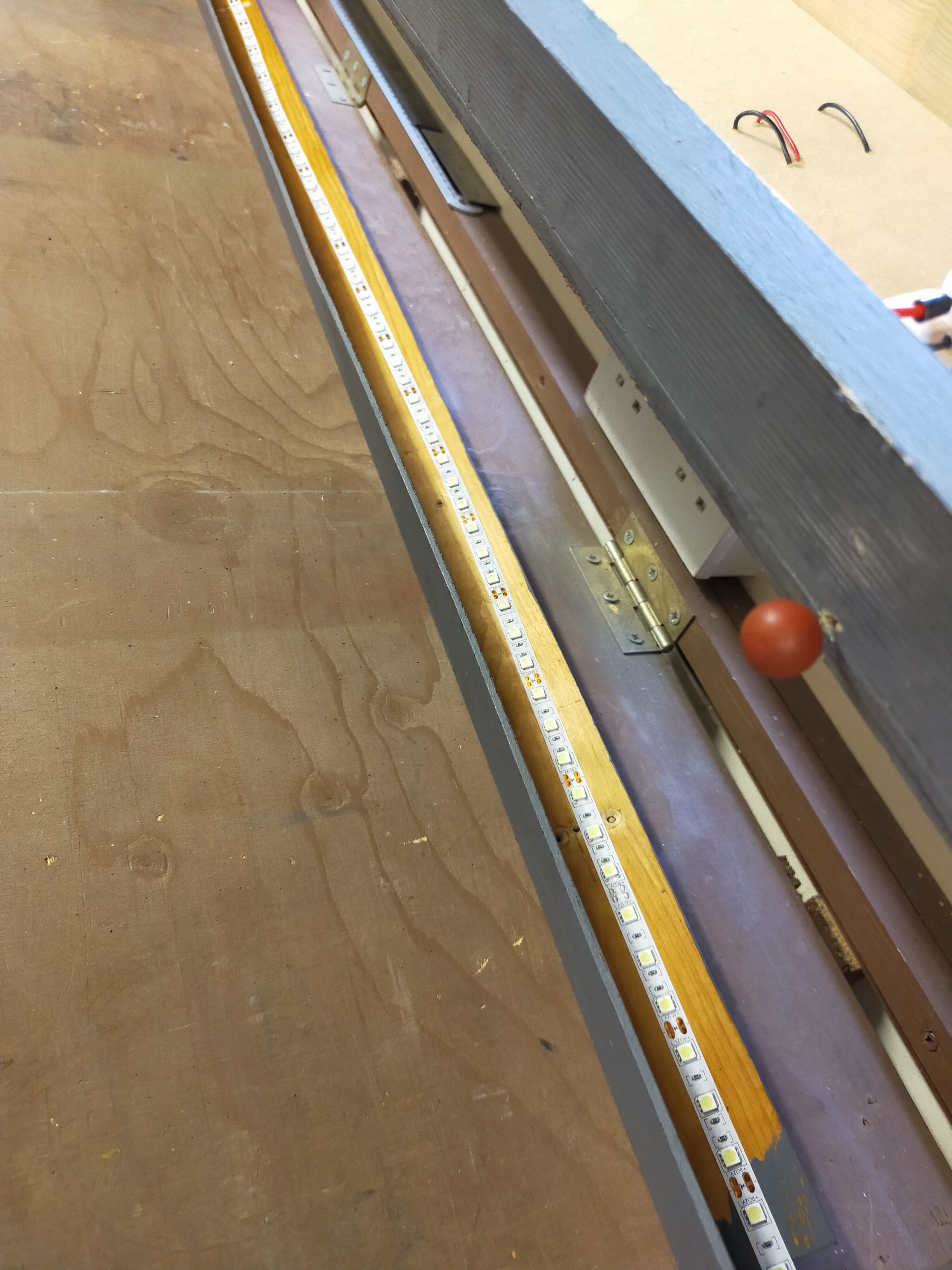

Work on the layout is progressing.  I decided to install the lighting next.  The word 'install' is a bit misleading as basically, I cut a short length of LED strip from the spool on which it comes, peeled of the paper backing to reveal the sticky back, and simply pressed it into place.  Total time taken in this task about two minutes!  Great stuff this LED strip.  I really would not revert to neon lamps, spotlights, or any of that pre-history nonsense.  I buy the LED strip online on the usual auction site.  It comes pre-wired to an on/off switch and 12v transformer plug.  I checked yesterday and 5 metres can be obtained for just over £12 Sterling.  Great value.
Here is the upturned layout showing the LED strip in place.
116 views (3 MB)
