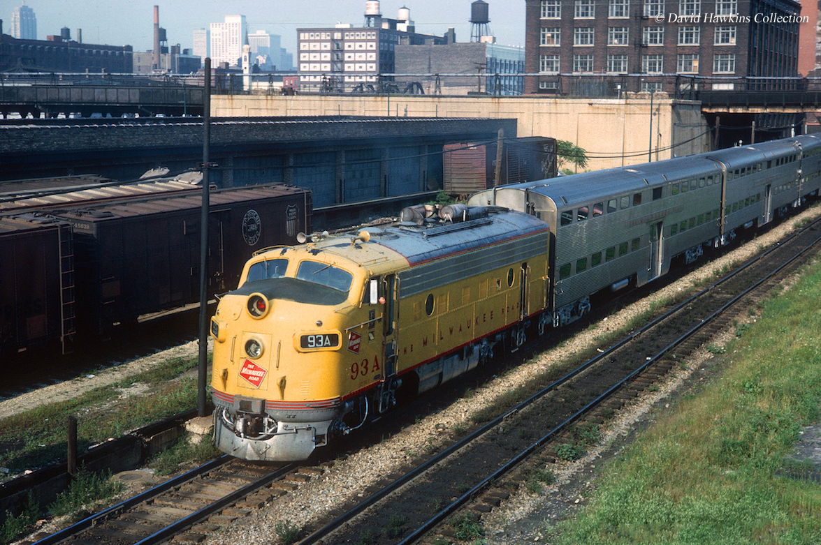

Roof piping. You should have said what you were specifically looking for re a photo. See http://www.rrpicturearchives.net/showPicture.aspx?id=2131299 and http://www.rrpicturearchives.net/showPicture.aspx?id=4110249 for a roof-mounted cooling pipe array on an FP9. The big box with the grill is the winterization cover.
Cal-Scale does a long cooling pipe array appropriate for an F9, although a representation is easy enough with soft copper wire  (Michaels, jewellery section). Such piping was typically for the air compressor, not for oil cooling (the internal radiators were more than capable). There would have been a moisture trap between the coil and the air reservoir (internal, for servicing). I believe this was normally a re-positioning from under the body when larger capacity fuel tanks were added (and the side skirts removed).

Roof gear depends on several factors - F9 or FP9 (which means a longer body length and some roof-mounted gear from the steam generator tucked inside, and additionally a passenger pilot similar to those on E units), winterization hatches for northern railroads, often left on over the summer in the open position, MARS lights in later years, horn type (railroad specific), bells (or not), spark arrestors (or not), raised or flush ventilator grills, ventilator fan diameter (36" or 42", but to a certain extent depending on dynamic braking or not)….
Check http://www.american-rails.com/images/F9A796878.jpg for a busy Milwaukee Road F-roof with large diameter D/B grill at the front, spark arrestors and passenger steam gear at the rear. And that large coiling coil for the air compressor.
One of those subjects where the devil is in the detail, and often railroad specific (no such thing as a generic F9). Those more knowledgeable in S-F F9 details should put you on the right path.
