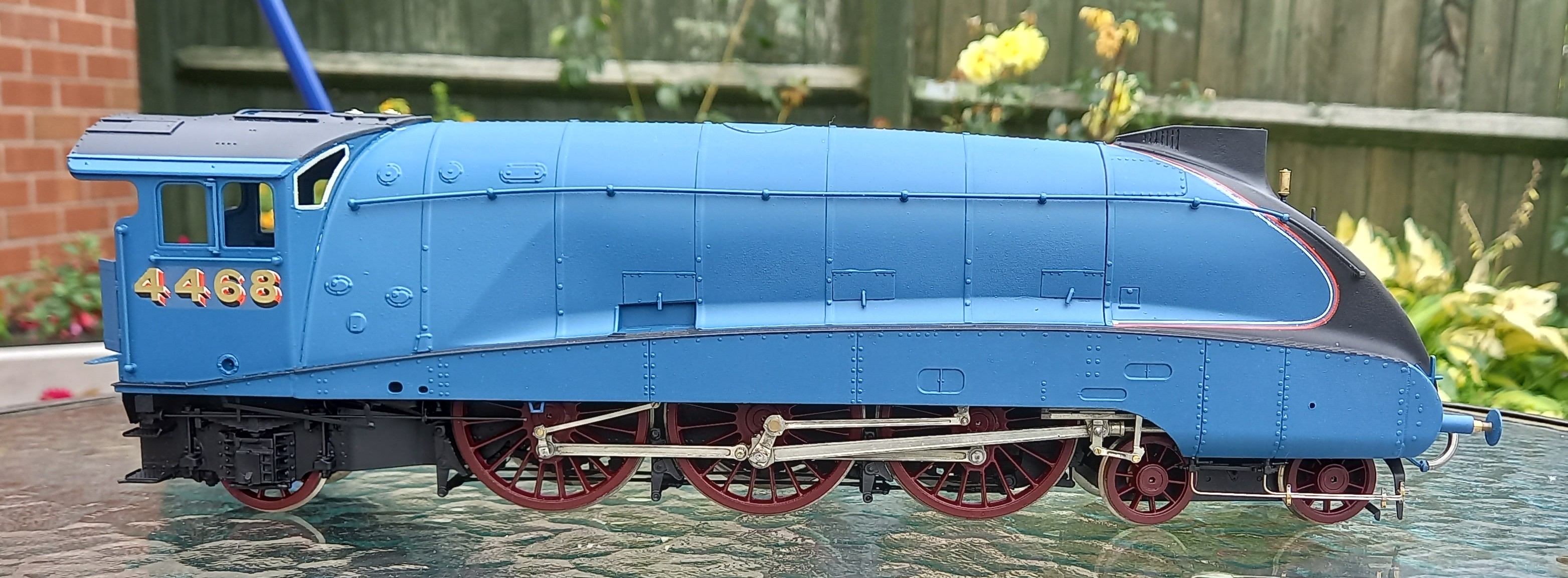

I patiently collected every issue over two years and made a start on the chassis in February 2019.
My intention has always been to make an exhibition standard fully working robust model , but using solder wherever possible and fitting a quality motor and gearbox.
The only parts needing total replacement have been the main loco drivers, lost wax lamp irons in place of the whitemetal parts supplied and a lost wax whistle.
So taking up the build again this September I made a start on the loco body by drilling over forty various size holes in the cast `mazak` body assembly
and fitting all the details and replacement lamp irons. The `mazak` roof section also had it`s details applied using a very thin quality superglue and was attached to the soldered brass cab section using Gorilla Glue.
The chassis was competed and then de-constructed to be painted and reassembled as a fully working unit.
The main drivers are Slaters replacement as the partwork wheels were not a good enough quality for a working model. I used Premier Components 30.1 Helical gearbox and a Canon 1833 motor.
She past her first test bench trials:-
https://www.youtube.com/watch?v=qplYANULJi0
https://www.youtube.com/watch?v=f0Gww0ki_jQ
And then I had a rest………………………………….

After my rest, I got on with some of the cab details particularly the backhead where I used soft copper wire instead of the harder brass supplied.
Then on to the tender assembly. The tender footplate and below has been a solder construction and has been fairly straight forward.
The tender body is a plastic moulding and so I detailed that using a very thin quality superglue. This turned out to be slow and fiddly.
So, my LNER A4 Mallard has been built and now will await her 1930`s Garter Blue livery……..

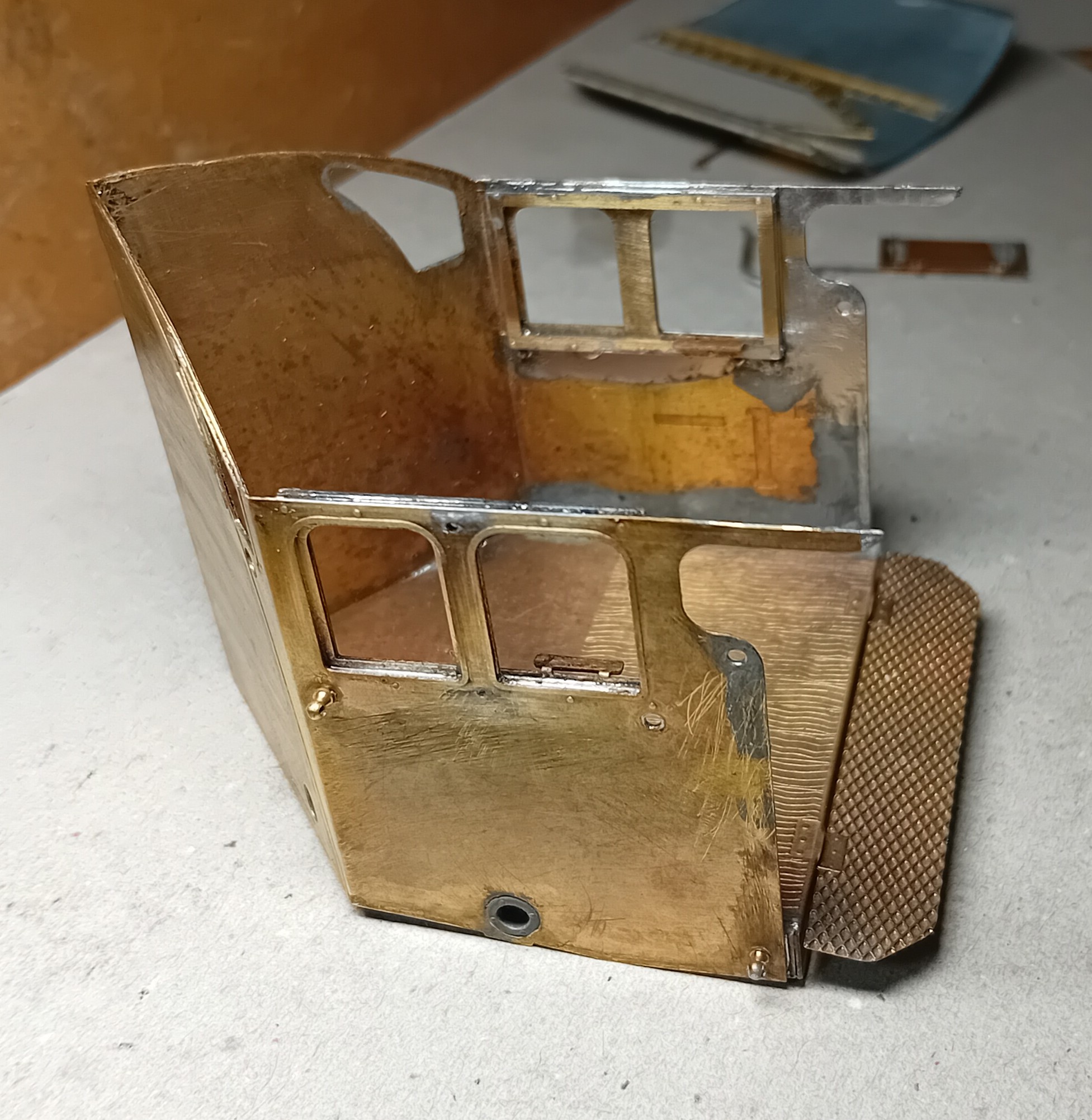

I`ve recently ressurected this topic because I discovered, after painting it all, I had assembled the loco cab window frames the wrong way round
Also, the overall paint finish has been the worst I`ve ever done.
And so, this year I`ve decided to rebuild the cab and of course strip the paint off and start again……….
Twobolt John
If you study the window frames before strip down , you can see that the framed window should have been the leading window and not the trailing window.
Twobolt John
I think I can make out the difference in windows that youre describing.
