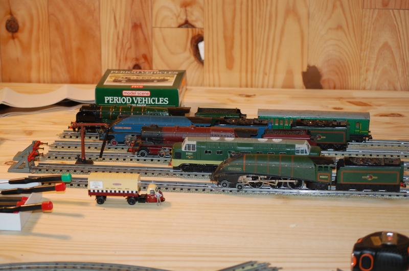

I am retired and live in France. About 3 months ago my Son (also Robert) came to visit and brought with him a huge box of Horby Dublo 3 track all dating from the 40s to the 60s. He opened the box and said, 'Can you have a go at fixing this lot for me Dad?' Since then 3 other boxes have arrived all containing various 3t trains, rail and other delights.
I have built a base board, not a big enough one I might add, with the intention of testing (repairing?) everything, piece by piece, as a winter project.
Now, I am completely new to the hobbie and rather thought that YMRC might allow me some initial insight into the mysteries of railway modelling and give me some idea of where I might make a start.
So, having said (written) all that I  posting on the forum this evening to see if someone can advise me………………
How I can use a multi-meter to test track and Engines?
Is flexi track available in 3T and where can I obtain it?
I have a 'St Paddy' engine that just twitches forward mm by mm and hums. Where do I start with this?
I'd also like to buy some rail clips please?
Have a nice day.
Robert.
