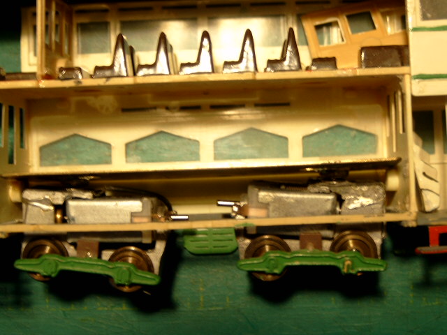

I have two "original" BEC bogie motors from the 1970's but the pic below illustrates the problem.
However I'll make contact with BEC and see if there are any of their chassis and trucks available as I know they originally did them for a London tram.
