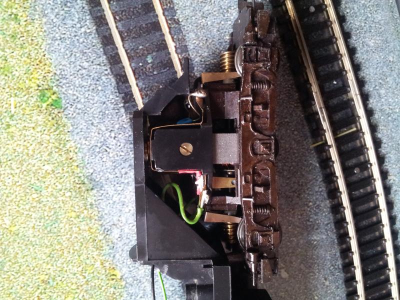

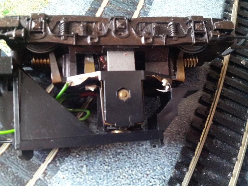

Ive just put the loco on the track as a rolling chassis only and it moved a whole inch beforeba spark flew out of the worm gear tripping the short circuit protection on the controller. Track pins are used and none foul any of the locos amd none lying across the track
#157757
Problem solved. After fearing taking the motor apart there was a dog hair fluff build up  amd build up of oil on 2 u shaped bits of metal and it was arcing out. A quick pull out with tweezers and she runs faster than ever now. no more slow mo coco diesel electric class 37

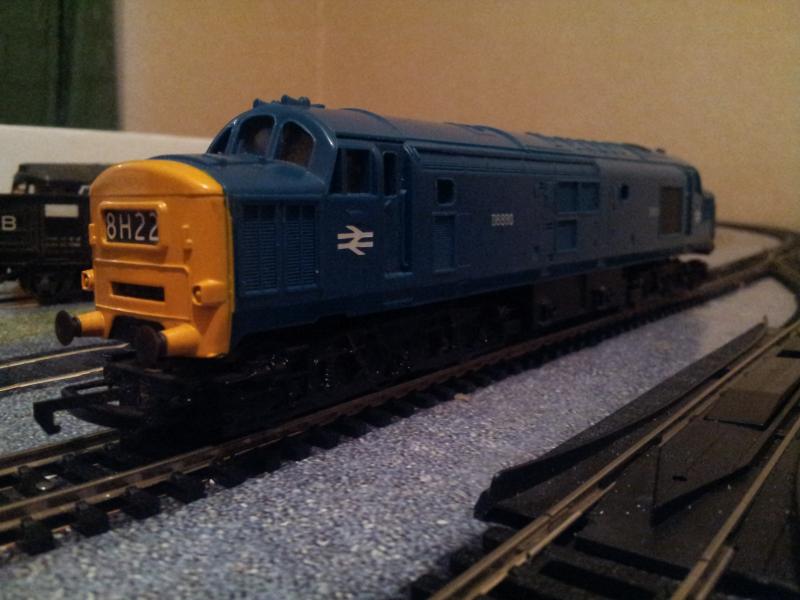

Hahahaha terry. Its only really today that ive cracked on and got the layout in motion. Built the baseboard and electrics then applying the track and gettin locos running :mrgreen:. The loco i was havin problems with i had purchased from ebay back before xmas for about 15 quid amd the condition was better than a few others i was considering. Just glad its running properly
#157764
And here is the loco :mrgreen:

Those motors are very easy to strip down and tidy up. If ever doing this, just make sure the wheel sets go in the way you pulled them out ! I have performed maintenance as such on a few of my old Triang/Hornby locos and after a clean up, they run like a dream, especially considering some are over 35 years old ! Spare parts for such motors are still available from -
