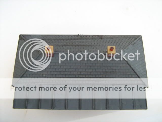

Firstly, there is some preparation to be done. The Dapol range of kits, which are ex Airfix, were introduced in 1958 and consequently they are crude by today's standards and now suffer from warping a bit of flash and mould marks. But, at around a fiver it is a cheap way to construct a station building. Any warped parts can be straightened by immersing in very hot water, quickly bending them into shape and then dunking them in cold water. It is worth washing the parts in soapy water as they can be oily from the moulding process.
When built straight from the 'box' the kits are little more than an unglazed shell:

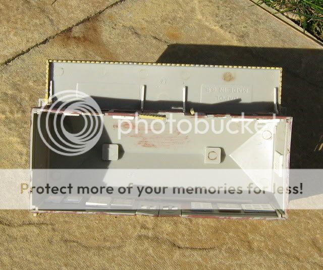

In order to give the buildings depth and to prevent being able to see right through it is necessary to construct interior walls. Once built it is quite hard to see in and thus the interior detailing need not be great to look effective. This is the sequence of construction that I use:

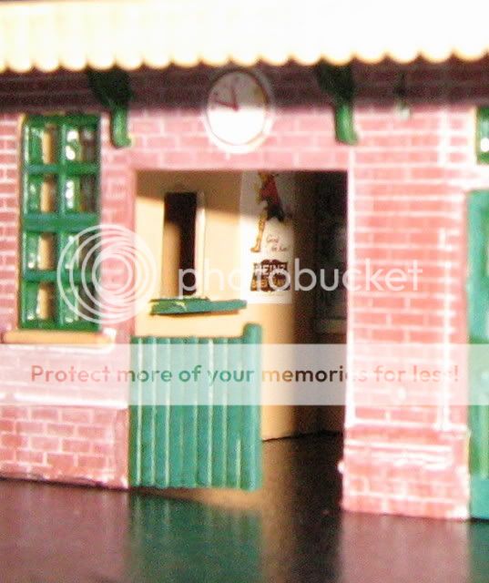

7. One wall (toilets) is left blank. The second (ticket office) I cut out a small rectangle half way up to form a hatch and added a small shelf from scrap card. The third wall had a doorway cut out to form the waiting room entrance. The piece cut out is then glued back in at an angle to represent an open door.
8. I then painted the interior of the building and the new walls a buff colour and the ticket office shelf and waiting room door green. I added a few posters and could have added other items of detail, but I stopped here.

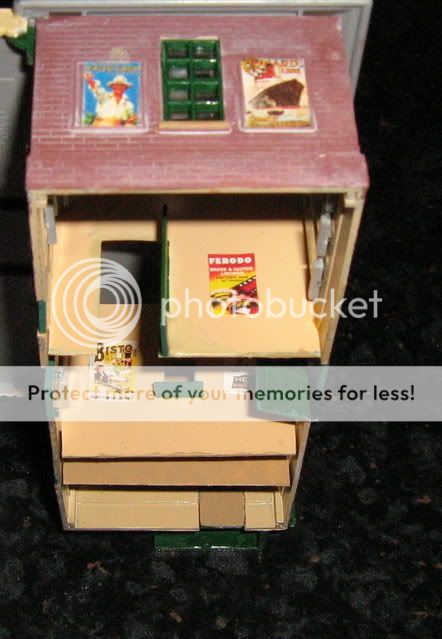

11. I painted the ridge tiles and chimney pots in terracota, again weathered with a black wash. Some posters were added and the finished model:
The interior walls are quite effective as can be seen from this close up:
