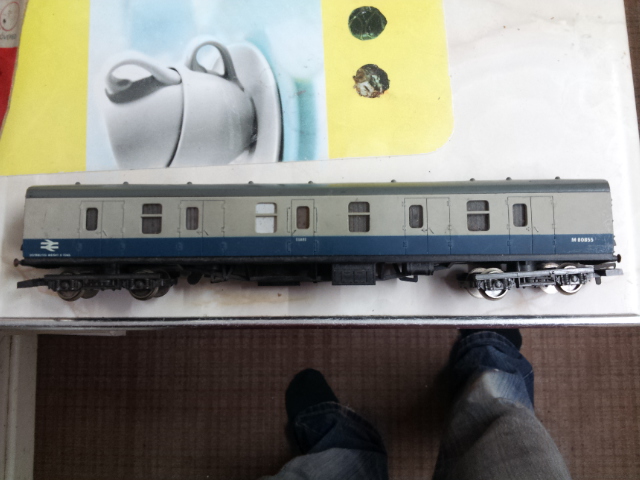

bogies
I was just wondering if there are any hornby bogies that would be compatible with this lima coach. If there is could I have the hornby part numbers

Sparky helpped me out with one coupling link but the other bogie still need one but im considering a complete bogie if i dont get any joy. Any help is appreciated

Hi Trevor
These look similar to the ones on the coach, they are supposed to be Mk3 bogies but I have used them before if you do not care about being accurate. Part No is s9749 here is a link to some

Hi Trevor
Hattons stock Bachmann bogies
Bachmann Branchline OO Wheel sets & bogies/trucks Products from Hattons Model Railways
Fitting these to my own Lima Full Brake, I intend to remove the lima mount flush with the floor, then cover the hole with a piece of plasticard, then use a dress makers press stud (also called snap fasteners) to connect the bogie to the coach. This will act as a pivot and also allow the bogie to be removed.

You could try Replica Railways. They do the Commonwealth bogie and I think they just clip in with a stud just like the old Airfix Bogies. For fixing to your Lima coaches I think you will find an 8BA nut and bolt (or this new fangled metric equivalent) will do the trick.
