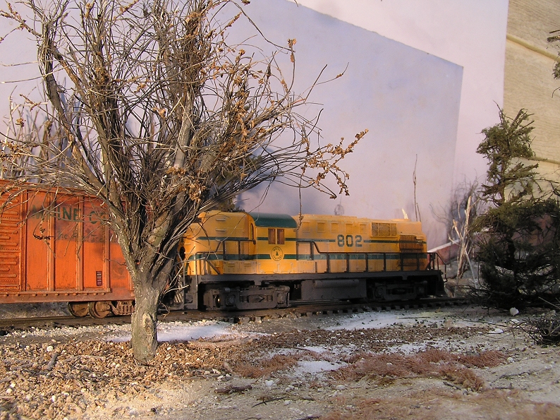

Using pre-painted coconut fibres, pre-painted sisal rope fibres, garden twigs. Foliage will be dried tea leaves.
I'm going for a multi-trunk specimen.

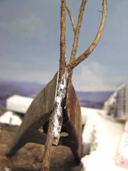

Twig in the centre has a thinner branch below thicker ones, so I snapped it off, leaving a nice stub, then glued it back on farther up.
Glue is Selley's All Fix - thick like paste and it grabs fairly quickly.
The trunk was shaved flat to accomodate the branch.
After trying in them in various positions, I took Left and Centre twigs and shaved them flat too, then glued them together
Held 'em in a spring clamp

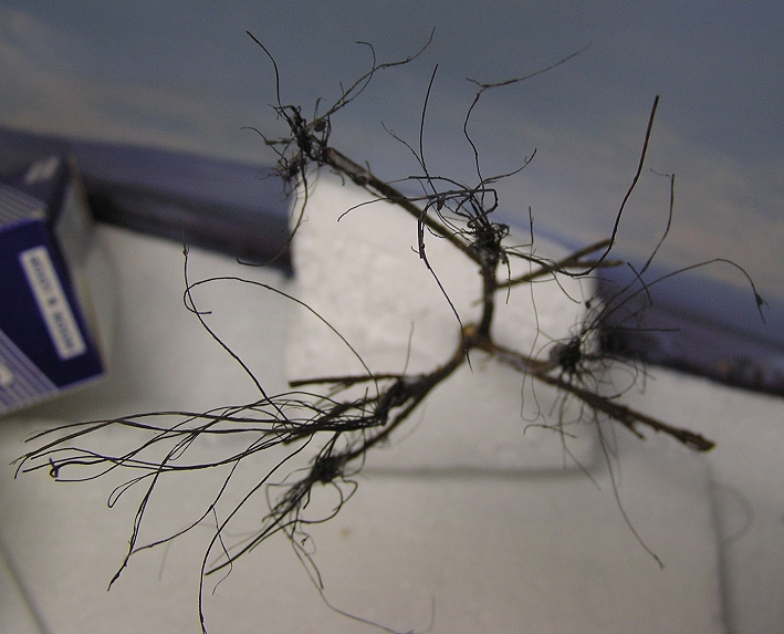

I twist one end very tightly, then tease out the fibres, cutting through any loops, and discarding any weird bits. It pays to have some PVA on your fingers as you twist them.

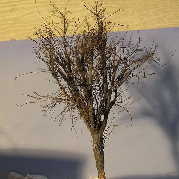

Added a couple more branches, then glued on some fibres of both types to disguise the cut-off ends…
View from above…
I like to keep my eye on how it looks from above, so I can get an informal balance to it.
More when I have the time.
That means I think they are good !!

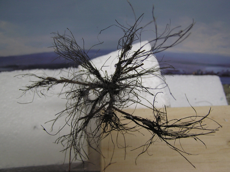

More fibres have been added. Bigger clumps down low. Small clumps of coconut fibres help disguise joins.
The sisal clumps are thick enough to be trunks and heavier branches.
and from above..
I'm not worried about the glue. It adds texture and it all needs painting anyway.

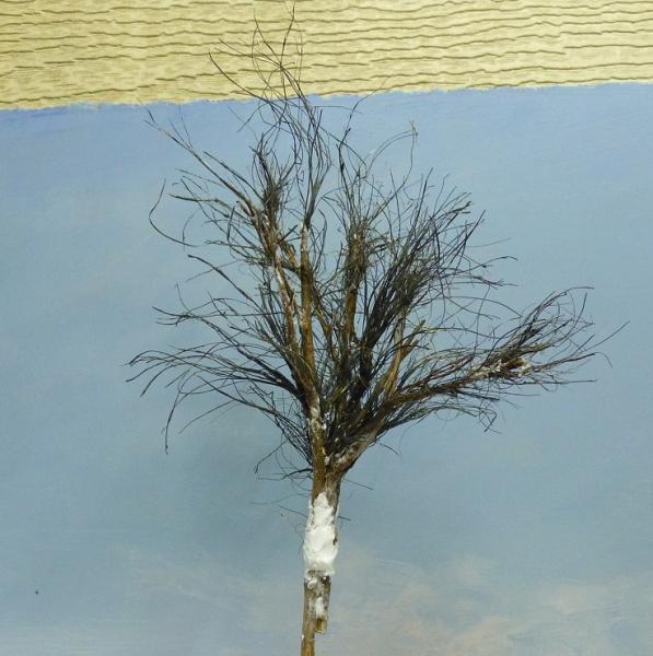

After still more fibres were glued on:
I think I have enough branches on it now.
The base is being broadened with the glue.
Next step will be to paint it, once the glue is dry.
I used Jo Sonja's acrylics - Linen, Charcoal and Chestnut, plus some cheap forest green for down low on the trunk and underneath a branch or two.
I painted the innermost parts quite dark, and highlighted tips of branches, along with some horizontal parts that might help enhance the impression of it catching the light.
For the faint green on the trunk I added chestnut, charcoal and linen to the forest green and painted it very thinly.
A mix of chestnut and linen was dragged across the trunk to highlight the texture.

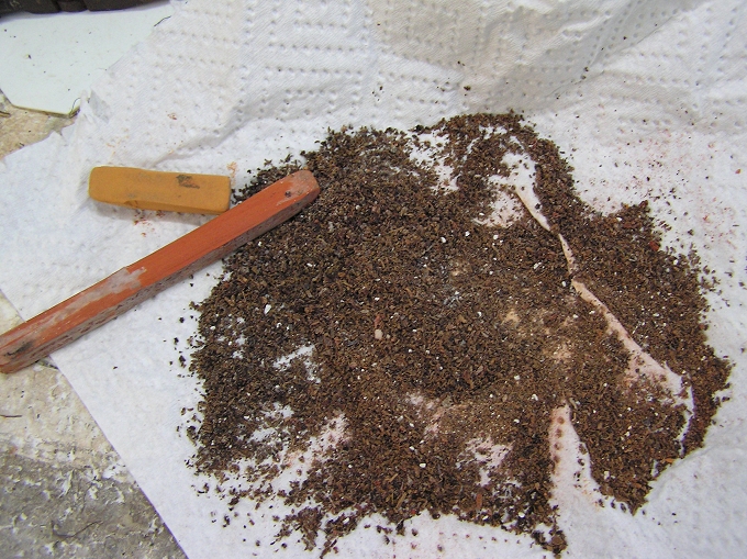

Then it was time for the tea leaves.
I decided they were too dark a brown, so I mixed in some powdered clay to lighten them [should have used chalk] as well as some powdered orangey-browns. All mixed together.
Then PVA was daubed onto the tree here and there and it was dipped into the mix.
Trickiest part, apart from avoiding gluing branches together, was knowing when to stop.
Excess trunk was trimmed off the bottom which was shaped into a point, then the tree was poked into the foam of the layout.
It's 7 inches tall.
edit: I could make some roots out of clay, as I did on the old layout, but I think that'll do for now.

trees grow like that, it looks just fine.There's a little gap letting the light through, just below a sisal clump where all the heavy branching starts. You can see the orange boxcar through it. I'll dissguise it with some more coconut fibres. I never would have seen it, but of course the camera does.
