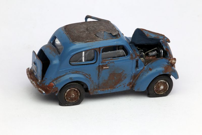

The donor was an Oxford models "Ford Popular 103E". I'll post step by step pictures but not all in one go as there might be questions on each mod.
For bonnet, door and boot etc removal, a jewellers saw is needed and the finest blades, I work with this with  my day job so I'm used to it but care is needed as it's very easy to break blades so you  will need a few!  The trick is to hold the job so it doesn't move, then  with very little pressure let the blade do the cutting and try not to  twist it in the cut as this usually causes it to snap.
So, the original model and the same car modified and added to the picture, the finished result and the car added to the layout.
Remove casting lugs.
Unscrew base an pop out window unit.
If needed, cut off front bumper, this can be done with a thicker blade.
 File to shape and smooth area, also use a scraper on the left and right grill areas, and scribe on the new grill vents.
The lights have also been removed.

Thanks Jeff and Andy, here's a few more steps :)
Wing removed this time with a fine blade.
Excess metal filed off.
Door removed.
Boot removed and bumper area cut out and refined.
  Headlight lense drilled out.

Excellent!  I love the cracked and broken window at the rear passenger seat - was that just scratched in?  Very realistic.
#242058
Just scratched in.
Bonnet and vent cut out, vinyl roof partially scraped off to leave a glue effect.
Plastic door section side panel removed, gearstick, radiator & pipe, engine block, coil, battery, distributor, regulator  and starter motor added.
Steering wheel spokes drilled.
Tyres cut flat and Araldite added to the bottom to give a bulged effect.
When the door was cut out, the top part had to be removed because of the thickness between it, and the roof, so this was added again.
Inside door panel painted and handles added, also handles to the outsides of the doors and a windscreen wiper.
Paper was glued to the roof with diluted PVA, it was painted torn and folded back.
A photo of the dash was found on the net, but the steering wheel obstructed some of the dials, so it was Photoshopped out and the dials corrected, it was then scaled to size and glued on.
Dents were scraped into the wings etc and rust colour added here and there, after the original paintwork was dulled down.

I forgot to mention the front suspension, its not really shown in the pictures but there's a top and bottom wishbone and a damper strut with spring which is visible.
