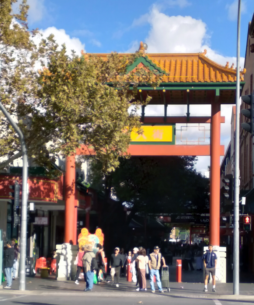

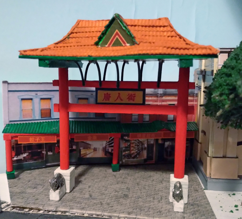

Real world copies model world - or vice versa
Wombat Creek, November 2021
Adelaide City, April 2025

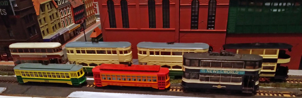

Happy Days
The chief engineer at Wombat Creek Tramways received 7 'new' trams today. They are imported from Britain (read 'from Canberra') for a very good price ($160 including freight!). They are all in working order, but they will probably be used as spare parts for more appropriate Australian trams. The double-decker to the front right could be turned into an ex-Hobart double-decker with enclosed ends. The motors from the two identical double-deckers at the back could be used under W classes from Melbourne.

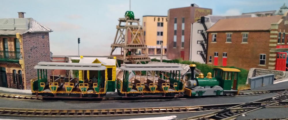

The ex-Sorrento Tram Taking Passengers
The trailers for the Baldwin tram are almost finished. Judging from old black and white photos (the tramway at Sorrento closed after Easter 1921) the bulkheads appear to be filled in with thin sheets of metal. They are difficult to do in 3D printing. Instead of trying to fill them in with thin plastic sheets I have decided the trailers will get some rolled-up blinds.
The original trailers were painted in different colours like bright red,dark red, green yellow, brown and black/dark green. I have opted for just one colour (green). I think different colours would have made the tram into an toy train from an amusement park. Instead of the colours telling the trailers apart I have numbered them 1-3.
Looking at the old photos it appears the gold lining disappeared over time. It is also unknown if the stanchions were brass (probably not, but it looks good!)
More information about the Sorrento tramways from Melbourne Tram Museum.

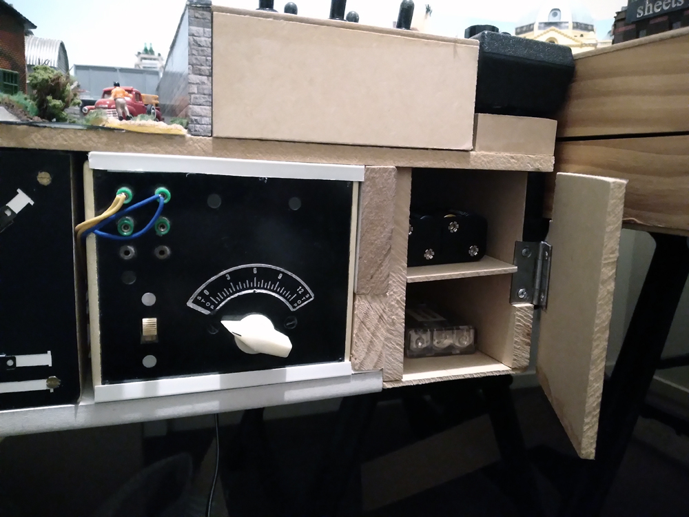

Not so glamorous work
We all tend to show photos of the trains, trams, track work buildings and landscape, but we must not forget the work going on beneath the surface.
A small cabinet has been installed at Wombat Creek. The cabinet houses batteries for traffic lights (12 V), street lights (9 V) and interior lights (4.5 V).
#292251
Any reason why batteries and not mains powered dc power supply Claus
#292253
Well!
The electronics for the traffic lights needs 'straight' 12 V DC. Rectified AC can't be used. The interior lights are LEDs from a cheap string of 'Fairy lights' from the hardware store. They come with a battery case with the necessary electronics (they can even slowly pulse). Finally the street lights are 9V, which in fact is a bit too much. Only the traffic lights will be used at running sessions. The other lights only to impress visitors. So batteries are the easiest solution.

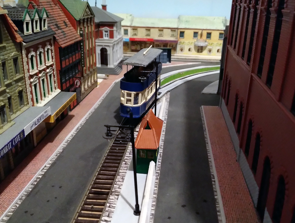

Something has to be done
Either the lampposts weren't designed for double-decker trams or double-decker trams should not be allowed into Victoria Street. A solution has to be found!
