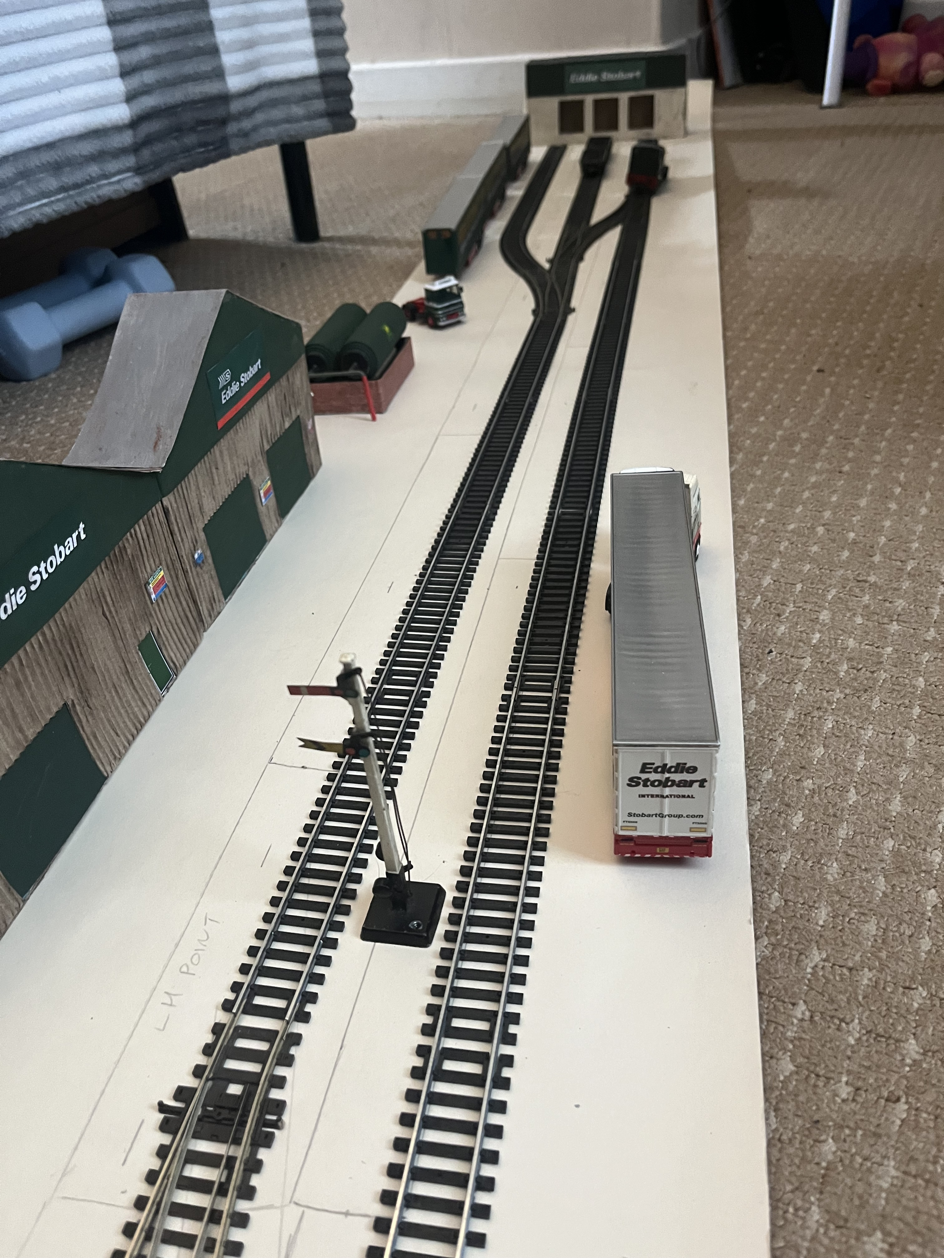

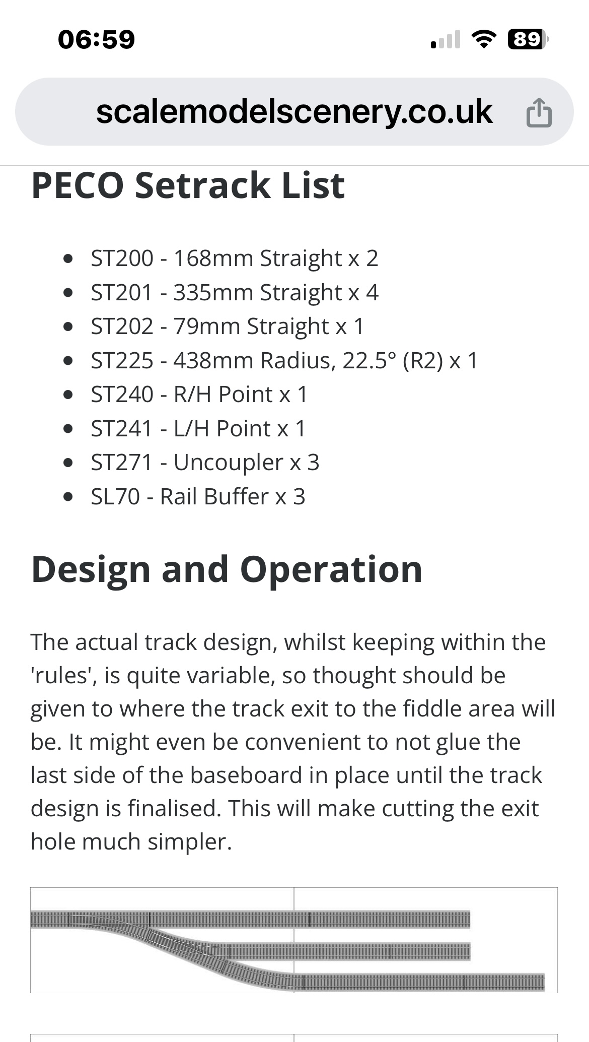

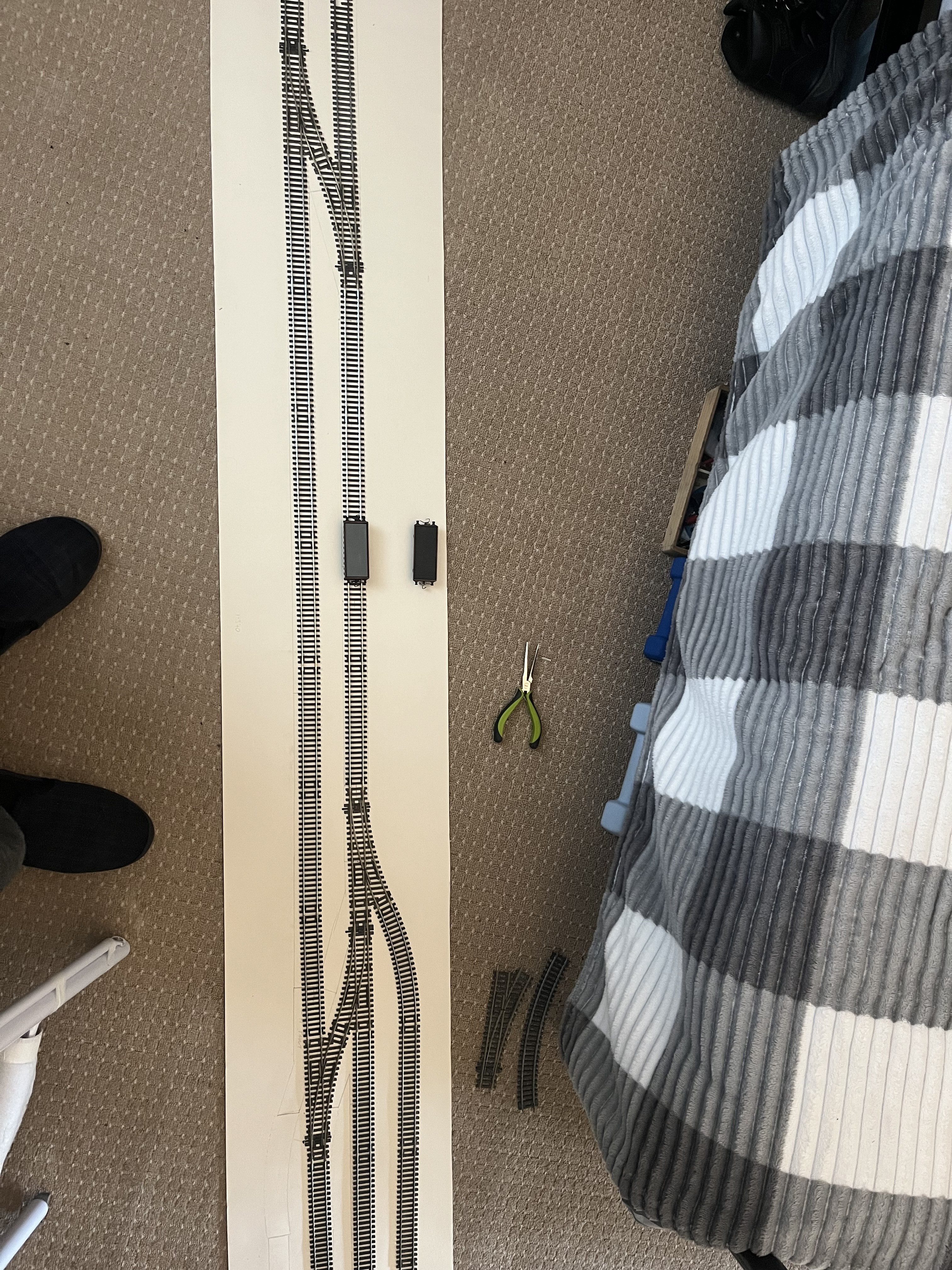

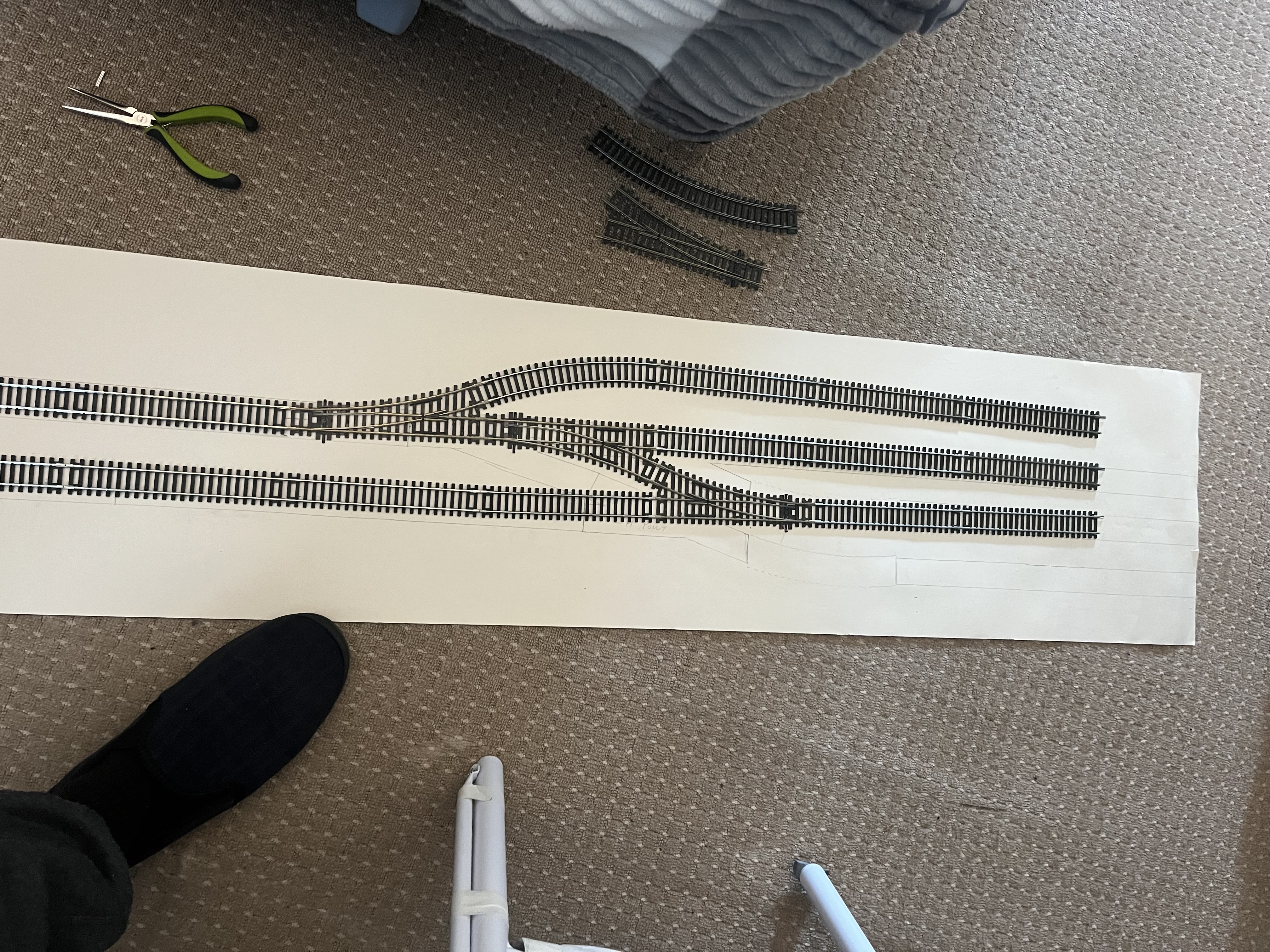

It’s for the inglenook. So to clarify I’ll be using hornby r600/601 straights. Hornby r606 curves. Peco st240/241 points. Would this give me the correct design as seen in this image ( this is peco track design in the image)
Have you looked at any track planning software such as Anyrail or Scarm they might be better than the Hornby Track Builder (which I've never used).
I know you can use Anyrail for up to 50 pieces of track for free, and think Scarm is now the same.
Might give you more ideas.
AnyRail™ - Download the latest version of the easiest model railroad planner here.
SCARM - The leading design software for model railroad layouts
Looking at the original design, the top left-hand track needs to accommodate 1 locomotive and 3 wagons. Have a look at Inglenook Sidings Shunting Puzzle before you start laying track (if you haven't already done so). Peco's design uses a fiddle yard to accommodate the loco and wagons.
Plan ahead - you may want to add another module/fiddle yard extension.

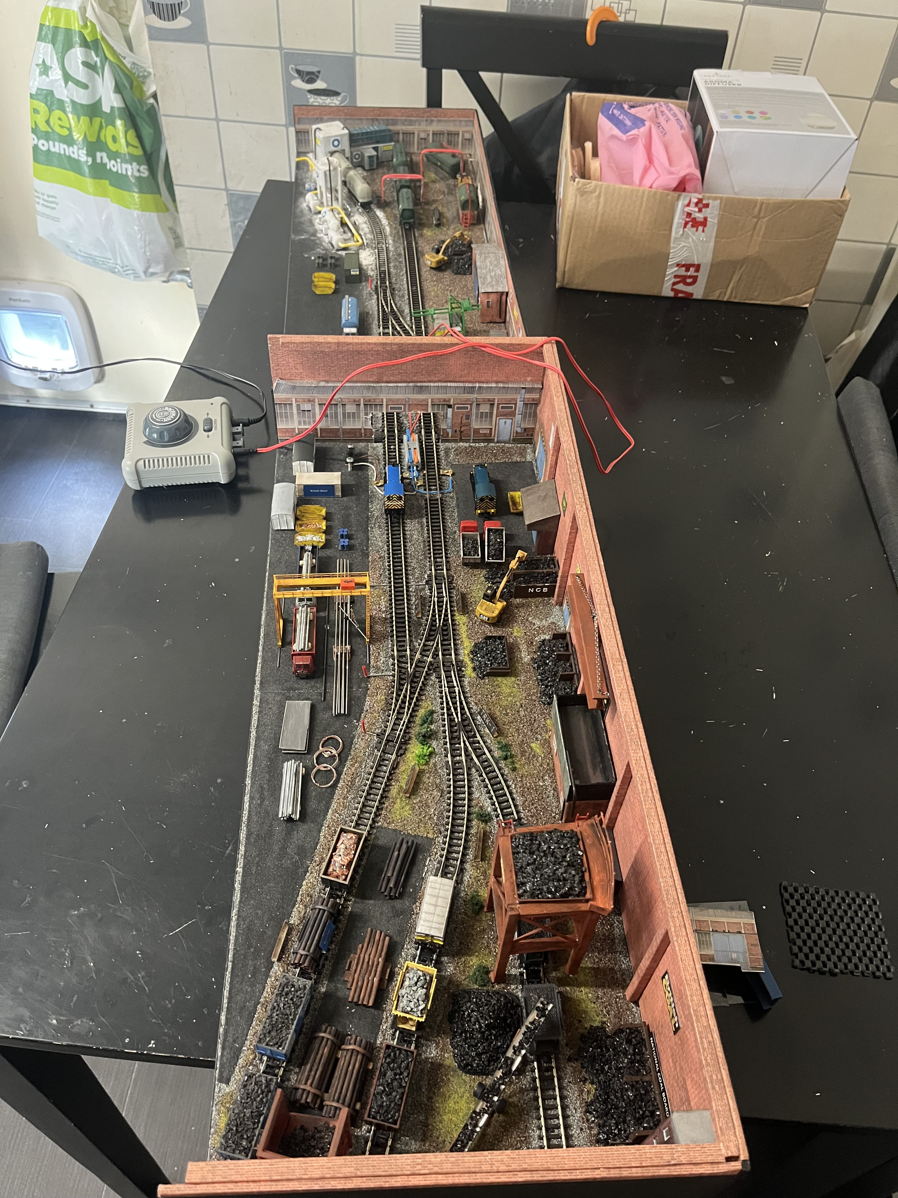

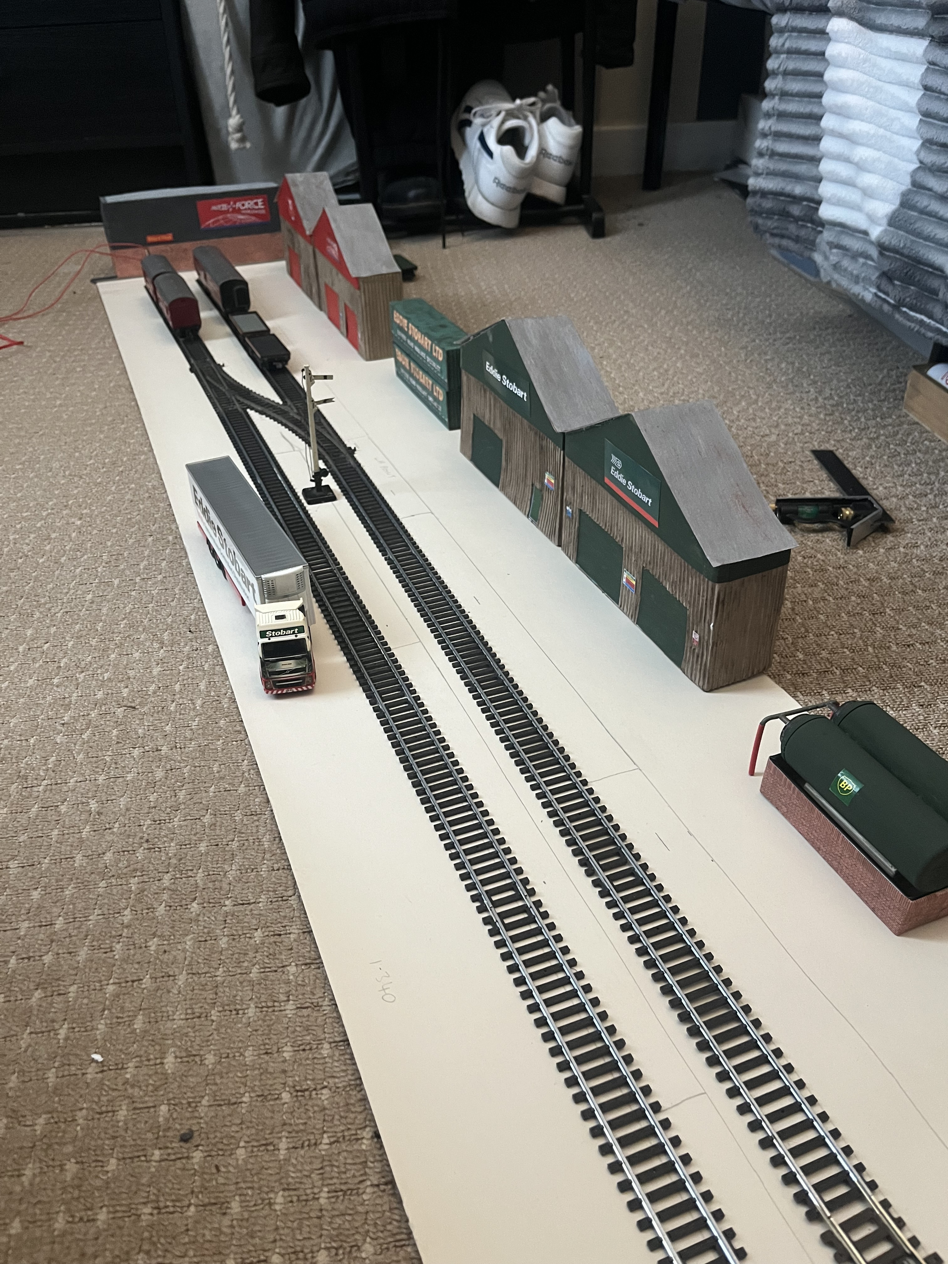

I’ve made a shunting yard in N gauge similar design. The insulfrog points direct the power to the track where the point is switched. Therefore you can isolate sidings. Just using a shunter and small wheel base wagons.

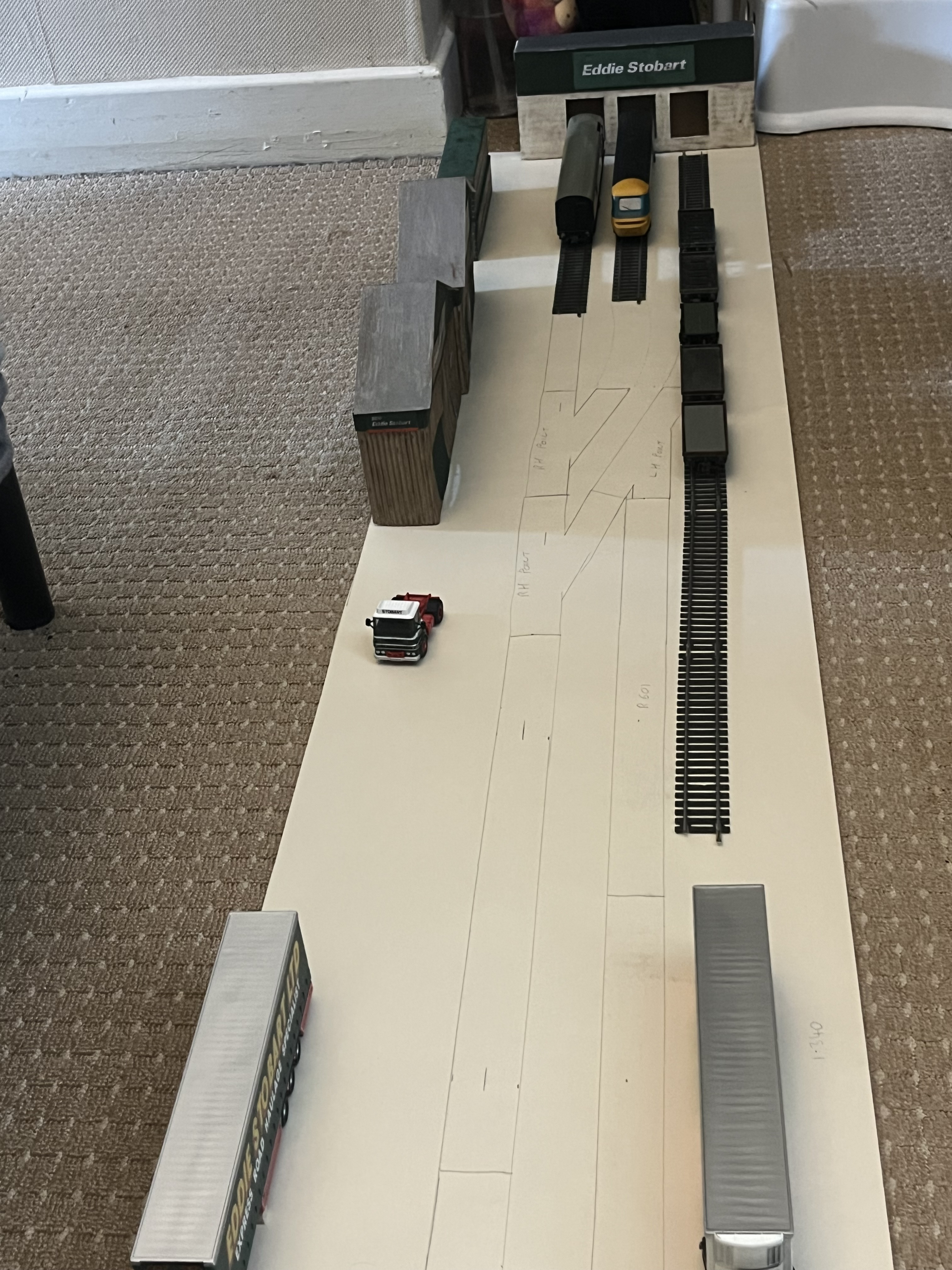

This is my n gauge yard in the image which some of you have seen before.

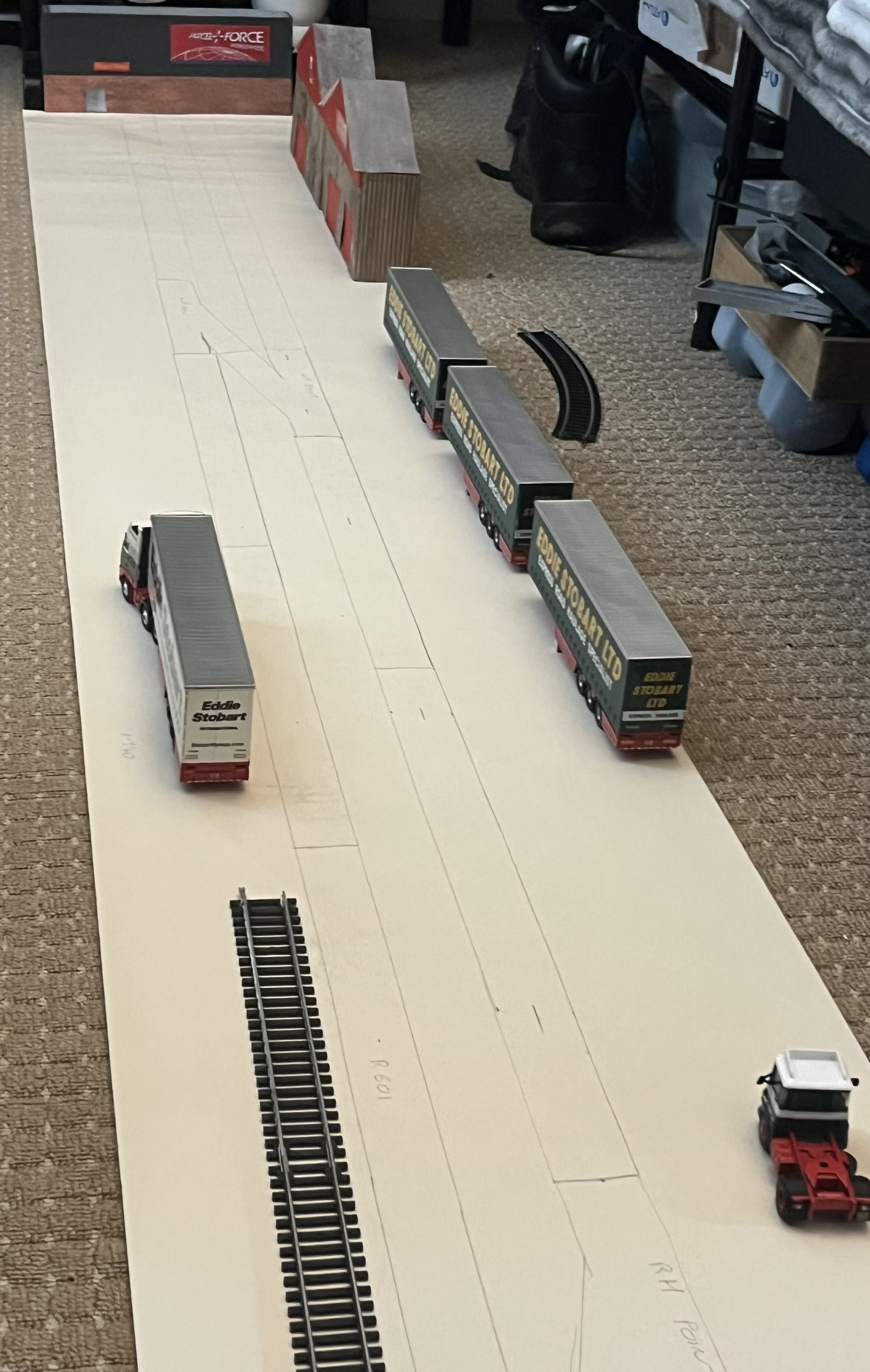

I’ve got a baseboard ( 2 pieces of 48x12 contiboard)

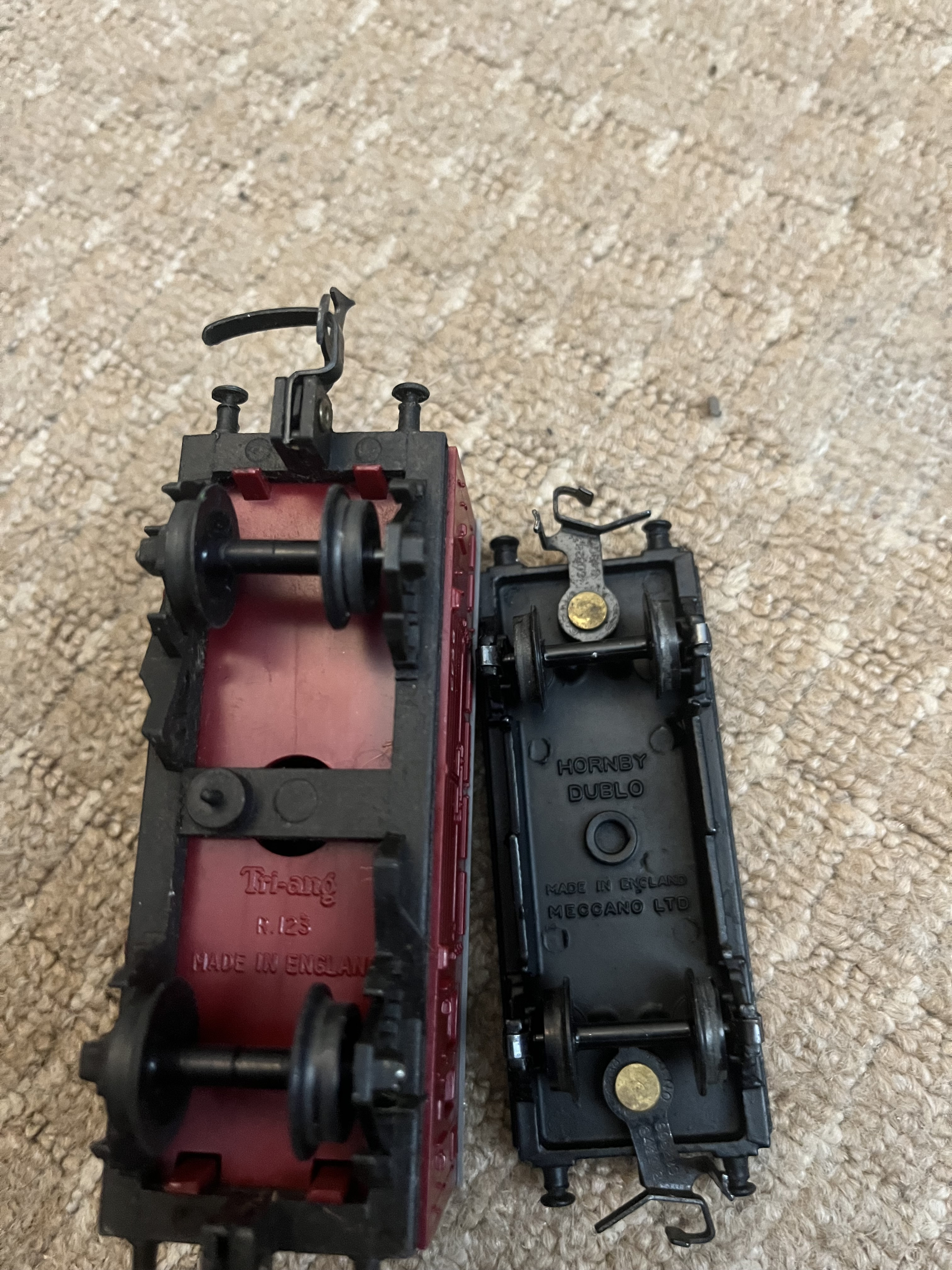

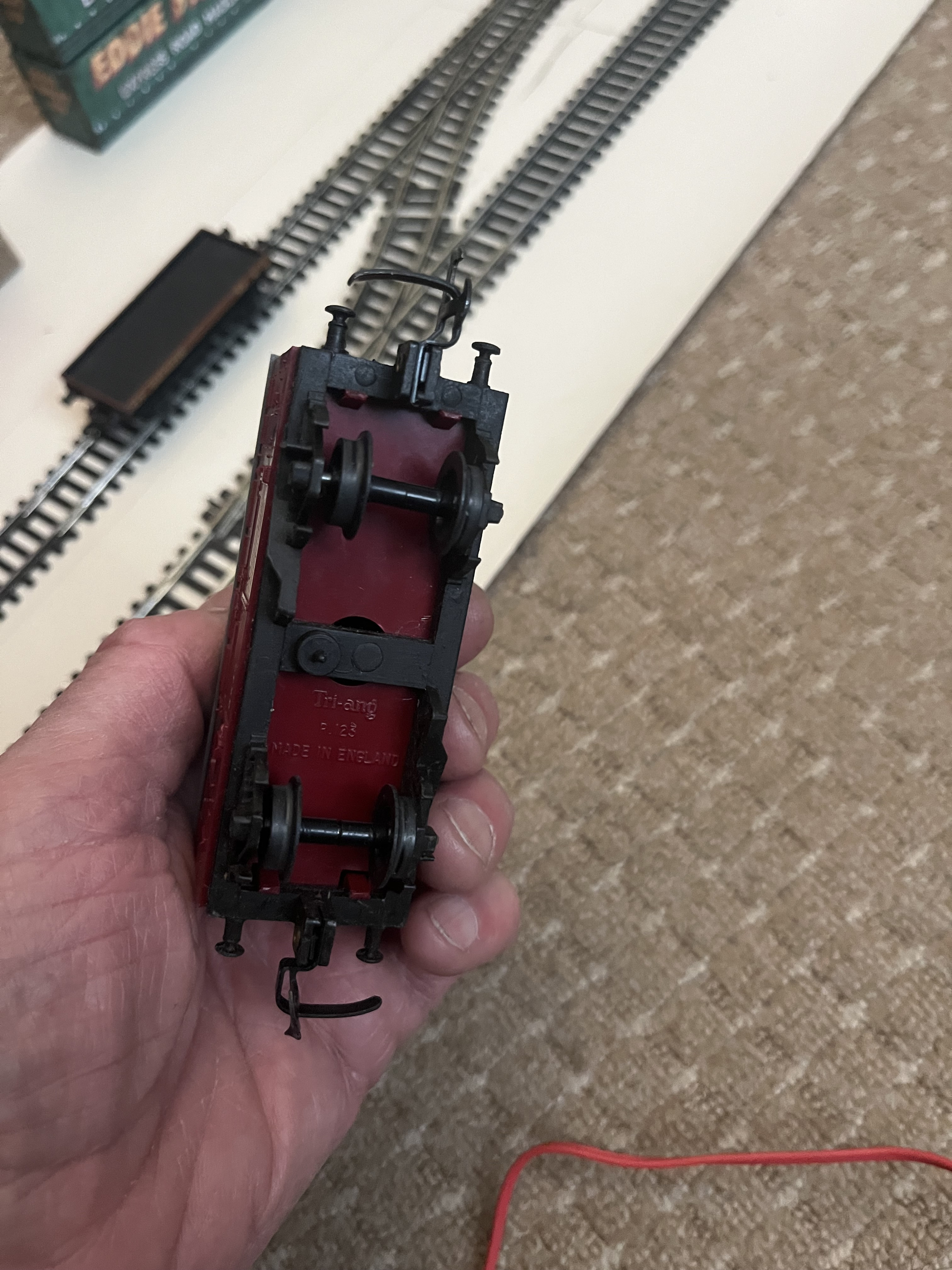

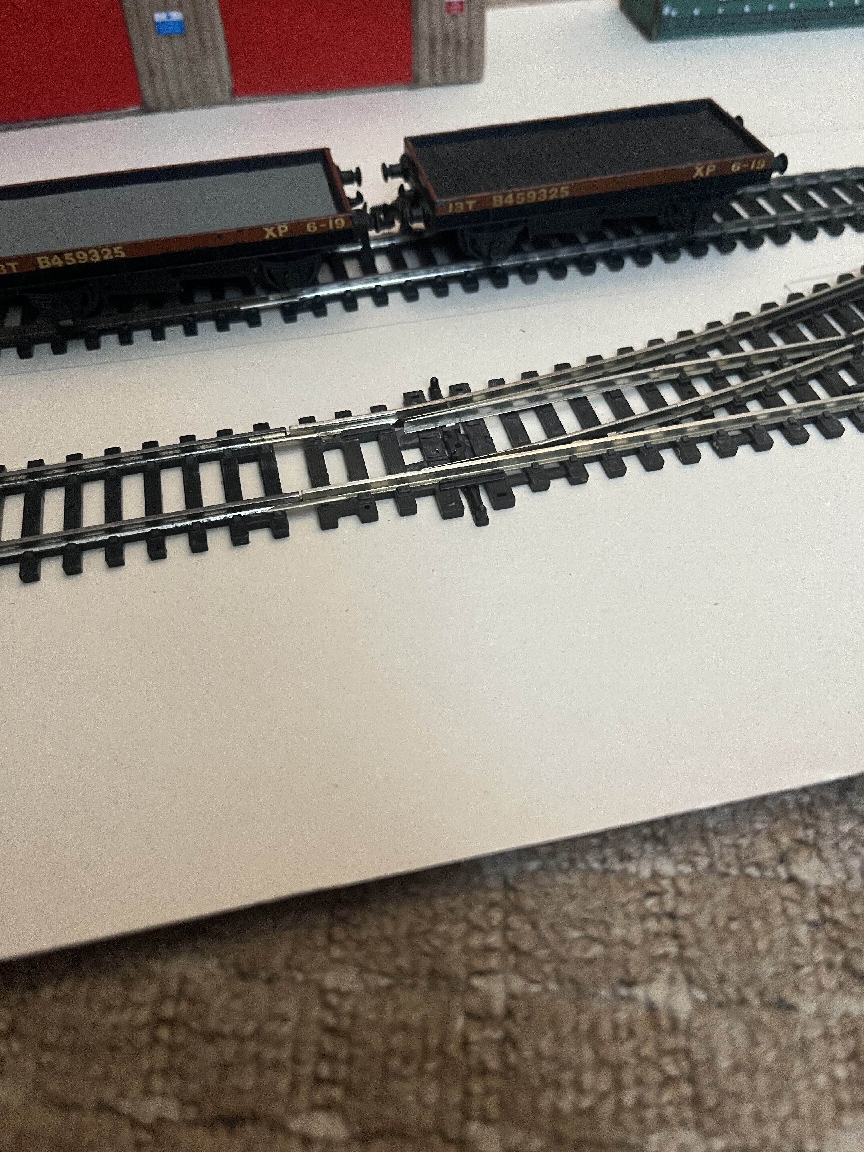

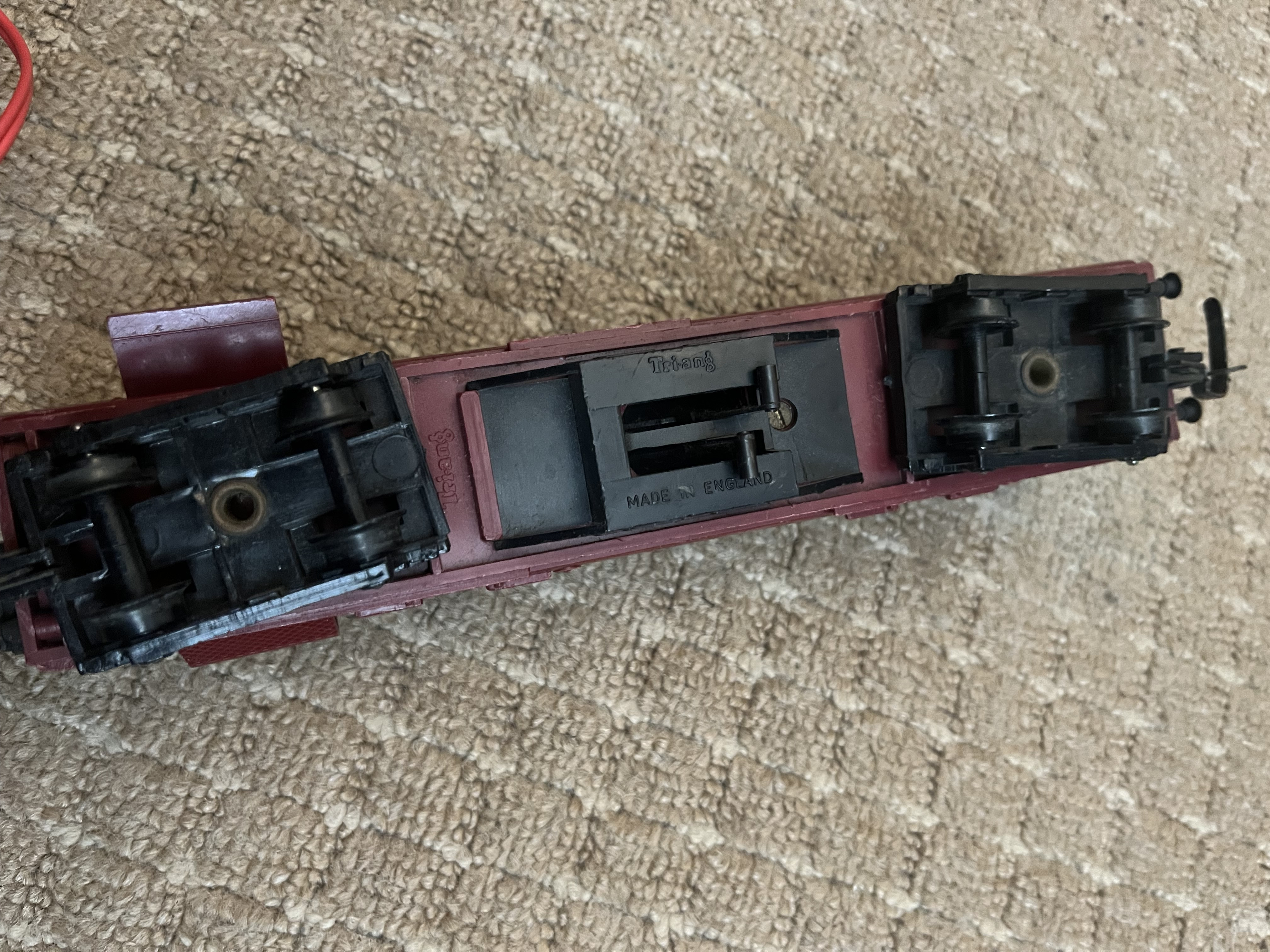

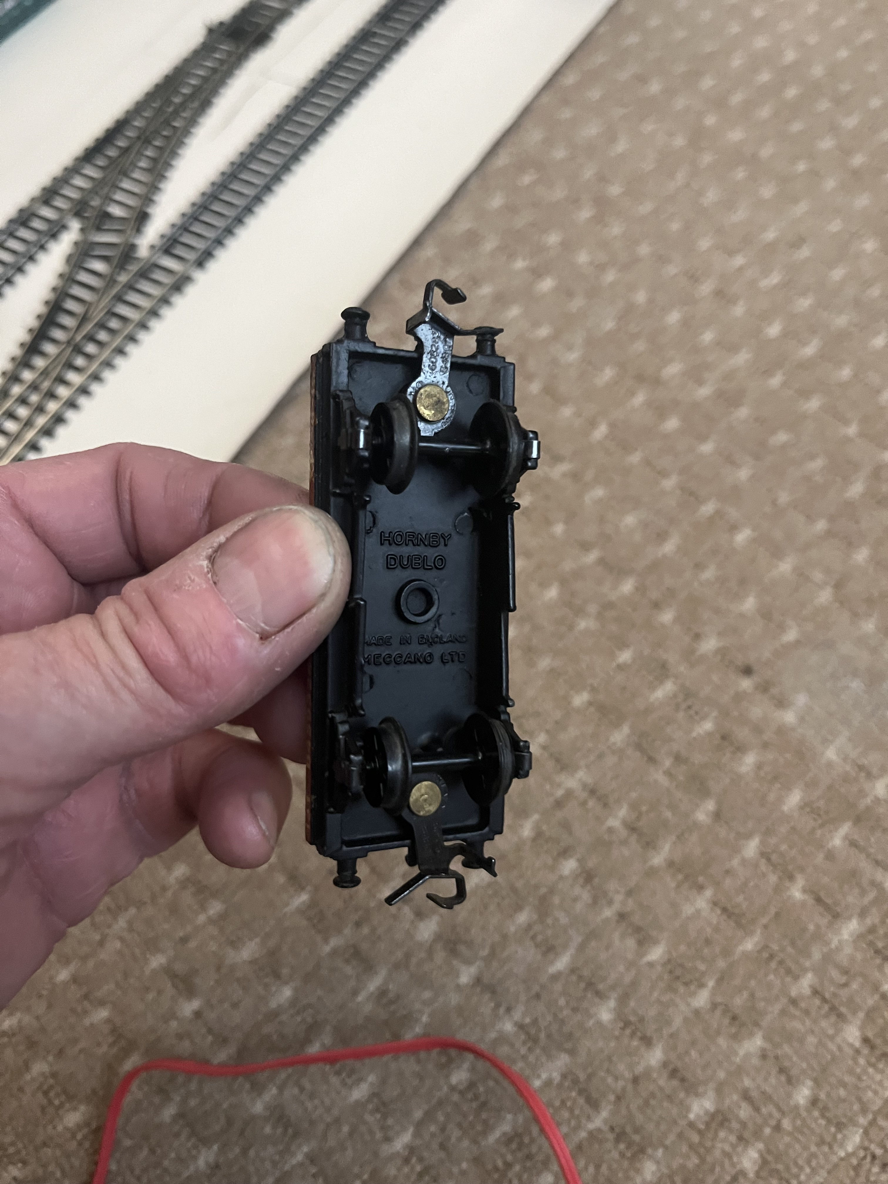

But I bought some triang wagons and a mail coach cheap on eBay ( for the mail depot) the thing is they seem not to go through the points and wheel aligners. I pushed them through by hand and the wheels seem tight through the frogs.
Are triang compatible with hornby and Peco track, the wheels seem thicker and a bigger diameter.
Check the gauge. They look way under. Triang and older Hornby are usually under-gauged. Relies on wide wheel treads to go through the frogs. The easy solution is to change the wheels for new ones. Or avoid Triang/old Hornby. There are reasons why the old stuff is cheap.
I did read somewhere that Hornby points are designed for Hornby stock. Modern, not the old.
As Nigel says, there are reasons why they are so cheap.
The couplings on the Triang wagons probably wont connect very well to more modern stuff either Gray.

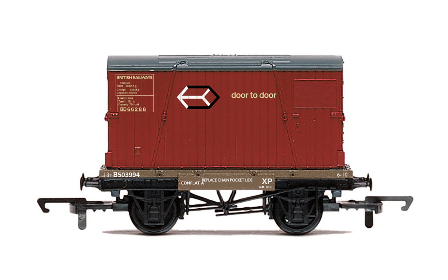

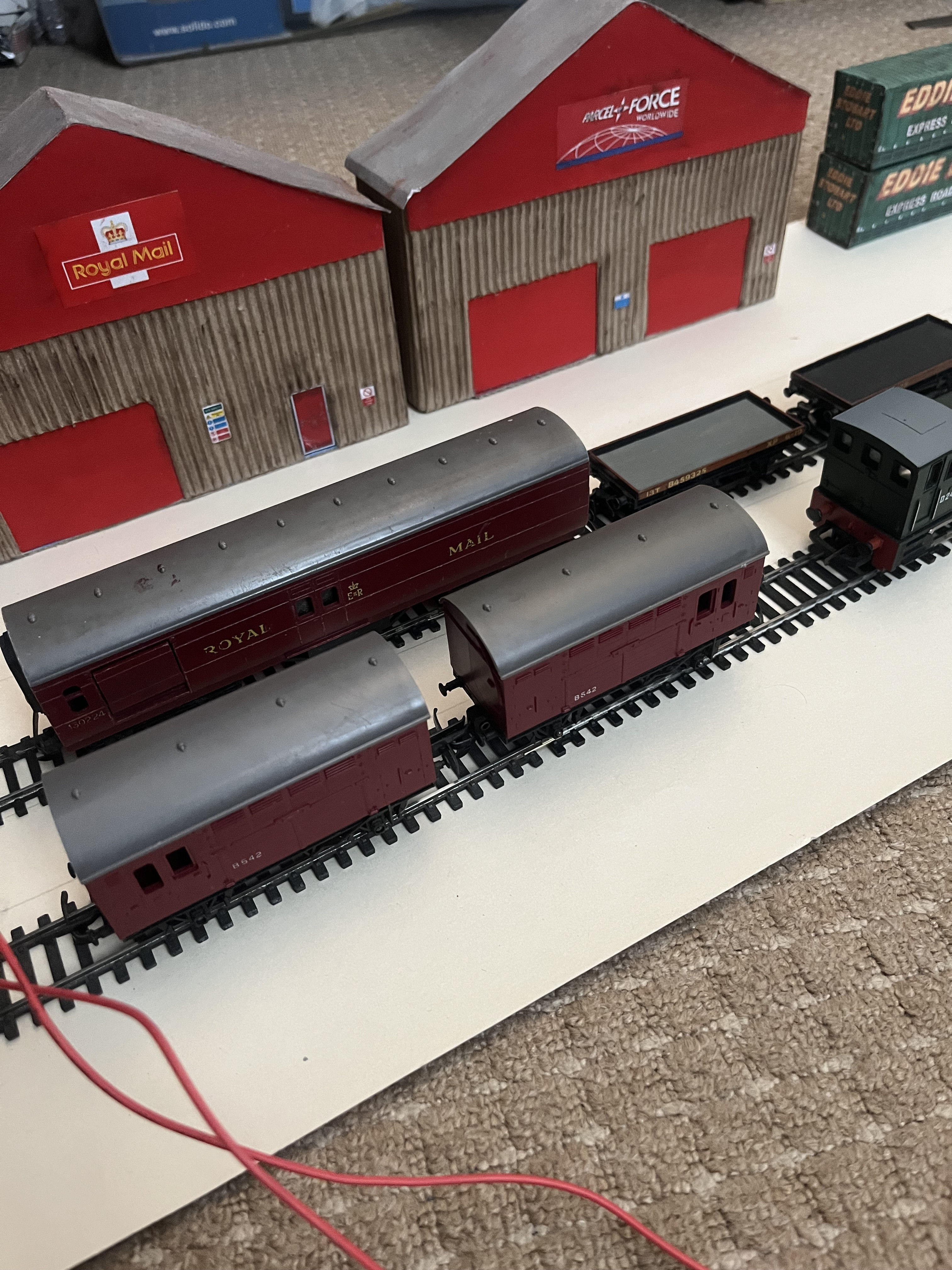

Thanks Ed. I’m not familiar with OO rolling stocK. I’ll ditch the triang unless I can change the wheels as They do fit my theme. Or I might go for something like these in the images.
Can I ask if hornby are compatible with dapol and farish etc. and do older hornby wagons couple up with the newer models.
If you cannot re-wheel them and the back-to-back check does not resolve the tightness through the frogs then those wagons might have a home as old ones dumped in a siding but never actually run.
Similarly older coupler styles were intended for the standards of their day and seldom play nice with anything recent. It can take some ingenuity to replace those old couplers otherwise keep those with the same style together rather than mixing them up.
Old wagons are often difficult when it comes to replacing the hook/loop coupler with a modern, svelte one. Or an NEM one. Or a knuckle Kadee. Where possible go for modern wagons. Unless you like updating them. I do, but I am selective in what I buy. I've got a box full of 1960s vintage wagons that are impossible to update. I have a couple sitting on flat bed trucks on their way to the repair shop, plus a couple of flat beds with just the body serving as a container. Bodies were often used as crew facilities. The branch line to Fairford had a horse box body just off the turntable as the loco crew break room/office.
