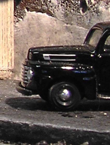

I found chalks didn't take on high gloss cars. The method I like is to repaint the car with enamel paint - either matching the original colour or with something new - then while the enamel is still slightly tacky I rub powdered pastel all over it. I used pale brown here.  Greys work well too.
This is the only view of it in its original state that I have [cropped from the edge of a photo]
 It is a cheap model though.

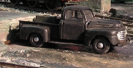

I use washes to give the base colours - normally working wet in wet.  Usually once its dry I spend just as long carefully cleaning it all off again.  No matter how hard you try you cant clean it all and you tend to get dirt left in places you cant reach, most of the time this is the same as on the real thing.  As always, work from a photo of the prototype.
Heres a couple of mine - These are particularly grubby examples.
I always spray road vehicles with Dullcote or this http://shop.warlordgam…tt-varnish-spray-37-p.asp
