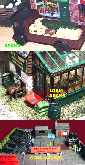

Bin bags, flour sacks, coal sacks, grain sacks etc., are easy to make with Milliput.
Just roll into an appropriate sized sausage and cut to suit.
Often that's enough to do the trick but, if not, some poking with a cocktail stick or similar will soon push it into shape.
I may have pics of previous work - I'll go and look.

Here's a few:
