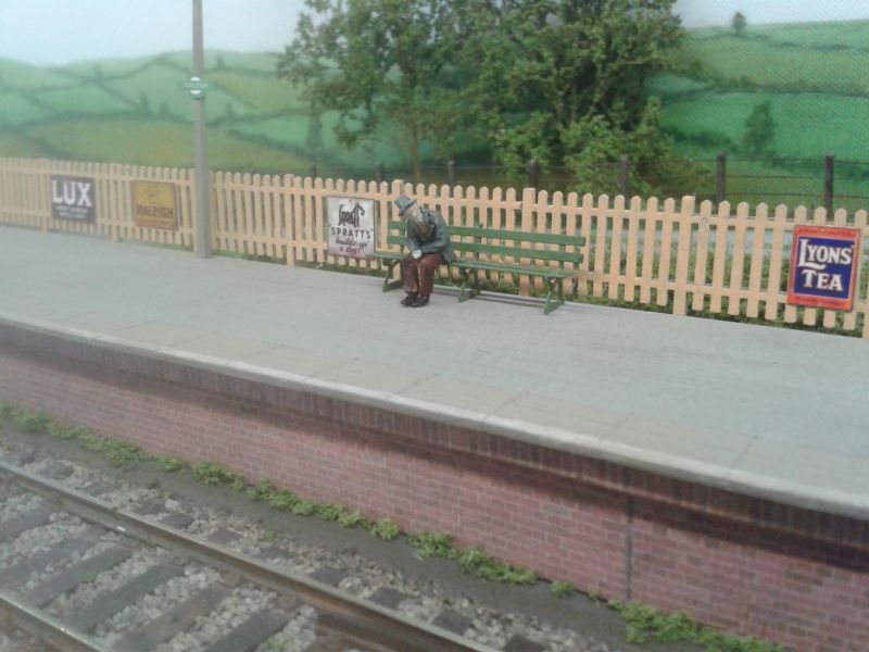

The layout is at the rather enjoyable stage where I can indulge myself in adding the fine detail.  All that virgin platform fencing was simply crying out for some decoration.  Out came the beautiful enamelled advertising signs from Sankey Scenics…
A general view of the station…
You might remember that way back in this thread I made some removable coal heaps for the rear siding.  It has been bugging me for some time that the general look of the siding and adjacent yard did not reflect the fact that coal was being unloaded here.  That has now been put right using black acrylic paint…
There is still more work to do in this part of the goods yard.  I might add come real coal to the ballast and ground surface, although the coal heaps do need to sit on a flat surface.  I have got to think about sourcing or making some coal scales.  The rather coarse trade offerings seen so far do not fit the bill I'm afraid.
More soon.

Herewith a couple of pictures which I forgot to post a few days ago.  Once again the signs are from the superb Sankey Scenics range.  Usual disclaimer.
Sorry - I can't seem to get the last photo to sit vertically.  Can anyone help please?
Terry.                            Sorted. B
#257001
Can't help with rotating the photo, but those signs certainly look good.

I decided that it was time to get some people on to the platform.  All figures from Dart Castings.  Painted by me yesterday in rather muted acrylic colours.
More soon.
Last edit: by col.stephens
#257271
It's all looking most authentic, Terry, and your figure painting is superb.
#257272
Thank you Michael, very kind of you.
#257278
That looks really nice. As Michael said, the figures you are painted are brilliant. You must have some rather steady fingers.
