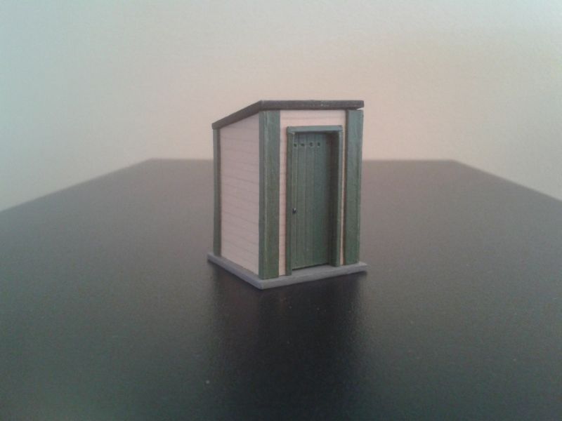

I'm not sure if this building is often modelled, but I caught sight of it in the background of the photograph of Adversane Crossing signal box.  My Lords, Ladies and Gentleman, I give you…the signalman's privy…
As usual, made from mount board (1mm thick), postcard door and corners with a Peco track pin as a door knob.  Scalescenes' papers for the clapboard and slate roof. Painted with thinned acrylics.
Just some slight weathering required using watercolour paints. The base is a square measuring just 24mm.

It's amazing what one can fit into a square inch and I feel sorry for so many 4mm signalmen who's company directors gave never a thought to their comfort.
Thank goodness you modelled it with the door closed!

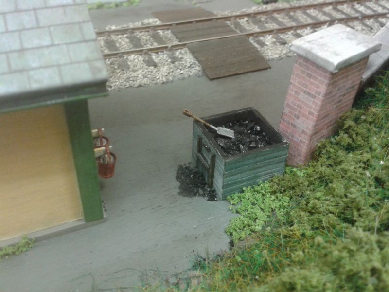

Continuing the saga of Farleigh signal box.  I observed this in a photo in the book previously mentioned,  hiding under the stairs of a Southern signal box.  Modelled in card with Scalescenes' clapboard paper.  Measuring just 16mm x 16mm.  Somewhere for the signalman to keep his coal.  Just needs topping-up with coal and a handy shovel nearby.

I finally decided on the positioning of the coal bins and coal office.  The bins are situated as per the original article in the Railway Modeller.  I have moved the coal office forward adjacent to the track from its original position against the backscene.  Models from Scalescenes.  Coal from layers of black carbonaceous rock consisting of layers of partially decomposed vegetation deposited in the Carboniferous period!  Oh yes, and hit hard with a hammer!

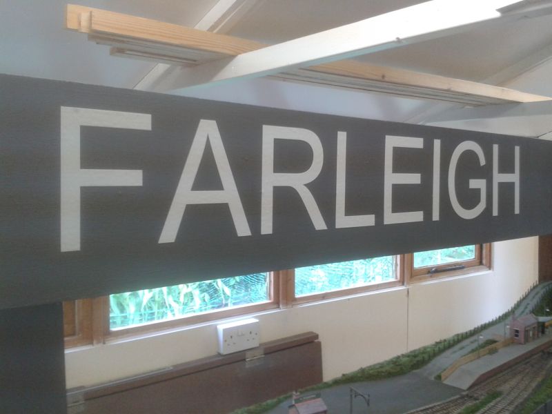

I am tempted to say that I hand painted this very professional looking lettering, but I didn't.  These are 100mm high self-adhesive vinyl letters, obtained from ebay for just over £6. Delivered in three days!  Applied in about sixty seconds.  When ordering, I typed the eight letters in the correct order - F A R L E I G H - .and they arrived in that format, correctly spaced, sandwiched between two pieces paper.  It was a simple job to remove the backing paper, revealing the sticky backs of the letters, pull the front paper taught, and position the complete word, rub down the letters and gently remove the front paper. A bit like giant Letraset (for the older members present).  I gave the entire facia a coat of matt varnish just to ensure the letters don't peel off at sometime in the future.
