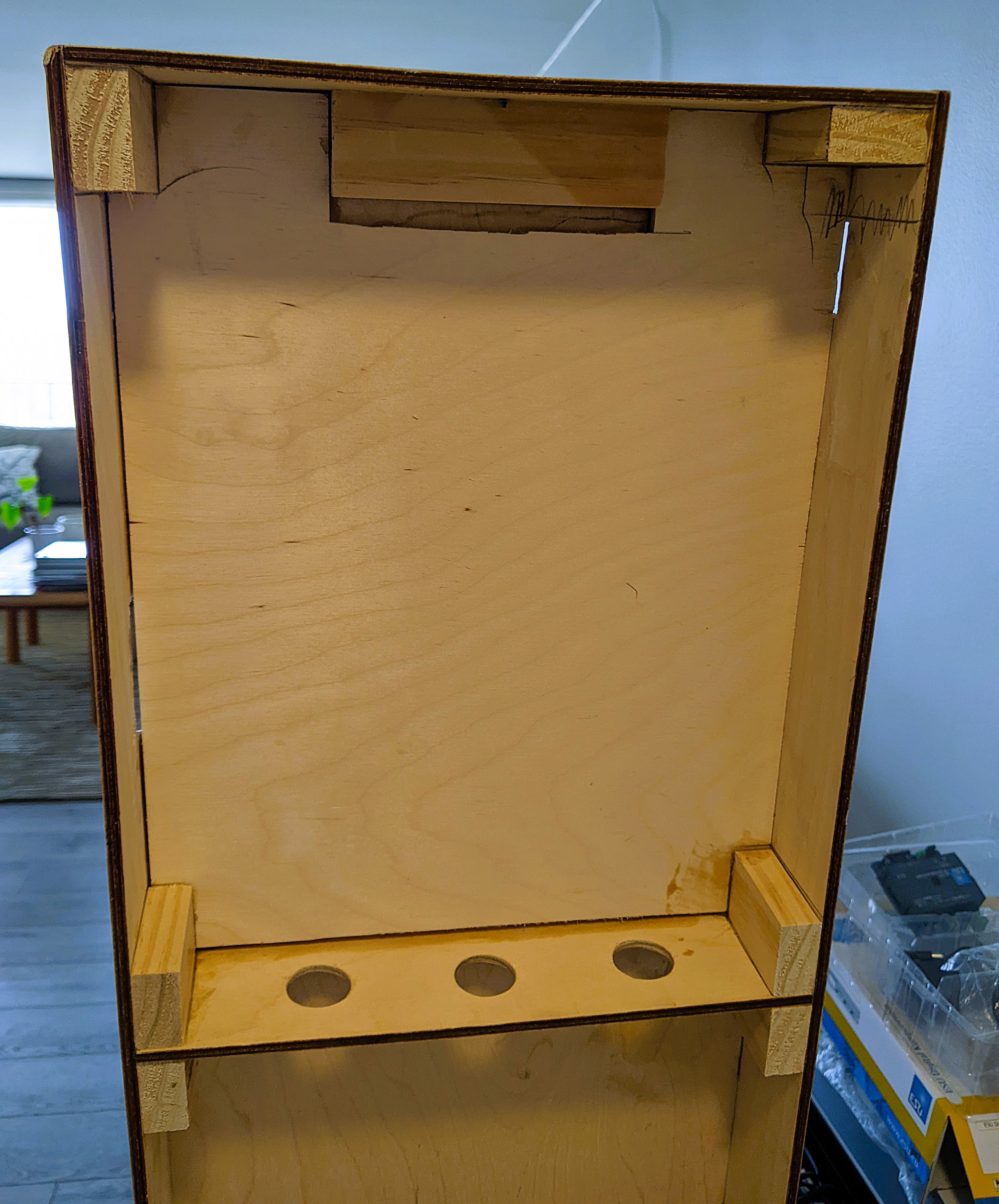

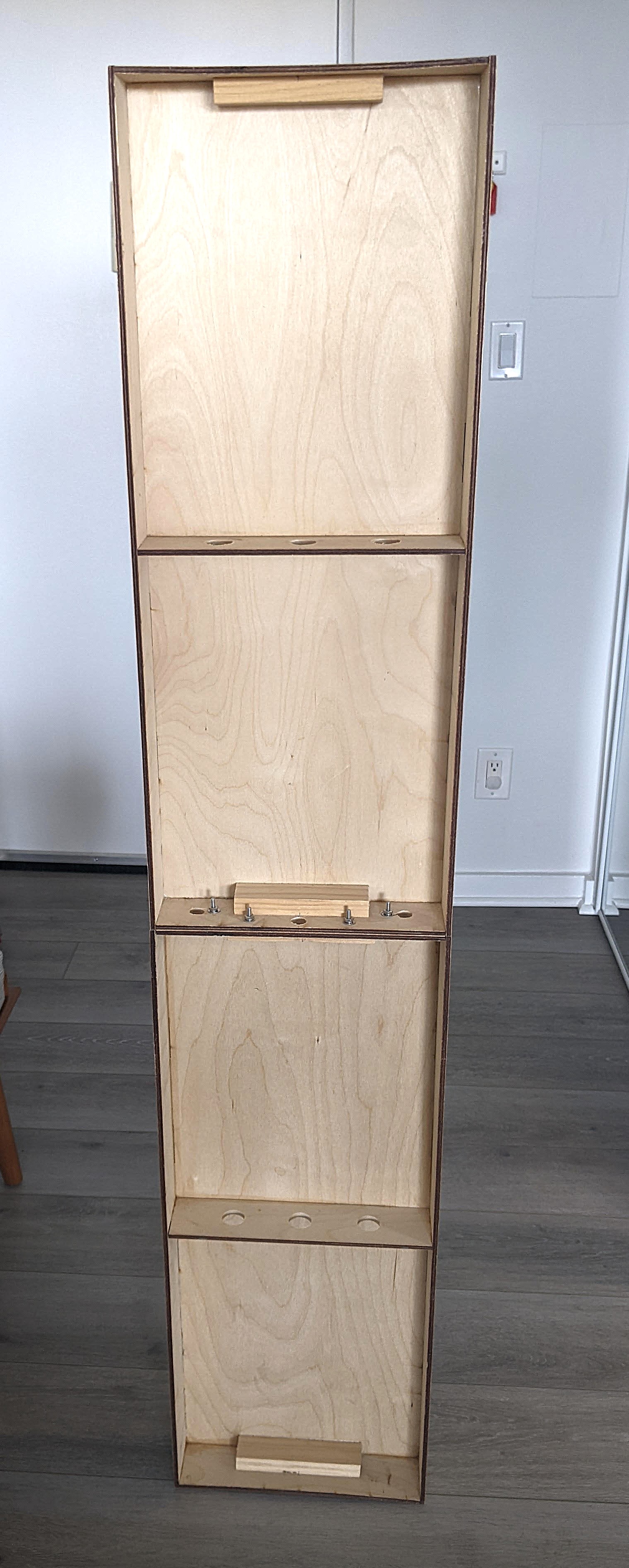

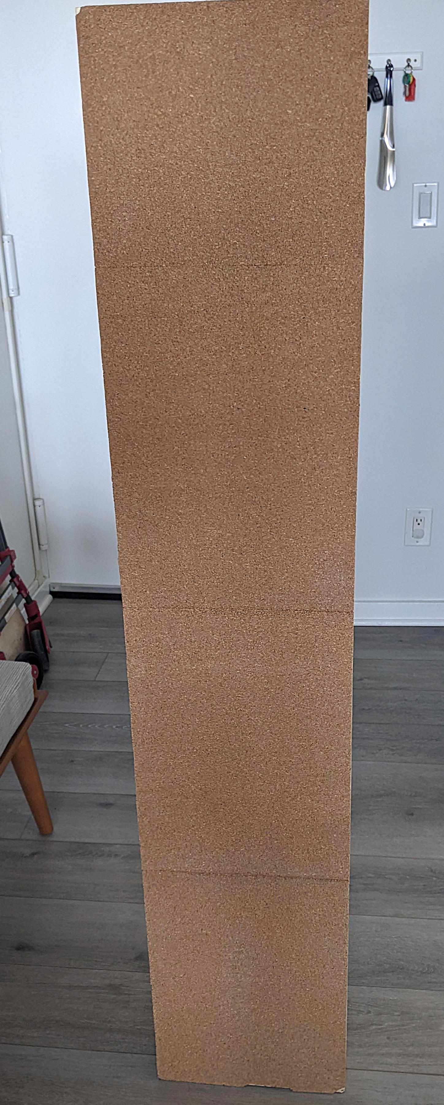

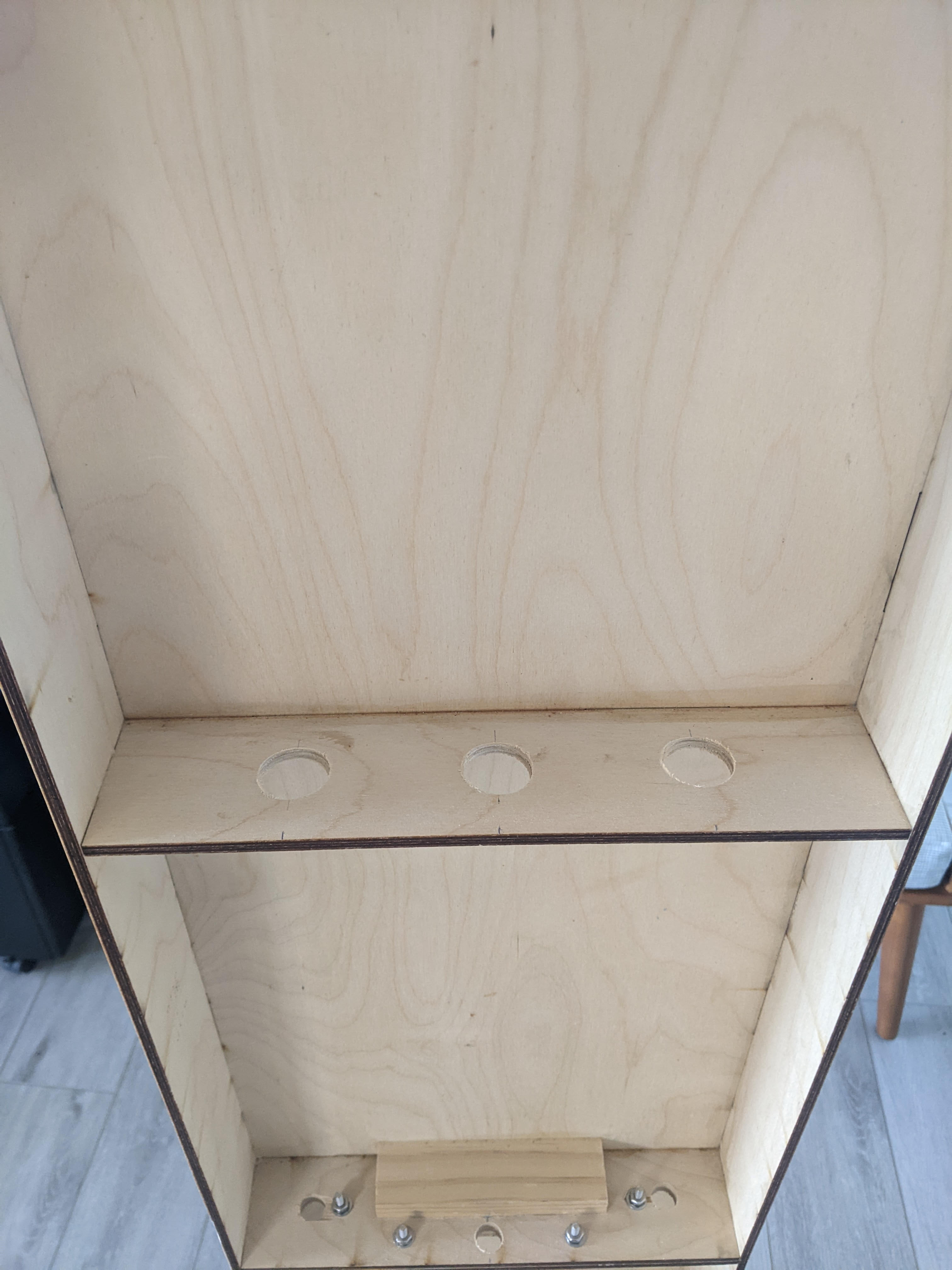

All this N-scale locomotive restoration and rejuvination I'm currently into prompted me to get the 2 modules I constructed for HO use out of storage. Each one measures 5 x 1 foot, composed of two 2.5 x 1 foot submodules, and they can be joined lengthways (10 x 1 feet) or sideways (5 x 2 feet).  They are made of 6mm Baltic Birch, laser cut, with tenon joints, 15" centers.  Holes for cables, wiring. Ends reinforced for C or D clamps. No screws or dowels. One of them fits nicely on an ironng board, which saves the hassle of building legs or base-units. The 2 modules are stored in a walk-in closet (cupboard) when not in storage. The photos below show the better looking of the 2, the other needs a bit of work as one end has a stream bed that will need removing. The tops are covered in 2mm cork placemats from Ikea, no longer available, but I have a few unused left.

First job is to get the second module into the woodworking shop and do some refurbishment. Pictures below of the first module.

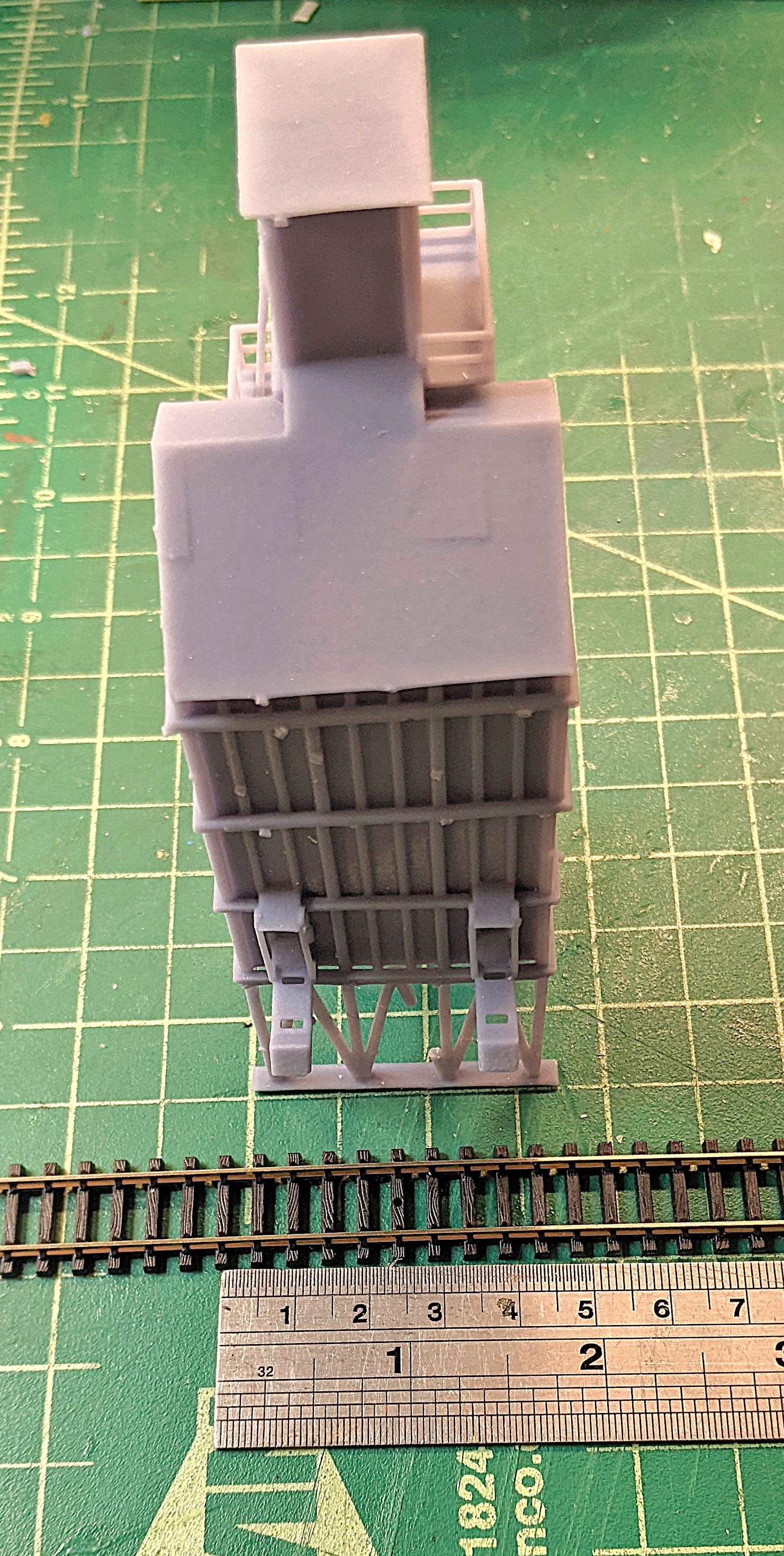

I have one ready to put together. The footprint is around 5 x 5 cm. Two together across the tracks are around 5 x 17 cm. I found a later photograph (1936) showing only one tipple serving both mainline tracks, with a water stand opposite the tipple. The Southern used a pair of ALCO diesels on this route in 1941 when there were plenty of steam passenger trains around. The Southern was not 100% diesel-powered until 1953, so an E6 or even an E7A would not be out of place. Models of the ALCOs in N scale are around. There were two tipple loading tracks, one for full coal cars and the other for empties. Logically the Stearns coal facility would be supplying the coal, and shunting the coal cars around. If I use just one tipple it's one for home, one for away. Should make an interesting cameo.

Hi All,

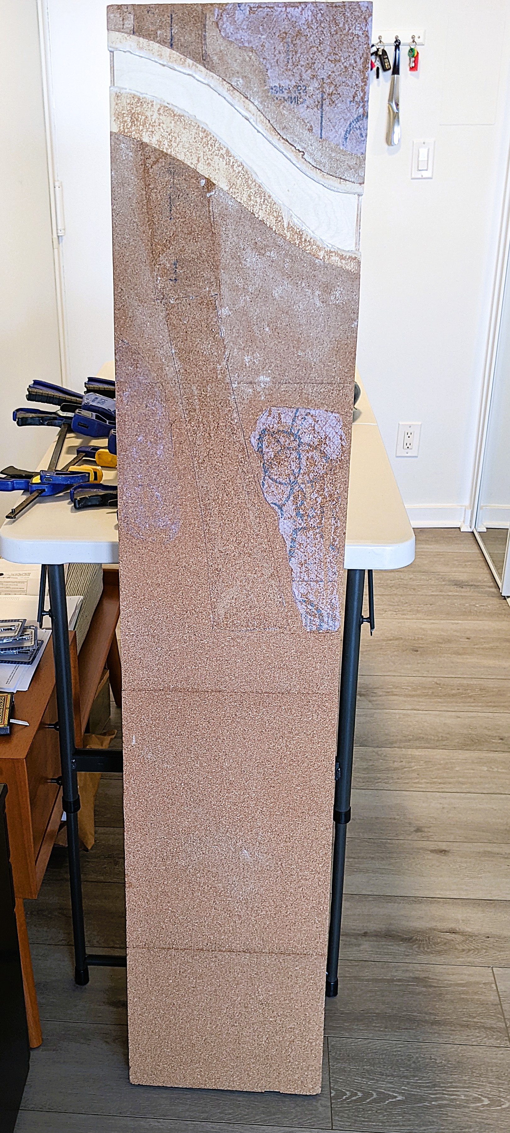

I retrieved the second baseboard from storage, and spent yesterday at the community woodworking shop doing some refurbishment.  I had originally planned on a crossing over a small stream, I removed the HD closed cell foam and plaster cloth I had used, and replaced them with a single sheet of Baltic Birch underneath. I now have a shallow river some 35-65 mm wide and 5 mm deep - 17.5-32 feet wide and 2.5 feet deep not counting the banks. The cork is a bit worn, but basically sound. You can see where there were HD closed cell foam scenic hills and a second layer of cork as track bed. I also reinforced the frame corners inside with some 1 x 2 inch wood. One corner had failed glue, I sanded and re-glued.
So, a blank canvas 10 feet long and 1 foot wide. Track and turnouts to order after I come up with a layout plan. I currently have enough code 55 for 1 line and no turnouts. I was contemplating whether to have a decent river and gorge. Methinks a separate module 1.5 foot long x 1 foot wide with a decent depth of say 50-60 scale feet (100-120 mm). Need to look at a "drop module" design for this. [I'm using 2mm = 1 foot, actual in 1:160 is 1.9mm = 1 foot].
PS. The black lines are not marker pens - they are from the insulating foam - Pink Panther brand.
