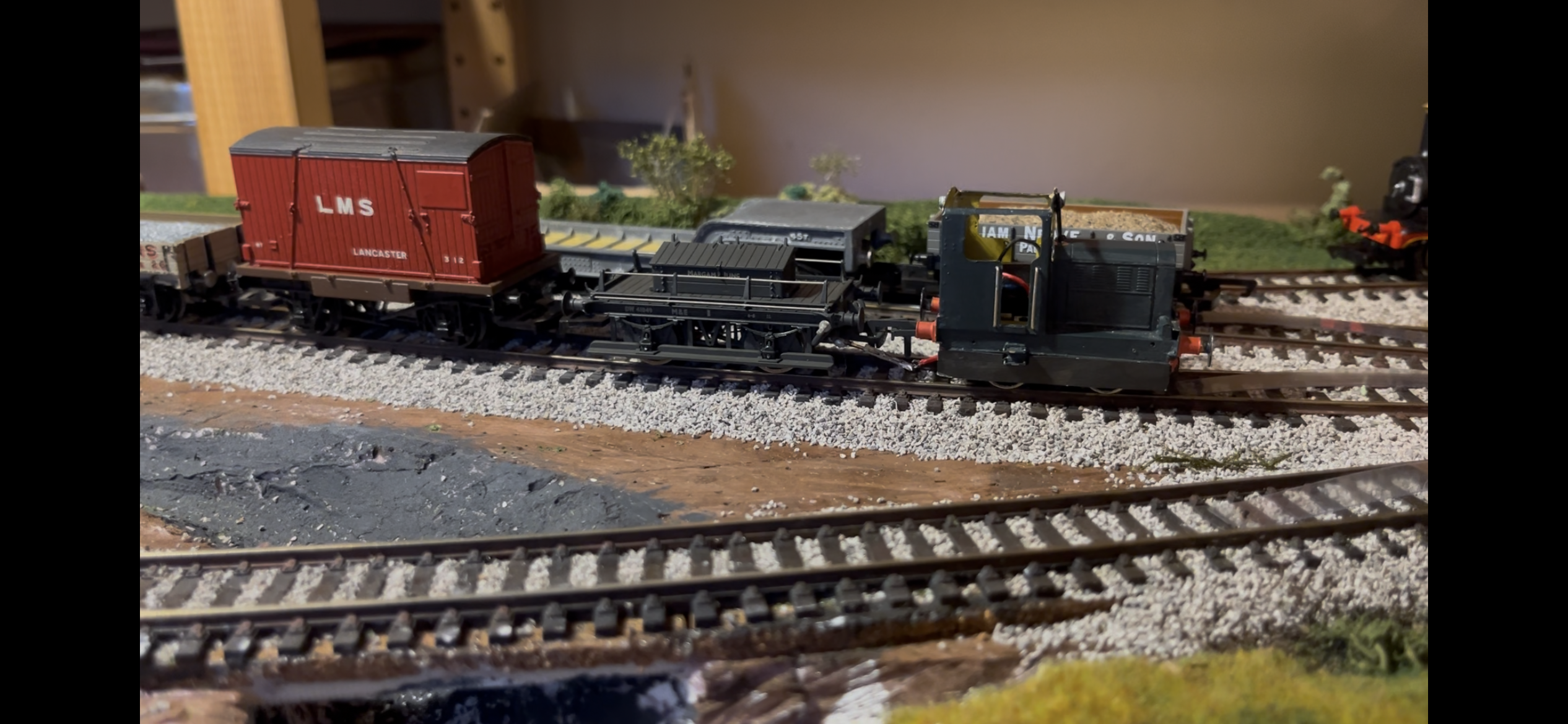

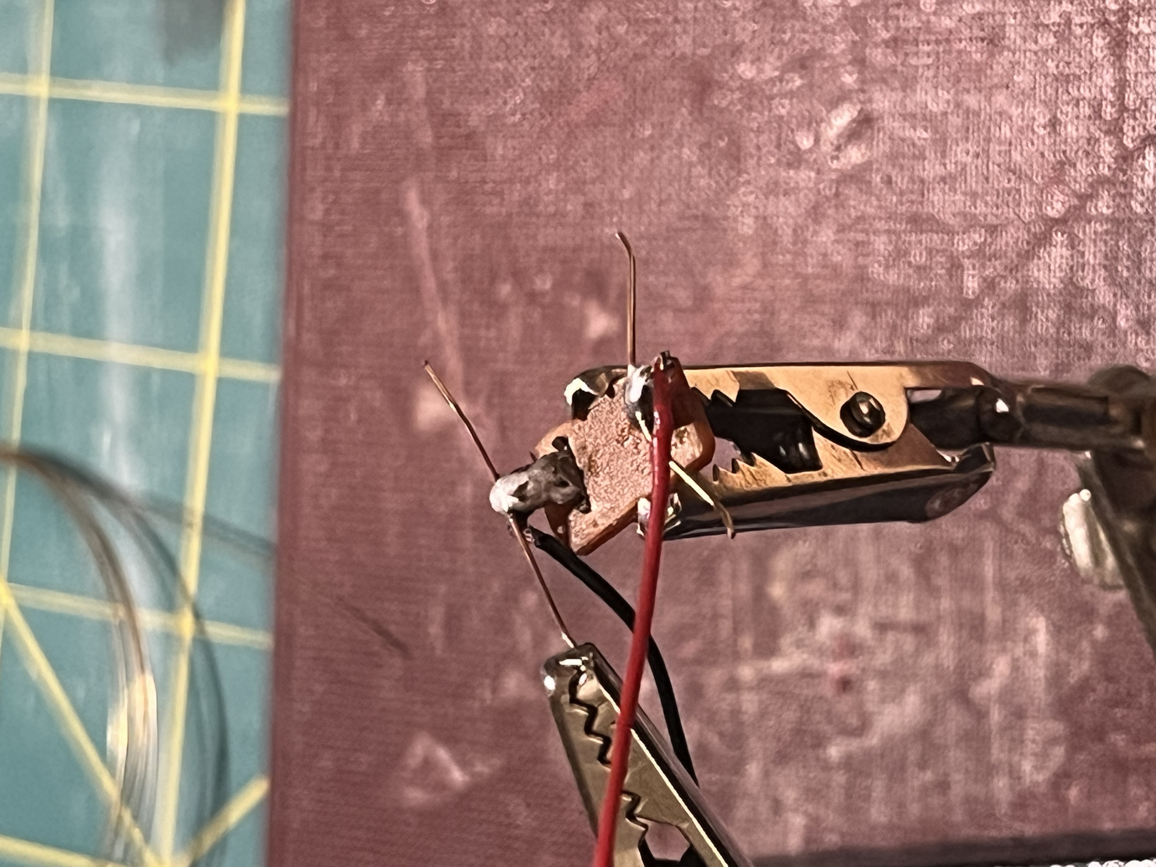

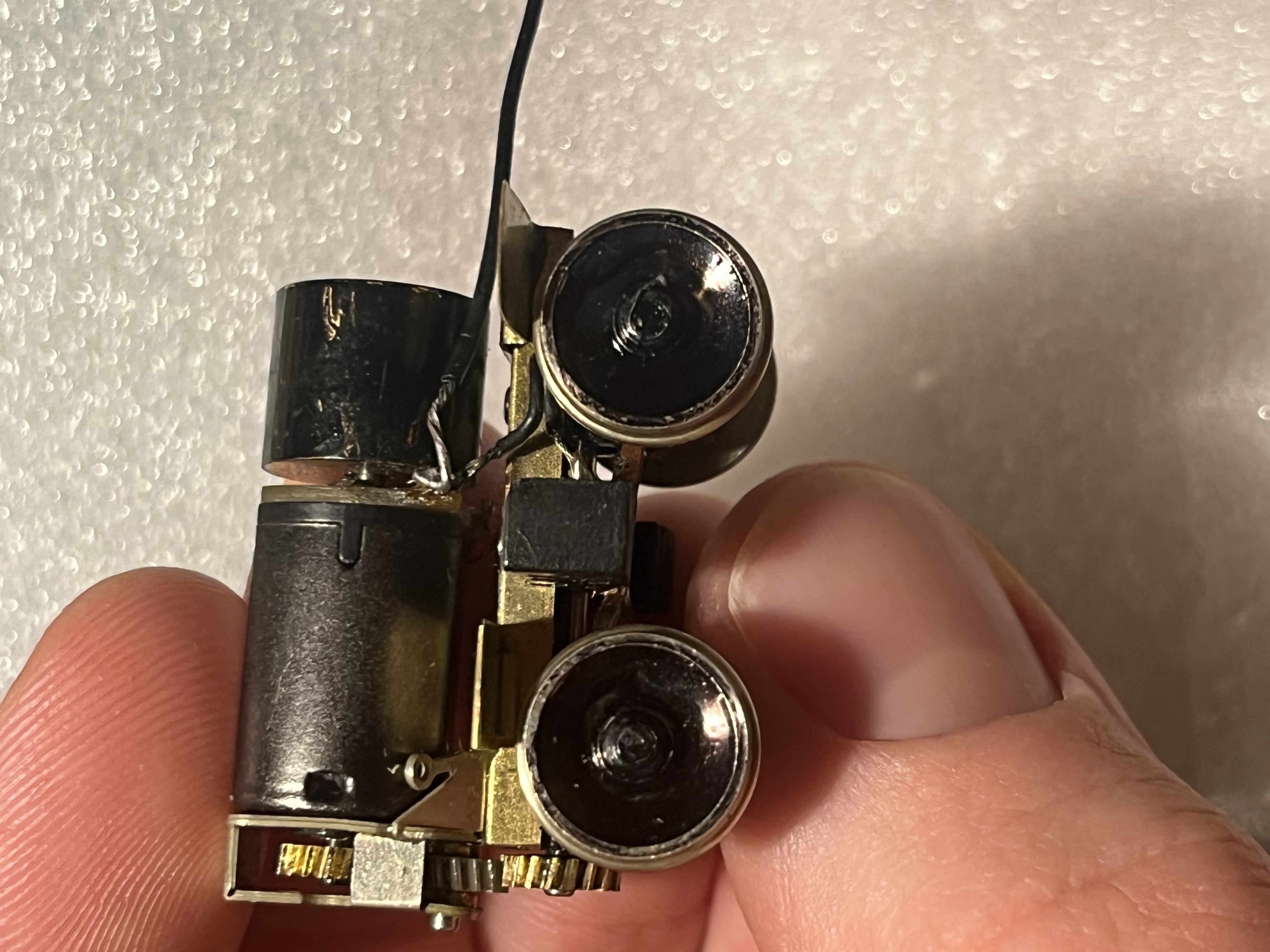

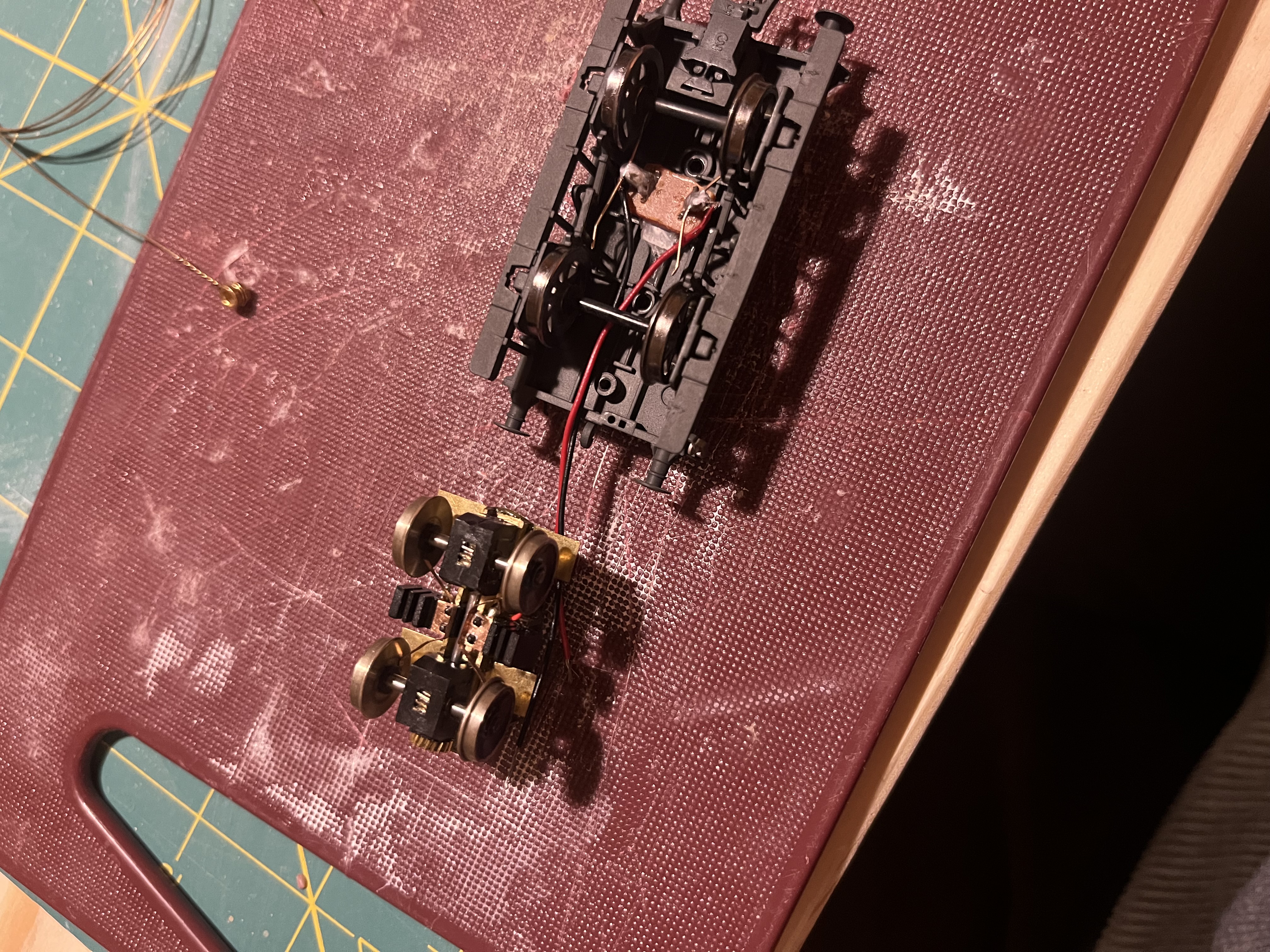

I actually got a little frustrated with the scenery not looking as perfect as I wanted, so I decided to attempt something else for a bit. I thought I’d attempt to wire the pickup wagon to my kit built Ruston, which is too small to pickup power over points.   Using only guitar strings and parts from that computer I found on the sidewalk (😂), I set something up and so far it works pretty well. I have not enjoyed soldering and I had a really hard time soldering my pickups to the track, but somehow this went ok. The biggest challenge here was bending the pickups to touch the wheels but not apply too much pressure. I’m still not sure if all four wheels are working.
after soldering the extra pickups to the chassis, the chassis didn’t fit into the body anymore, so I filed it down a little bit, but then the chassis was shorting out the motor. No problem, I borrowed my wife’s nail polish and that insulated everything.
I tried to put captions between images but it didn’t work… but you can figure it all out.
My wires a touch messy, and I need to do some cosmetic things like reattach the roof and a front coupling to the loco, but it works! All my wiring was successful!

That looks excellent Darius and well done with the soldering - not easy on tiny things.
What is the motor - a Bull-Ant or something ?
#293207
I can’t remember exactly what it is but I believe Mishima. Does that sound right?
#293214
If that's a Mashima it's now irreplaceable - they are no longer made. Same for Bull Ants. Keep the voltage to 12V or less. Check with a voltmeter. Do you know if your power pack is a PWM output? If it's an old Hornby/Bachmann one it will be plain vanilla noisy DC. My DC power pack is a new(ish) MRC model with a PWM output - 17V.
