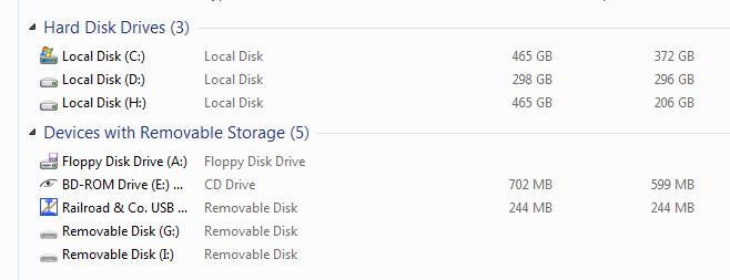

#87392
Hi Max i have taken some shots of my computer and the sticks properties which isn't a lot, i noted this morning when i start my pc my autoplay settings find the stick and ask me whether i want to open them just another confirmation the stick is found. That is the autorun file on the stick working so you should have something similar.
Pete
My Computer
Last edit: by wogga
Pete.

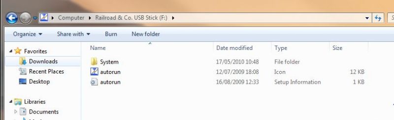

#87393
The stick
Pete.

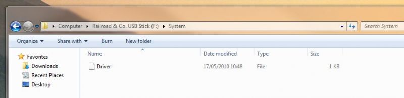

#87394
The system file on the stick
Pete.

Max,
From the diagrams, your stick has the same amount on it as Wogga's. In the first chart he has posted it shows 244MB free space. That is exactly the same as shown in your pink pie chart - 244MB.
So I think your stick is fine. I expect that it just contains a small string of characters like you often have to enter for new software as a code to enable it and prove you have purchased.
As you can see the pie chart, the stick must be connected just fine.
