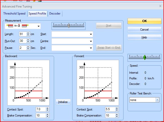

Just on loco profiling (like John i have been doing a fair bit recently) i have setup a special profiling track because my layout does not have enough length to do profiling, with my experience the run out track needs to be at least twice the length of the test track i.e. profile length is 1metre then the runouts either end need to be at least 2 metres each, this will allow the loco to accelerate and deaccelerate under its own control, anything less the loco is still accelerating into the test length and will give skewed results.
Pete
I hadnt realised you had set up a separate profiling plank…………….I think its a good idea which I am already seriously cosidering. Right now I use a storage road which plays havoc with the chimney pots in the town centre!
I am intrigued by the lengths you are using ………………I thought (both from the Manual and RMWeb) that the key thing was to have the measuring block as long as possible………….mine is 60"……………   The discussion on the start/run off block length centres on the run off not the start and has to be sufficient both for the loco to stop and for TC to have sufficient time to re calibrate……………….there is a time delay you can increase if needed as well. My run off is 24" so my ratio is in inverse proportion to yours?
My profiling generally works very accurately
Although yesterday I ran into a problem with a 14xx which is not the smoothest performer at slow speeds (traction tyres and only 2 wheel pick ups :twisted:)
I fiddlled with the CVs and reduced the Max speed to 25 mph and appeared to get a much better performance at low speeds…… except that TC insisted on producing a flat line (no curve at all) at lower speeds. For 5 speed steps the speed was the same…… 6 mph………I also found I needed enormouse brake compensation (150) to pass my 12" at 8 mph brake test…………..I guess that should have been my red light…………….when I tested it with schedules I found previously proven stop markers required significant adjustment……..and brake markers were even more erratic…………….wasted almost a day on it
Thinking about it having speed steps achieving identical mid range speeds cant be good…….so I think I need increase the Max speed to about 30 mph to allow for a different speed at each of the 28 step……adjust the CVs and reprofile the loco yet again    :cry::cry::cry:…………….I will let you know how I get on

John, i only tell TC the runout is 30cm because i think that is the point it starts to de-accelarate when i observe at high speed, My concern is that when it hits the test point i feel it should be at the speed for that decoder notch hence the longer lengths either side of the test portion. My test track is made up of 3 lengths of 1 yard peco with buffers at either end which is 1 yard test and 1 yard at each end for the runout which isn't long enough as they crash the buffers at the higher speeds hence my theory of twice the test length minimum. I catch the loco and hold it while it builds up a bit of speed then let it go which is cheating but it seems to work for me.
I suppose you could use an oval as long as it doesn't encroach onto the other end zone, i think Brian uses an oval?
Below is the speed profile for one of the reliable Fairburns.
Pete.

My attempts at profiling were hampered by the 15min. rule, I used a U shape in settrack and had to keep shortening the timed section to stay within 15 min. As you say, the 15min makes evaluation difficult: without profiles much of the potential accuracy is lost, so the demo is not much better than an expansion of the manual, you can't compare the results with the real thing, I guess.
I think it is a very calculated (aka cunningly) 15 mins Brian, and when you are getting to end of tracklaying and control installation you have to test fully in my opinion before you can do some serious scenery just incase you have to rip stuff up.

You are right about the over run Pete (althogh I dont think it affects the profile) I had forgotten I have to set the points at both ends of the storage yard to allow for it……………maybe I will have to rethink my idea of a separate track
Your Fairburn profile illustrates my dilemma……………….it is clear from the curve that the loco moves very well at slow speeds but even though you have set a maximum speed of 100 kmh (and how often will you do that) at speed step 28 the loco will do just short of 200 kmh……………..I imagine that Dr Railroad is getting excited and of course you are only using 50% of TCs internal steps
I have couple of locos like that…………..they run perfectly satisfactorily so I just ignore Dr Railroad and focus on more pressing issues like the 14xx…………….but for me the nagging doubt lingers would the ok loco run even better if I adjusted the cv and reprofiled………………….too many things to do and not enough time……and I am retired
John Dr Railroad doesn't show anything? i have just been doing some loco exchanges tonight and all is well, some uncoupling (still using tension locks and the kadee shuffle)and coupling. All oK. If anything the Fairburns stop at the right spot but with slightly different braking actions and on occasions a really slow 1 mph crawl to the stop? so not perfect.
I too am tempted to do a bit of tweaking and more PROFILING! but shall chill for a bit and see how i can get a temporary fit 5 metre profiling track in the house without decapitating er indoors!
As in nothing at all??  Try deliberately giving two turnouts the same name and connection number…………you should get a message if you select Dr Railroad on the main train menu……………..its quite handy for that……I have got in the habit of checking fairly regularly
I would have expected a message for the Fairburn asking you to adjust the Max Speed CV to bring it in line with the Max Speed you have set up in the profile

Ah! apologies John, i thought Dr Railroad and the messages window were one and the same, but no learnt something else again. Had a quick flick into DR R and yes it is full of notices!
I will have study tomorrow night in the sim and see what appears.
