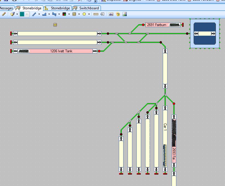

Well here it is my terminus ops experiment completed, basically once the fiddle yard is in and a turntable it will be a cyclic event of a variety of trains performing this basic operation. Needs a bit of fine tuning as my pax get whiplash as the train departs the station!
Brian this is with a demo of gold i needed it for the separate command.I am still trying to justify the cost for my meagre layout. I started a topic on RR&co to see if Herr Freiwald would consider a cheaper "Lite" version of gold with some size restrictions. One can only ask!
Setting the stop position was nothing too technical i can assure you, i used the head of the train entering the block to set my brake and stop markers then adjusted them until i stopped the front of the train before the buffers leaving enough room to allow the move forward after uncoupling then i dropped my uncoupler in the middle to allow some degree of latitude. But saying that after loco profiling it stops spot on every time.
But if you look at the screenshot of my humble switchboard you will see i have cheated….no trains no coaches! i just couldn't get the separation right? When the train left to depart the arriving loco tried leaving as well because TC thought they were joined! I will now stop boring you all now.
Pete
Pete.

Great Video……you sure move fast. Love the way the light engines crawl about. You may be able to fix the departing speed with schedule specific (or route) speed limits although I have a similar problem on one of my schedules and I am playing with temporary speed restrictions that are released or activated by action markers……..when it works I will write it up
I had this problem………its covered in the tutorial…………you have to get the Join and separate commands in the right place and right sequence…..
