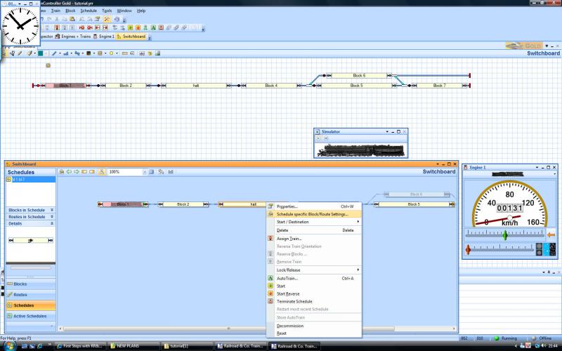

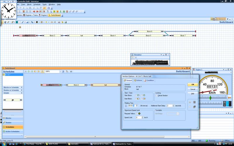

now for the question you asked, this is a nifty trick that i didn't know about
select the halt block and the schedule specific block route settings
then in the general tab select wait time 3 minutes
hey presto

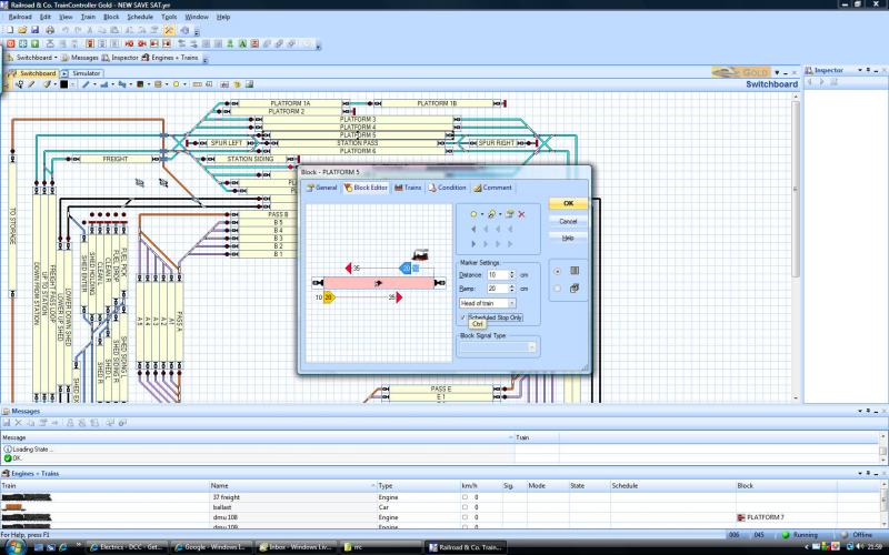

Hi John, I have rechecked my maths and they are correct to my assumptions, but my assumptions might be wrong. I will wait for the answer.
As for braking, according to the Help file:-
"The ramp describes, within which distance after reaching the brake marker a passing train slows down to threshold speed, if it has to stop in this block."
So I set the brake marker as being the point at which the train starts to slow down, and took the comment above to mean that by the end of the ramp the train would be just moving at threshold speed, which it would continue doing until it reached the stop marker where it would stop.
There are 2 measurements the braking ramp which is the distance the train travels before it reaches threshold speed and the distance between the contact indicator and the point where the braking ramp starts.
So to quote your example travelling right to left you have stop marker that is activated 40" after entering the block and a brake marker that is activated 10" after entering the block……the train will then progressively slow down for 20" (the length of your ramp) and then continue at threshold speed for a further 10" until it reaches the stop marker
On the return journey (Left to Right) it starts braking 2" after entering the block……brakes again for 20" and then continues at threshold speed for 8" when it will stop at the stop mark which is 30" from the entry point
I am pretty confident that is what will happen and I think you will find 10" at threshold will take quite a while
Having said that, on reflection, I dont think the combined ramp and distance have to exactly equal the stop distance……but the difference is the distance the train will crawl before it comest to standstill…….I suspect a couple of inches is enough

Yep, exactly what I thought I was programming in. Trouble is, without actually seeing it happen, did not think it through well enough. As you say, crawling along for 10 ins will be ridiculous. I still think I have the stop points correct, but have to wait to see your correct answer.

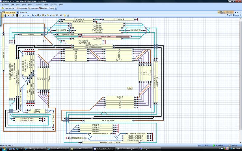

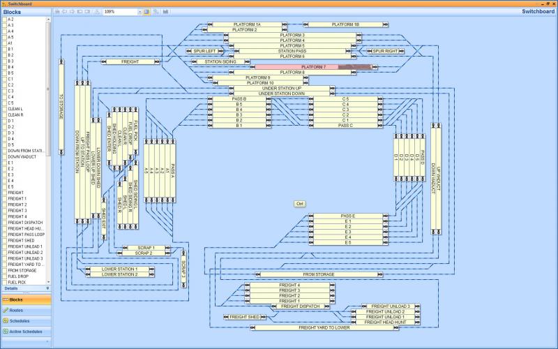

i done this at work so didn't have the right switchboard so converted my platform 5
i think the simulator thing may be because i am stopping and starting the schedules all the time, this would not happen on the physical layout as trains would have to be moved.
looking at my plan above between blocks pass a and pass b the route is orange, this also happens in the dispatch window. why is this?
with thoughts about your plan i think a roundy roundy with a fiddle yard at the bottom and a yard on the left or right.
here is my new plan in both windows
