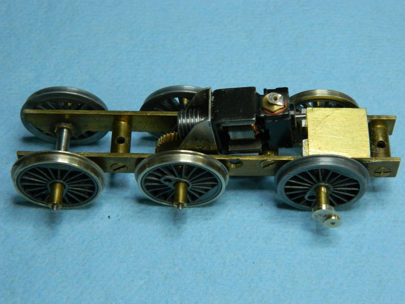

I had already converted the frames to EM gauge by the simple addition of some brass washers at the ends of the spacers, and have had it running with a Branchlines motor and gearbox along with I think a 50:1 gear. No compensation on any wheels, that may come. Not too sure about that motor either, feeble magnets but there is not much room available. I had also used a mix of modern Markits/Romford wheels (insulated) and old half insulated ones. I found some insulated Romford wheels of the correct diameter in the spares, so they will get put on. EM axles, extended axle extensions and "Deluxe" outside cranks are all from Markits. They look the business, as opposed to the run-of-the mill regular outside cranks. Markits axle design solves the issue of quartering without any effort.

Fiddling with the chassis last night I realized I had a see-saw. Hmm, sez moi, that ain't proper. Out with the micrometer. Two of the oldest wheels are 21mm in diameter, 4 of the not so old are 20.65-20.70mm in diameter. An "Oh dear, well I never" moment. There looks to be just enough meat on the the older pair to take it down to the diameter of the other 4, if the rim stays attached to the spokes in the lathe. I can but try. If not the hunt is on for some wheels.

The diameter of the 2 oversize wheels was taken down on the lathe to correspond with the other 4. Only one tread came off, back on as a friction fit, dab of Loctite or CA will keep it in place. Phew, a big sigh of relief!. Markits production is erratic at the moment, getting this diameter wheel was going to be difficult. The lathe is a cheap one from Amazon, shoe box size, accurate enough for this sort of work. Soft metal or plastic, definitely not for steel or cast iron. I need to find a milling attachment to make some hornblocks. The rims on Markits/Romfords drivers are nickel silver (the center is I believe ZAMAC/MAZAC), I finished off with some #800 then #1000 grit. Took the rims down a tad as well. Pictures show the lathe as well as a rim being reduced. No more seesawing.
