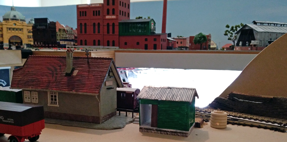

#292572
Goods shed ready for business
Just the gutters and downpipes are missing.

#292594
Nice building Claus - I like the roof tiles.

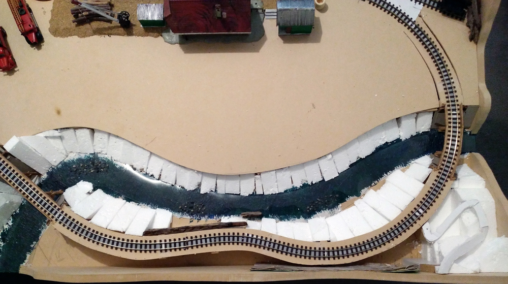

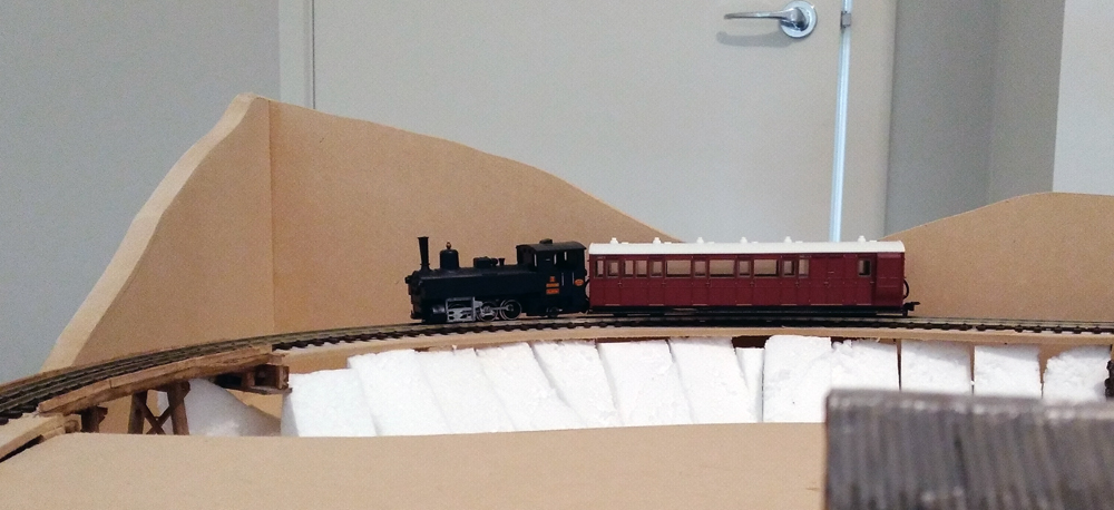

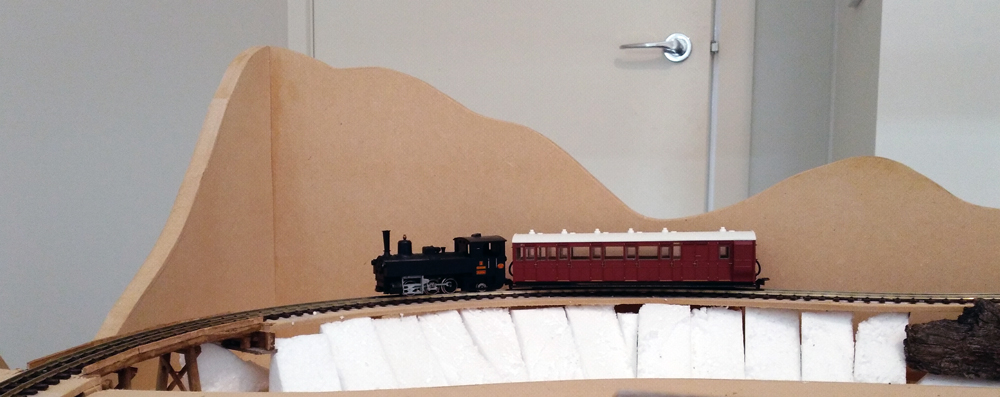

Cutting Corner(s)
When I do modelling, I try no to cut corners. However, the other day I literally cut a corner. The contour of the landscape was created before any tracks into Gumnut Gully were laid down. I did try my best not to get too steep slopes, but one corner ended up being too high or too close to the track. With some shaking, dust and derailments the corner was cut down to a more manageable height.

#292638
Absolutely plastered

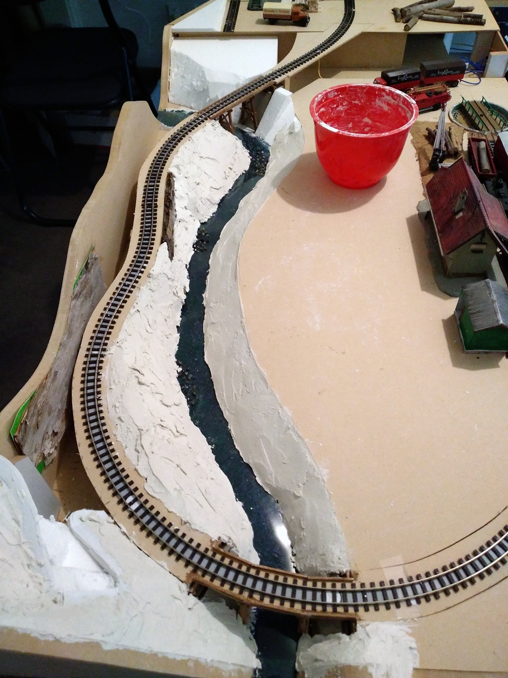

Wednesday was the day to be plastered! Not me, but Stoney Creek in Gumnut Gully.
The banks of the creek was roughly landscaped with Styrofoam cut with a long blade. Not too messy, thankfully. Next step was the finer landscaping with plaster of paris. Last time I did a similar job was some 30 odd years ago, so my skills were a little rusty. I half-filled the red container with water and stirred in the plaster. Everything worked quite well. I did the bank to the right in one go and it came out quite smooth.
For the left bank I intended to repeat the success. Half-filled the container with water and stirred in some plaster, which hardened in about 60 seconds! Scraped out the container before it went into the fridge together with the bottle of water. I have read working with cold ingredients gives you a longer period before the plaster sets. After 30 minutes cooling off, water went into the container followed by the plaster. Again, the plaster went hard after 60 seconds. Could the cause be the residue in the container? I don't know, but the from then on very little water went into the container and the mixture was quite thin. Working fast and with several mixes I got the left side done. It is quite rough in appearance. I hope I can smooth it out before planting grass and trees.
#292643
Hi Claus,
For what it's worth I put the plaster in a container first and then add water sparingl until I've got the right mix.
#292644
Hi Claus,
Well, it may make a difference. As a male I usually don't read instructions  :hmm: , but this time I did!
#292649
if it's plaster of Paris you're using Claus, it's the very devil to work with.  It sets rock hard before you can write "Paris" on a bit of paper !!  That's why they use it for medical casts - it's fast setting ……….
Have you tried the plaster bandage - 'Mod-Rock' is one brand.  It's great to work with although one does have to raid the piggy bank to acquire some ……………….
The terrain is taking shape nicely. :thumbs3:

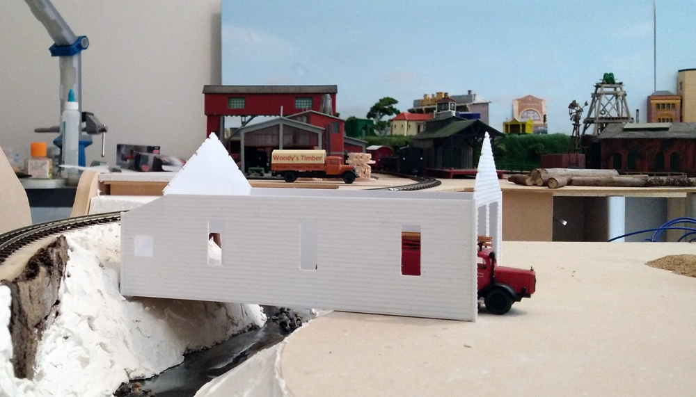

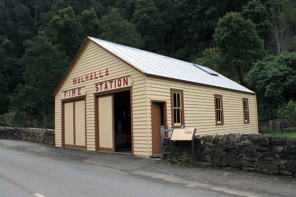

Gumnut Gully Fire Station

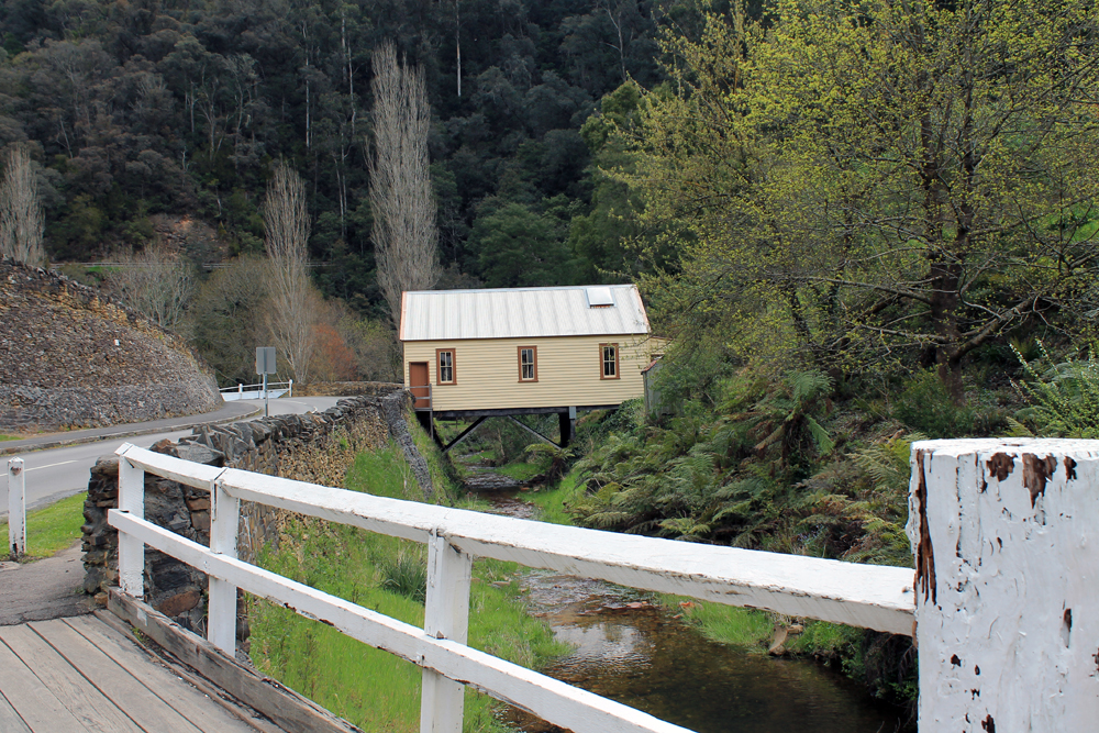

With the bush fire season fast approaching the need of a fire station in Gumnut Gully is urgent. A couple of photos from Walhalla, Victoria, serve as inspiration.

#292680
What a funny spot for a building…!
#292682

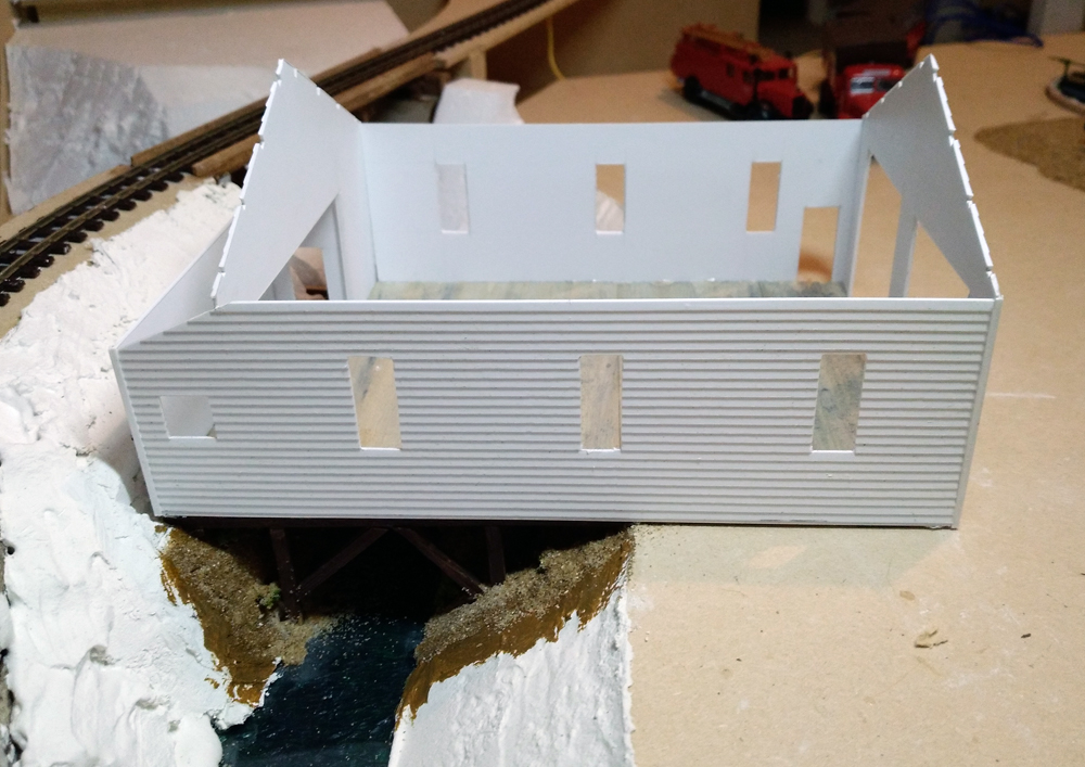

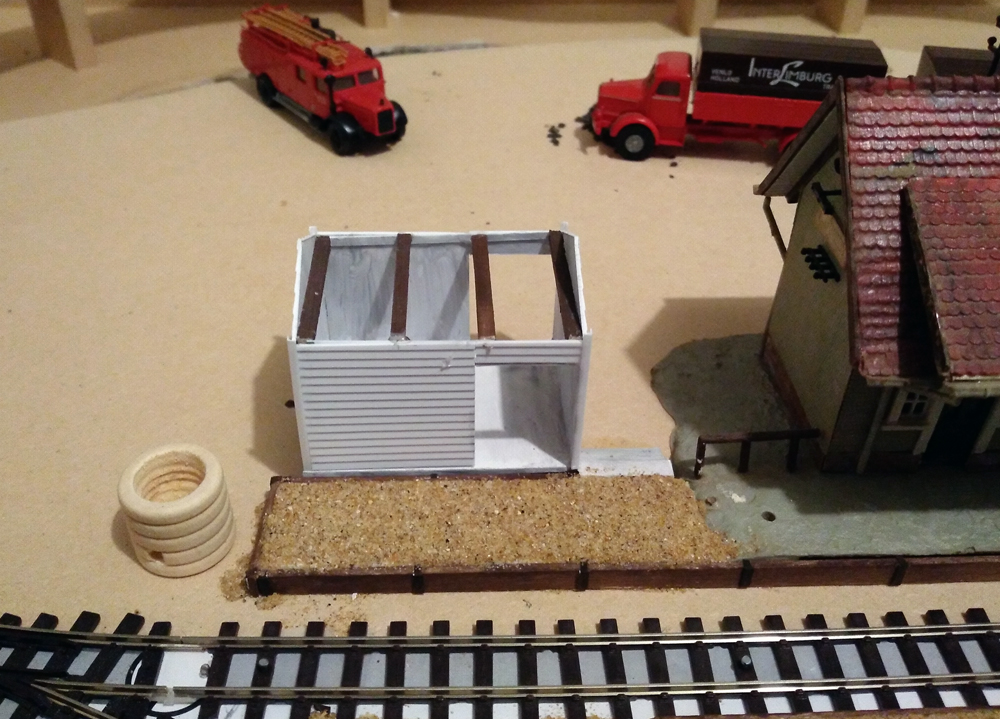

Spanning the Creek
The walls of the Fire Station are up.

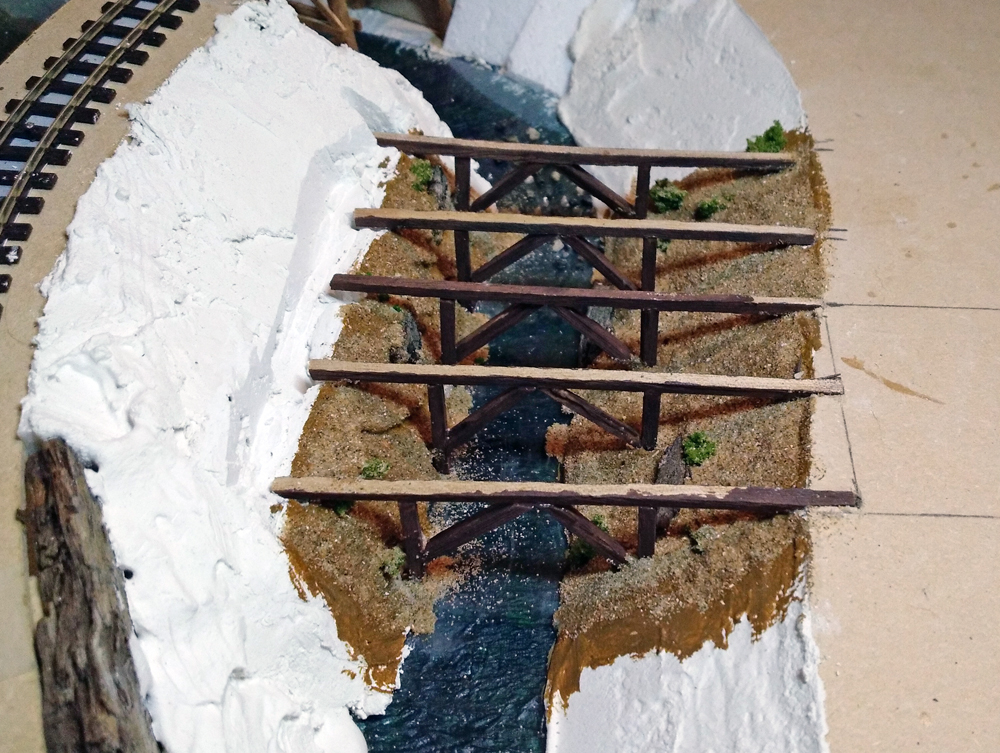

Hidden 'gem'
The fire station requires a proper support across the creek. Like the original five beams have been put up. It looks rather good, I think. Unfortunately only the outermost beams are visible with the building in place.
