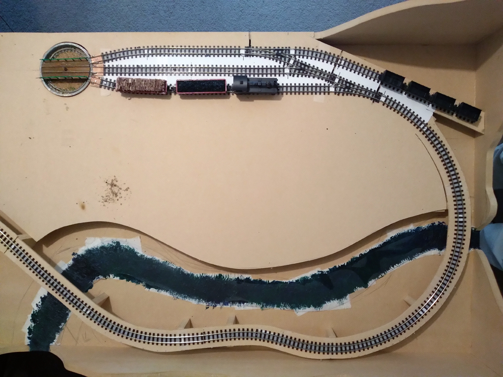

Gumnut Gully still appears very quiet and abandoned. Not much of activity is to be seen. However, the still to be named creek has started to form. The creek bed is made from toilet paper (!) which has been painted with green and blue paint. The water is a 2mm thick plastic table cover.

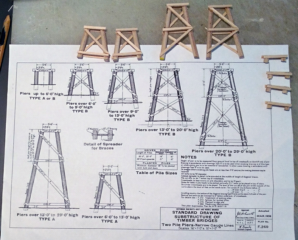

Spot the mistake(s)

Nope    give us a clue
Wrong cuts at the ends of the braces!  :(

Take your word for it Claus, they look fine to me :thumbs3:
#292016
Hi Claus,

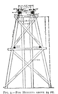

Cuts are OK. See the diagram below of a pile trestle bent. Louisville & Nashville Railway. The designer of the Victoria Railway got it wrong - the diagonal braces are supposed to rest on the horizontal braces top and bottom. There should be another horizontal brace at the bottom. If there is not that is when the cut is vertical to slope off rain.

Hi Nigel,
The designer of the Victorian Railways may be wrong, but they certainly stuck to the design and drawings. I am glad I got it sort of right.

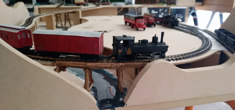

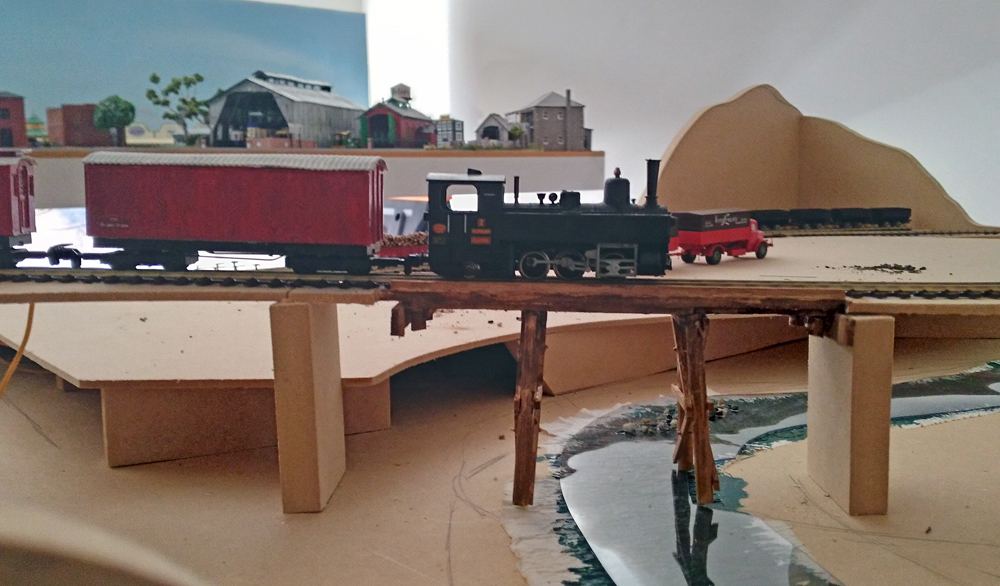

Two trestle bridges over Stony Creek (yes, the creek running through Gumnut Gully has been named) have been finished. As a test, a short goods train has passed over each bridge. Not a tiny squeak was to be heard!

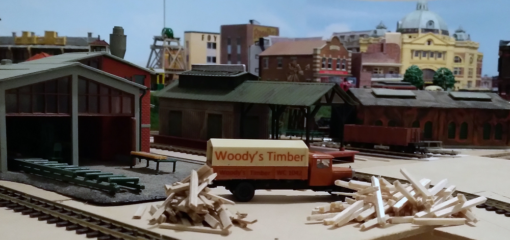

Woody has come to pick up some timber from the sawmill. A heavy wind gust must have come through! Better get the timber stacked again.
The phone number (WC 1049) will have to be changed soon. In the early 1960s Australia went from two letters and four digits to six digits. The new number will be 92 1049. I think, Woody will rather buy a newer truck than repaint the old one.

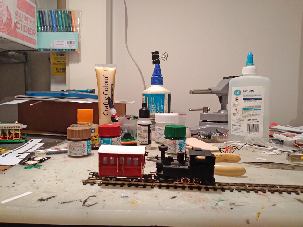

The result of a few hours of measuring and cutting resulted in the body of a small brake van. A similar van was used at the Mt. L yell railway in Tasmania. The body is on a temporary chassis which explains the lean.

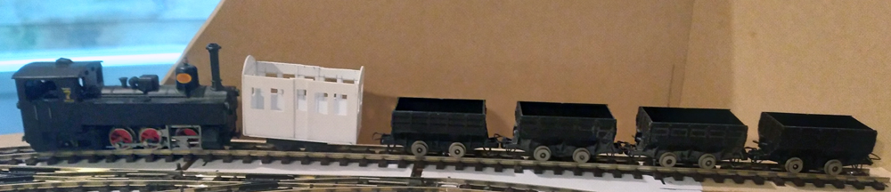

Getting there
Almost finished. I just need to attach a step beneath the door and some brakes. After all, it is a brake van!

I'm just catching up Claus - regarding the trestle bridge piers,  As Nigel said, yours are spot on and a much stronger design than those in the print.  The print ones rely on the fixing to the main post for security whereas yours are also also resting on the cross member - a far stronger structure so not sure what the Victorian engineers had to drink the night before but it didn't do much for their brain powers ………….
How did the brake van work ?  It's just 4 wheels which however braked, must have struggled to hold a train load of gold nuggets - gold, so I'm told, is heavy stuff.  Can't confirm because the only gold I posess is in paint form ……………..:07rolleyes_2:
