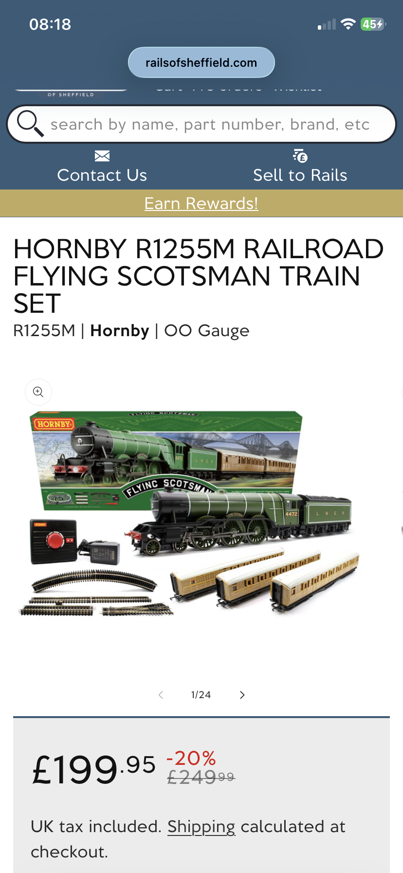

HORNBY R1255M RAILROAD FLYING SCOTSMAN TRAIN SET
R1255M
Hornby
The set came with the outside track and I used the poster layout to work out the layout and it shows a inner track and an extra loop above inner track so I am planning another visit to pick that track up also. IMG_5458.png

Looks like the set comes with third radius curves, so an inner loop will be second radius which is fine :thumbs3:
