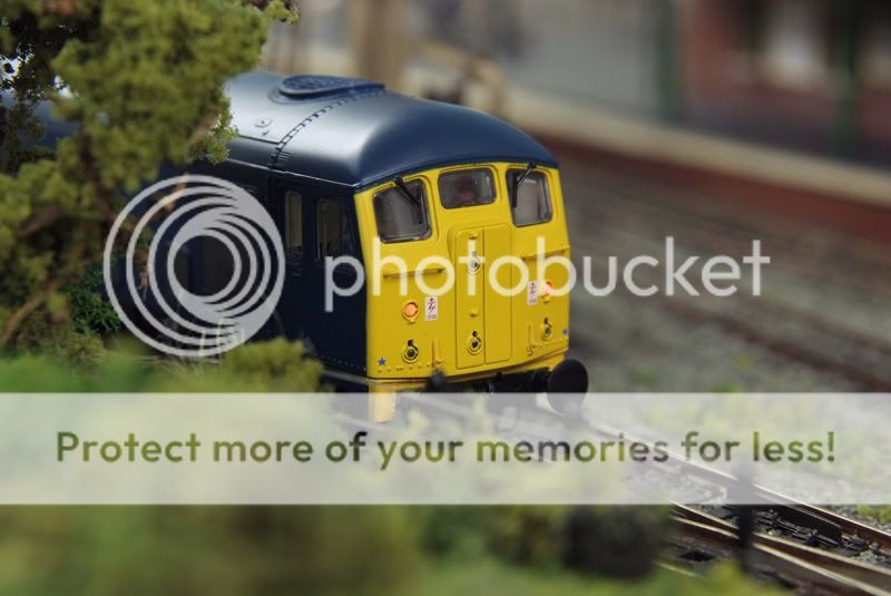

Depth Of Field
Depth of field can be thought of as the amount of the image which has acceptable sharpness. This means that either side of the selected point of focus, there is a region in which the image remains in focus. Moving outside of this band of focus (towards or away from the lens), the image becomes progressively more unsharp and out of focus.
The amount of depth of field is controlled solely by magnification and aperture. Since the magnification is normally fixed for a given suject, the depth of field is usually controlled by aperture alone. Wide apertures (such as f2, f2.8) give less depth of field whilst narrow apertures (such as f16, f22) give much more depth of field.
This control is very important when deciding how to isolate a subject or where to direct the viewer's attention. Look at the picture top right which is a townscape view with a garden rockery in the foreground. The foreground was only a few feet from the camera and the background view stretches to infinity (virtually!). To maintain such a great depth of field on the 50mm lens used, it was necessary to select the narrowest available aperture of f22. Careful focussing using the depth of field scale, which is usually marked on the focussing scale of the lens, showed that sufficient depth of field was available at the minimum aperture.
http://members.tripod.…lade/Gallery/ruthflat.jpg
The picture uses shallow depth of field to direct the viewer's attention to the subject (this is not as easy to see on the small picture, click inside the frame to receive a larger version). Notice how the immediate foreground and the background are out of focus, but there is a band of focus (look on the path) in which the subject sits.
This technique of isolating the subject using depth of field is very effective, particularly for portraits , in which the viewer's attention should be directed to the subject and the background left out of focus to avoid clutter. Note how the background can still be important, although out of focus, to indicate location or the mood of the shot.

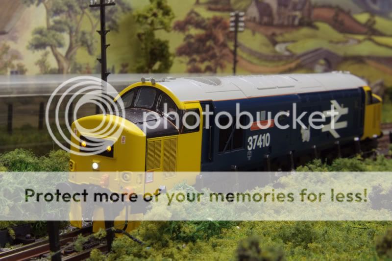

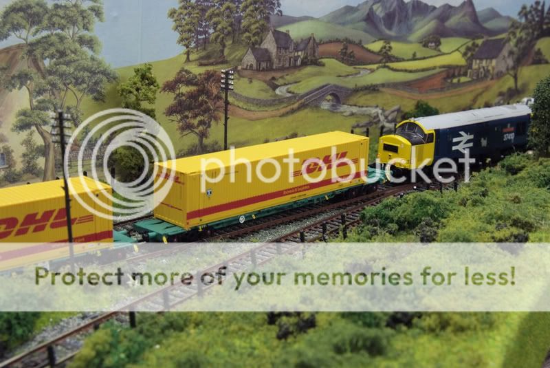

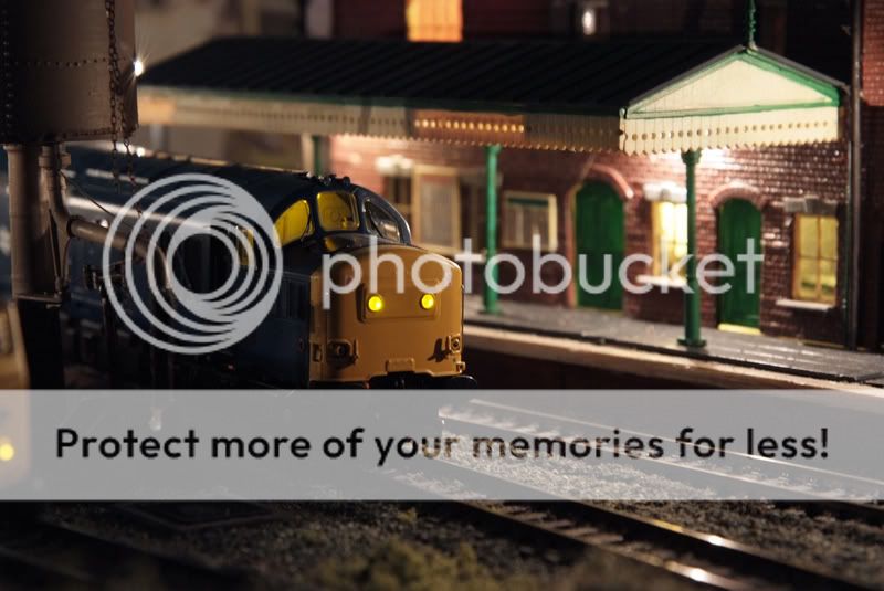

To Flash or Not
Below I show three different images
First photo
Built in flash on camera on
ISO 160 f5 Shutter Speed 1/60
Second Photo
Flash Turned off
ISO 250 f5 shutter Speed 1/6
Third Photo
Flash Turned off
ISO 250 f11 Shutter Speed 1 second
With the last image showing how I set the camera up, you do not need fancy tripods, the big must is that the camera is still, use your delayed action/ self timer, which will stop any movement at the time that the shutter opens.
Hopefully you can see the difference in all the photos, but by using available light, the photo has a more natural look to it, and it will always be sharper, if you use your aperture correctly, if you have a camera that does not allow you to alter the aperture, then look in the menu, and see if you can alter the ISO, from 100 to maybe 400 or even higher, this will in effect alter the aperture for you, but take acouple of photos, using both and see for yourself. if the lighting in your room is not good, then use a desk light which can be used as a overhead light, This can be a very handy tool, which we can talk about at a later date.
Could members please post their comments on this topic in the thread I have opened called "Comments On Alan's Photography Tutorial". Thank you.

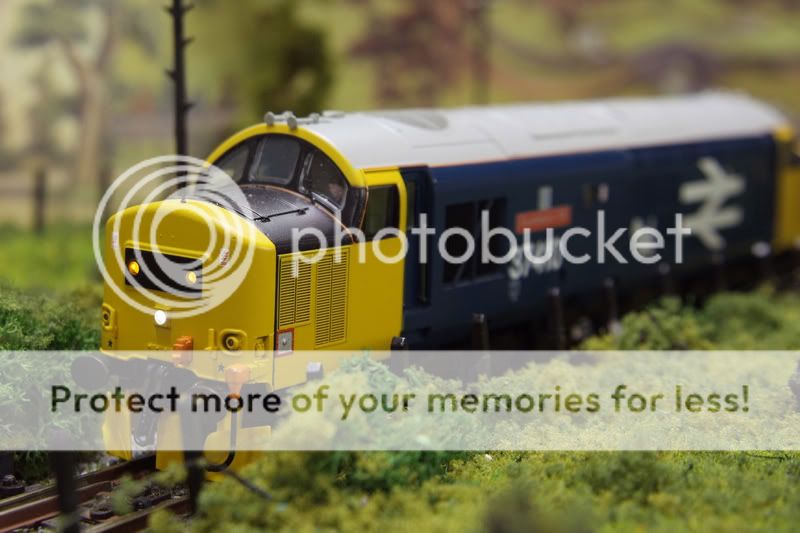

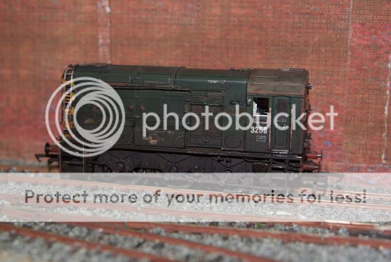

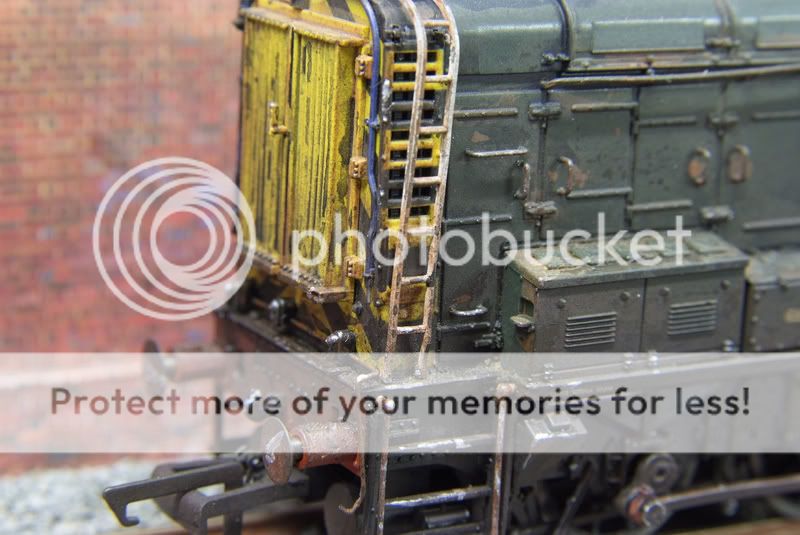

Depth of Field/Focus
Below I hope to help with the depth of field/focus question. I have taken four photos all from the same place, and the only thing that I have changed is the aperture, the camera is very close, Wide angle macro, which helps to show the shallow depth of focus on the first image. By upping the aperture ( allowing less light onto the subject, which means a longer shutter speed) the depth of focus grows, so at an aperture of f5.6 only the front of the loco is Sharpe, but as you go up to f16, more of the loco and surrounding area's become Sharpe.
First Image
ISO 160
F5.6
Second Image
F8
Third Image
F11
Fourth Image
F16
Hope that this has explained a little more regarding DEPTH OF FOCUS, the same applies when a photograph is taken from further away from the subject, but the difference is a little harder to notice.

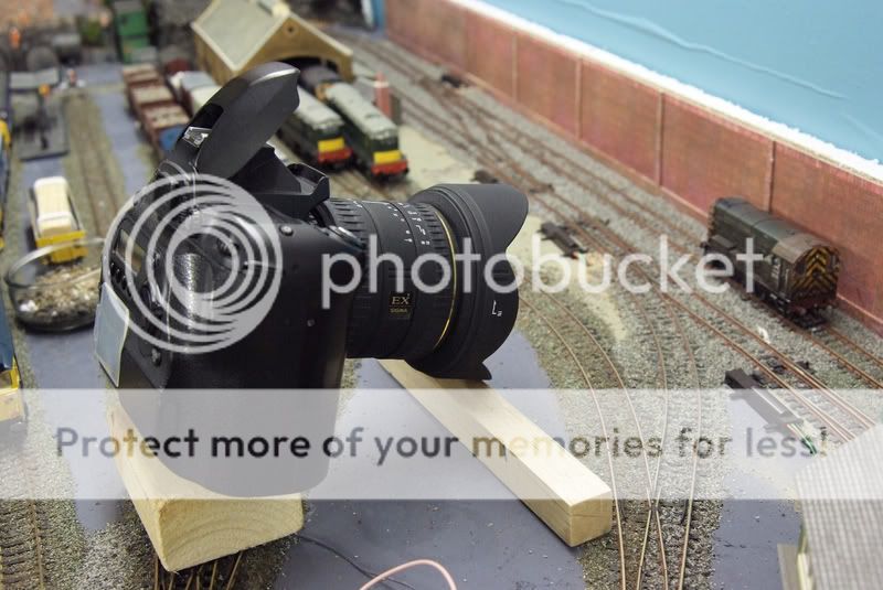

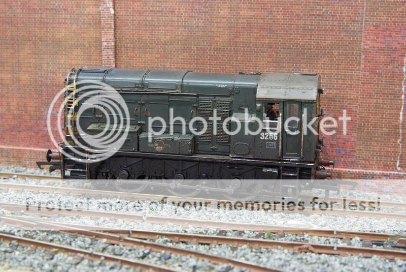

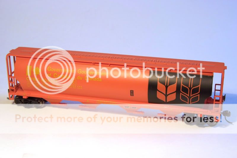

Quick Mini Studio
at Home
This is going to be a two part tutorial with a quick set-up studio for the first one ( this one ) and a more professional studio set-up in the second one.

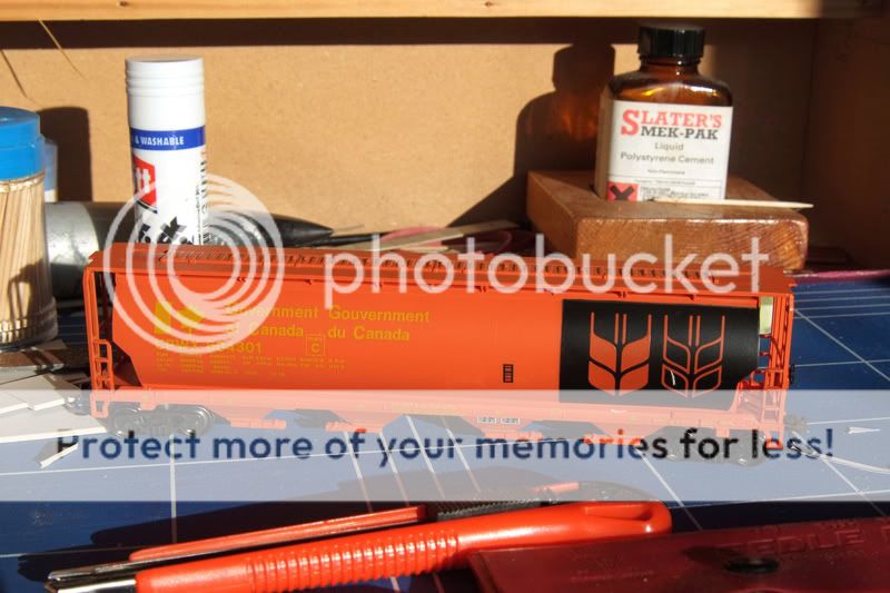

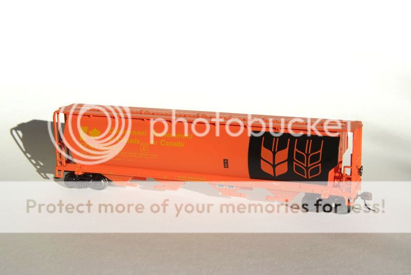

For this studio, all I have used is a piece of off-white backing card and a normal desk light, the first photo's show a wagon photographed on a normal workbench ! and the second shows the set-up.
both the photo's below are taken just using the sunlight coming in for a window behind
This first photo is also taken just using the sunlight, exposure = 100iso f16 at 30th
the next image has be taken by using the desk lamp ( this has a standard 60w bulb in it ) and placing the light to the right of the camera about level with the front of the camera, this has given us a flat light, with a shadow to the left.
This next image is the same as above except that the light has been moved to the left of the camera, giving again a very flat light, with shadow to the right of the wagon
The last image shows a close-up using the above lighting, which is better than a complete full wagon, as you are seeing a better lit area.
All the above images have been taken using the following exposure
100 iso f16 at 30th
None of the images have been taken with flash, which is why they have a very warm feel to them, using flash in a studio setup will be covered in the next tutorial. This is not the best type of mini studio, but you can see that it does work, it would be better if you used plain white paper, as that would reflect a little light up onto the subject, and also only using one light ( that has a normal 60w bulb ) gives a very flat lit subject, that does not really give any punch to the photograph, but I am going to show the difference in the next tutorial, along with using more than one light.
Hope that this has helped some of you, and I hope that I can upload the second tutorial very soon
