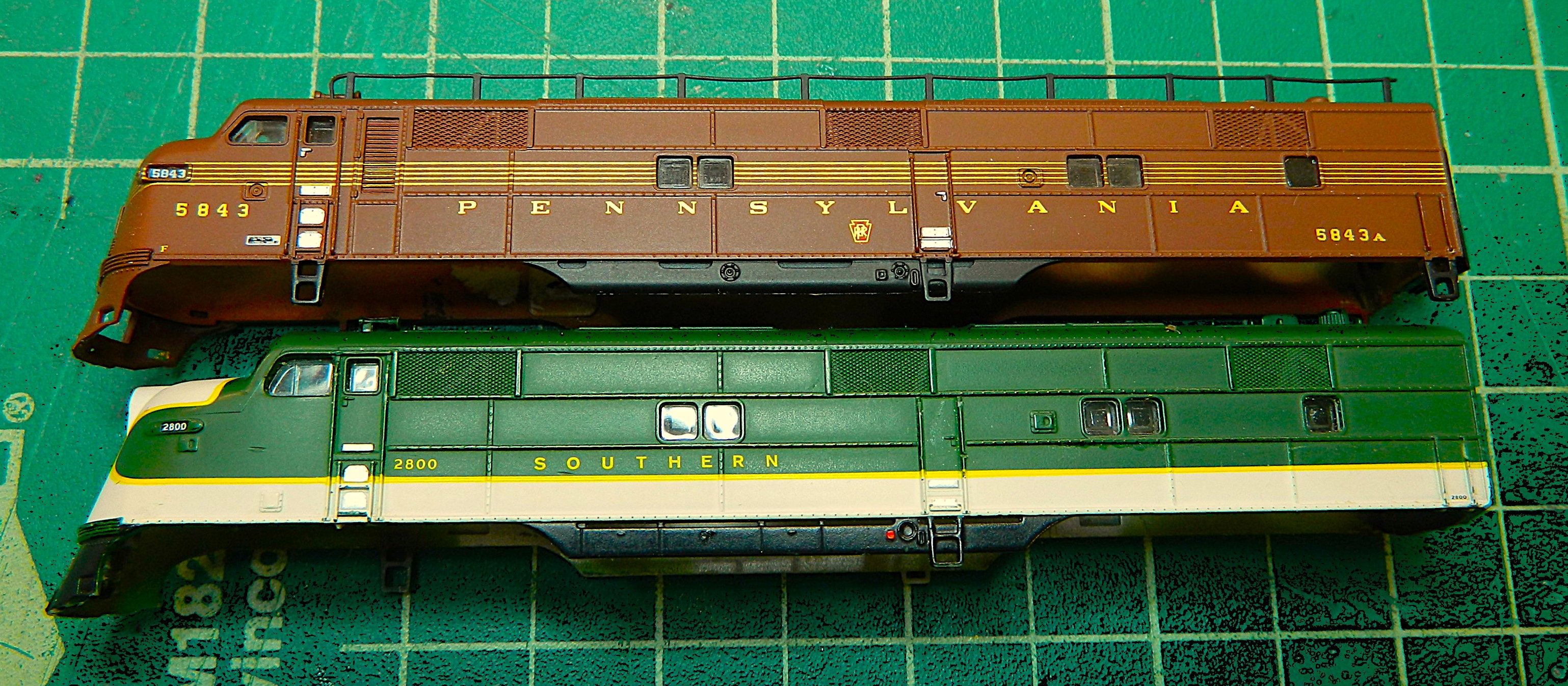

So onto my latest project - a BLI E7A DCC -sound chassis transplant. The donor is a Precision Craft (BLI) Pennsylvania E7A with a DCC sound chassis, the recipient is a Life-Like Southern Railway E6A body shell. Why am I doing this? Southern Railway E6As with DCC sound are rare and expensive in N scale. The BLI Pennsylvania E7A was $100, the Life-Like Southern E6A locomotive was $20. If I can find a BLI or Kato Southern Railway E6A with DCC sound I will be looking at $200-$250.
So after test-running the donor E7A without any issues except for a low sound volume and a weak headlight, it was off with the body shell and a look-see inside. Photo 1 shows the shell and chassis. Photo 2 shows a close view of the chassis. Close inspection revealed the following: 1. A loose cab interior. A previous owner had tried to force the locating lugs into their holes (Photo 3). 2. The speakers were loose. They should have been fixed with adhesive tape, otherwise, the sound is not baffled and is muted (Photo 4). There are 2 speakers, 50 ohms each, and wired in series. 3. The decoder was not tightly fitted to the 21-pin board. The label on the decoder says it dates from 2018 (photo 5). My DCC controller says it's an ESU Lok Sound V4. There is also a stay-alive capacitor. Apart from the cab interior and the loose speakers, it's in great condition.
Photo 1. Pennsylvania body shell and chassis.
Photo 2, Close-up of chassis.
Photo 6. BLI and Life-Like body shells.
