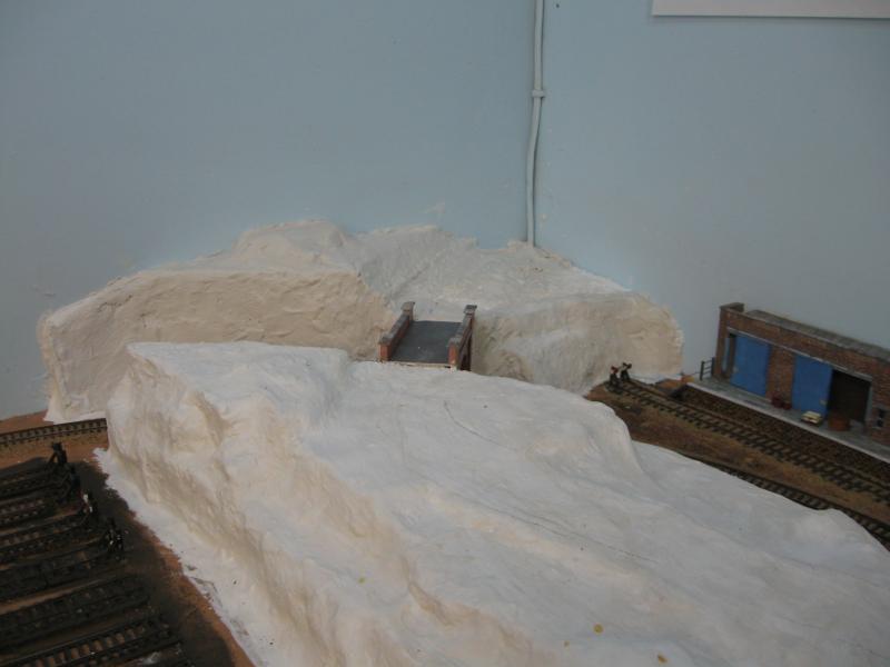

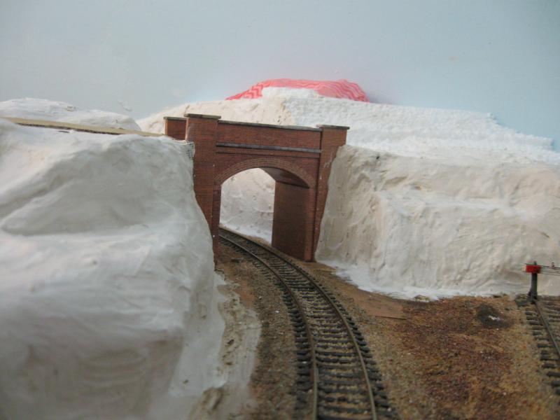

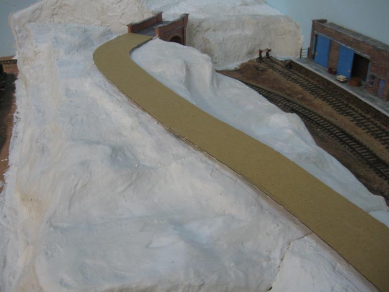

Slowly getting plastered !
The card road will be covered with Scalescenes Tarmac TX20 & glues/plastered into the surface- plenty of painting, etc to do.
#92125
I like that Ron, going to make a nice sceniced corner.
#92126
Thanks mate - yes it will take some time - in-between other parts of the layout job list.
#92127
Always good to vary things, apart from avoiding boredom, it will allow the plaster time to dry :thumbs

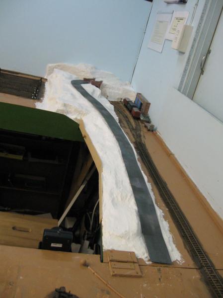

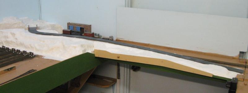

dd, the area is over 5'6" long
It goes over the lift up - tarmac covering done.
It will have to be cut to lift up. This is the easy part - fitting into the surface & adding more plaster - maybe putty this time at the edges, will take some time & care.  But will give the plaster a basic light brown/ tan colour first.

The cutting is more prototypical than all those tunnels we use, Ron.
Engineers would always use a cutting where possible.

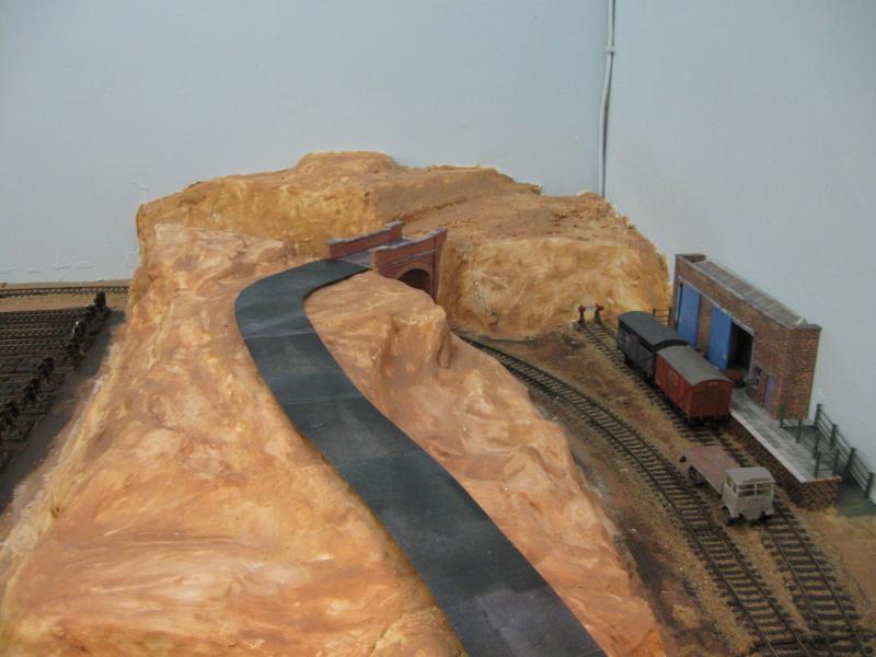

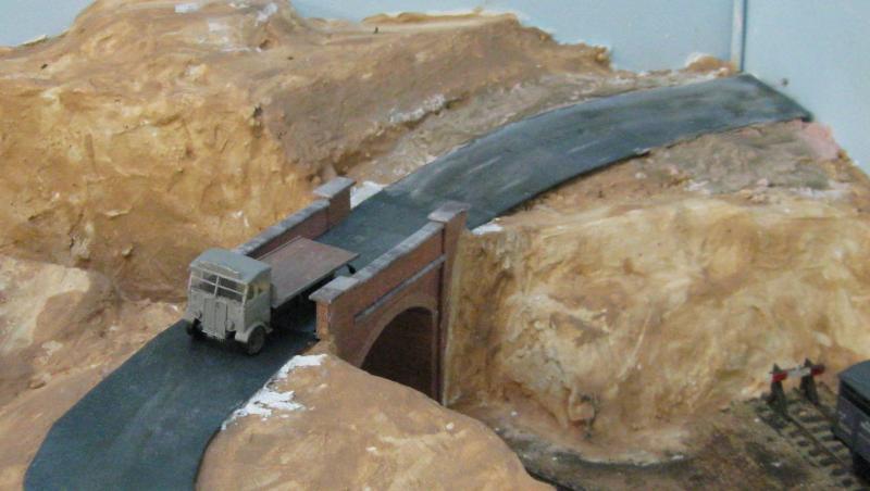

The white cliffs of Devan have gone -a rough coat of  tan paint to start with ( as usual, one sees an error after photo taken, etc - the truck is in the wrong place(
#93168
Changing all the time Ron, and the bridge is blending in really well, that's a h..l of a long road, you are going to need a few lorries etc to fill that up, or are you going on the fact that we in Devon have only just got lecky, let alone lorries :roll::roll:

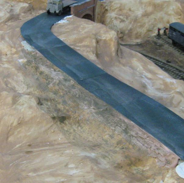

Back into some more "scenery" now after track changes & panels elsewhere on rthe layout..
Some more road surface  & slowly getting earthworks upto the road. Compare against post of Aug 16th.
#98139
That's looking good, Sol.  It's certainly going to solve that corner for you.  :thumbs
#98141
That little bridge looks just right in amongst all the rolling Devon hills
#98155
Its going to look great once some grass grows on the hills.The bridge sits in there really nice and natural,too!

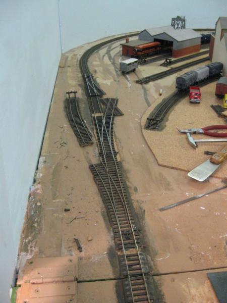

To the right of this liftup
was another small siding kicking back into a cattle dock. The last operating session saw that this shunting manoeuvre create problems with main line running so it was decided to make both  sidings non-operational but just a scenic area. DMU's will stop at the platform which is to be set onto the liftup. So while the points are made fixed, the time was taken to shift the point into the cattle siding closer to the liftup by 4" so that additional points can be installed for allowing Tawnton to be a through running station and also to be able to access the planned extension.
This photo shows the existing LH point moved closer to the camera ( the old cattle siding still visible & to be extended) with a new RH ready to access the diamond for entrance behind Tawnton Flour mill ( where the pliers are situated)into the main station & further down, another new LH  ( just sitting there - not yet installed) to match into the diamond for the extension on the centre peninsula.
