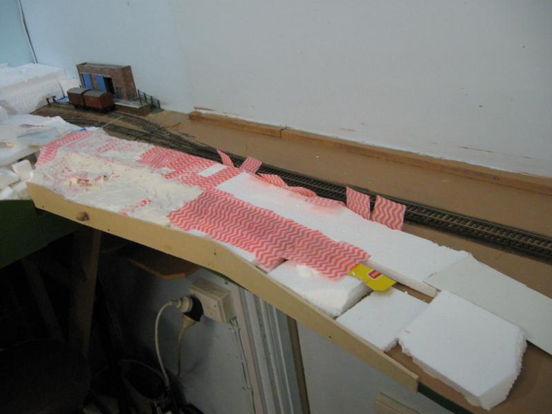

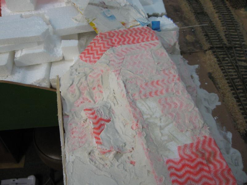

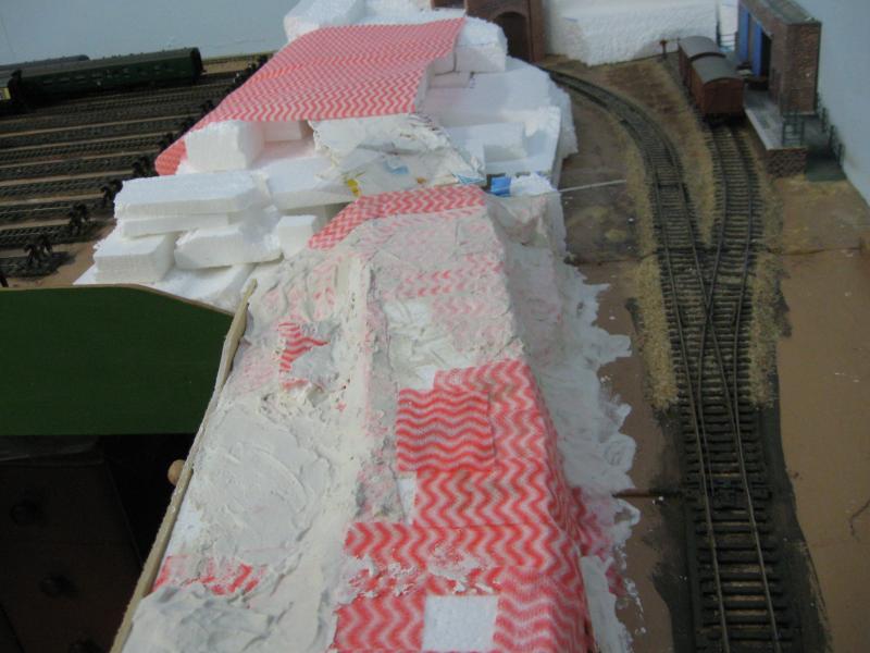

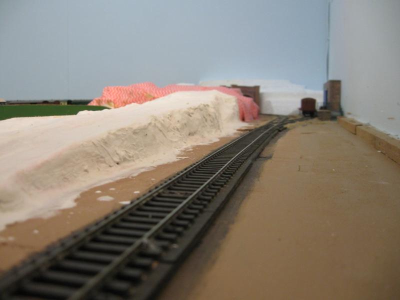

some was plastered & others tried with PVA - the bits sticking up PVAd at the base & will be bent over - PVA smeared all over.
The big piece of Chux, glued to baseboard with PVA & will be anchored to foam into shapes with Liquid Nails which was also used.
The piece of Chux at the top of the photo was across a gap., glued with Liquid Nails which was good enough after about minute then to allow me to brush into the rest of the Chux with full strength PVA, that piece is now firm enough for me to add some more. To make it a bit harder, this is across the liftup so there has to be a fine gap.
A bit of a ( well no, a big) mess but I take heart in that others on YMR start off with a mess & end up with a miracle so I may also get better !
I thought I would try all methods - each has its own atrtributes I trhink
All of the above was done 14-15 hours ago & the plaster is dry.
It certainly has the look of a good business-like structure about it Sol so carry on and all should come good.
Layouts seldom look their best when they are at this stage but as we all know if this bit isn't right the finished product won't be either.
At the rate I'm building it may be many months before I get to the mucky stuff, but at least I'll know where to go for reference articles come that day.
I wonder how much effect the PVA has on both drying times and flexibility……………:roll: I also like the "No More Nails" type glues, they may be more expensive than PVA but are both strong and fairly quick drying - patience never was one of my strong points !!!!
Looking at those shots Ron, it seems you are using the Chux cloths as a "carrier" for the plaster rather than soaking it in plaster first. I did it both ways Peter, soaking it ,is bleed'n hard & messier IMO
I wonder how much effect the PVA has on both drying times and flexibility……………:roll: I also like the "No More Nails" type glues, they may be more expensive than PVA but are both strong and fairly quick drying - patience never was one of my strong points !!!! PVA is slower but again gives a base for plaster. "No More Nails/Liquid Nails is very quick indeed, I found a tube I was given some months ago
If I didn't have the foam as a freebie. I would have used flywire & straight plaster.

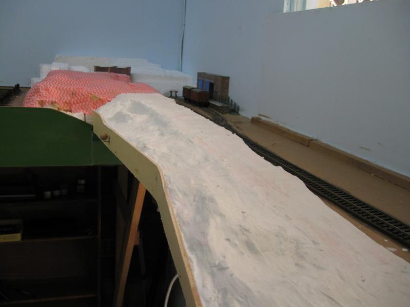

This is the gradient of the road on the lift up with all plaster. I have not yet decided on the road surface, either DAS/Plaster like MikeC has done or use the Scalescenes tarmac which will match the bridge road surface.

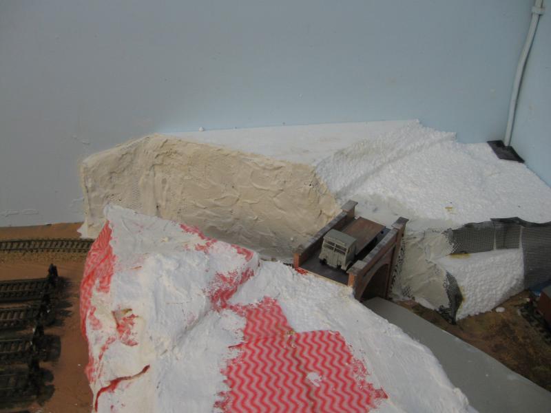

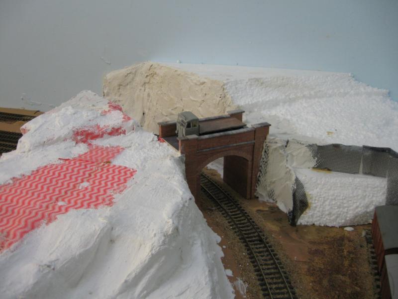

Now to carry on with the area near the bridge - at least get the Chux covered.
