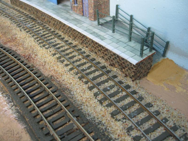

#88531
Sol.
    The platforms really look the business.I think the unusual brickpaper you've used is great…very naturalistic and different.I can't wait to see it all when the scenics are finished,should look the dog's doo-dahs!
:cool wink
#88532
nice work Sol,the platform looks very good,as said the scalescenes paving is neat.
:thumbs:lol::lol::cool:

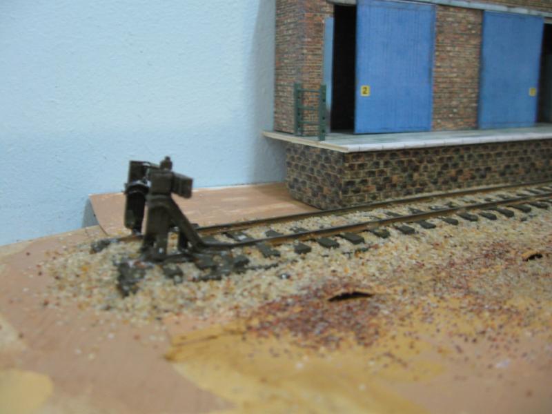

Ballasting under way - still damp.
and this is the end for the steps.  Not normally seen from this angle & they will hide the shortness in platform depth.
Photo also shows up more ballast/ground material needed to hide the tape gaps.

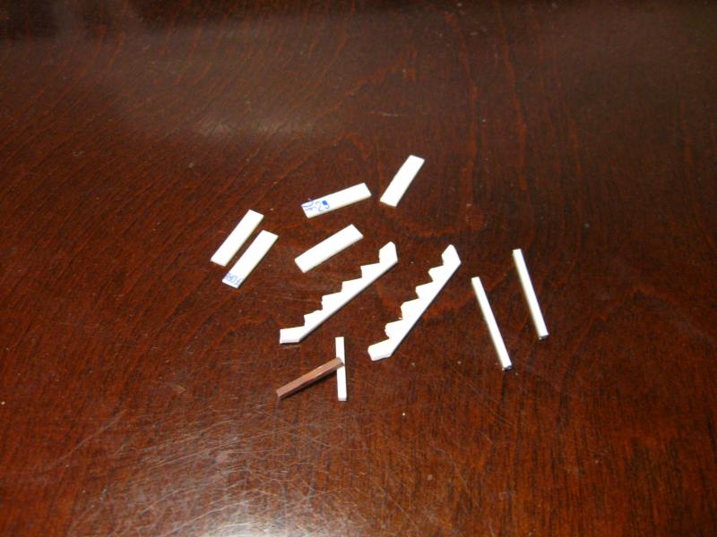

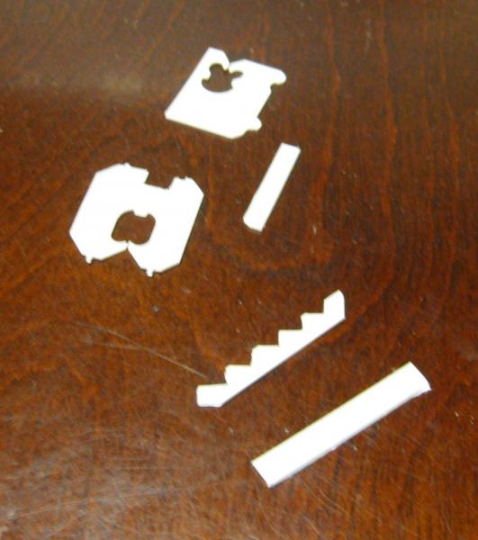

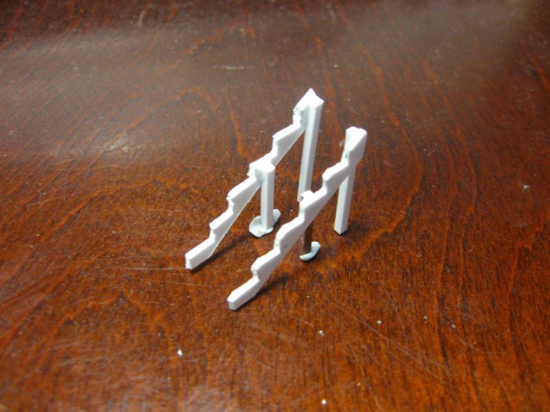

Steps, side pieces from 1.2mm styrene - one side already cut to shape using a nibbling cutter  http://www.micromark.com/NIBBLING-CUTTER,7761.html .
the steps themselves are 1mm styrene fron bread bags tags. One cut to width, the length to be measured.

All bits cut with posts
Sides prepared with posts

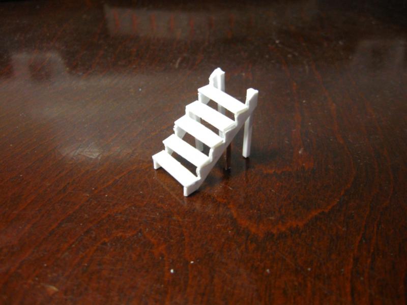

Steps added - not perfect but …

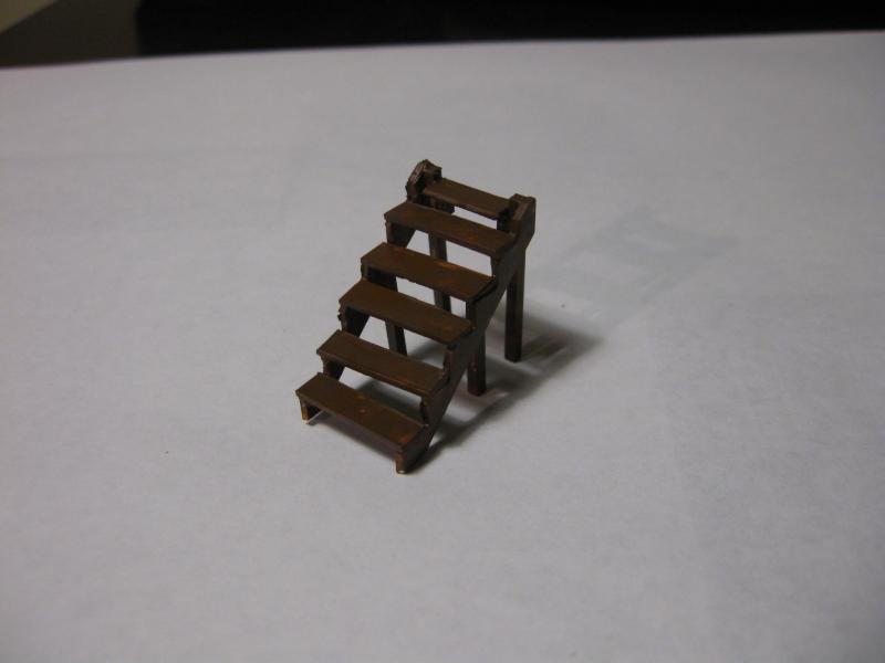

Painted now - since the above, it was tried in situ & a small step added at the top.
When installed at the far end of the goods platform, a rail to be added in situ & weathered. As mentioned earlier in the thread, it won't be seen full on or even side on but at an angle. Took some time but I enjoyed doing it.
#88665
I like them! They have plenty of character. Thanks for that, Ron.
