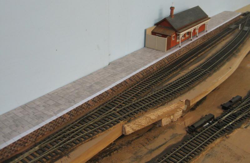

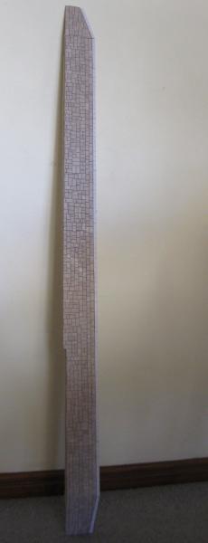

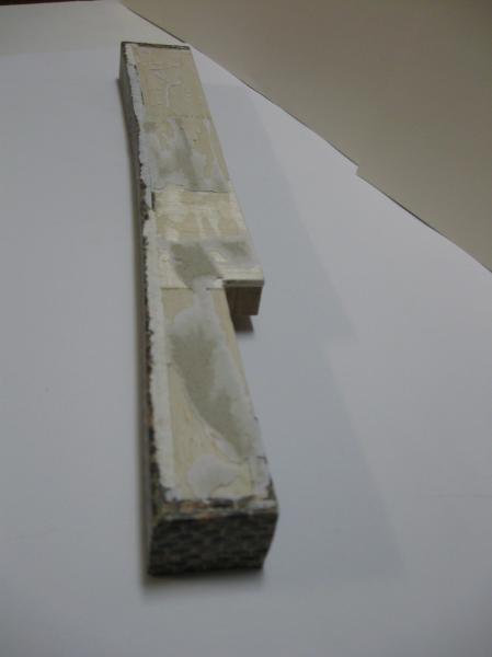

All paved now 3'6"' of it - to be sprayed with varnish when things are cooler outside -( currently in the shade a touch over 45C, official is 41c)   the. weathered . Shown resting against inside house wall
and temporary in position - fencing, etc of course to be done
I don't think I will be doing this for Tawnton platform which will be about 6'6" - 7' long, fingers are still covered with PVA:exclam

It really looks the business Ron.  I do like using those individual slabs from Metcalfe.
#73864
Very realistic RON.
#73987
It really does look good Sol. :thumbs
Did you find the slabs a fiddle to do ?  Whenever I've used them, my first couple of rows are great, then they seem to go off line a bit and look terrible.
The edging and support wall also look very, very good :cheers:cheers
Will you varnish the platform when it's removed to seal the underside edge or doesn't that really matter ?
#74033
It really does look good Sol. :thumbs  From a distance. yes
Did you find the slabs a fiddle to do ?  Whenever I've used them, my first couple of rows are great, then they seem to go off line a bit and look terrible. Definitely a fiddle to do,  first few rows. nice, then you have to be very, very careful. Occasionaly I leave a larger space & cut a slab to fit.
The edging and support wall also look very, very good :cheers:cheers Thanks
Will you varnish the platform when it's removed to seal the underside edge or doesn't that really matter ? all visible surfaces & including undeneath near the main wall will be sprayed - I don't want ballast glue/water to give problems.
#74042
Well we are looking at them from a distance :roll:
What are you thinking of putting along the wall behind the station Sol
#74059
Alan, platform fencing for sure, a couple of low-relief/photos, etc of  trees hanging over the fence. Not having any real depth, I don't think I can even glue photos of buildings on there though it maybe possible to have a very low relief buiding 1/8th of an inch deep such as a water tank at the far end so it would be at least 2'6" - 3' away from observer so it may look OK.
Just resprayed with matt varnish & it takes away the PVA fingers on the platform surface - looks good, now some weathering powders in parts - but won't get much done today-  34C at 9.20AM already on its way to 43C.
#74068
That is looking good Sol. :doublethumb
I'll bear your technique in mind if / when I re-do the platform at Treheligan which continually gives problems in the warm weather.

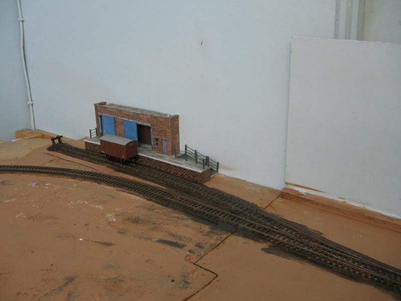

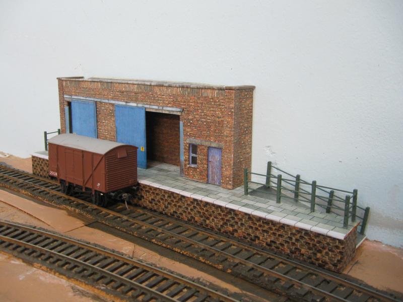

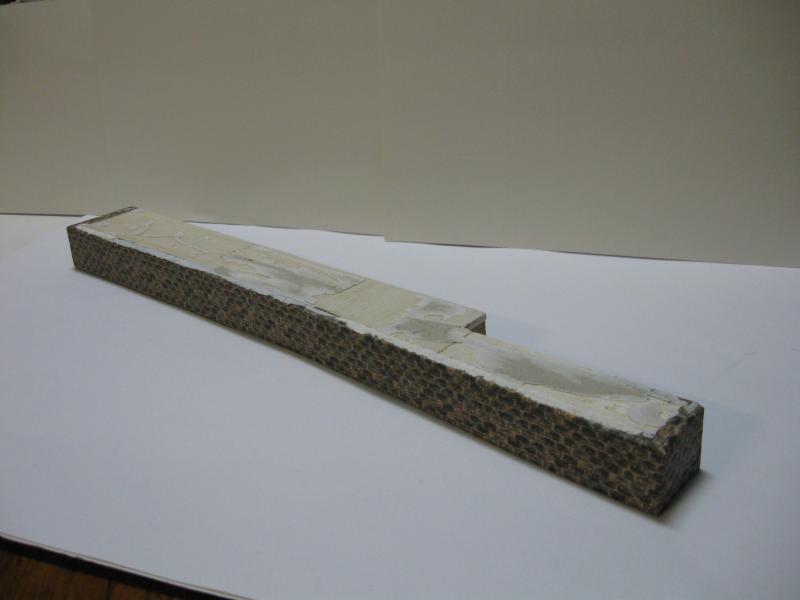

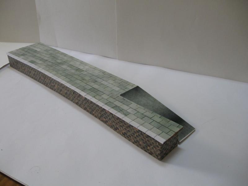

On Post #81 ( page 5) of this thread, I described how I made a platform for the small warehouse/goods shed.

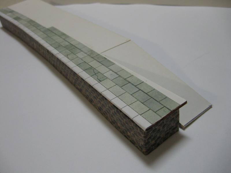

 With the alterations in the trackwork at Barnstable, that platform was too narrow so keeping the stone wall, I stripped off the existing plattform surface
Using 2mm thick card, added edging as per Post #130 & then strips of Scalescenes platform slabs - had to be strips due to the curvature of the platform.
Added also from Scalescenes papers, the concrete ramp
All sprayed with matt varnish, some fencing to be added to stop the "workers" from falling off the edges after fitted to the location.
#88477
It looks good, Sol.  I like the cracks.  :thumbs
#88480
Noice!
#88490
Excellent Sol, as Max said the cracked slabs look really good. :thumbs

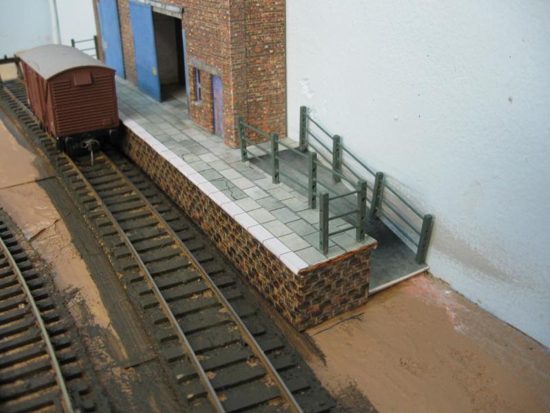

Fences made - post & rod. A set of steps required for the far end.
The ramp to be puttied in; ballasting next.
The overall position relating to Barnstable - the passenger platform will be to the right of the point.
Behind the buffer stop will be a hill & a road bridge ( the recent one in Hornby Mag for May) over the curved mainline coming down in front of the curved track .
