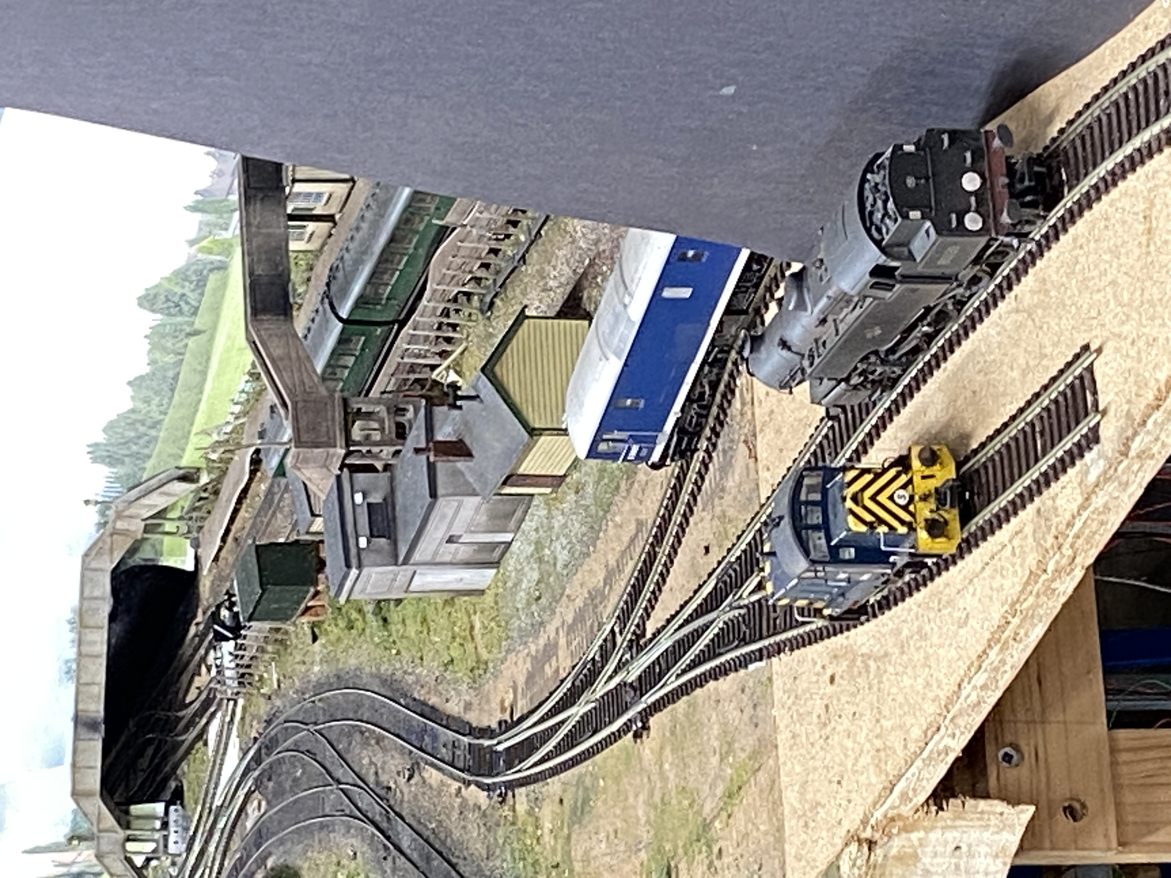

A cold and very damp afternoon was spent in the club room. But productive in its way.
I rigged enough wiring to operate the passenger lines. They are not fault-free, they require some switched isolation in due course (but not just yet with one item powered) and the uneven floor gives rise to poor rail alignment at board joins.
But things move.
The next sheet of back scene was also pasted up with fervent hopes that it doesn’t bubble beyond recall in the dampness. This has a curved corner to reduce the “corner” effect when photographed.
Those three little links at the very bottom will take you to video clips.

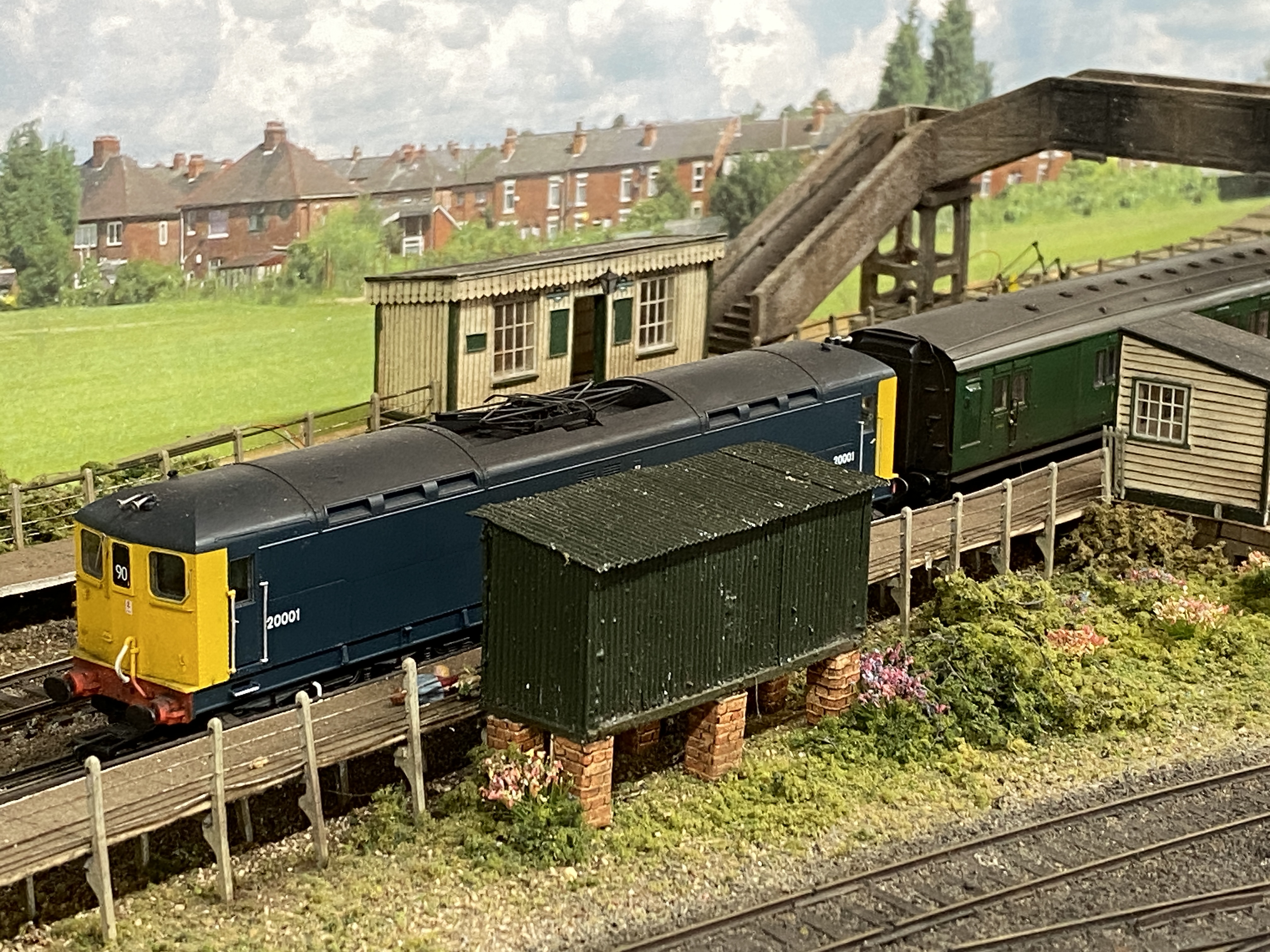

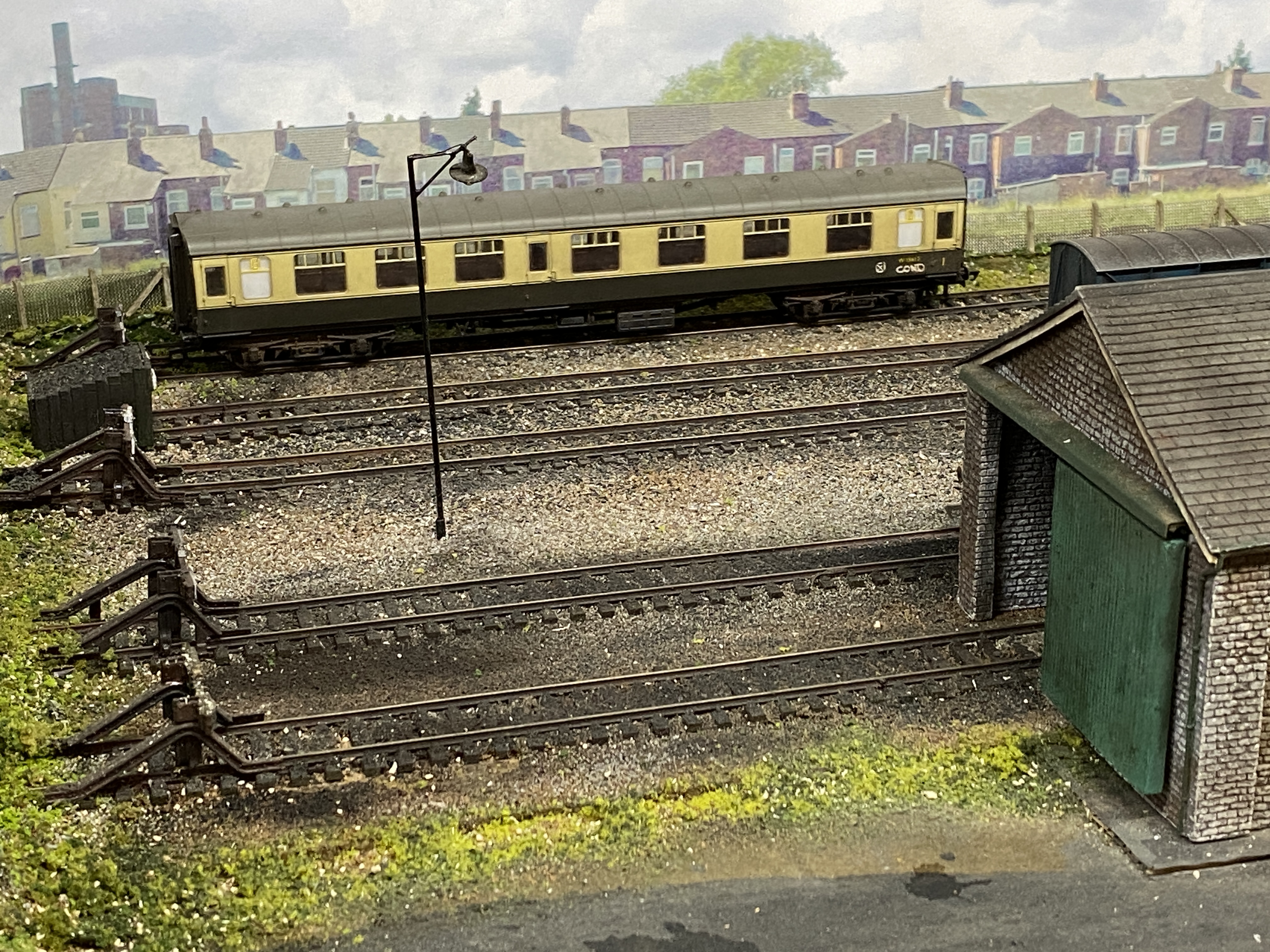

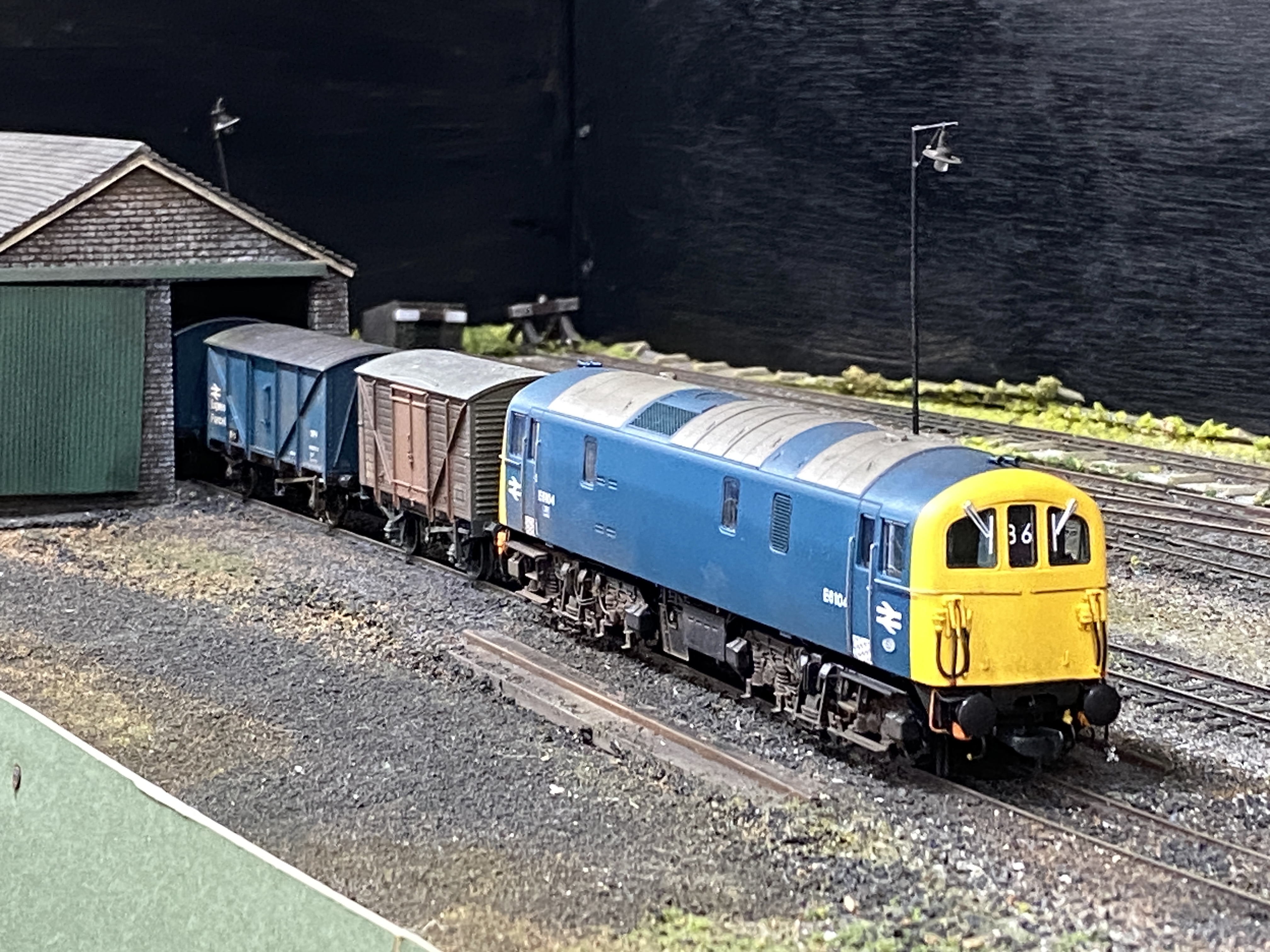

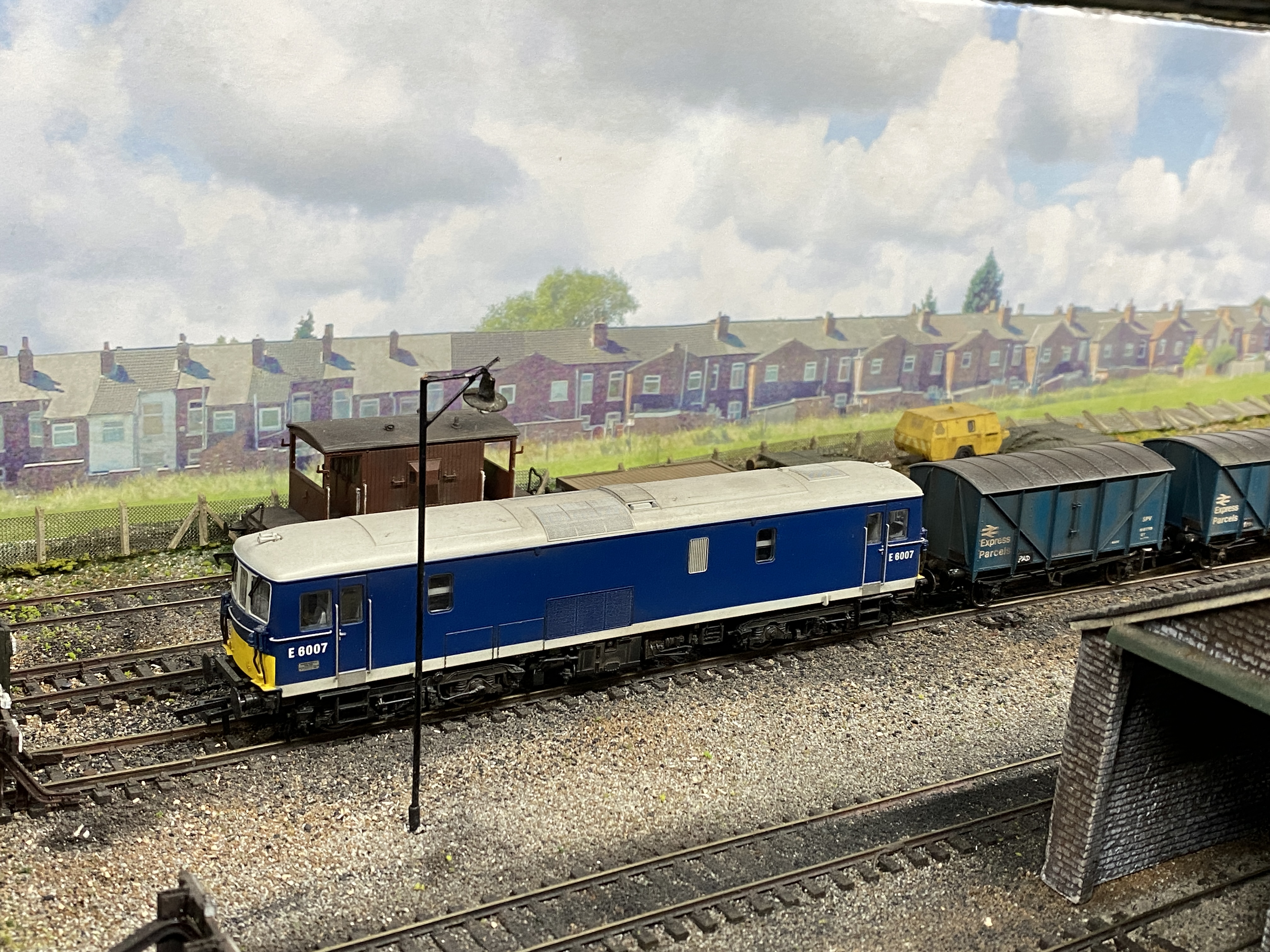

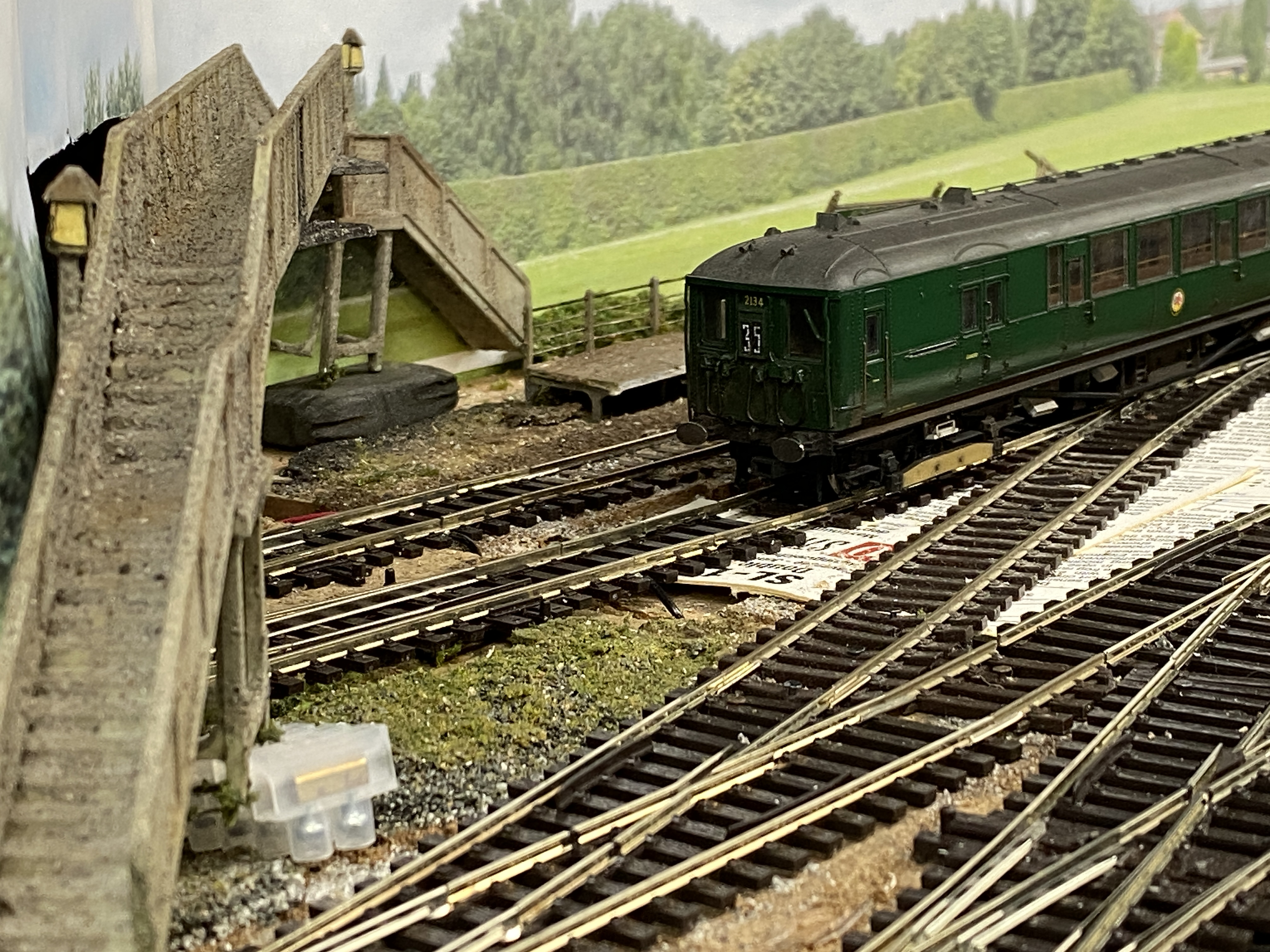

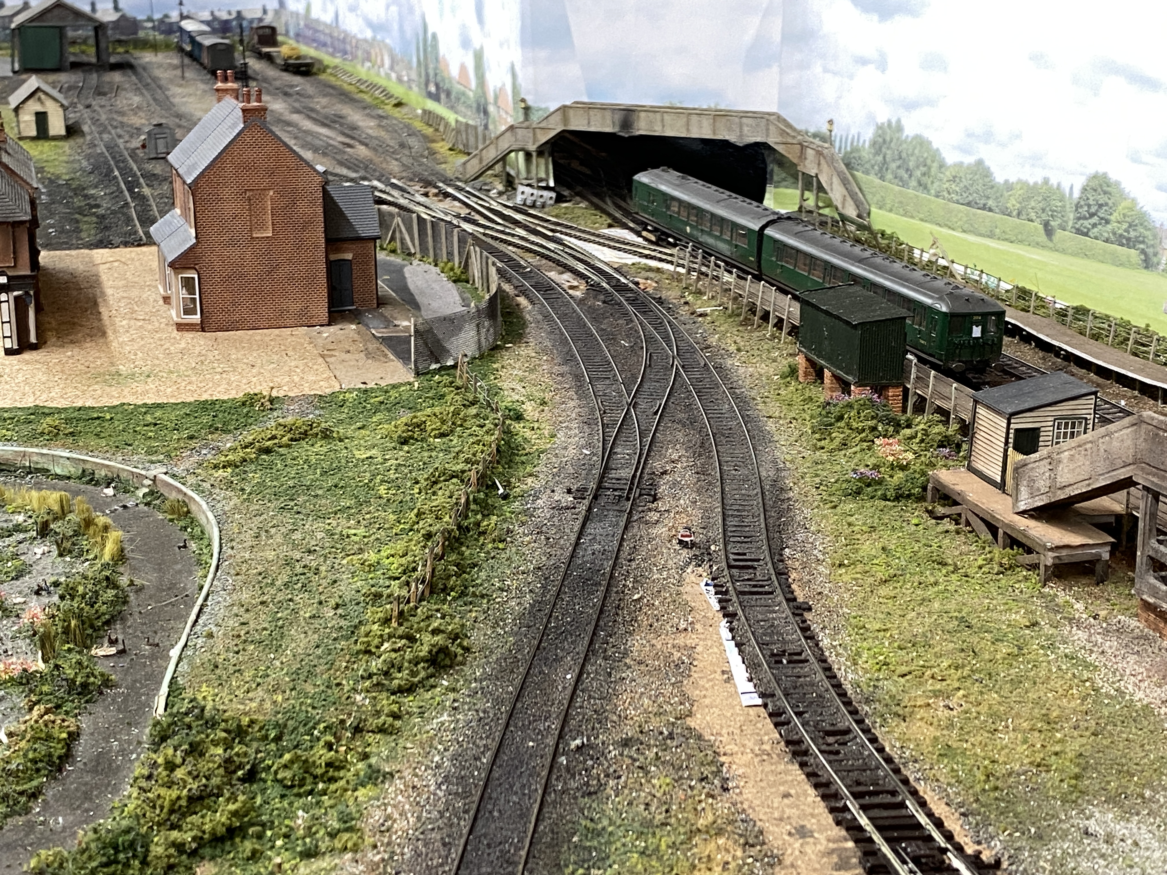

Today’s session in the clubroom resulted in power being wired to the goods lines. Not yet into the yard as that requires the double-slip to be wired and the board-join to be bridged with plug-in choc-blocks. Maybe next week eh?
More backscene was applied; the full viewing area is now fitted though a little tidying-up is needed where trees, clouds and buildings don’t quite match at the joins.
The first appearance of a varnished 2-Bil unit was recorded.  An early-blue EDL has arrived in the yard which has more scenic work appearing. Including the shunter’s mess relocated from the back to the front of the scene.

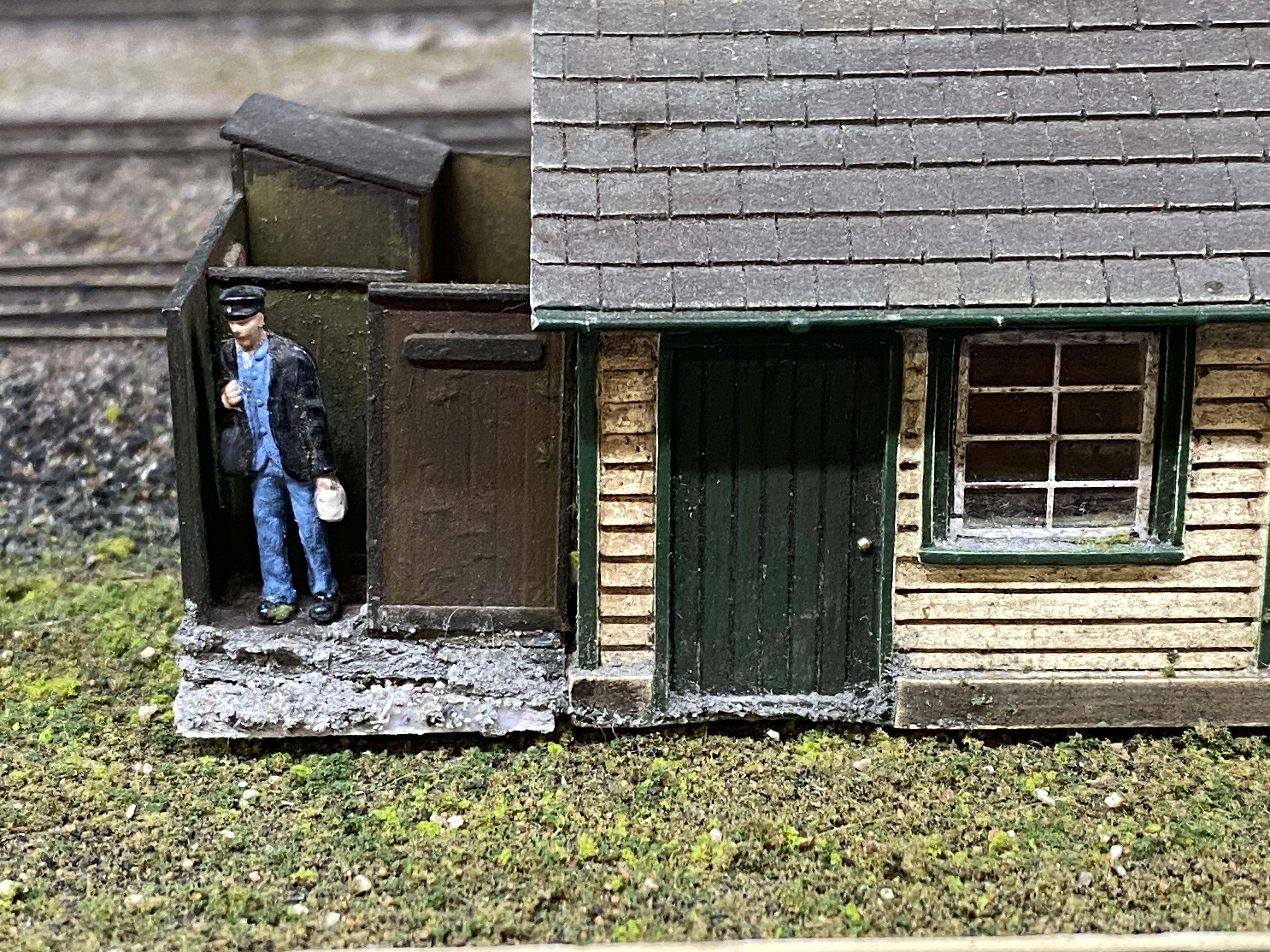

Looking very good Rick.  I like the guy staggering out of the loo - one wonders what he's got in his billy-can ……………….:07rolleyes_2:

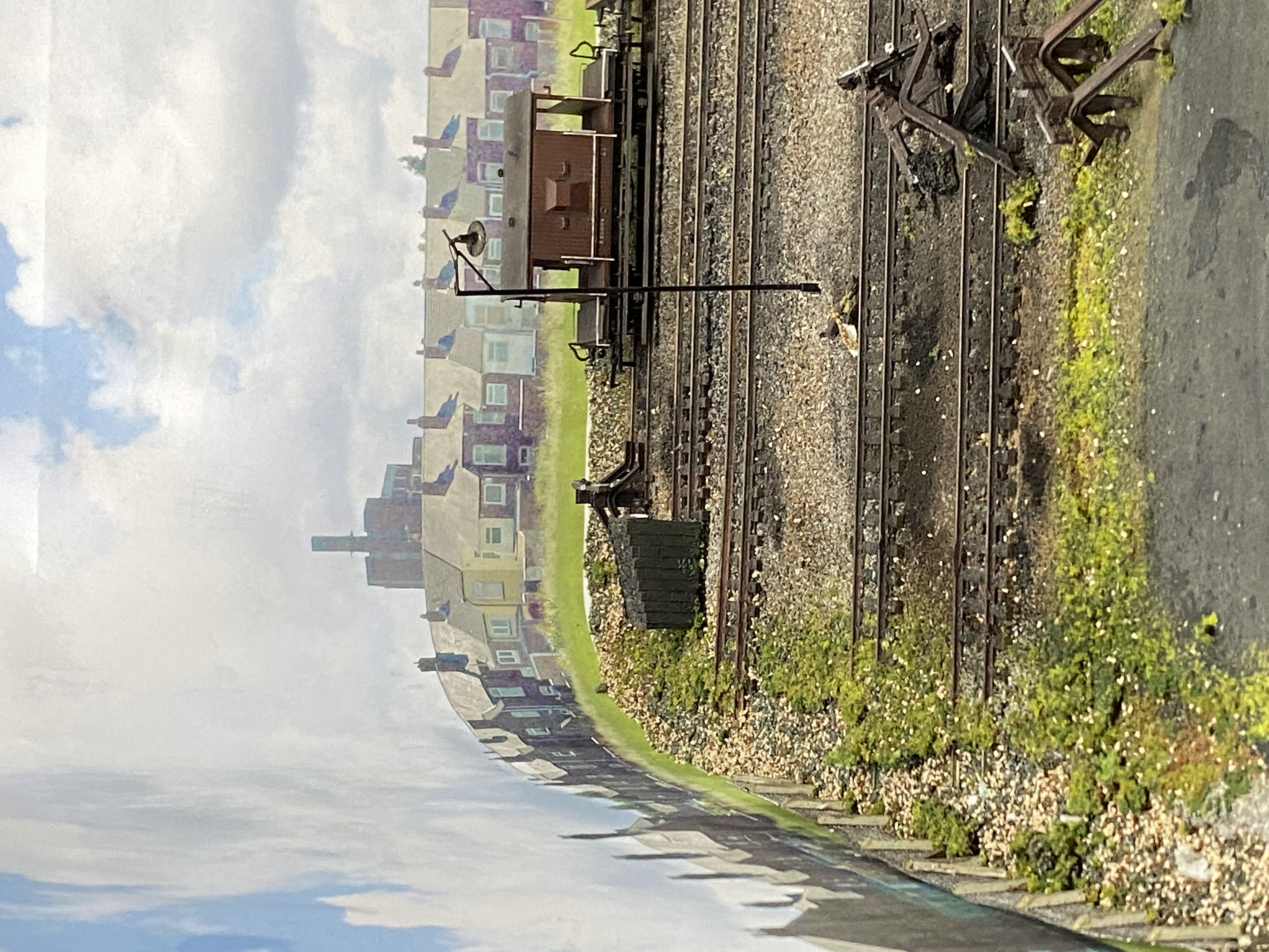

What is the backscene - looks the part and fits in nicely.
Item has a rating of 5
#293202
The backscene is ID Backscenes "Into The Town" packs 107A, B and C.  Not all of the six panels in those packs has been used.  These are the self-adhesive version.  I started out with wallpaper paste and plain-paper ones but have overlaid the self-adhesive versions.  In a damp clubroom wallpaper paste took too long to go off.  Other adhesives are available but some are not ideal for bubble-free backscene fitting.  The self-adhesive ones are fine and can be eased away from the wood and re-fixed if needed.  Never let them stick to themselves though!  That ruins the printed surface.
I think we can assume our man at the grotty has relieved himself of the one-time contents of his billy-can!

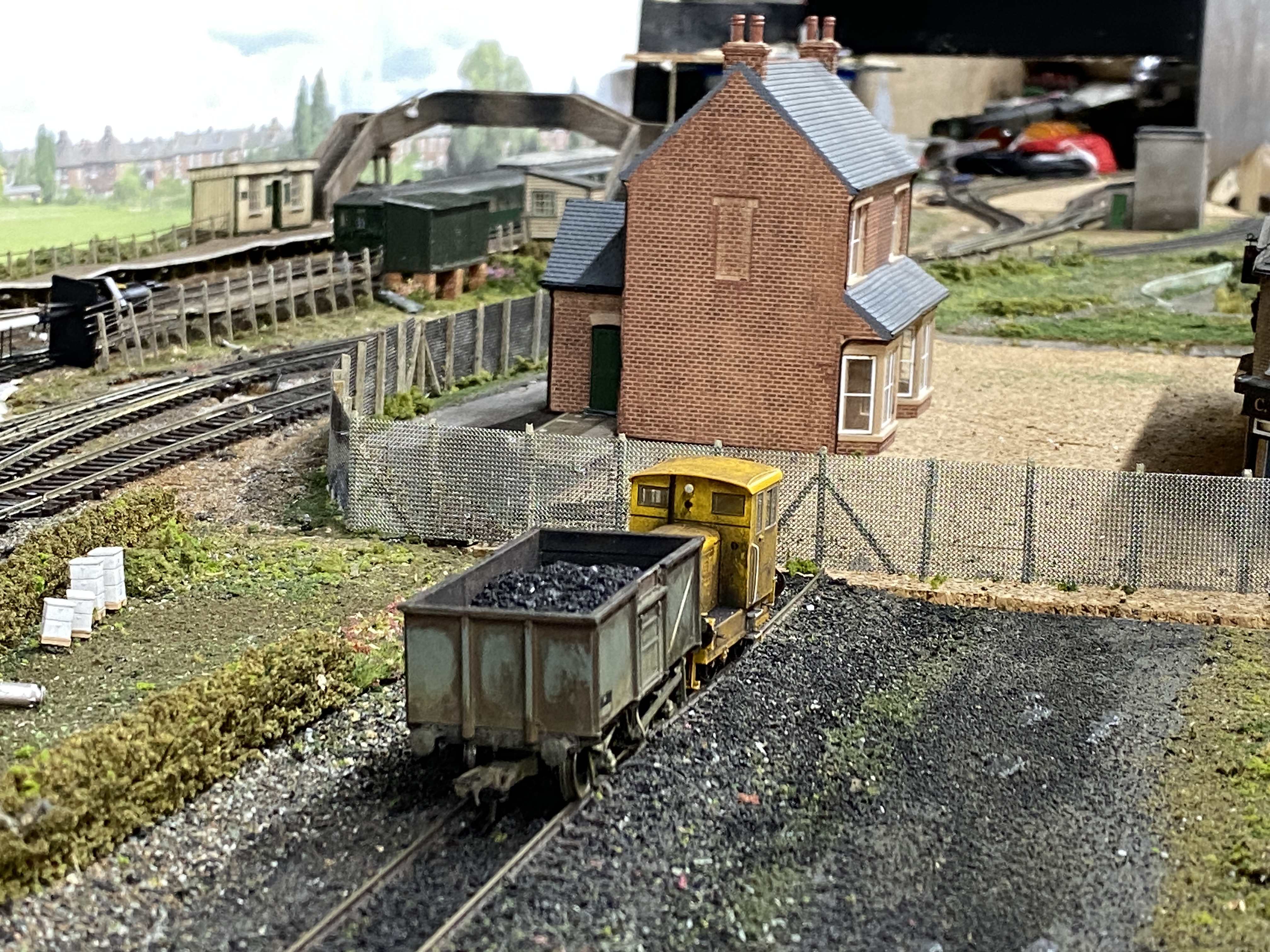

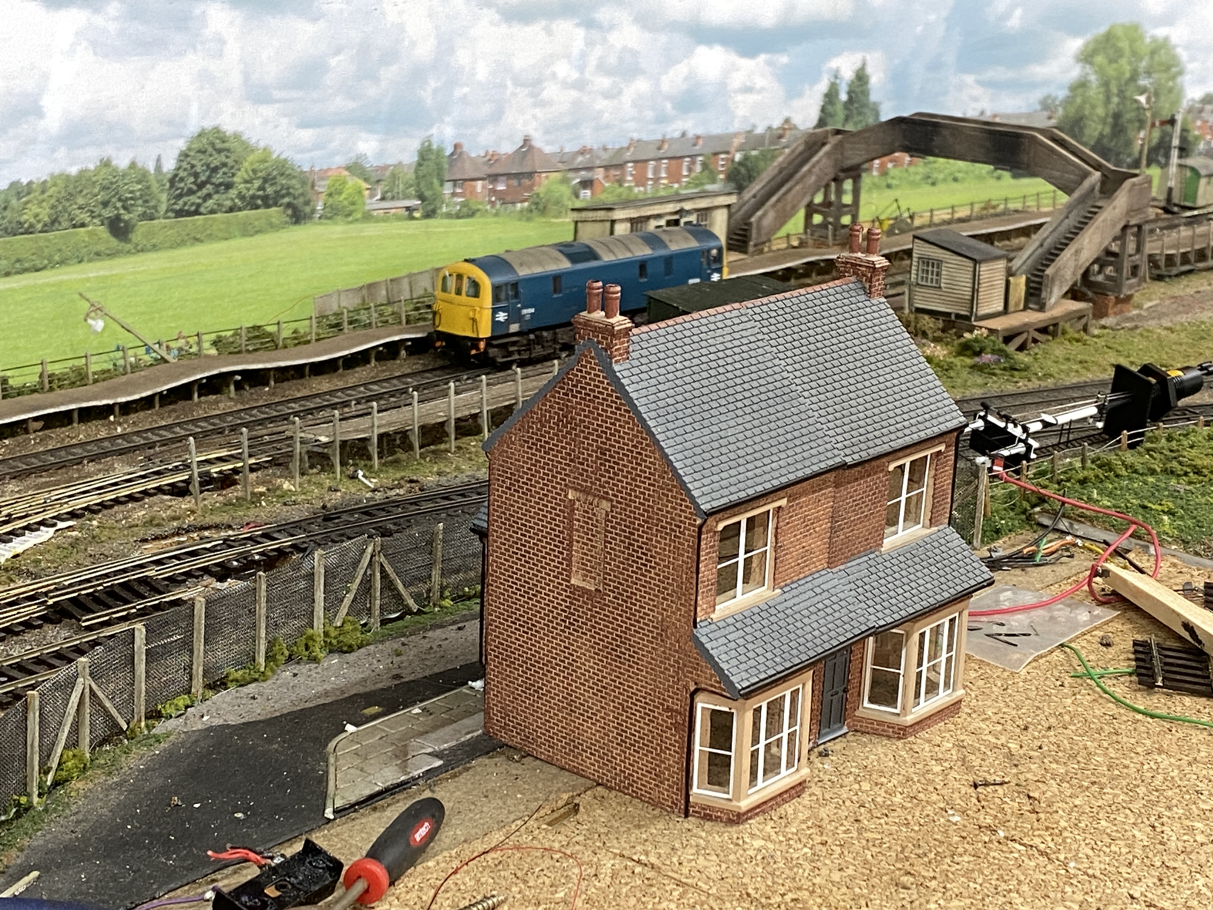

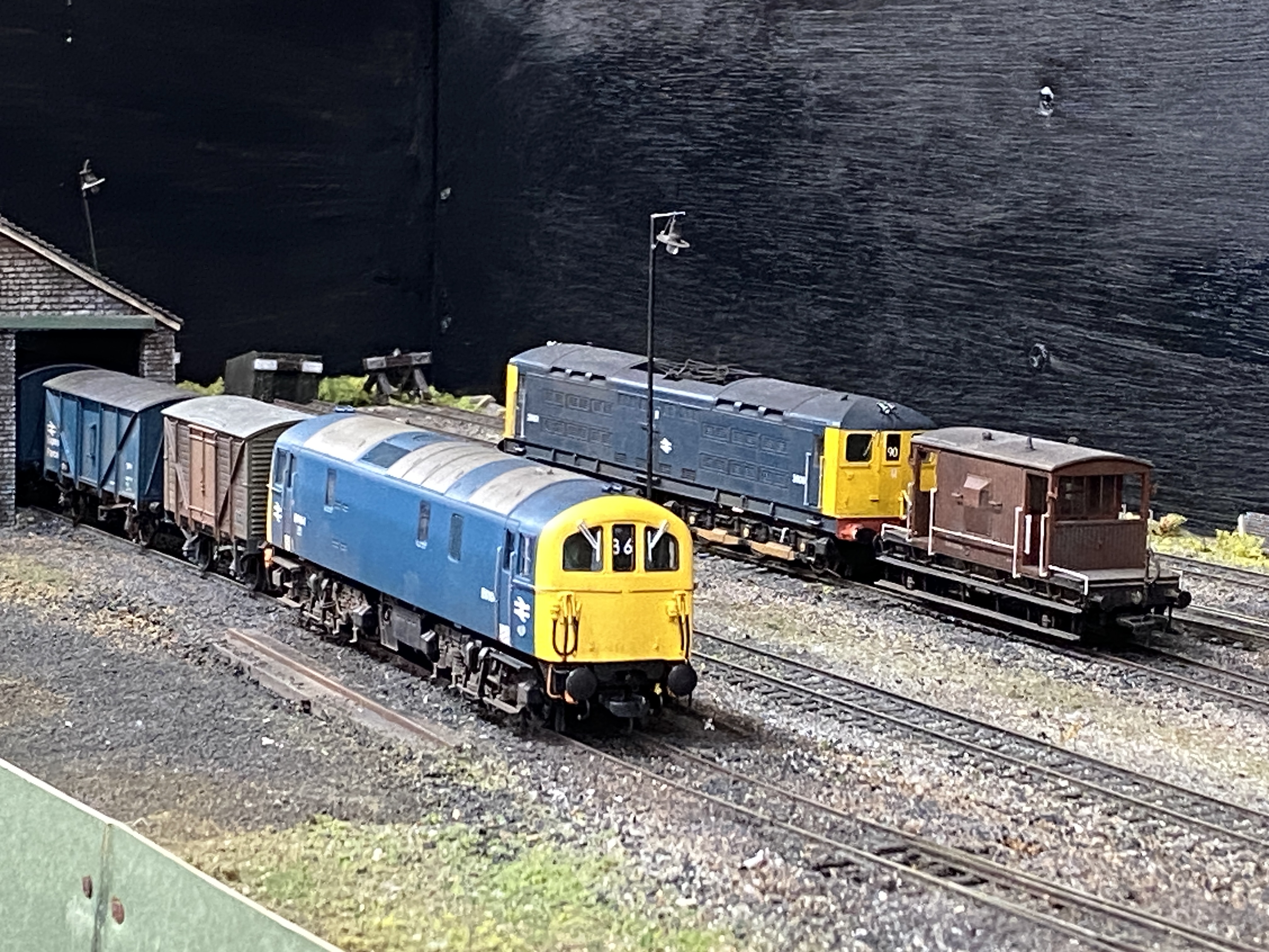

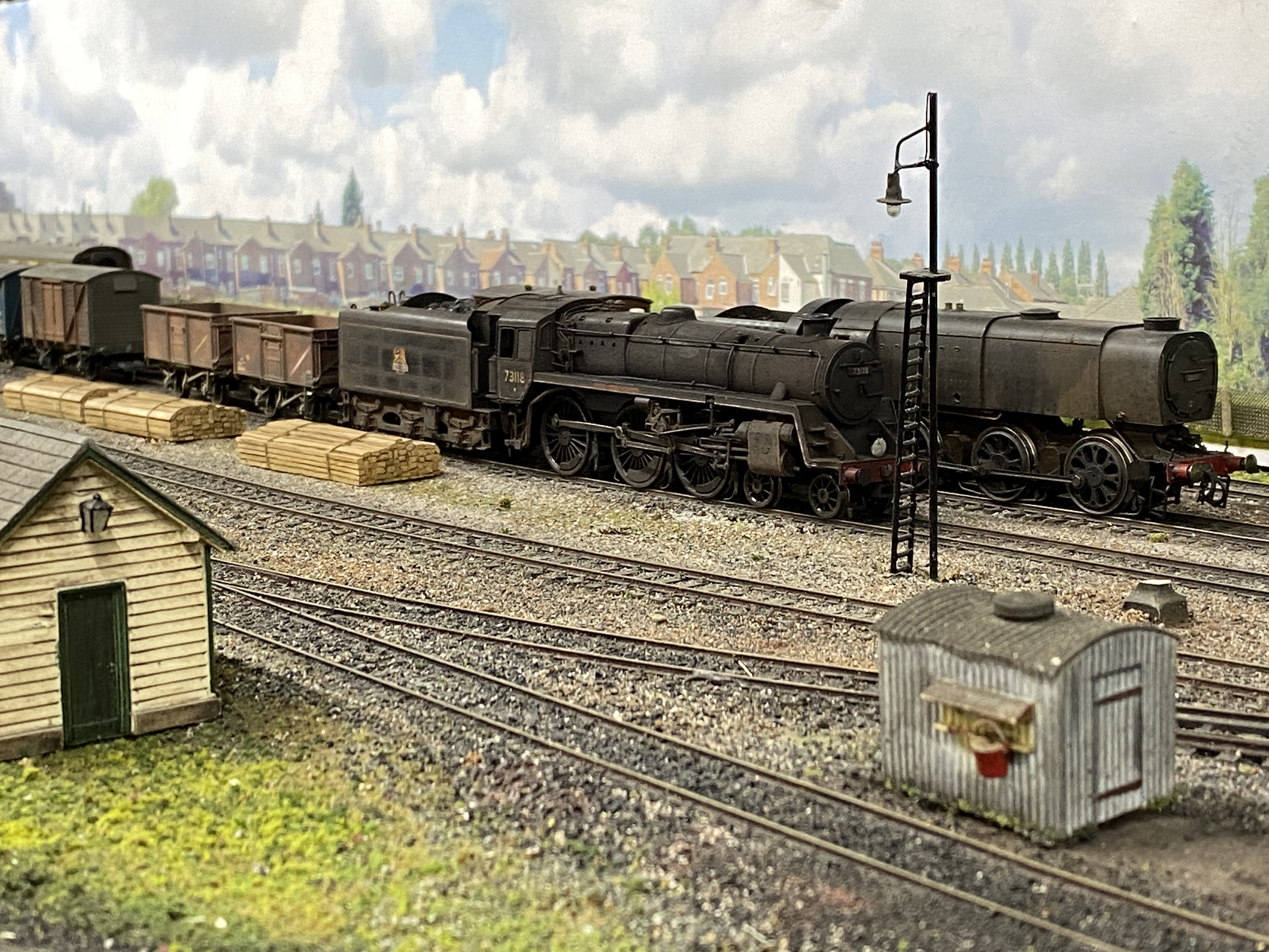

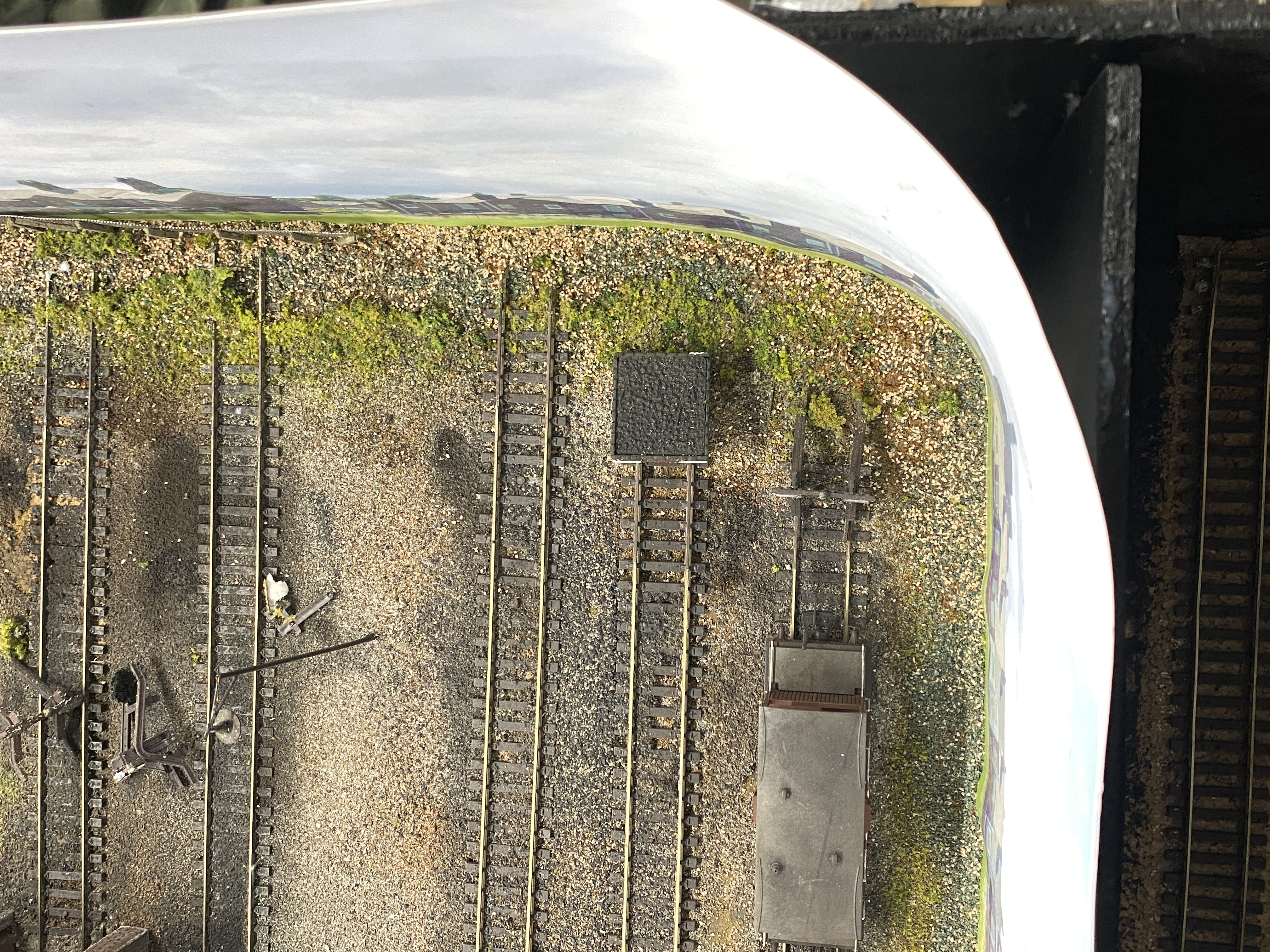

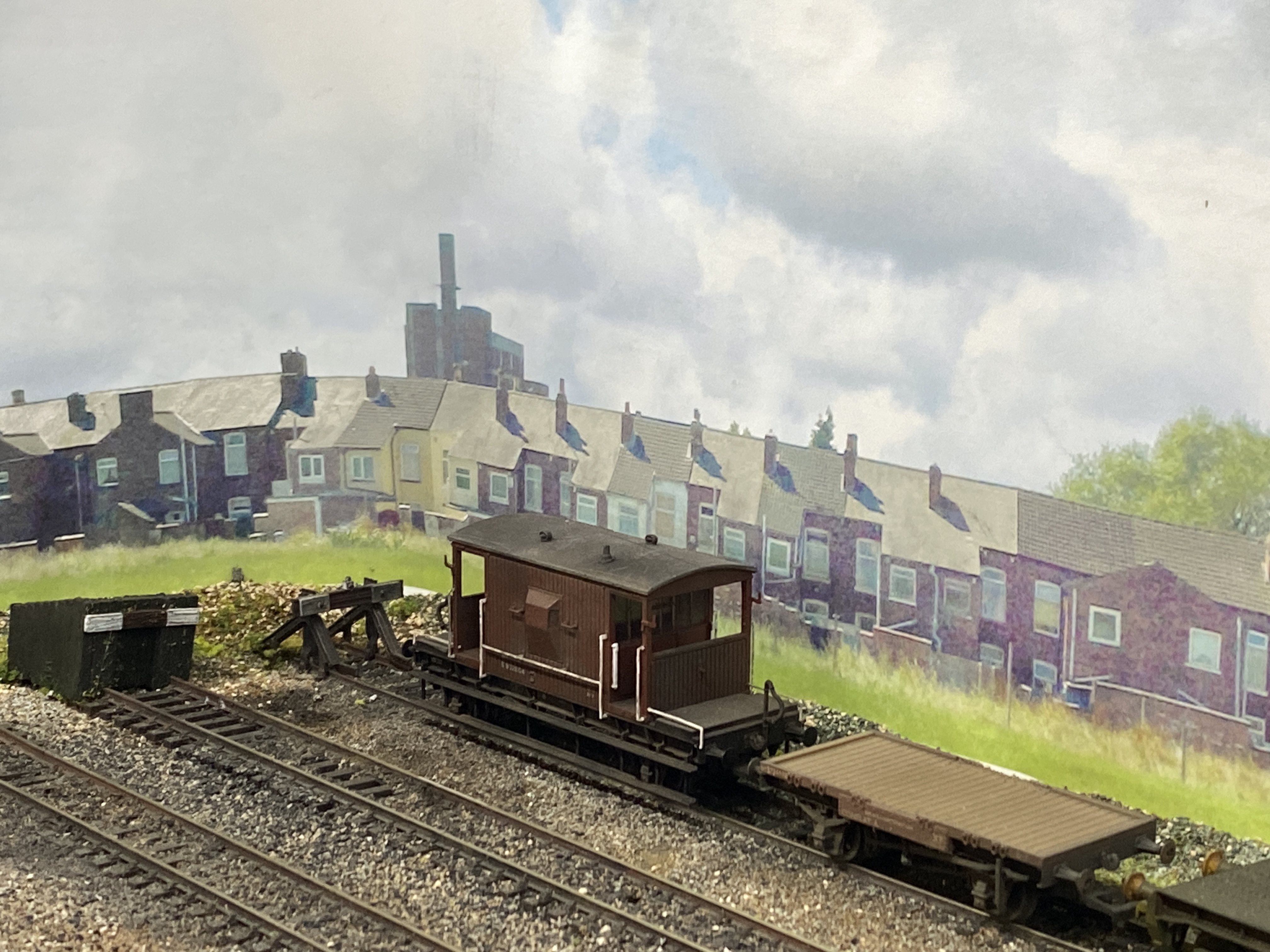

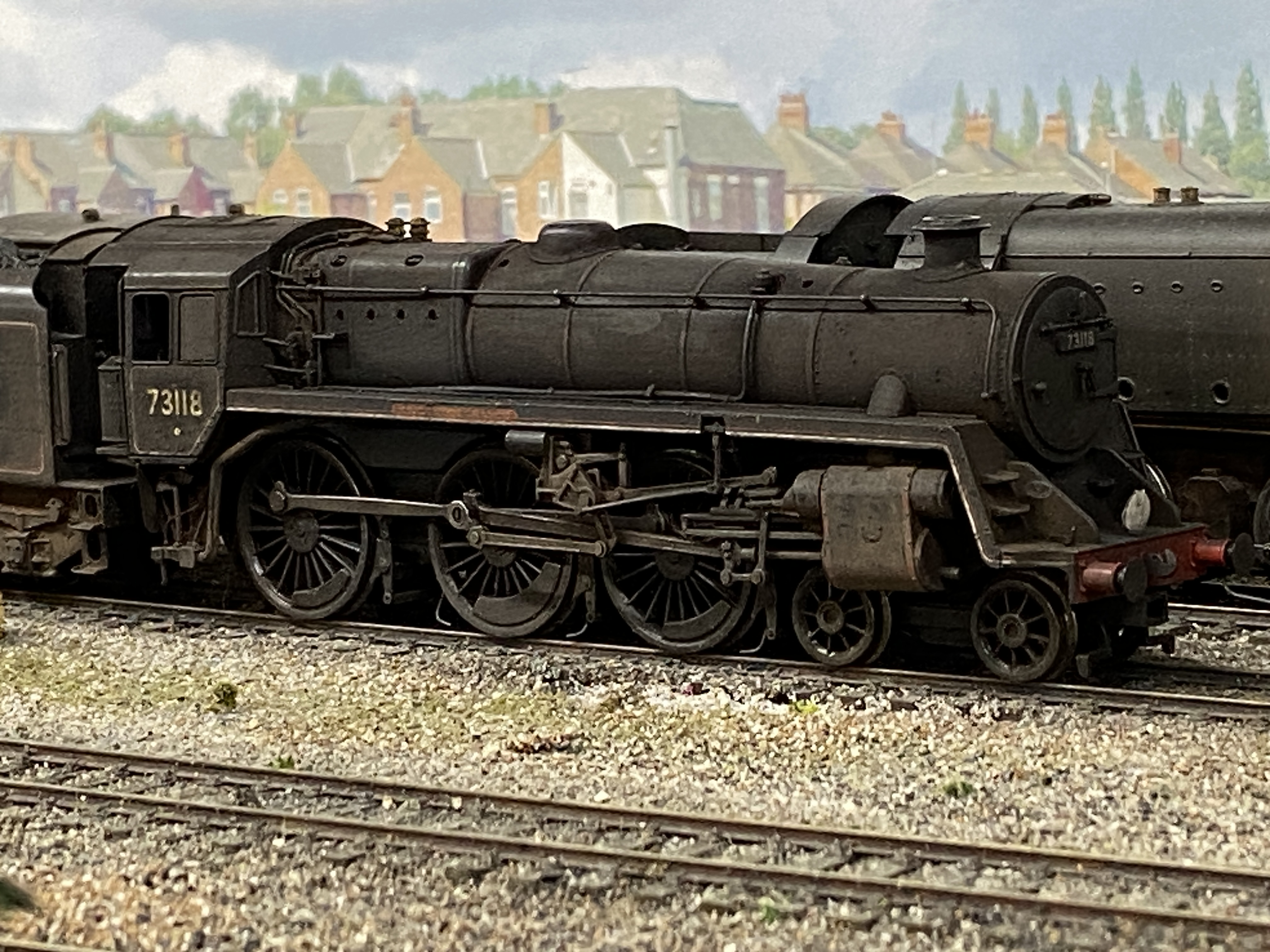

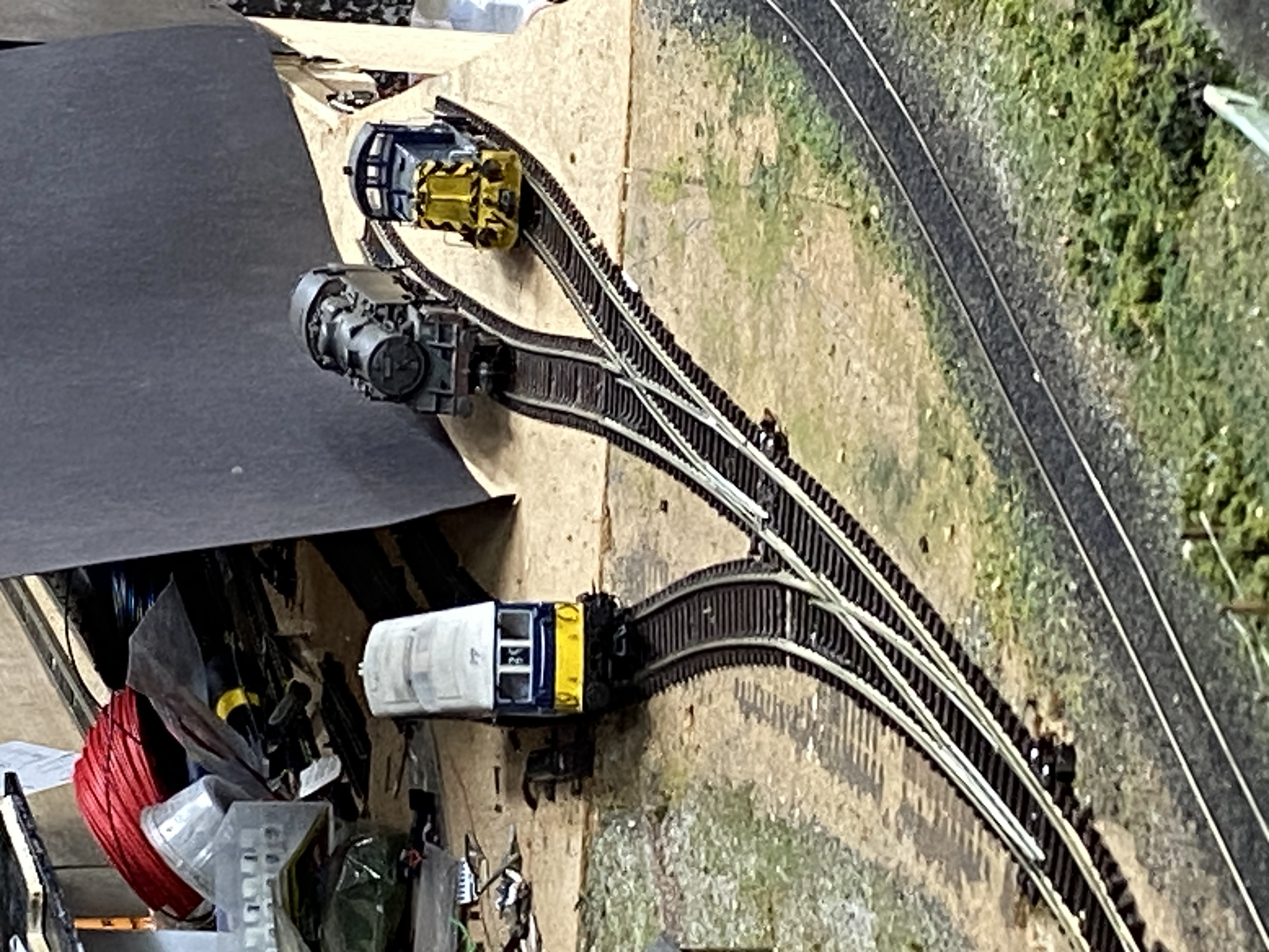

Three damp and cold hours in the club room ended with progress having been made.
The self-adhesive backscenes fitted last week had not adhered to the wood so were encouraged with some wallpaper paste today. Some of the goods yard fence has been glued back into place.
The track was finally connected between fiddle yard, goods lines and the new loco sidings; there are only two of the latter not the planned three due to space constraints.
A sheet of black card is placed where a permanent scene will be fitted.  The 73 is on the goods line and the two new sidings are occupied.
A BR Standard and a Q1 are seen in the yard where the condemned Mk1 coach has reappeared. And the 4-wheel shunter is once again parked on the Merchant’s Siding with a coal wagon. The buildings will be new positions as shown but there will still be a coal bunker (or staithe) and the little coal delivery float will return.
IMG_0771.jpeg IMG_0770.jpeg IMG_0769.jpeg IMG_0768.jpeg IMG_0767.jpeg IMG_0766.jpeg
