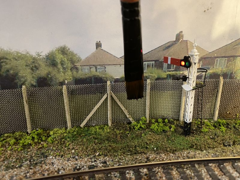

A little work was completed today weathering the chain-link fence which runs alongside the railway for the length of the goods yard.
The paint mix is 4 parts Woodland Scenics Raw Umber, 1 part Woodland Scenics Black and 1 part Railmatch Rust. This was carefully let down a drop at a time with wet water until reaching an airbrush consistency - that of milk.
The mesh was painted using a wet no.12 flat Renoir brush. Corners were touched in using a round no.10 Renoir.
The posts, previously painted in Railmatch concrete beforeassembly and fitting, were then dry-brushed with the no.10.
The “before and after” difference is intentionally subtle.
