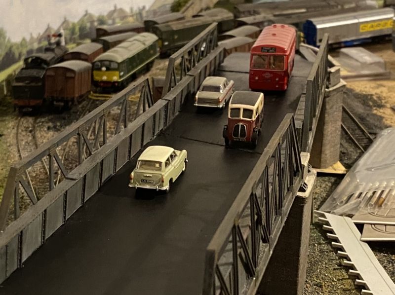

Little bits of fiddling don’t seem to achieve much at the time but they add up. Recent fiddling has seen the girder bridge assembled into one piece and the roadway laid and painted. The footpath is yet to go down and a small gap remains to be filled in the side girders caused by the slight angle between the two spans. The latter is cut and painted but awaits the paint drying before fitting.
This isn’t in its final position of course but there is nowhere else I can place a long rigid object to work on it.

And the footpath goes in. Metcalfe self-adhesive pavers which I find require a dab of glue to adhere reliably
Last edit: by Gwiwer

Nice track weathering Rick - what did you use ?
Regarding the Metcalfe pavoirs, I find them a bit too "hefty" for my tastes.  They may well be the right size - I've never measured them so don't really know - but the joints look like crevises.  I think they're just too thick and much prefer the Scalescenes version…………………..just my opinion.  :cheers

The track weathering is Woodland Scenics black mixed with Railmatch rust. For the check rails I painted them with just rust first before the top coat. That was a different mix to the running rails using a greater proportion of rust to black
Those paving slabs are a bit chunky but they stand about a scale six inches above the road surface which looks right. The gaps are quite noticeable but this can be eased when weathering powder is applied as that sits in the cracks. One benefit of using individual pavers is they take on the slight curve along the length of the bridge.
