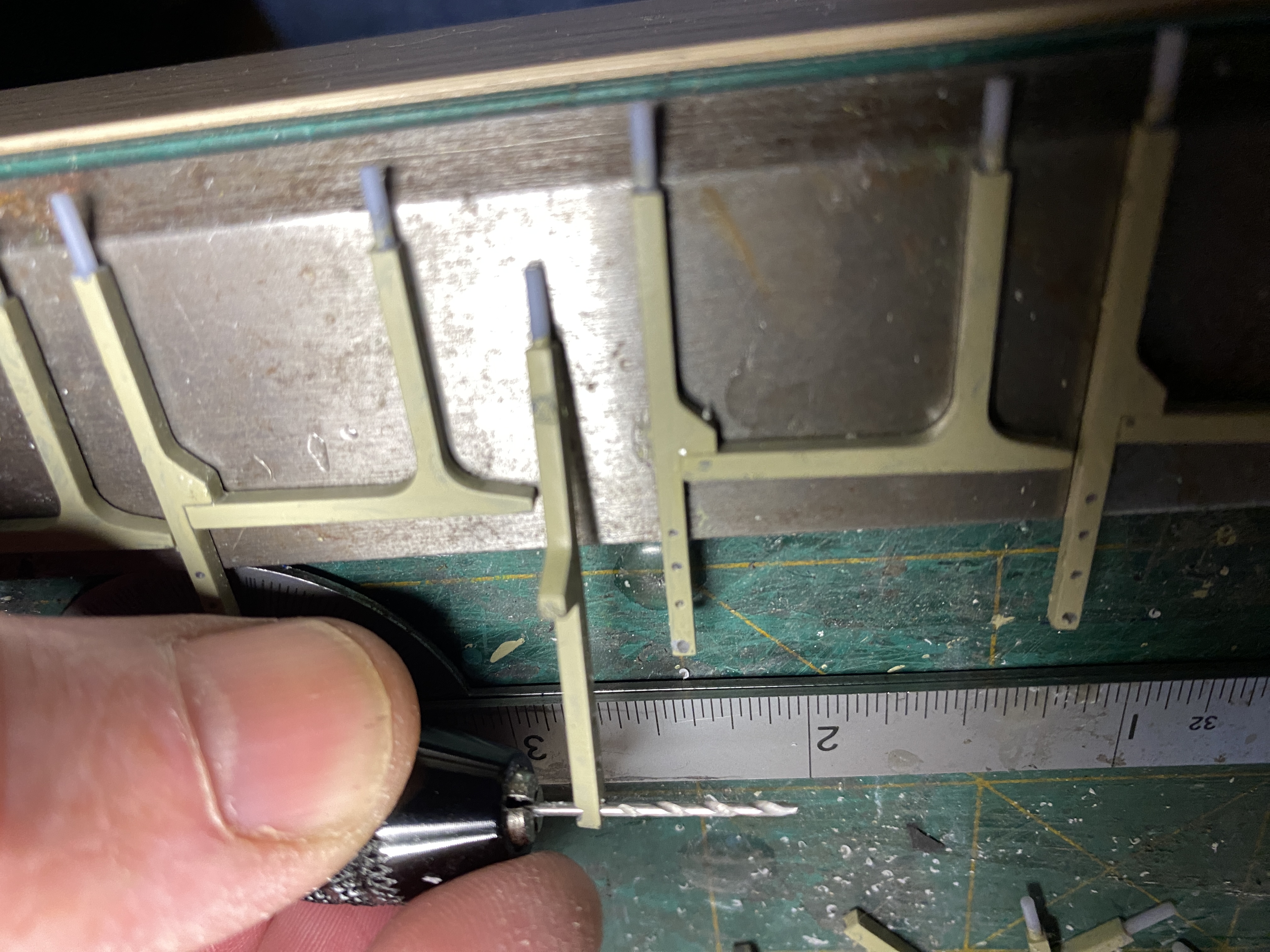

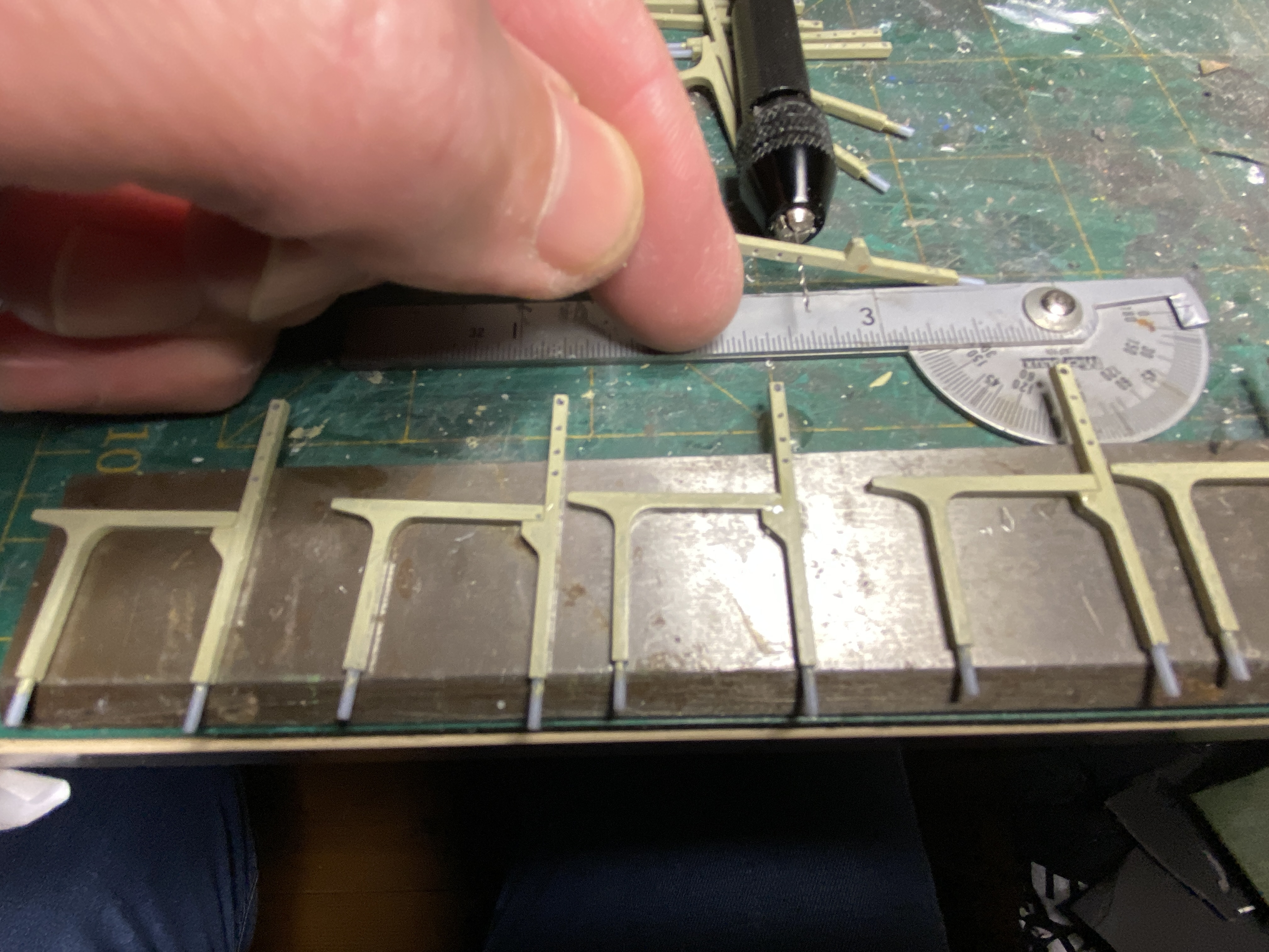

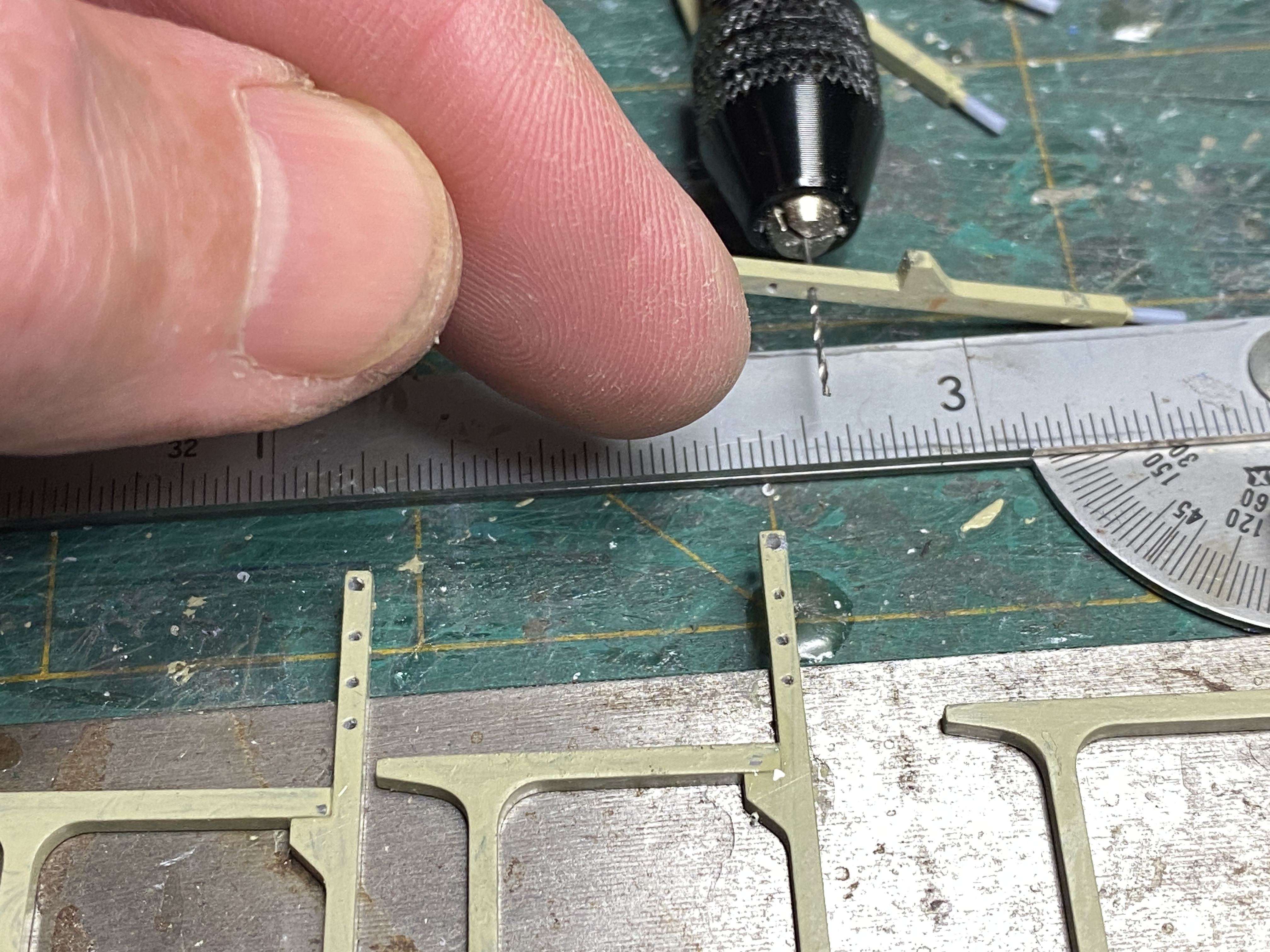

The slight alterations to the platform positions require some new “concrete” legs to be built up.
These are from Dart Castings but are now supplied as 3D-printed plastic rather than cast white metal.
They still need to be painted and the two pieces stuck together. And as with the metal ones the holes for fence wire need to be cleanly drilled out.
0.6mm for the three lower piano-wire strands and 1.0mm for the brass rod at the top.

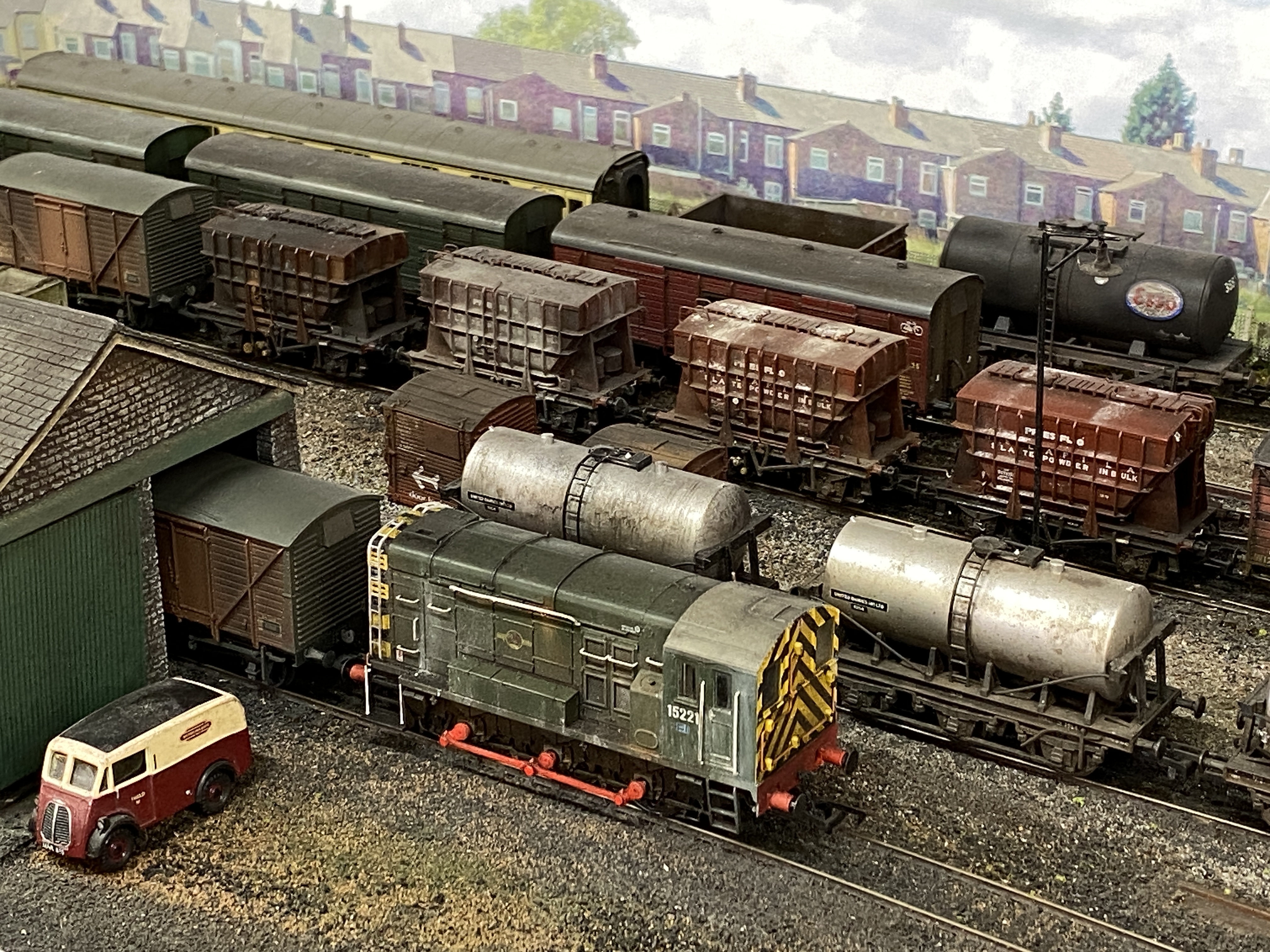

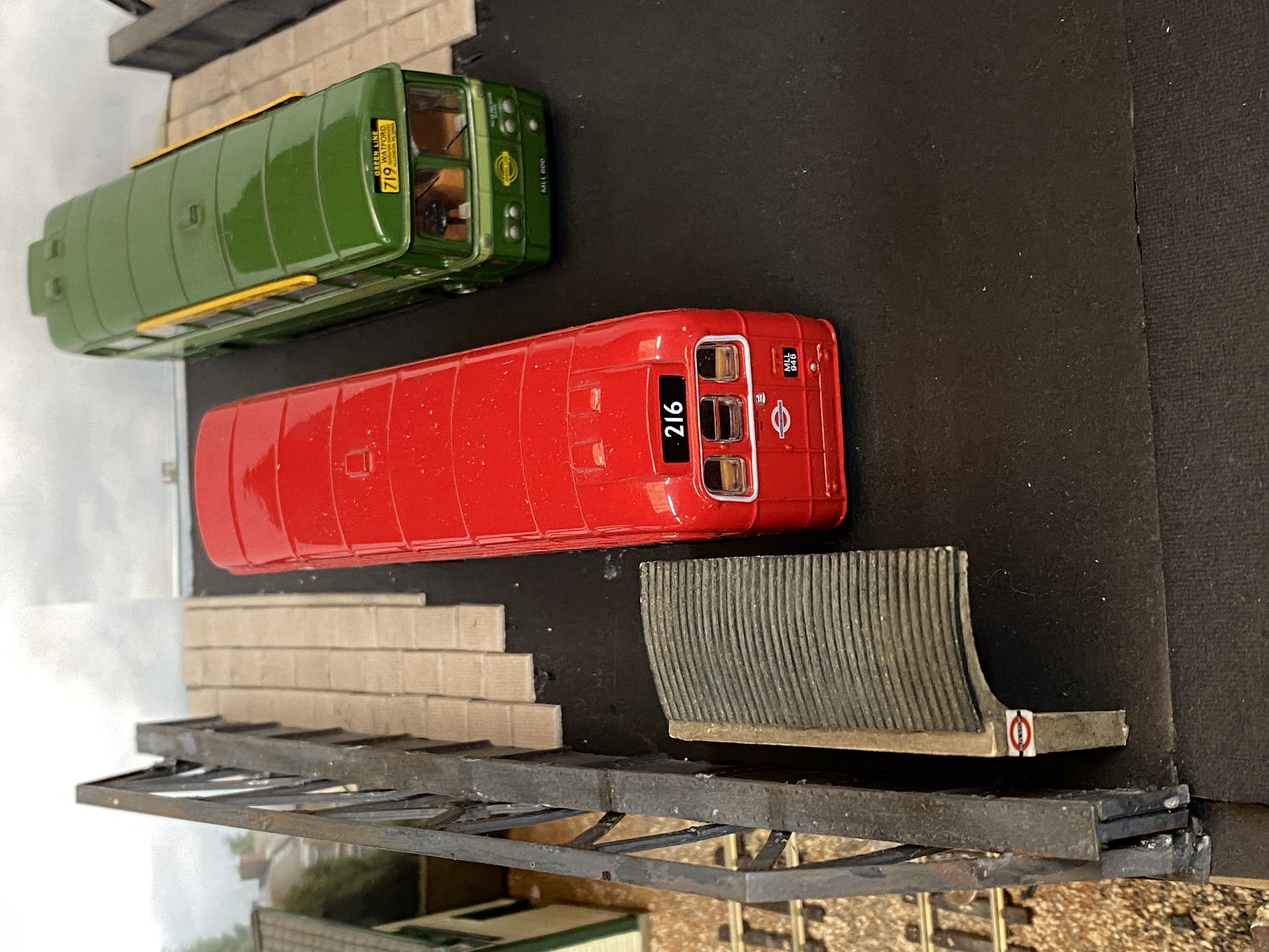

A short afternoon alone in the clubroom saw some progress today. Not a normal club day but we can come and go when we please and I cannot manage the usual Wednesday sessions this month. The car is required elsewhere.
The road bridge footpath was begun. Each paver is individually laid then squared off so it takes time.
Two short lengths of track were replaced at the “London end” of the passenger line. That will give a much smoother run across the board join out of the fiddle yard.
More rolling stock has returned from store including one of the blue 2-EPB sets and most of the Presflo rake.
IMG_1051.jpeg IMG_1052.jpeg IMG_1053.jpeg IMG_1054.jpeg IMG_1055.jpeg IMG_1057.jpeg

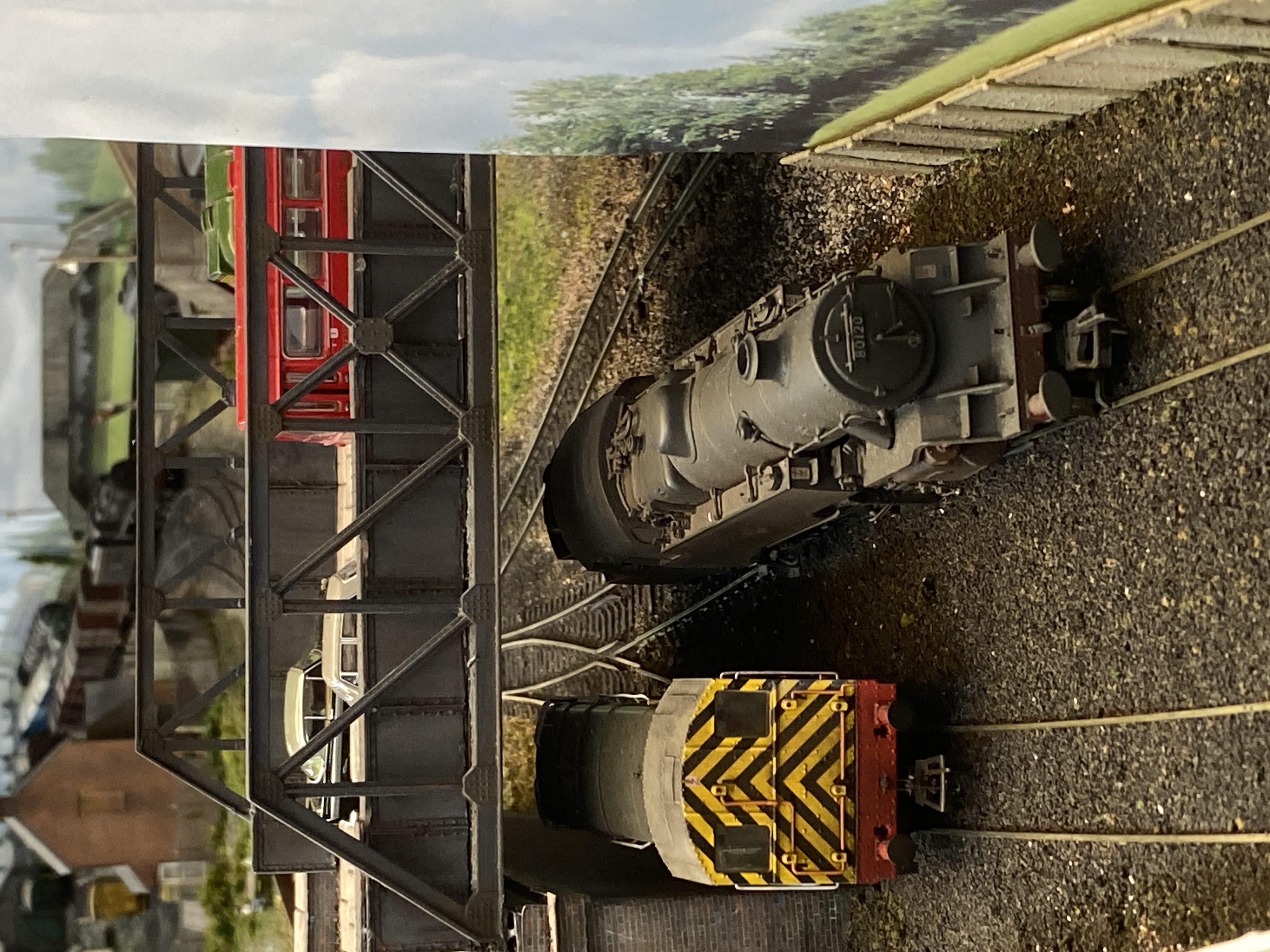

A new yard crane is required and has been build from a Wills kit. After painting in olive green the completed kit was then heavily weathered with rust, grime and some patches of white  / grey.  This is now loosely placed in position pending the construction of a permanent concrete base.
The footpaths over the girder bridge are fundamentally complete and only require ends trimming.  The road surface received a coat of mixed grey and black paint and will be over-brushed with weathering powder before application of the white lines.  Small brass-etched gratings have been stuck to the surface.  Tiny details like this go un-noticed by most but add to the overall effect of realism.

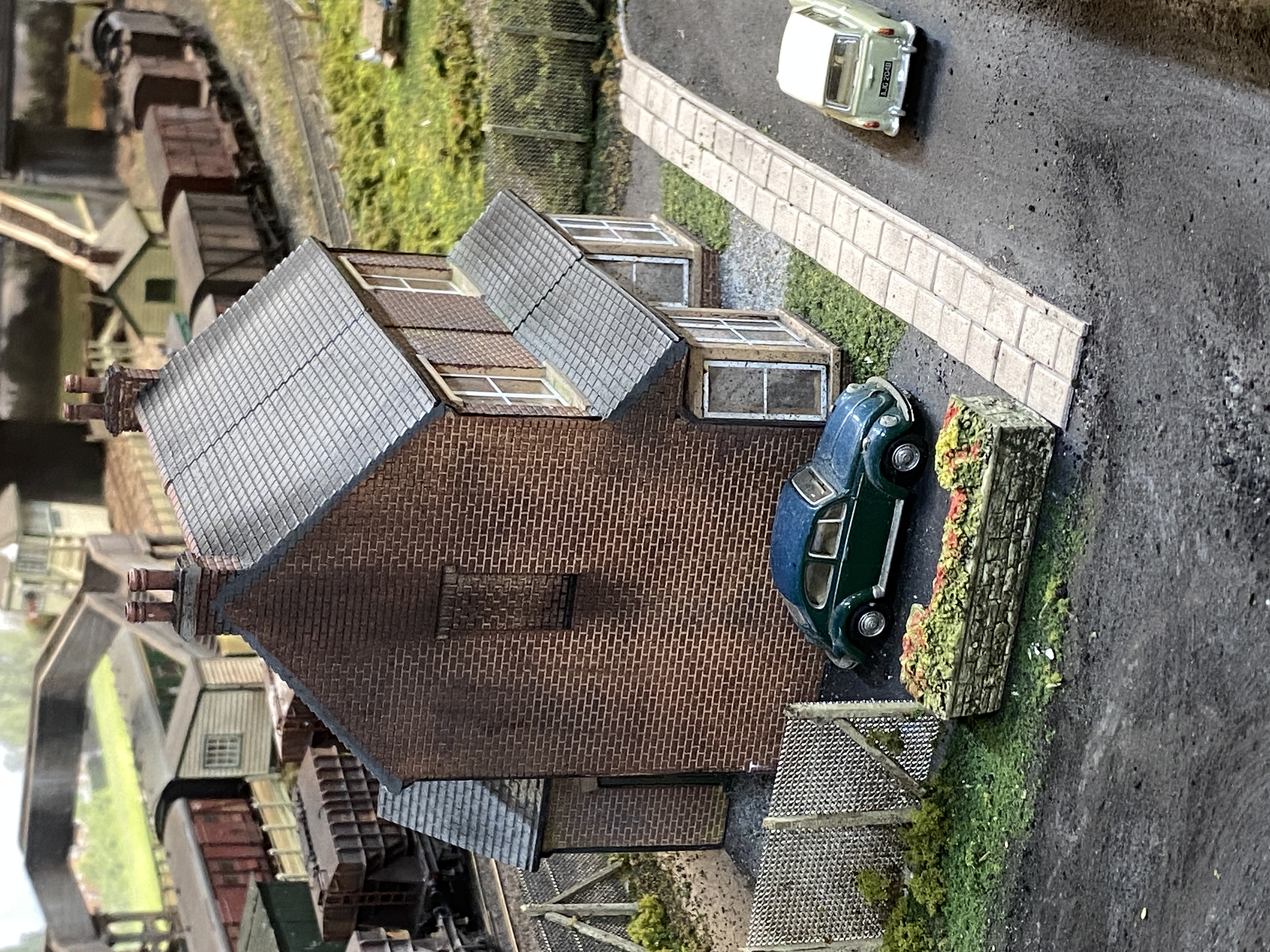

Today’s session was the last for a while due to forthcoming holidays.
The self-adhesive backscene has bubbled in the warmer weather but was left to hopefully sort itself out.
The road scene was brought near to completion by brushing a grey-black weathering powder along the road before adding the white lines. The footpath weathering and a few bits of infill remain to be dealt with.
The ground cover over much of the scene was refreshed and new paths laid to the re-sited mess room and newly arrived accommodation coach body. The stream was cleaned and the Waddle Marsh was wet for the first time in years.  The picnic tables have returned.
Finally the yard crane was fixed into place on a small base and the roadways around the yard were renovated.
Some of the seldom-used steam-hauled stock got runs on the club test track and were posed for photos on the layout.
IMG_1170.jpeg IMG_1171.jpeg IMG_1173.jpeg IMG_1174.jpeg IMG_1176.jpeg IMG_1177.jpeg IMG_1178.jpeg IMG_1179.jpeg

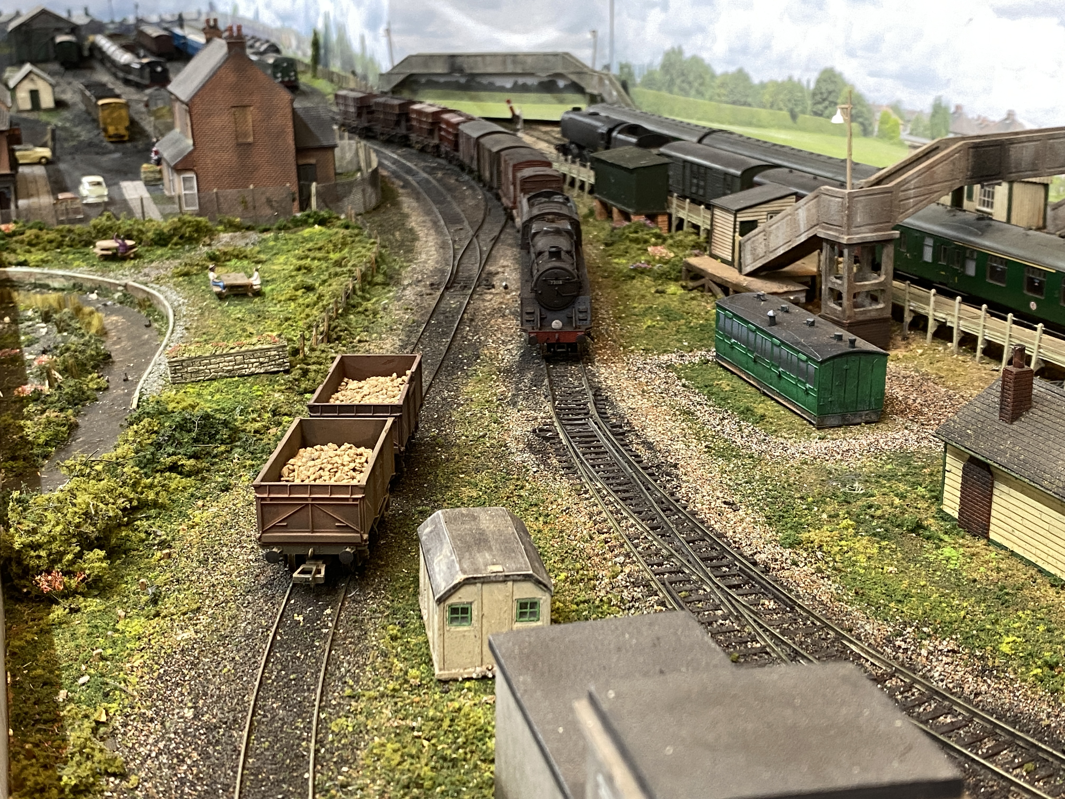

It's been a few weeks ….. and they have been busy ones but not necessarily with muddling.
However there has been progress on the layout which, scenically, is now well advanced.  The paste-on new paper back scenes are up replacing the self-bubbling stick-on ones.  Same views, better result.  More groundwork has been done and the new platforms are down.  I'm not yet happy with the colour.  Both concrete footbridges have been fixed back into place and equipped with working lamps.  The wiring to the lamps is far from complete; they have been tested on a battery for now.
I had a points failure a couple of weeks back.  The locking spring on a point forming part of the custom-built crossover-with-double-slips unit popped out of its locating point.  As it happens this is right underneath the road bridge and despite my efforts for over two hours to relocate it the darned thing would not go back into place.  The road bridge was gently teased out from its fixed position and the point repaired within moments!  The bridge now requires re-fixing and repair but as it also needs some detailing improved upon I can attend to the whole job one day soon.
Wiring is basic at present but allows test operation of the passenger lines and of the route from them into part of the goods yard.  All works.  Some isolation is needed to deal with backfeeds and the use of "unifrog" points which are not self-isolating in every situation.  Not hard.
A selection of SR and WR trains is shown below.

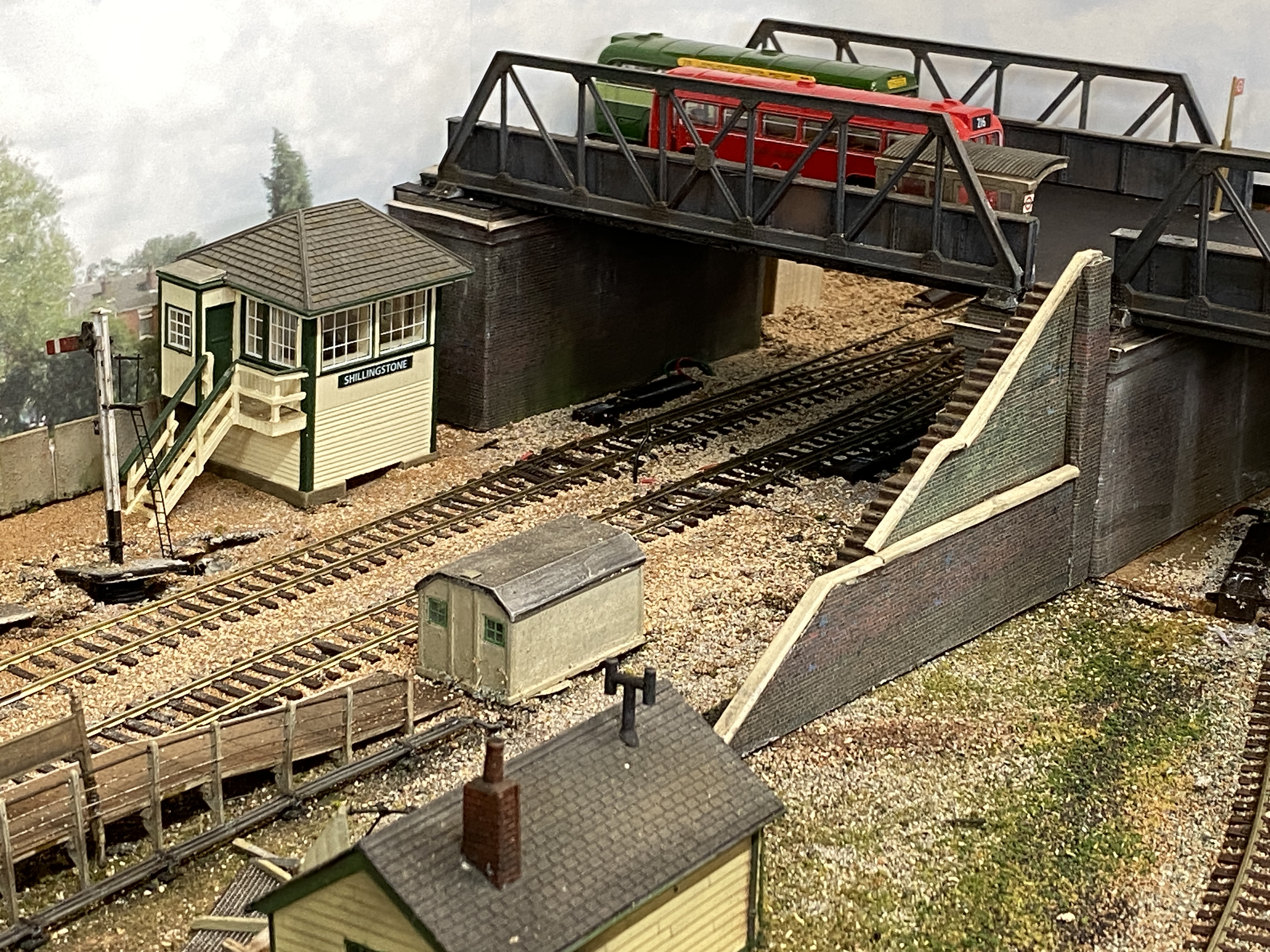

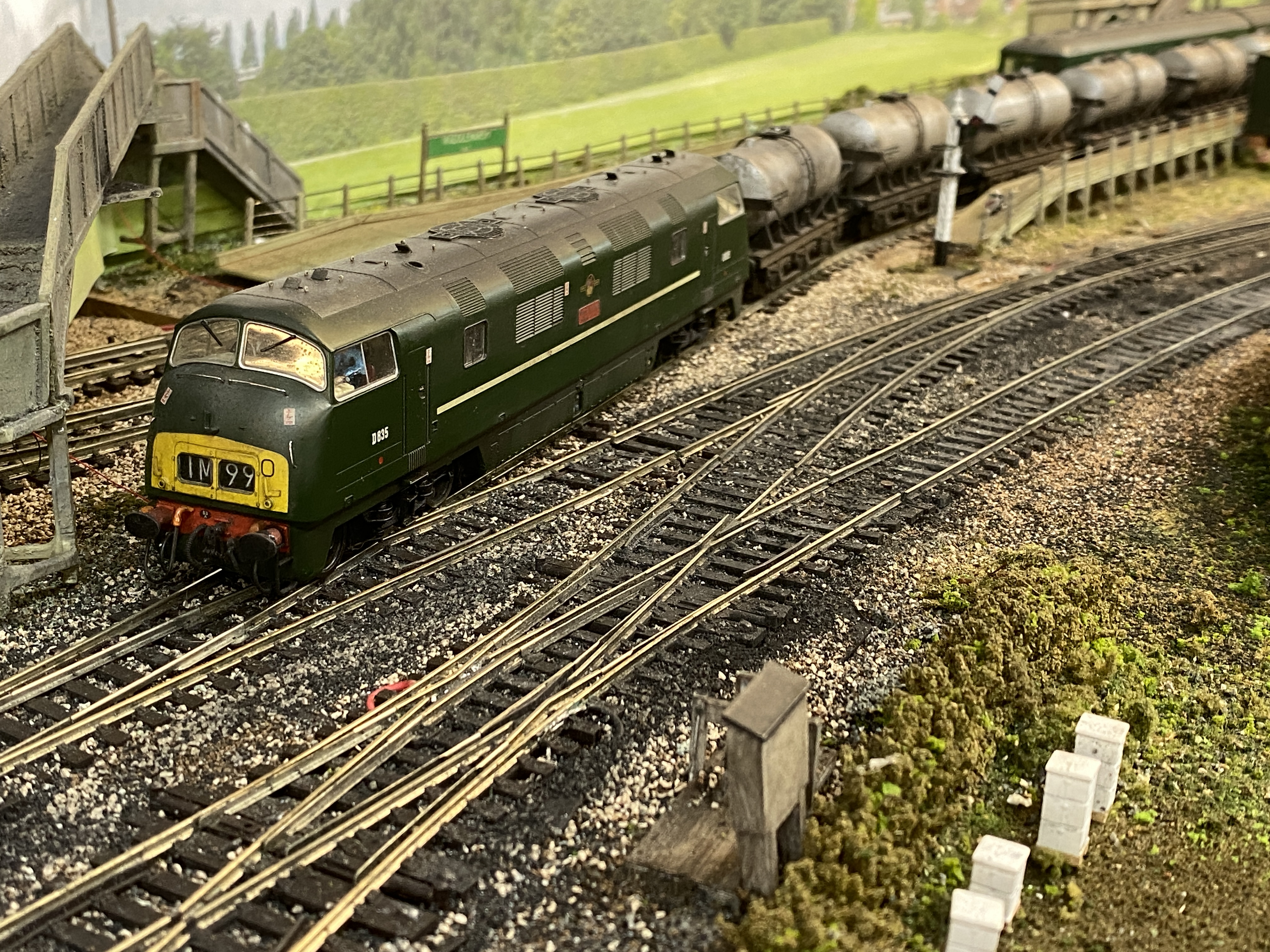

Some jobs take ages and seem to achieve little. But the overall scene is still taking shape.
Today saw concrete fences fitted around the railway, wooden fences fitted to Waddlemarsh cottages and the first length of conductor rail restored.  The platforms have been weathered and are a slightly better colour.
As I found before some stock clips or nudges the conductor rail meaning fine-tuning of its position is needed. The Hornby 2-BIL units are just ok as is the Dapol 73 shown. But the Kernow class 74 strikes it firmly and needs something on its bogies looking at to determine a “fix”.  Bachmann CEP / EPB stock is fine.
Today also saw some proving runs with a 4-CEP unit but I wasn’t able to capture one. Next time …..

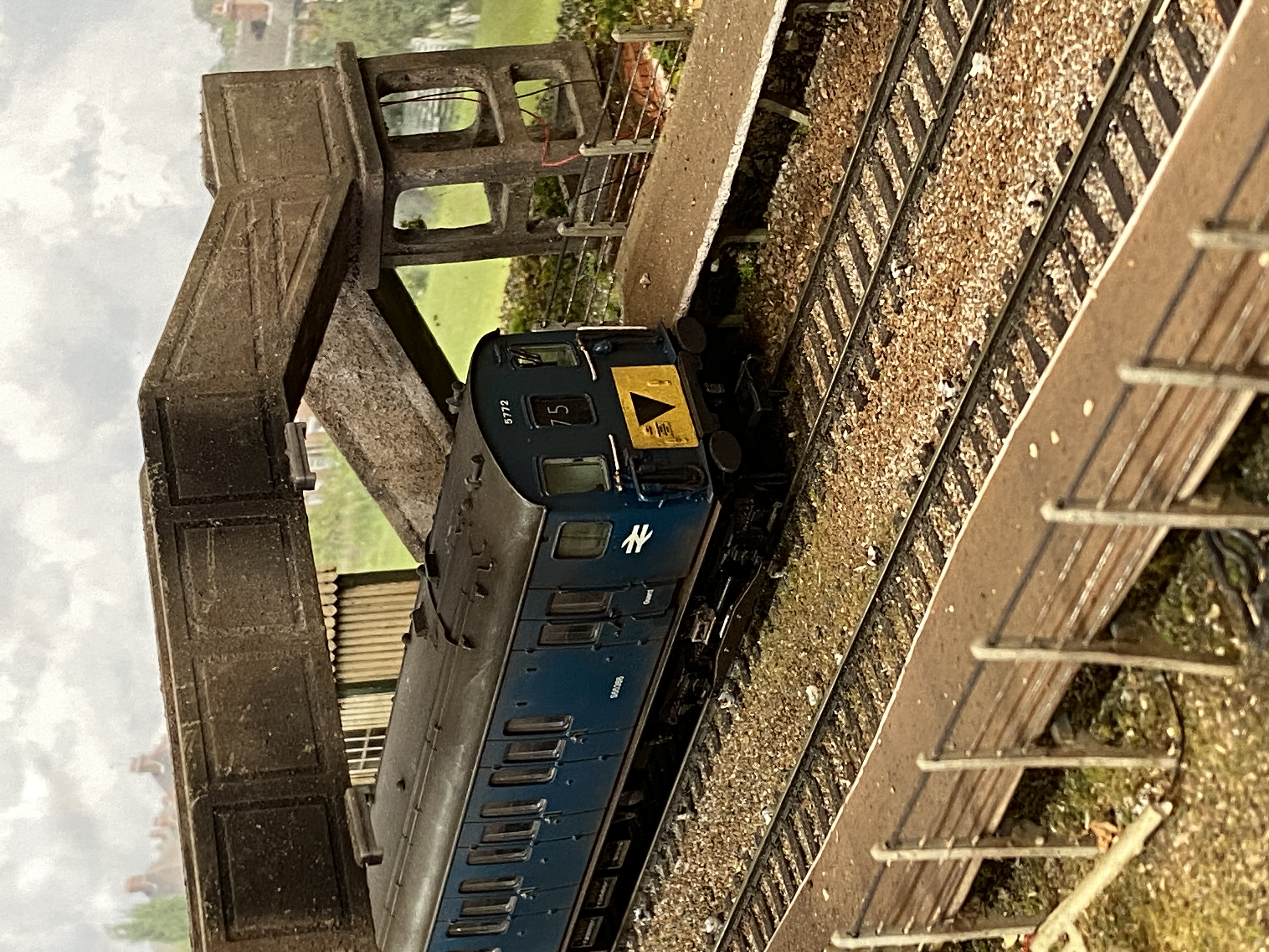

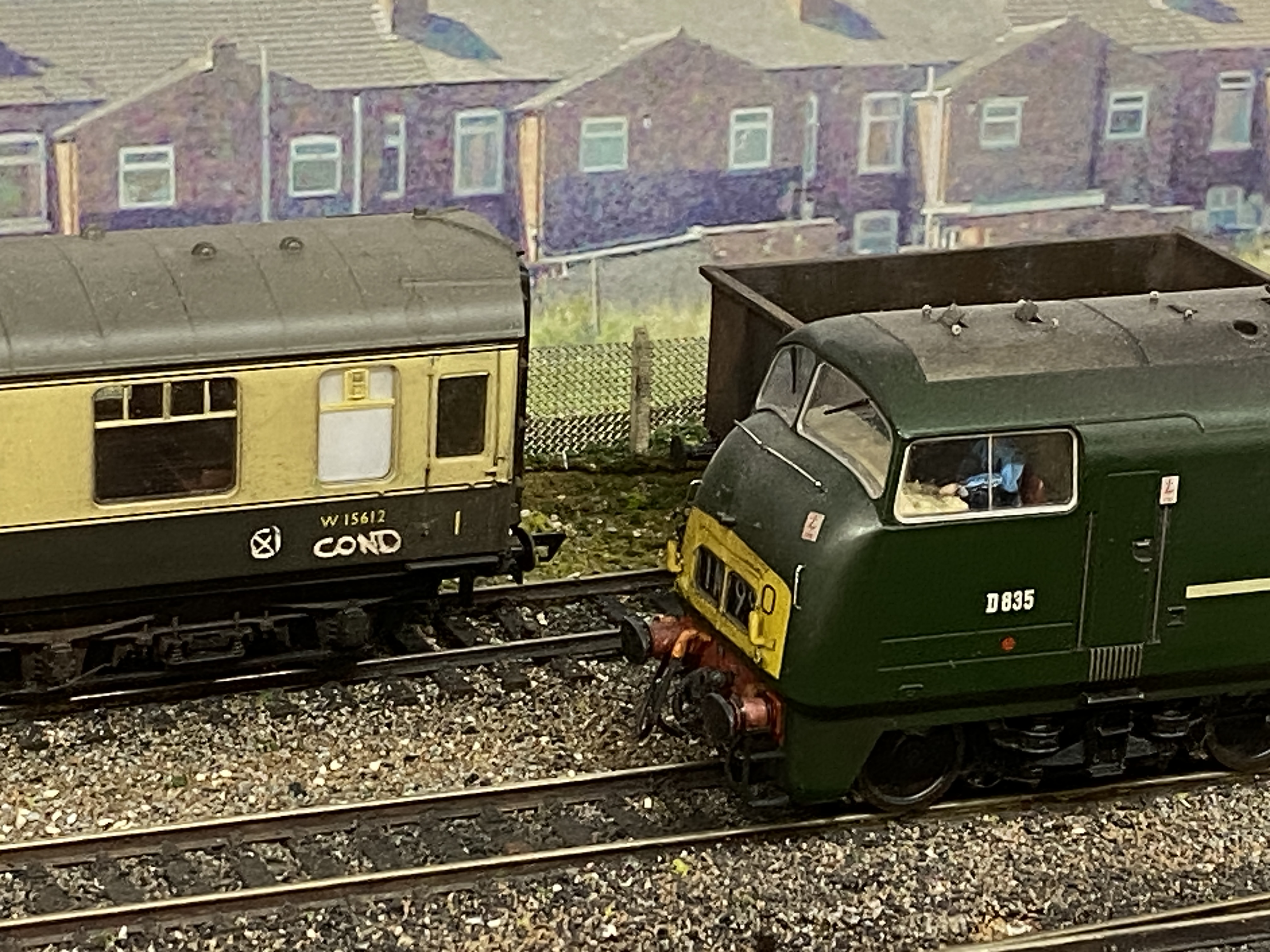

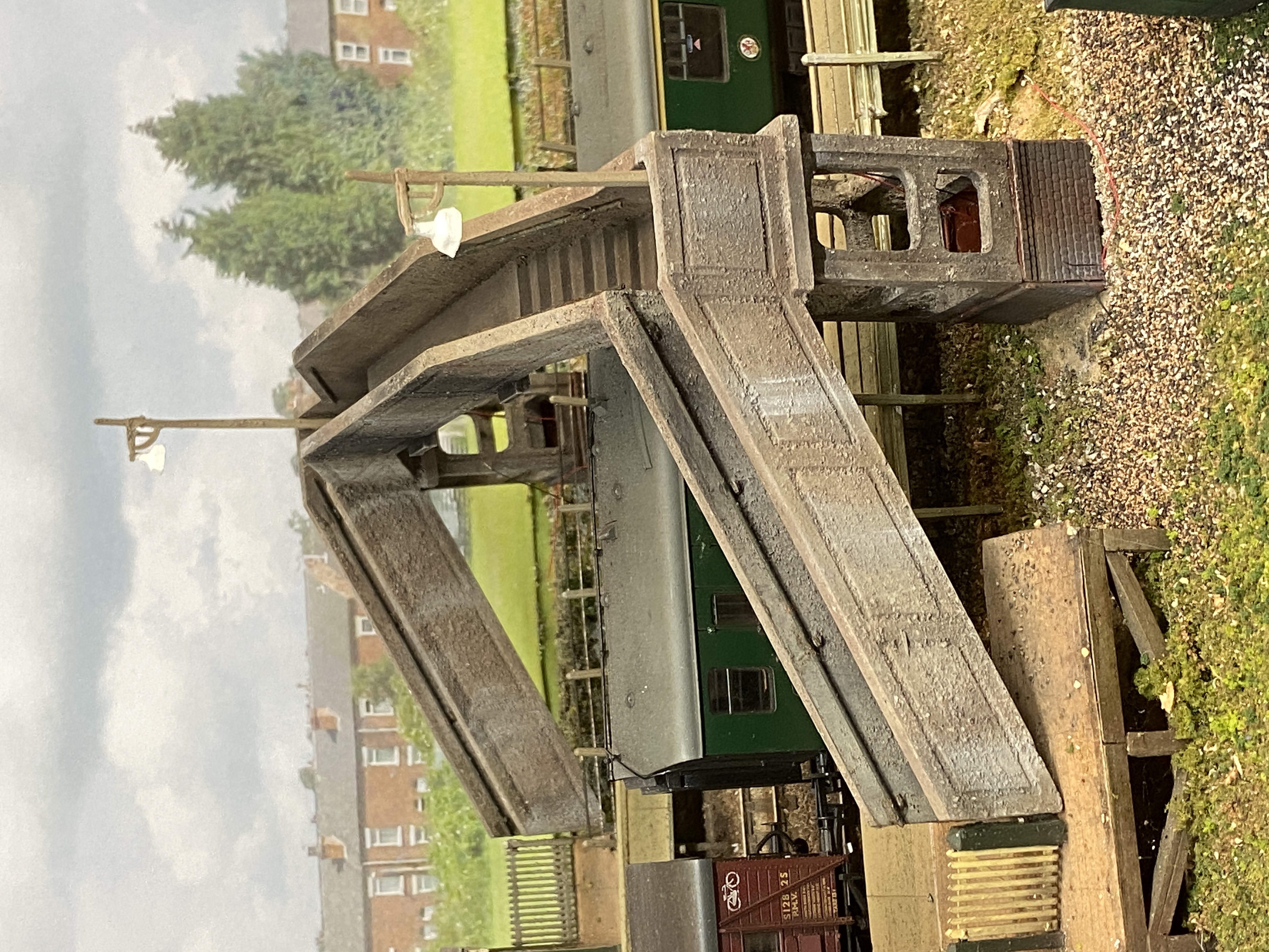

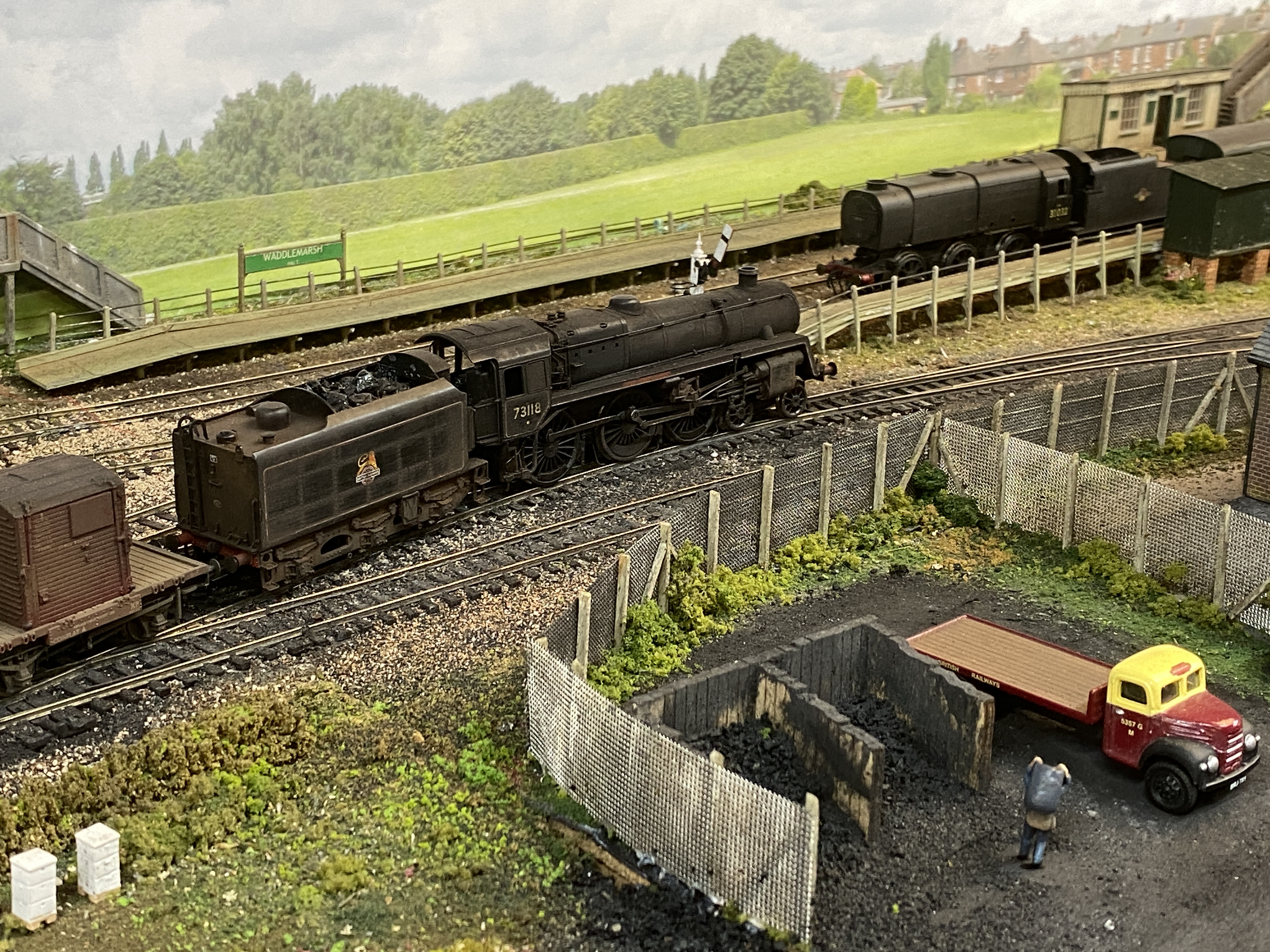

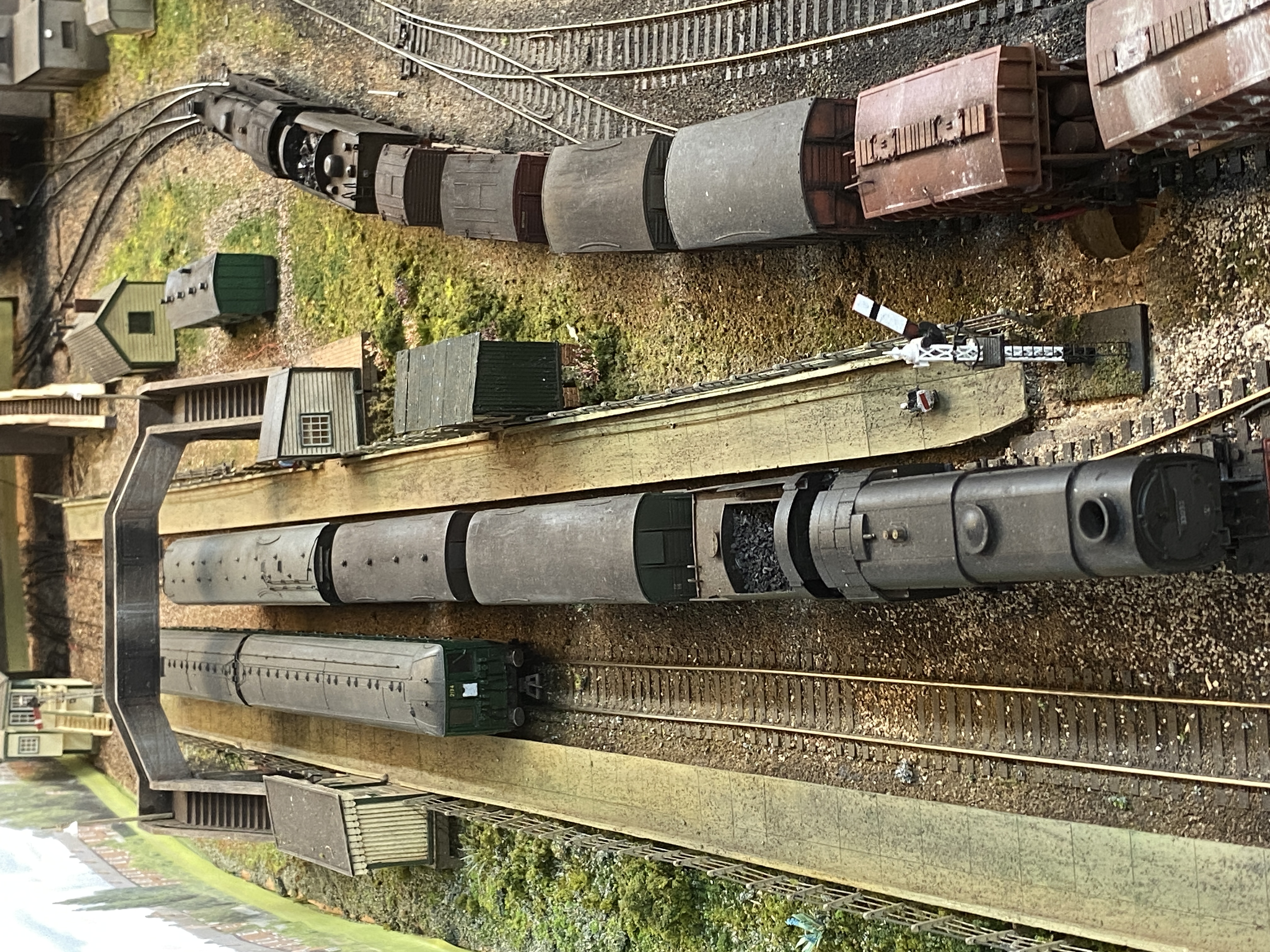

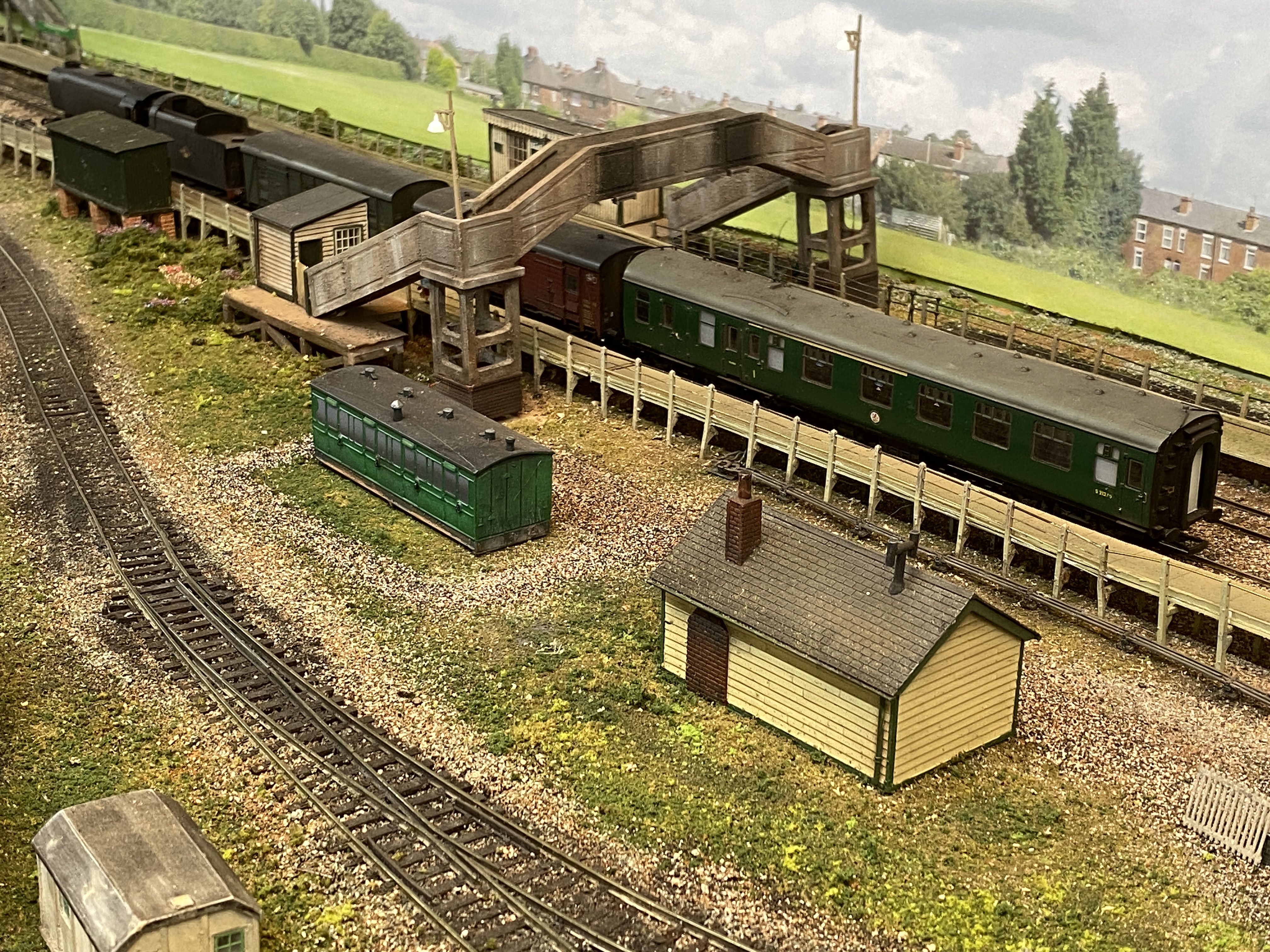

Today’s session was mostly concerned with fencing.
More concrete, timber and mesh fences have been added.
A little groundwork has seen foam-board used to support the Up Starter signal and beneath the kit footbridge which hangs in the air pending construction of brick bases.
Discontinuous sections of backscene have been partially obscured by trees.
IMG_1640.jpeg IMG_1641.jpeg IMG_1642.jpeg IMG_1643.jpeg IMG_1644.jpeg IMG_1645.jpeg IMG_1646.jpeg IMG_1647.jpeg

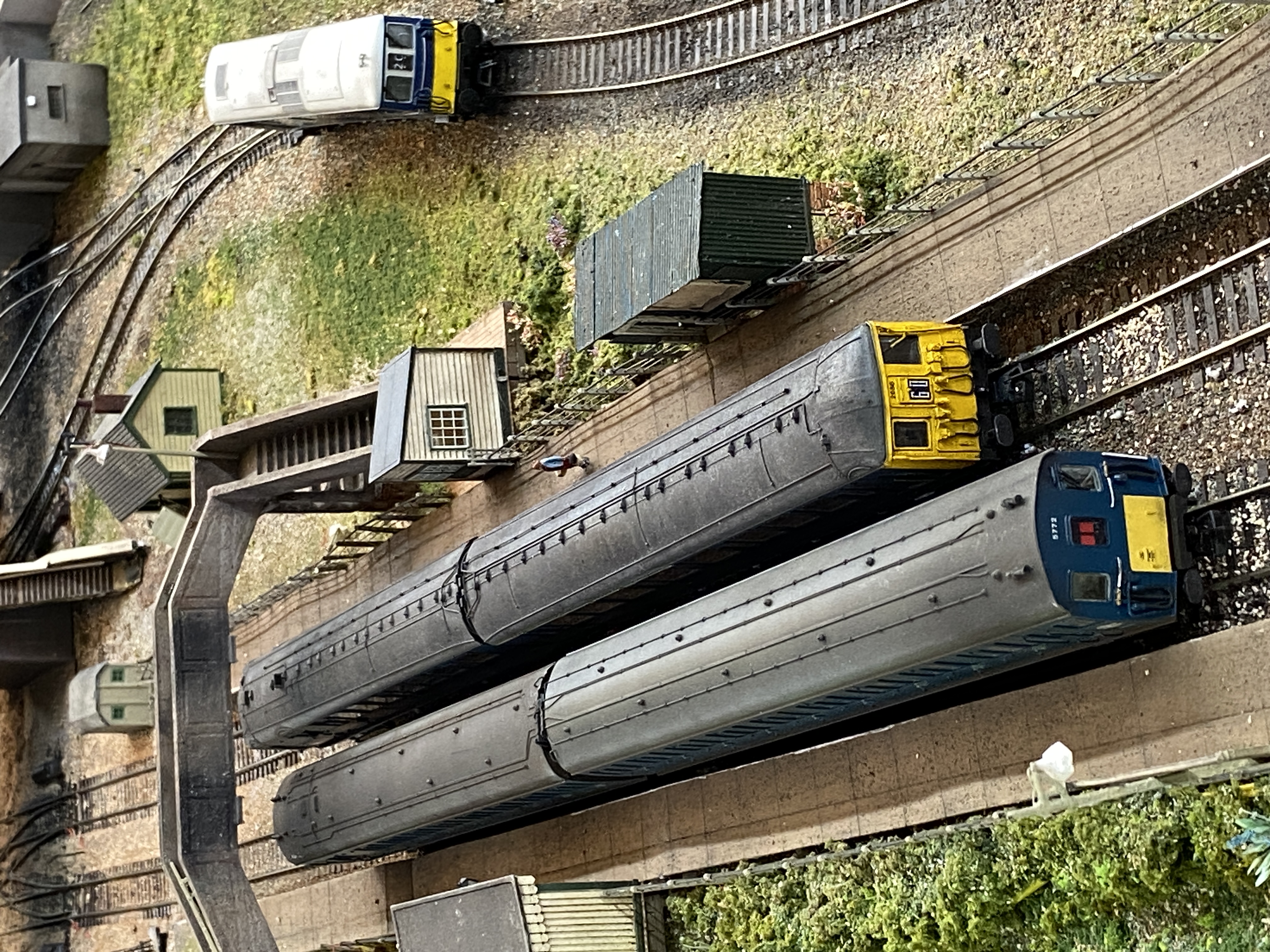

#293624

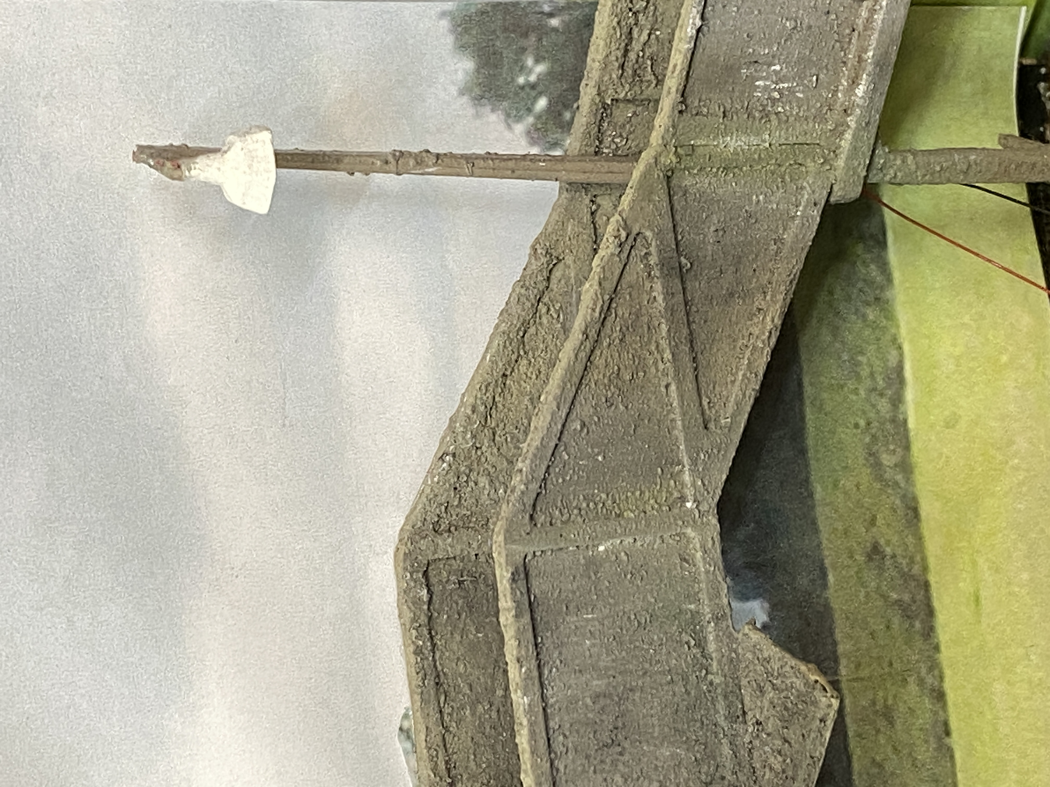

Some things take ages to achieve and appear to make little impact overall. But as a part of the overall scene these little things do make a difference.
The signal box now wears its correct name and has been weathered. The sign is printed onto glossy photo paper with the size determined by trial and error as much as measuring. The green is the darkest my printer will produce.
The Down line now has its conductor rail fully fitted. The rail is placed ready for fitting to the Up line
Both platforms have lamps erected though not yet wired in and working. One lamp remains unfixed as I need to rectify irregularities in the platform height there.
A guest appearance was made today by St Blazey-based 37 669 which bears the nsme of my former Australian layout on a custom-made plate.
  IMG_1685.jpeg IMG_1687.jpeg IMG_1688.jpeg IMG_1689.jpeg IMG_1690.jpeg IMG_1691.jpeg IMG_1692.jpeg IMG_1693.jpeg IMG_1694.jpeg

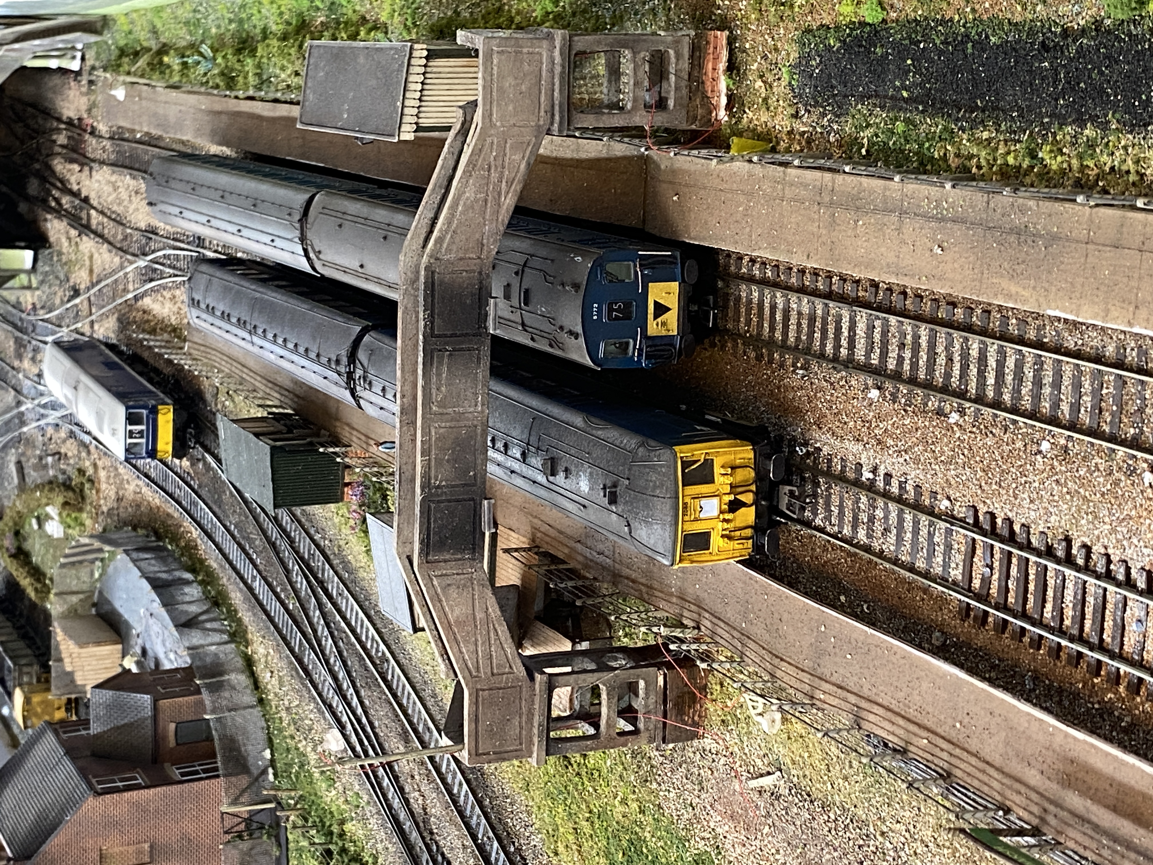

#293664
The rebuild continues. Recently it’s been slowed by poor health and consequently limited time in the clubroom. Attention has been largely confined to getting the overall look “right”.
I now have a draft re-wiring plan which needs to be worked on with all the four controllers “live”. That will help to identify any back-feeds or dead spots. It’s rather embarrassing when you switch one on and three trains move at the same time!  I know it’s only a temporary set-up at present. There is a lot to do.
