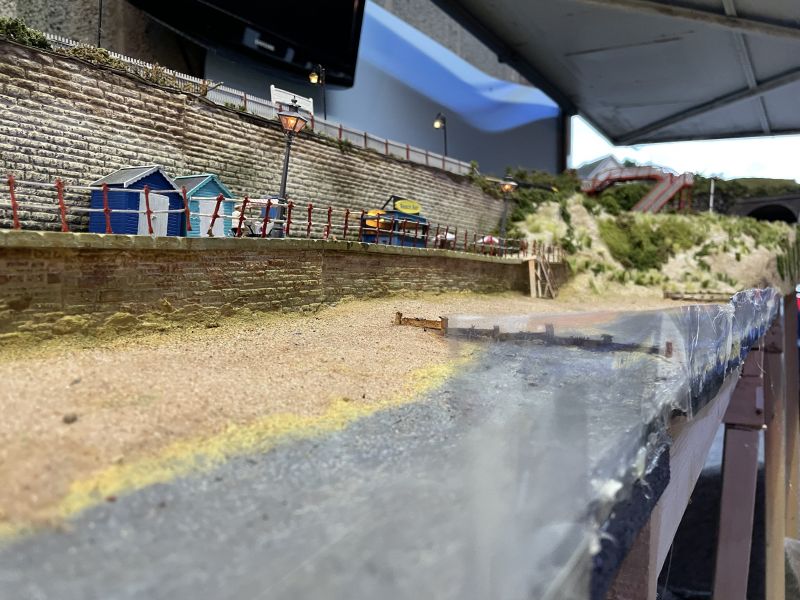

This evening I applied isopropyl alcohol on the sand and then a mod podge, water and dish soap mix to glue the sand down before the big pour. I also started building a dam with the Peco point packaging and hot glue. All the way down the bay.
I think I may attempt the big pour on Sunday morning!
Made from the packaging of Peco points, fixed with hot glue to provide a temporary dam for the resin. Checked for leaks by filling with a small amount of water.
Like my pervious pours I’ve built some dams to separate sections. The harbour area will look a little less blue. Getting excited about the pour. It’ll either make or break the bay. Fingers crossed!

Quite a rich colour for the bottom layer. Will add a second lighter layer on top once dry.
How long did it take to set Chris ?
I agree it is a little blue at the moment. As this is the bottom layer, my hope is I can make the second pour a little greener, so you get a difference in colour between the deeper water and the shallower areas…Wow - I could swim in that ! More of a mediterranean tone than I remember at Whitby but it really does look good.
It is still setting. It is still pretty tacky this morning. The little river was pretty solid to touch at this stage but I guess as this is a larger pour it will take a little longer to set.

There are always leaks!!! I had a frantic half hour trying to control them. The bridge from my boxfile is currently hot glued underneath a section of beach. I must get a photo. I plan to tidy up a few bits and then add a second pour to raise it a little more.I trust there were no leaks.
I’ll add some waves and white water much like I did on the river scenes.
