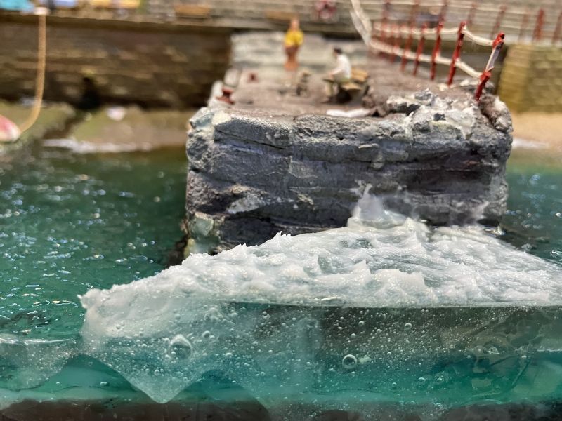

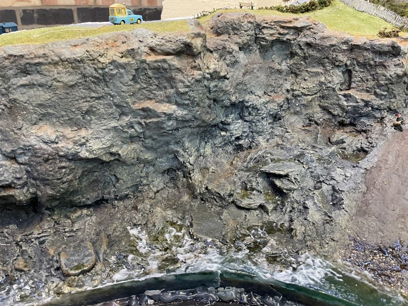

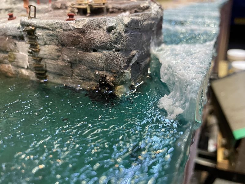

So one fun thing about resin if that if it finds a hole it keeps going and going and going. So I have my hot glue gun at the ready but near the rocks I had a major issue! So I grabbed the first thing I could find which would plug it.
So the bridge I made for my boxfile was unceremoniously glued in place to reduce the dripping! I also sacrificed the t-shirt I was wearing due to the amount of drips! Resin doesn’t come out of clothing! I had to use a saw to remove it the bridge when the resin was dry.
I also realised even though I tried to keep the scene level during construction, it wasn’t perfect. I also should have brought the whole harbour scene up by 3-4cm. So hidden at the end of the pier is a ‘mighty large’ step, which I have tried to hide as a wave.
If I didn’t have the drop the whole harbour would have been flooded which I thought would have spoilt the scene.
So there you go, it doesn’t always go to plan! But as I said, it is easily the most exciting part of the build so far.
