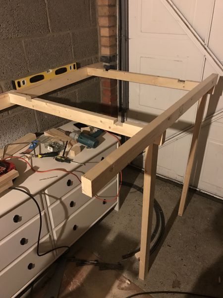

The first cut… I decided to go with a simple wooden frame as its easily to work with. My woodwork skills are nothing to shout about, I have used common sense on my joins and pure educated guess work, which seems to have worked so far.
Above, the first join. Taking an U shaped cut out of the main support for the cross sections. Below the first "block" is constructed checking we are level as I go. My plan is for the tracks to remain relatively level with an upper and lower level. Initially I'll be focusing on the lower dual "L" shaped loops with the upper to be built at a later date.

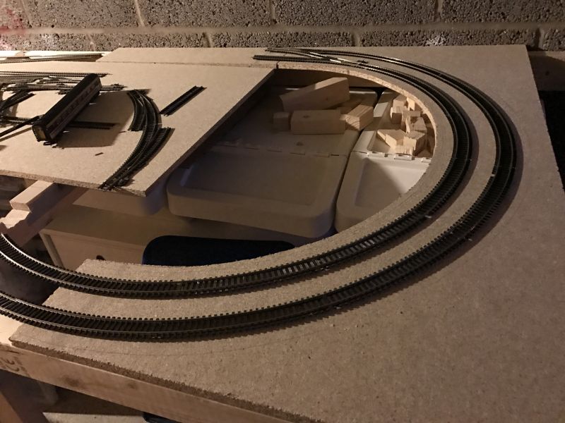

Using old Hornby track on the floor to work out the minimum clearance needed to get a very tight turn 2nd on the inner 3rd on the outer. Unfortunately need to be tight to fit it in the space but the plan is for this to be hidden under a tunnel so only more realistic bends are modelled.

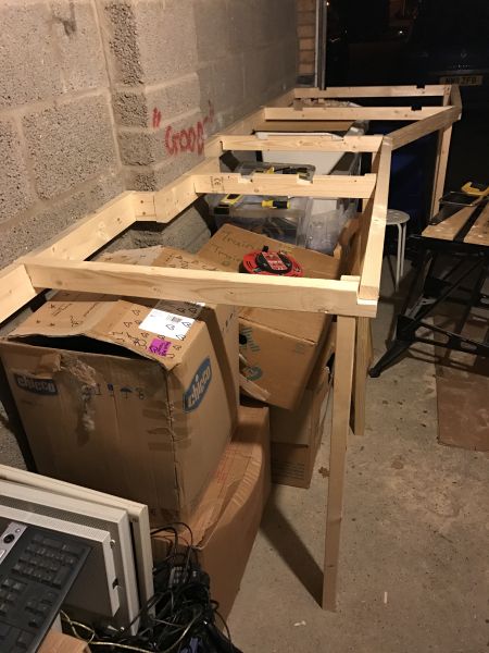

As the track heads into the garage the width of the layout is reduced to allow more room around the layout and I plan to eventually add a beach here to give Teasel Bay its namesake. At the back under scenery I plan to have a small set of sidings to allow trains to enter the tunnel and a different train to exit. I hope this will add a bit more interest than a simple oval. Eventually the plan is to get my software to control this and randomly select trains to run.
Looking back to the entrance of the garage. I've added some areas for the wires to run once the base boards are down.

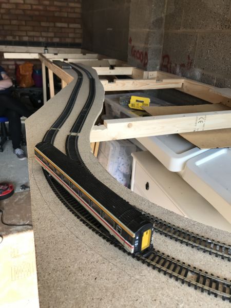

Using old track and the longest carriage for reference I started planning the track position and cutting out the baseboard using a Jigsaw borrowed from a friend.

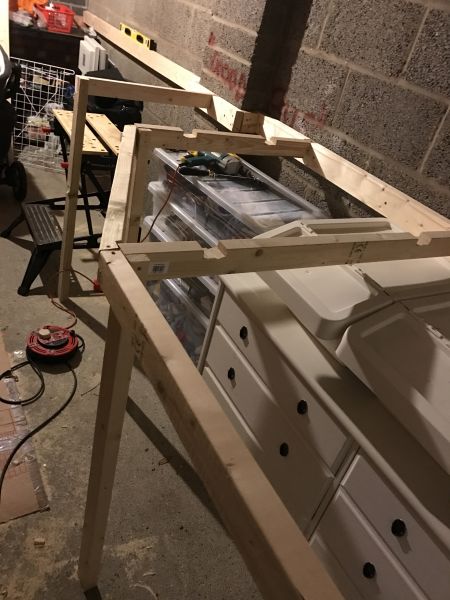

I had not finished the full structure by this time, as you can see the rear support at the back of the garage is resting on stuff before being fixed into place. On the photo below you can read "Good bye" written in paint (well I hope it ins't blood) which was there when we moved in!
Progressing slowly around to the rear of the garage. As you can see eventually the layout will be hiding quite a bit underneath!
Finally laying the old track to loosely plan the layout over the completed structure at the back of the garage. Phase two will eventually see a second oval around the edge of the garage with a removal section at the front for access but that is far into the future.
