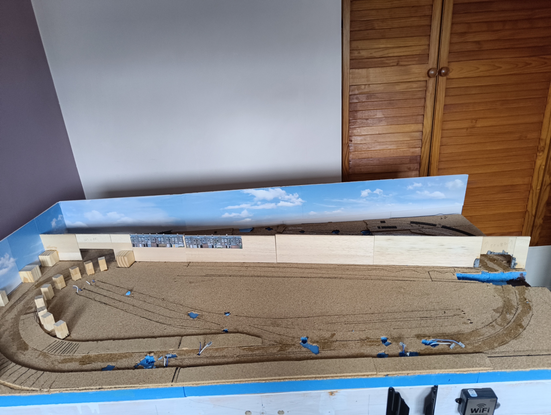

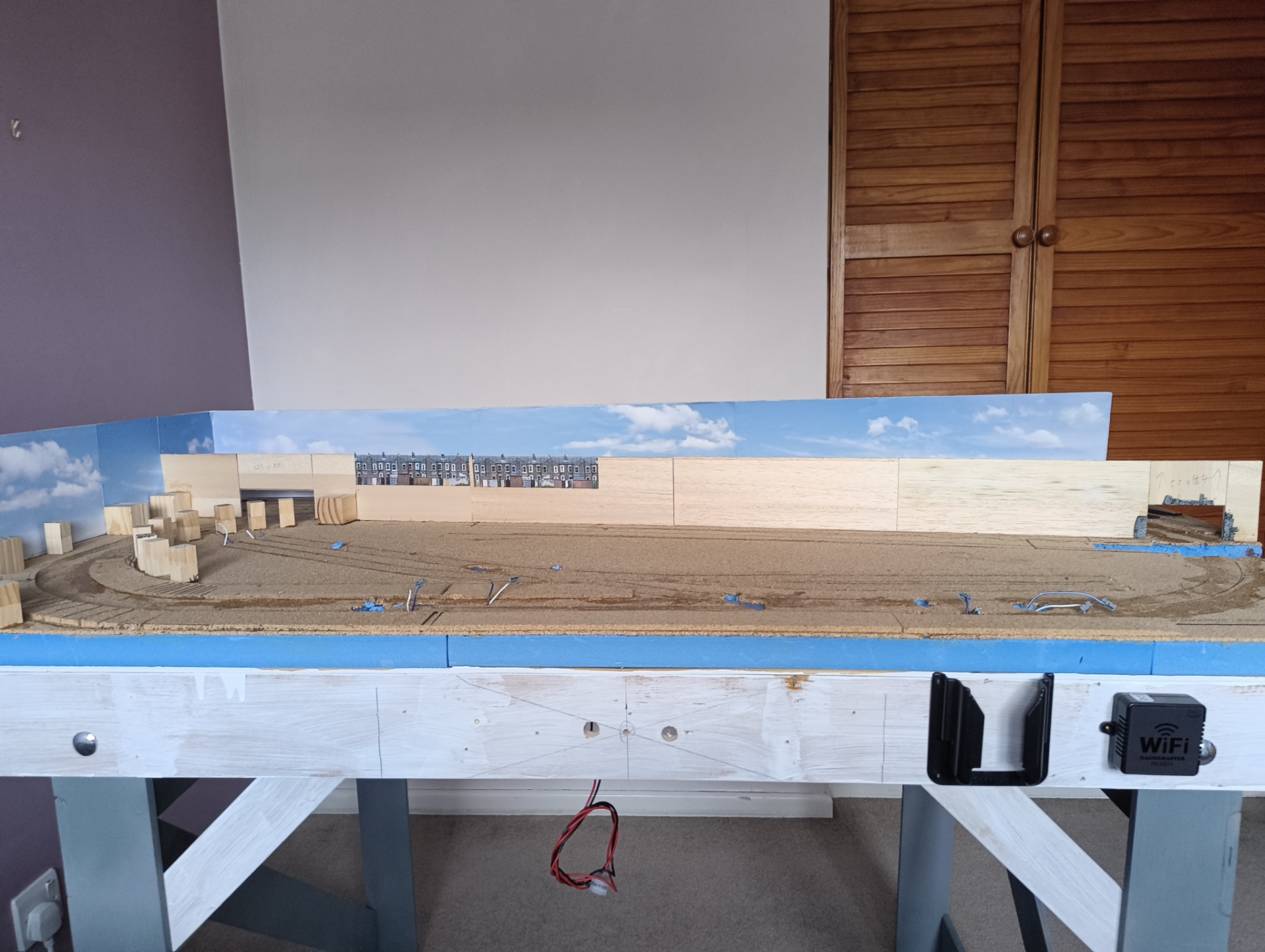

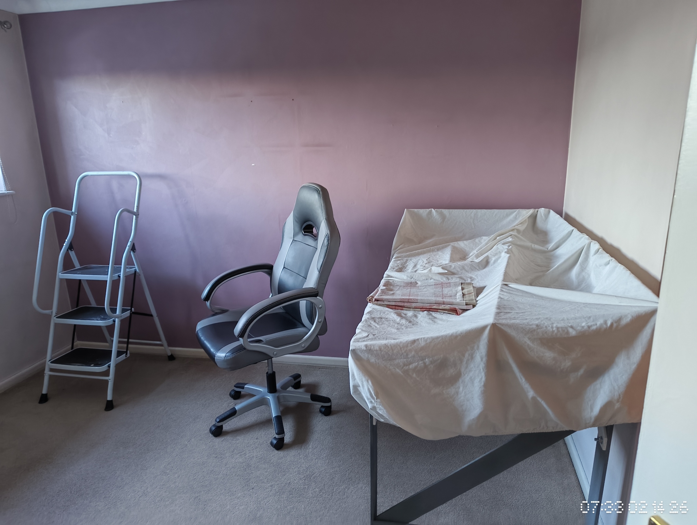

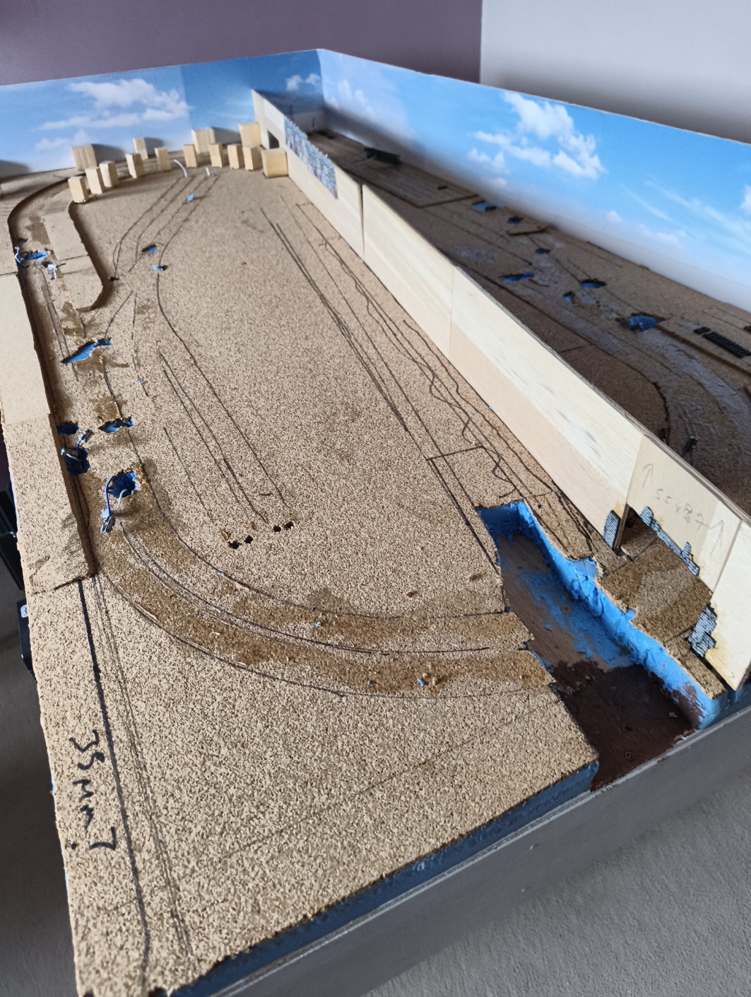

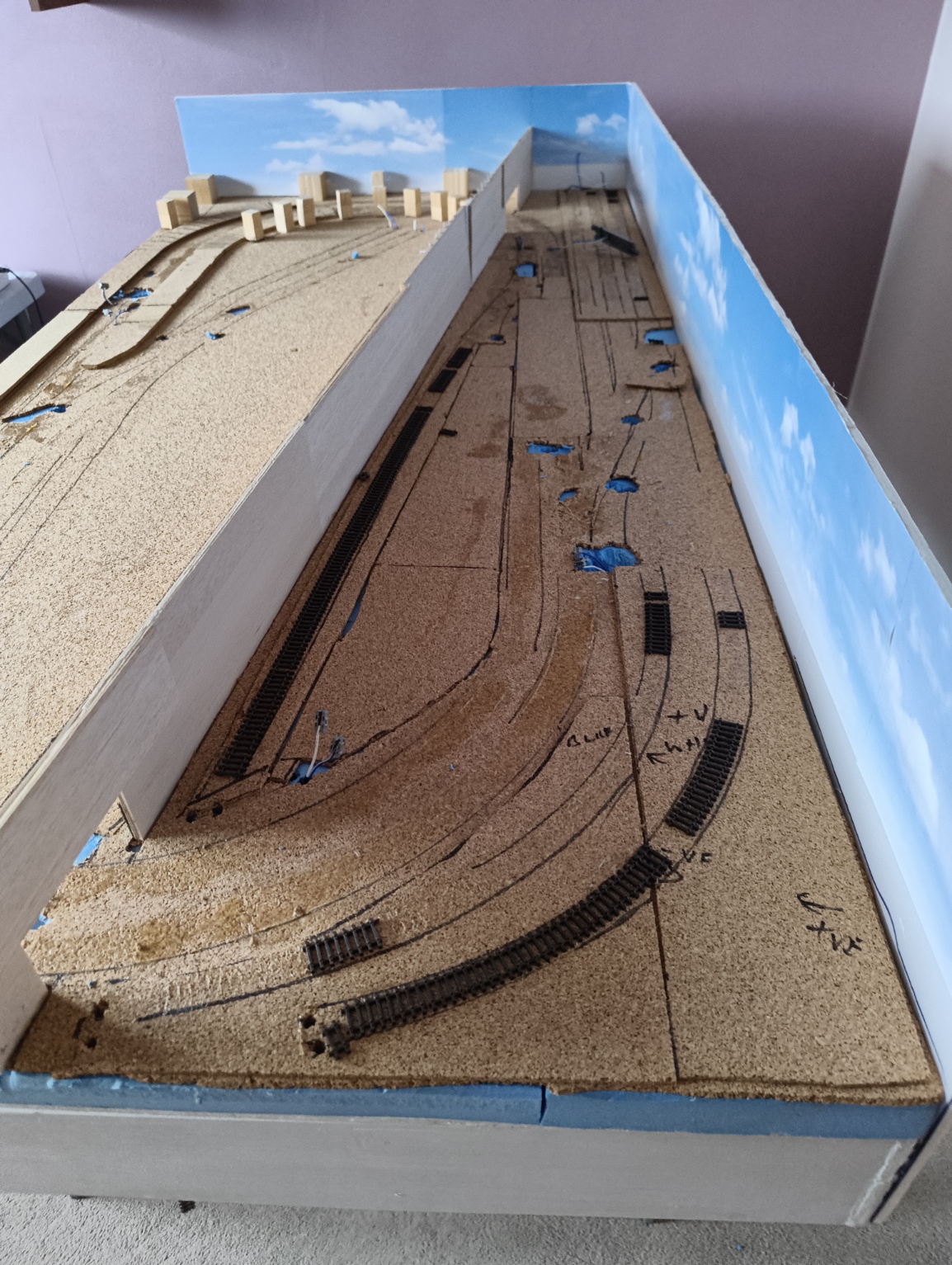

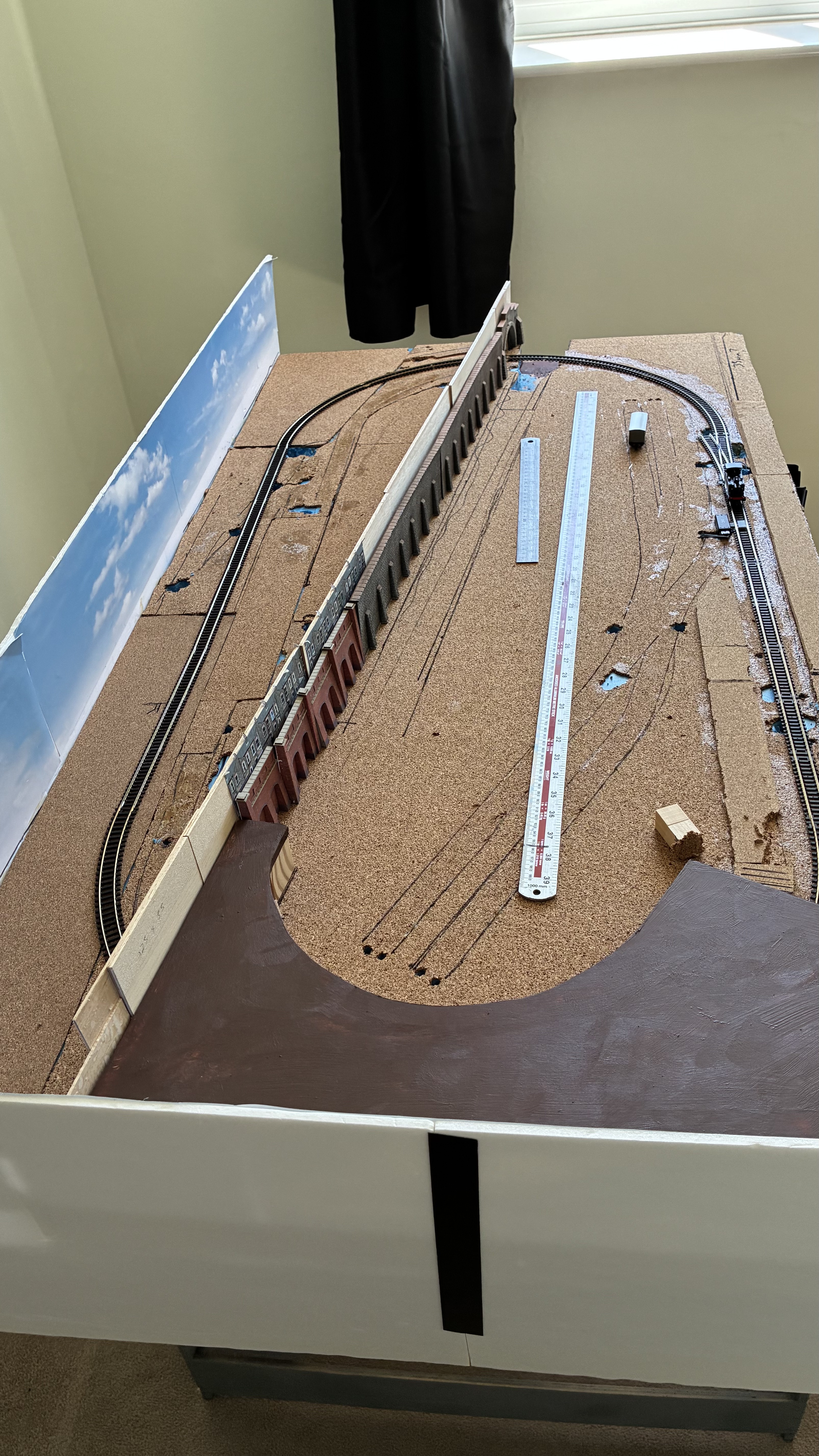

The axe has fallen, just got to get on with the decorating.
#293193
OMG - the lengths some people will go to just so they can do some decorating …………………………
Do you have ideas for a replacement Ed or are you going to stick with decorating ? :hmm:
