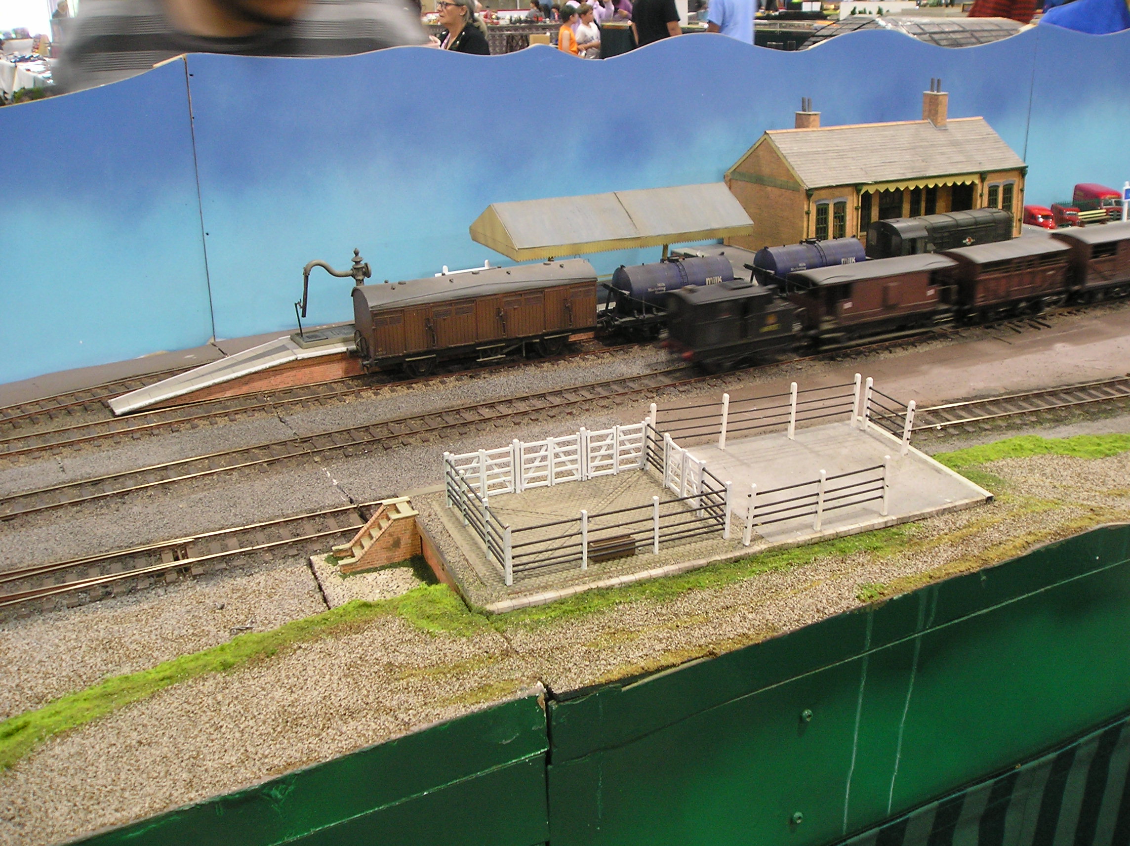

Class 08 with mixed train. SR CCT and two cattle vans.

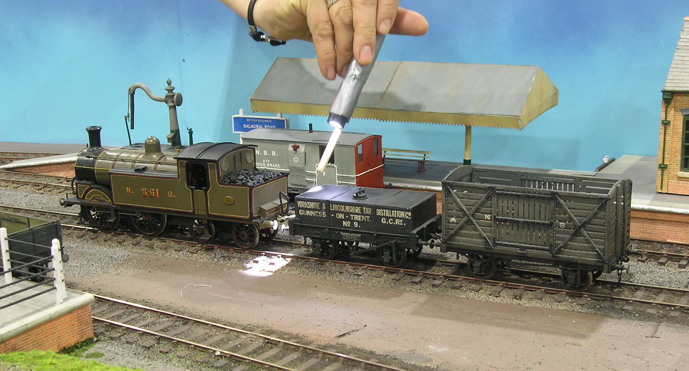

Uncoupling for shunting. A simple tool, steel wire with a hook on the end inserted into wooden dowel and taped to a torch.

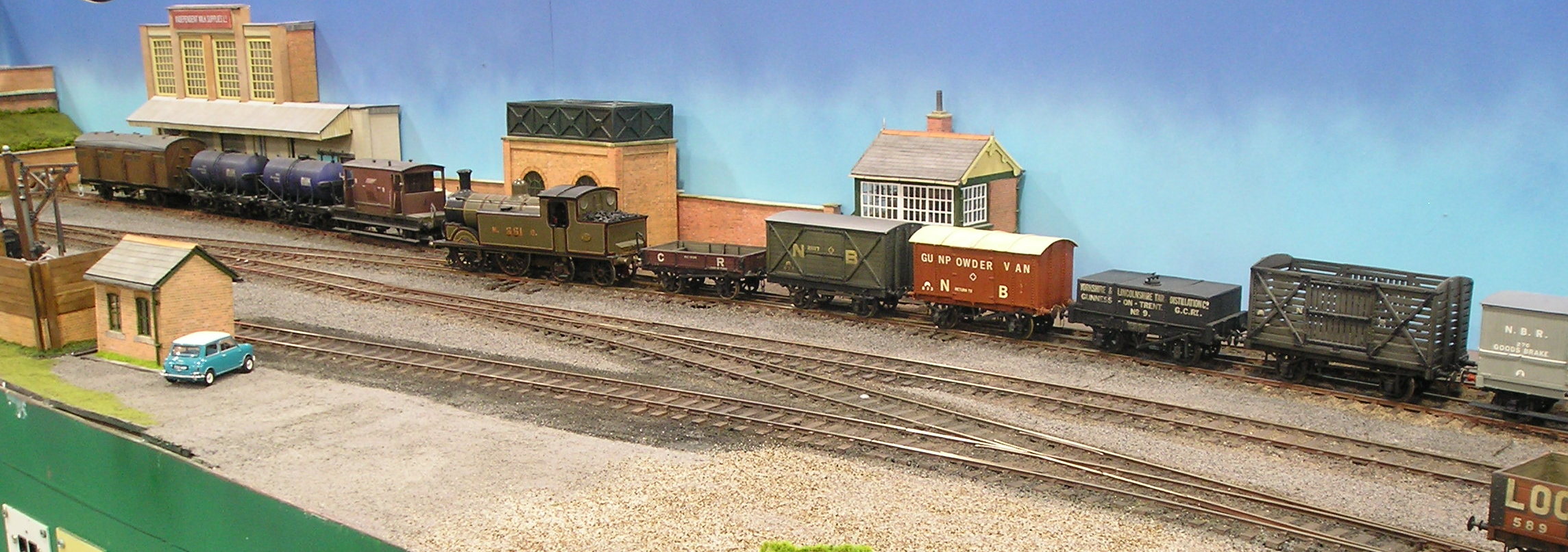

Overall view of the goods yard. Jinty is preparing to make up a train.

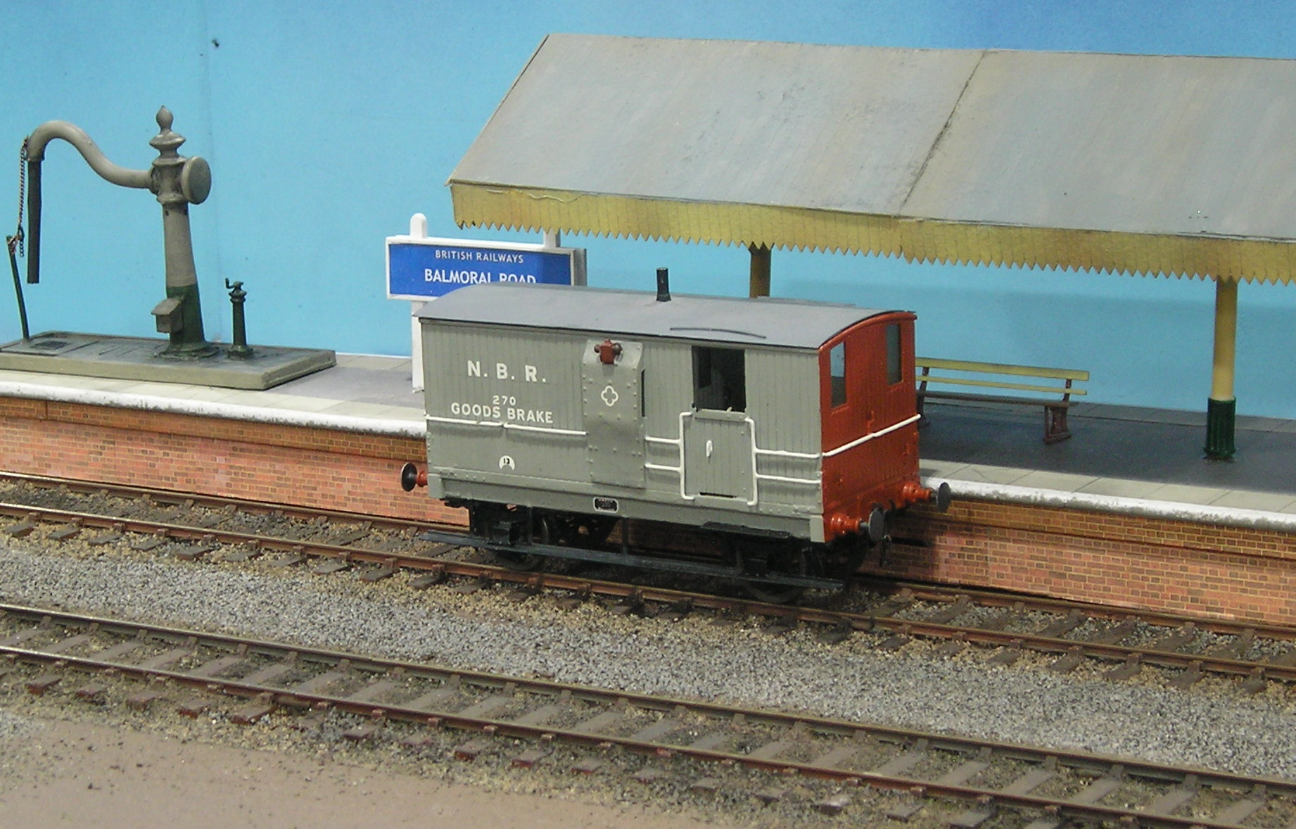

I like building kits so took on the commission to do this NBR brake van. It is from Connoisseur and etched brass.
