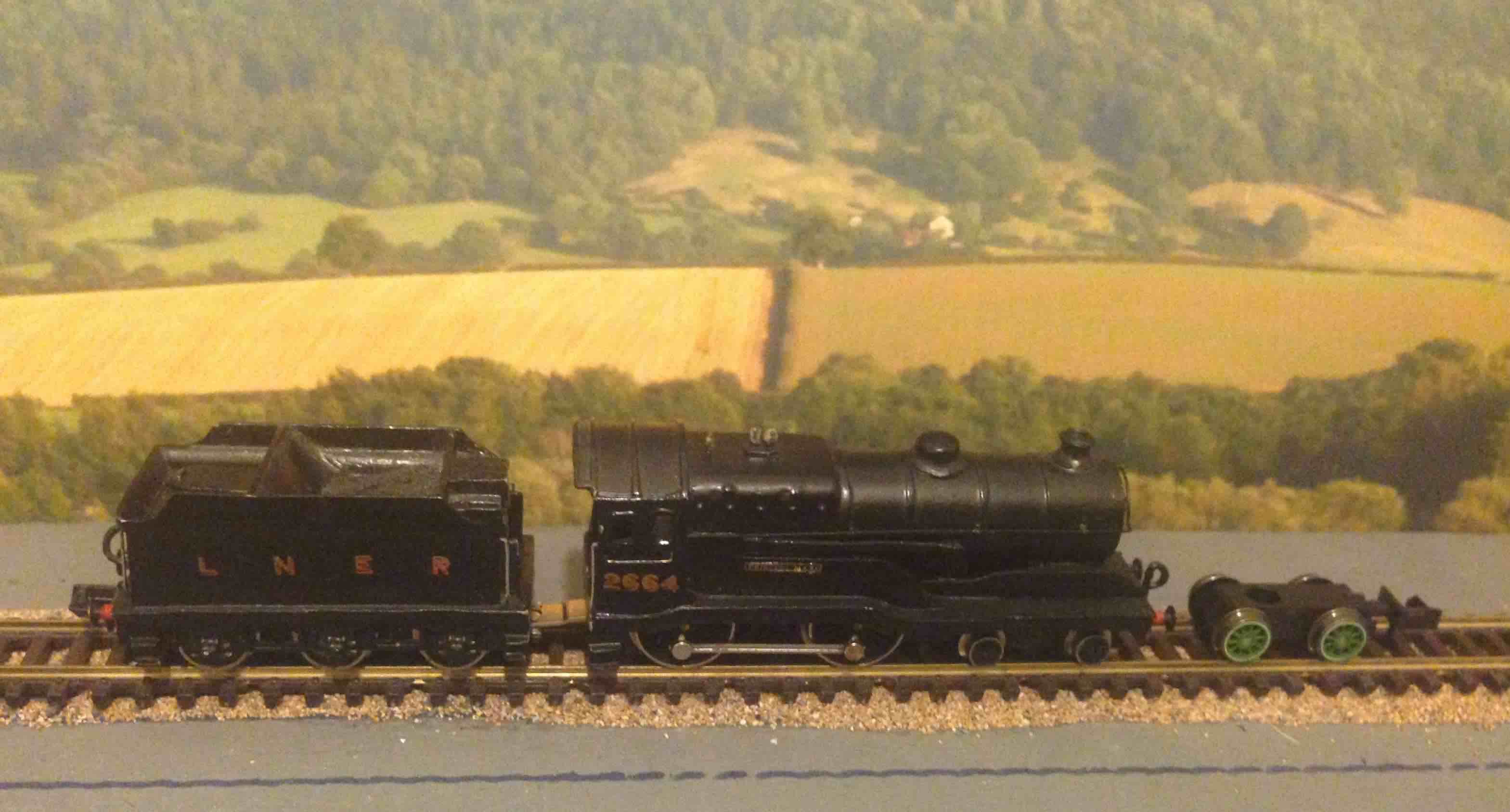

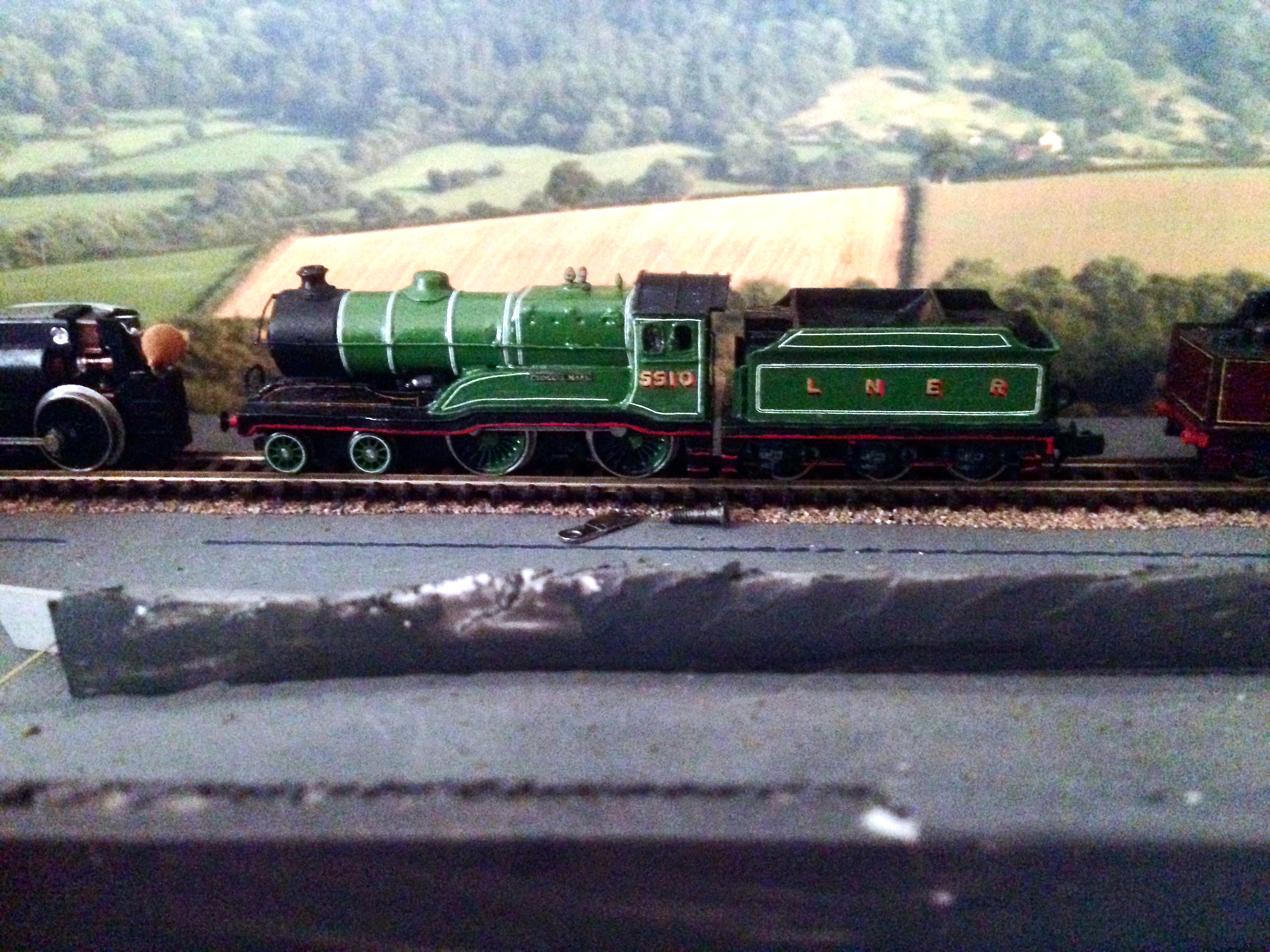

Now,I always wanted Silver Fox,as a tribute to my old mate Owen,but the prices were ridiculous, so I have purchased another cheaper A4,"Woodcock"that someone had painted entirely black, that I am currently transforming into Silver Fox…most of the painting has been done and she's now just awaiting a vallance,some handrails on the tender and a corridor for the back of the tender, then transfers to complete. Also,Princess Mary will require work and renumbering as she currently has her 1946 numbering and is in wartime black.I am taking her back to LNER apple green 1930s state.Pictures will follow as soon as I can, but I'm at a funeral tomorrow's it may be a day or two.Hope everyone is keeping fine….ta-ra for now.

These are the photos of Princess Mary and Woodcock in Wartime black that will become Princess Mary in LNER green and Silver Fox in 30's silver.Also pictured is new acquisition Coldstreamer…

I was having problems with uploading the images,seems to be OK now,but for some reason,they have appeared in reverse order????.Whilst I'm on "some kind"of a roll,I'll photo the progress on the A4 that was "Woodcock" and is becoming "Silver Fox"and the ex-GCR 4-4-0 D11 "Princess Mary" and post them up later this evening.Princess Mary WAS going to be renamed/numbered as either "Mons" or "Somme",but when I googled Princess Mary and found out she did a lot for the troops in WW1,I decided to keep her as is,albeit in her 1930's condition and numbering.Also I've been doing a repaint/lining job on an old Peco Jubilee which was "Renown" in wartime black,but is now in LMS crimson lake and has been re-numbered/named as "Palestine".While I had the transfers out,I also renumbered/named my Farish Jubilee from "Trafalgar" to "Keith".
