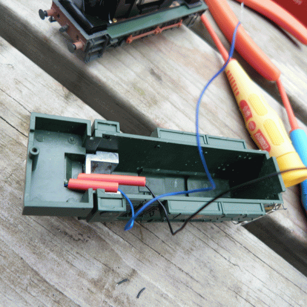

first visit and mission to the shed done. Just had my first attempt at chipping a Bachmann 08 with a chip complete with stay alive. Room is tight compared with other loco's but still relatively easy.
I have included some pictures and if anything they show how the loco comes together rather than how to take it apart but the reverse is just the same. I have another the very same to do so I shall detail the dismantling when I do that one. there are a few screws to come out and they are not immediately apparent at first glance.
Anyway, here is my first 08.
Some of the tools of the trade including soldering iron and double sided sticky tape.:mutley
Again I didn't show hoe I got to here but will do on the next one. Basically I took of the cab as I knew that the stay alive was going in there. After that I removed the couplings and coupling holders to give better visibility of the screws etc that need to come out.
The body, once the screws are removed hinges to the front. you can see the long slot to the left of where I have fitted the decoder. The decoder itself is a direct push on type but has three cables coming out of it. One for an additional function and two that connect to their similarly coloured partners on the stay alive unit which you will see housed in the cab shortly.

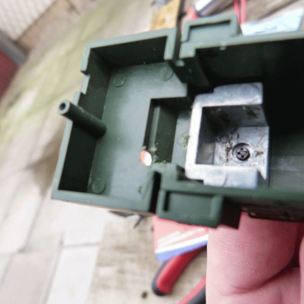

Once I looked at where the wiring was going to be run, I drilled a hole in the floor of the cab for the cables to come through.
here it is again from the underside.

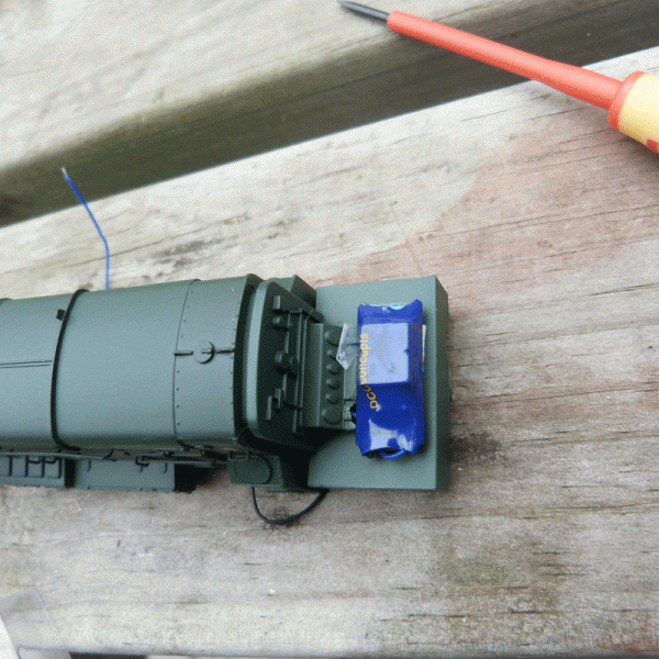

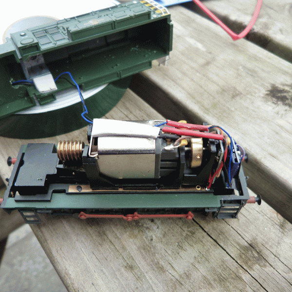

I fitted the stay alive unit to the floor of the cab with double sided sticky tape after passing the two wires through.
I slid a bit of heat shrink insulation over the two cables to slide over the soldered joint after its done.
job done
and another shot of the whole thing.
I then tidied the cables up a bit and used another bit of double sided sticky tape to hold things in place whilst the body shell goes back on.

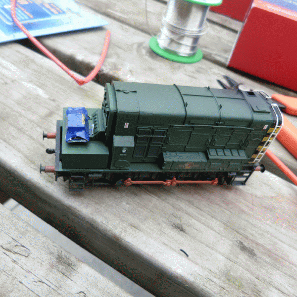

The shell goes back on and you can see the stay alive unit sitting there happily. ( I know its happy because I can see it smiling ….. cant you……. where are these tablets )
I didn't paint the chip black which I was going to do but I'll wait until its been trialled. its easy enough to remove the cab again later.
the cab is now back in place. and one last shot below.
job done. I just need to test it out and programme etc. If its ok, I'll maybe chip the other one and attempt a class 03. I think the crack is the same, stay alive in the cab.

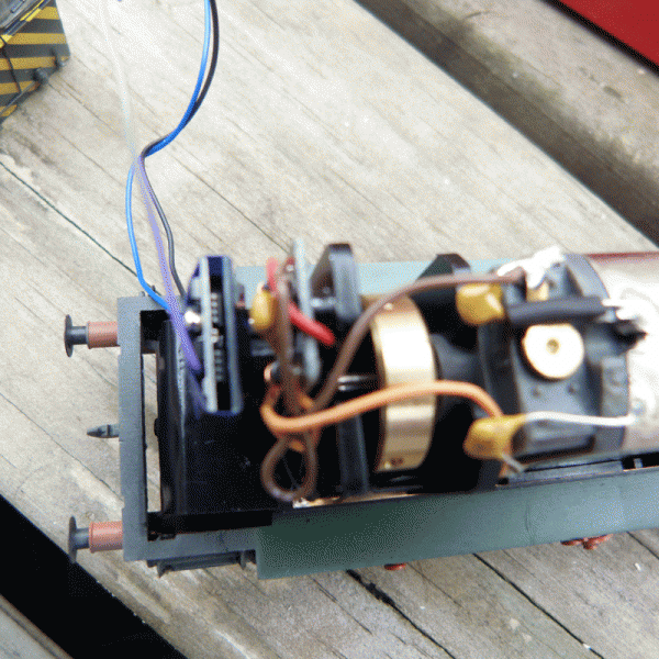

Well quite an eventful night.
Started off trying to programme the 08. It wouldn't recognise the decoder ……. Drat. So …… I took the loco apart only to find a wee long thing ( technical jargon ) with a copper winding thing had become detached from somewhere.
Well …….. Me being so knowledgeable of these things took a look around to guess ….. Ahem I mean see where it belonged. As it turns out there was another one connected to one end of a wee flat thing and it looked like there was a bit where the detached one may fit. So ……. At great risk of blowing the fecker up, I put on my surgical gown, prepared the area in question moving all wires in close proximity well out the way, sort of lined up the doofer with the thingy and went careering right in there with the soldering iron with a tip you could turn over the veggie patch with. Hey ……. It worked. Now programmed and working.
However, not is all well. This wire on tube is giving me headaches as the switched are not moving over fully. I put my version of an omega thingy in with limited success but need to rethink it as they are not reliable at all.
So, yet another setback. I did not even bother trying to test the magnets out with the loco attached as there is that much point work in the surrounding track work that it was just screwing up everywhere with the switches not feeding the frogs correctly. I could change them over to Cobalts but feel like I am giving in if I do that. It would be easy but then I'd be running away from the problem rather than sorting it out.
I think I'll persevere. More on that tomorrow.
#207431
That wee copper wire wrapped  thingy is a european suppressor (or choke) for DC, not needed for DCC, so can be cut off.
