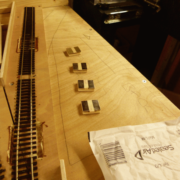

I got my magnets in and they work. Again, I will need to weigh the wagons significantly as the magnets are very strong. here is a couple of pictures. I'll apologise up front for the blurry photos.
A quick photo of the little blighters out the pack.
The first one made up.
and the others.
The first two installed.
now they are all in.

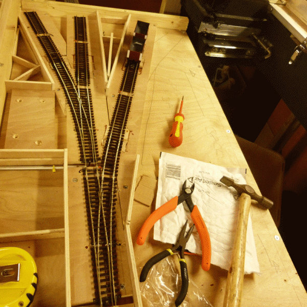

I put Highbridge on a couple of work trestles to work off. Much better at this height.

Hi Max,
Once I've tested it with a loco and I am sure i'm happy with it, I will be able to get some ground cover down and let it take shape a bit. But, yes, generally a good milestone hit. Good fun, its all different stuff I'm trying now after the long stint on the R & GLR.
Paul,
I'll look and see which wagons will be simplest to weigh down. They may not ultimately be the ones used on the layout but I just want to see that the weight will work in principle as the draw from the magnets is very strong indeed.

Hi Toto
The NMRA guideline is 1oz + 0.5oz per inch of vehicle, so a 3" wagon would weigh 2.5oz (1 + (3 x .05) = 2.5)
Check also that you base board is level, as the wagons will roll, especially if the magnets giving them a tug.
Just had another thought, I've used code 100 rail, your on code 75, effectively my axels are further away from the magnets :brickwall
Paul
#207187
Adjustable magnets…glue a longer piece of ply underneath the maget block…a screw at each end…screwed in from underneath so the magnet block fits in its hole….you can now screw it fighter or slacken it off till you get optimum performance.   Seemples
