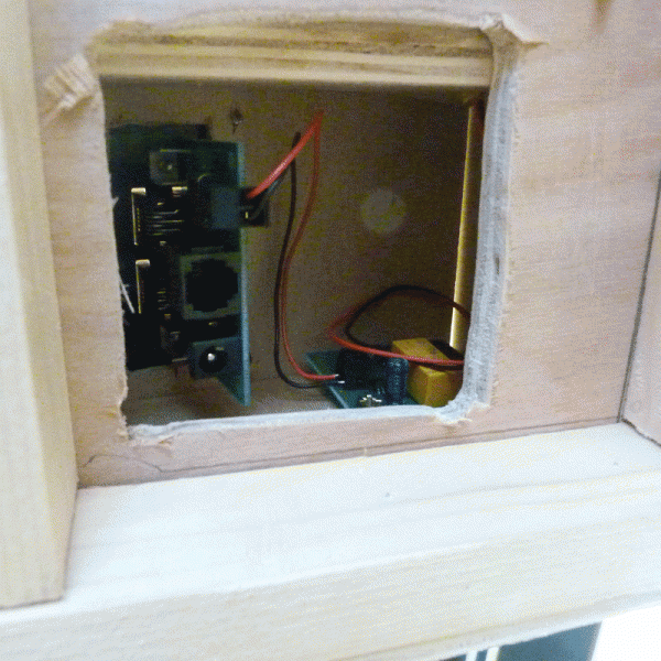

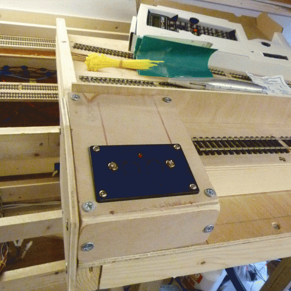

I went back out to the shed for a little while more. I think I found part of the problem with the auto switch and the layout track in general. A very bad soldered joint. I remade the joint and thinks have improved greatly. The class 03 and the 08 still have running issues. I think stay alive will be required for both.
A few more shots anyway,
One of the auto switch and the power cab PCP panel inside the plywood housing.
back in place.

So, in summary then, Highbridge is wired and running from its powercab. some teething issues to look at.
1. stay alive for the class 03 and 08
2. one set of points where I think the polarity switch is maybe not making quite right
3. double test the programming track with another chipped loco although I think its resolved.
4. maybe a little tweaking of the track for the sake of the shunters. Bo Bo diesels run fine so its the old short chassis issue.
