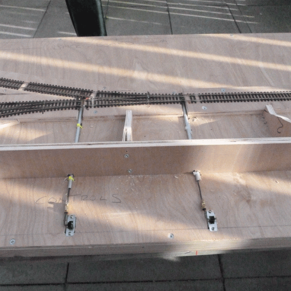

G`day Toto,
I think you will find your average wire coat hanger wire is too thick to insert into the tie bar hole.
I use a 1.25mm Gal Wire which is technically a tie wire for gardening or for wiring mesh to a frame etc. like this example below.
Easy to bend to shape….won`t stretch and rigid enough to bent at 90 degrees to activate a tie bar and cheap as chips….Approx.£3 in your money.
http://www.bunnings.com.au/whites-wires-1-25mm-7m-handypak-galvanised-tie-wire_p3064908
This product or something similar may be available at your B&Q possibly in the gardening dept. if they have such a thing.??
:cheers  Gormo

Eureka moment : Copper tape by any chance Toto ?? :hmm
ps. Whilst at B&Q, look for welding rods. They are solid and about 1mm in diameter. :thumbs

Only problems with piano wire are cutting it - plays havoc with wire cutters, bending it can sometimes be  a problem too, try and make too sharp a bend and it can sometimes snap. Plastic tube works just as well as metal, and it's cheaper. For N gauge I'm using 2mm outside diameter tube and 1mm wire.

Thick wire hanger or galvanised steel wire
SKIP18B BLOOMA HEAVY DUTY GARDEN WIRE 20 | DIY at B&Q
running from each side frame, then either solder a 1mm riser wire to the thick wire to operate the point, or solder the riser wire to a terminal block, this would give you some adjustment.
Just attach a knob at either end.
Paul
#204031
With knobs on then Paul ?  :mutley  Oh and is it by any chance heavy duty double sided sticky tape Tom ?     and I see we have the 08 souped up to 150 mile an hour…done out in enterprise white ?  Warp factor 2    beam me up Scotty !!
Now off for a lay down in as dark room after a visit from the grand kids
#204040
Heavy duty fence wire done the job …….. the kind I used as a sparky for fishing cables under the floor. Then bore out the point tie bar to suit……… like this,
As you can see, I used one of Gormos little gizmos ( the connector block innards ) to provide a bit adjustment potential.

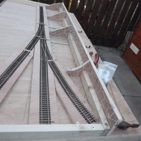

And now ……….. the bit I've been waiting for, for about a year or so. the chicken wire.
I got this stuff cheaper because it didn't have no feathers. I was clucking mad so I was.
Its time for a quick bite to eat and then out with the chicken wire and possibly on to the plaster bandage. So, what's the verdict so far chaps ?
and idea's before I go any further would be good. After the horse has bolted would be bad.
cheers for now.
toto

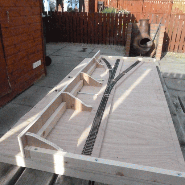

Chicken wire done. I haven't done the plaster bandage yet. that'll be tomorrow now. I need to look at starting to pack my case for next weekend. ( so SWMBO tells me ) anyway, a couple of photo's.
and another,
I intend to build a low brick wall along the front of the hillside fixed back to the plywood formers.
and another,
and its in its resting place for the night.
So, that's where I'm at for the moment. I am still thinking whether I want to form some kind of feature onto the hillside before I go installing the plaster bandage. I'll have to have a wee think on that one. Also, what I am going to do at the ends as I need to have an idea in case I have to build it in now.
I'll be back with any decisions etc as they happen. hope you all like it so far. Its straight of the top of my head as I go but think its heading in the right direction.
toto
