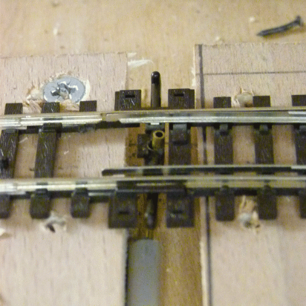

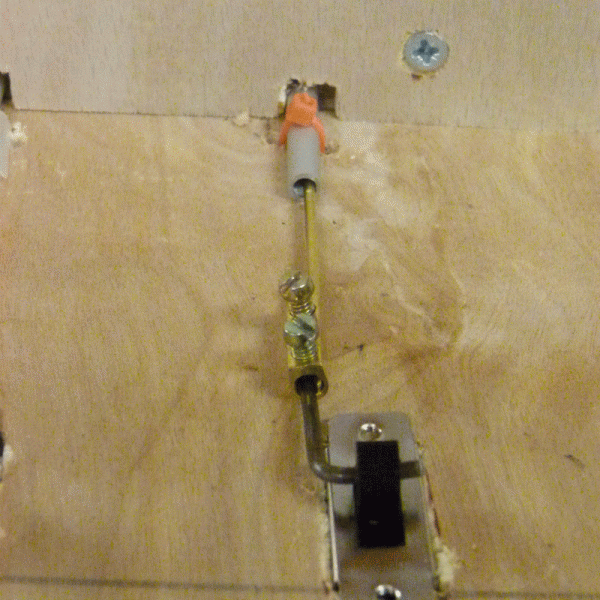

Just nipped up to B&Q and managed to get some very thin hollow tube made of brass. It should take a bend and therefore will be ideal for my other wire in tube point control.
I'll be installing that tonight along with the kadee magnet. That will be tonight's tasks. I may get a bit more done depending on how long it takes me to do the above.

What size is the tube Tom (diameter)?
#205045
Hi Ron,
I'm guessing but it must have an OD of approx. 1.5mm or so. I have installed it tonight but not before bu@@erring up a set of points when drilling out the tie bar to accept the tube. never mind, he we are.
The aluminium tube must be about 4.5mm OD or there about. I can find out the exact size should you wish to look for the stuff yourself.
here is one of the tube coming through the T bar.

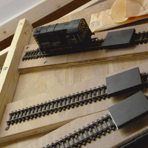

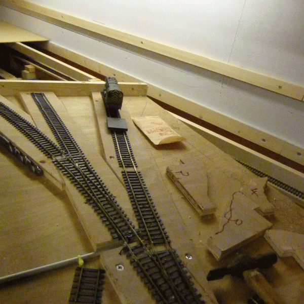

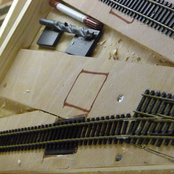

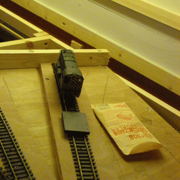

I started looking at the positioning of my kadee magnets. you'll see what I have done over the next few photos. I think this will spark a bit of a debate.
and another
I will be using four positioned as shown. Over kill but I could not position one in the obvious place ( as suggested by Gary ) due to the lack of length. I will explain that one later.
another
and another
The first one sunk in,
I had to stop as the banging was a bit loud considering the neighbours so that was as far as I got.
The next one for cutting in.
And one last shot.
the positioning of the magnets is based on the use of two shunters. One residential shunter and an incoming shunter. I'll try and work up a diagram to show how I would intend working the system.
As I said before, I could not place one just after the kickback lane and before the three sidings as that would have been the best place but there is not enough room. So ….. lets see if the above makes sense to anyone of it suggests chaos or an unworkable solution. Most moves will involve the movement of two wagons at a time with the exception of the incoming shunter that will bring in three or maybe 4 at a push. It does make for lots of movements.
Anyway ….. lets see the questions it throws up.
cheers for now

#205048
Hi Toto
Have you forgotten the Kadee shuffle, you only need one magnet at the throat, and one at the end of the reception road to uncouple the delivery loco from its train.
Paul
#205049
There ain't enough room at the throat. That's the problem. Unless I remove the kick back siding which would give me a longer straight section prior to hitting the first set of points.
#205050
Hi Paul,
Gary suggested placing the magnet at the throat as well because with the delayed coupling, you could basically decouple and push into any siding. Due to the lack of enough straight track available at the throat, my way of thinking was as follows.
I'll be as clear as I can,
The visiting shunter pulls into Highbridge and takes its train right into the main goods lane ( the longest one ) . The shunter goes to nearly the end of the lane where it uncouplers the whole train and draws forward a couple of scale feet.
The resident shunter pulls out of the kickback lane, approaches the wagons and couples up. It then draws out onto the main track and then pulls forward again distributing the wagons into the other two sidings. This lets the visiting shunter pull out and disappear back off scene.
The resident shunter then reallocates the wagons to the main lane siding to be unloaded. Once unloaded the wagons can be reformed by the resident shunter into a train again and await collection by the visiting shunter again.
The cycle can then be repeated or only part of the train maybe unloaded and a bit of additional shunting with one or two additional incoming wagons could maybe be facilitated.
Does that make any sense or Am I talking a load of Gladys Knight.
PS ….. I did not think that was too bad logic for a complete rookie.:mutley
