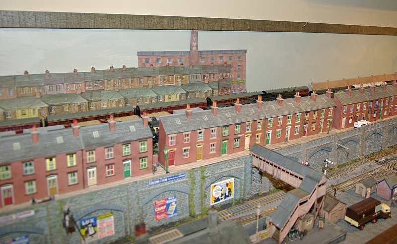

So (a) I got bored with ballasting and (b) I had time on my hands. I started looking at the unfinished back scene behind the storage sidings
Regular readers will recall that above the branch line I have a series of Metcalfe Houses concealing the 8 road storage yard…..then behind the yard are two layers of Townscene backdrops cut out and mounted to create a slight three dimensional effect
It all ends rather abruptly after the YMR Mill………like many other projects on Granby it landed in the pending box
Townscene sheets are great but difficult to get hold of. Finally I got some from Jerry(?) Freestone just before Xmas.
I mounted a distant shot on thin card…..painted out the cut edges…… and mounted it directly to the sky behind the second row of houses
This finishes off the tiered effect of houses climbing up a hill that I wanted to achieve
I ordred two of the sheets with the house backs on……a must for any urban layout…….then mounted some other house tops behind and finally a third long distance layer
Right now its a little bright…..this is 2011 vintage while the first shots were on Granby II vintage circa 2003
Its also a little crowded but I am not unhappy with that……..small northern industrial towns are (or where) exactly that……a little crowded

I think that tiered effect looks great.
I agree that some buildings are unlikely in Wrexham but I don't believe you should beat yourself up about that, John.
It is your scene. If you want Disneyland in the scenery that's a matter for you.

Brilliant John - as ever.
I really like the "clutter" of housing disappearing into the distance.  The way you have achieved it shows that you've given it a great deal of thought.
As you so rightly say, buildings in the industrial north were indeed very cluttered.  Perhaps more so at your side of the Pennines although some of the West Riding mill towns, whilst smaller, would come a close second.  It's that "industrial clutter" that so inspires me - as it has also inspired many more famous people than me in the past.  The power house of the "Great" in Britain - sadly now almost gone.
The juxtaposition of the differing architechtural styles is also extremely authentic.  I'm green with envy but, as with every cloud, there is a silver lining in that when I look at your layout, it rekindles my fires ………..
Your "search for perfection" is proving very successful.
Always an enjoyable read and excellent photos to match. :cheers
